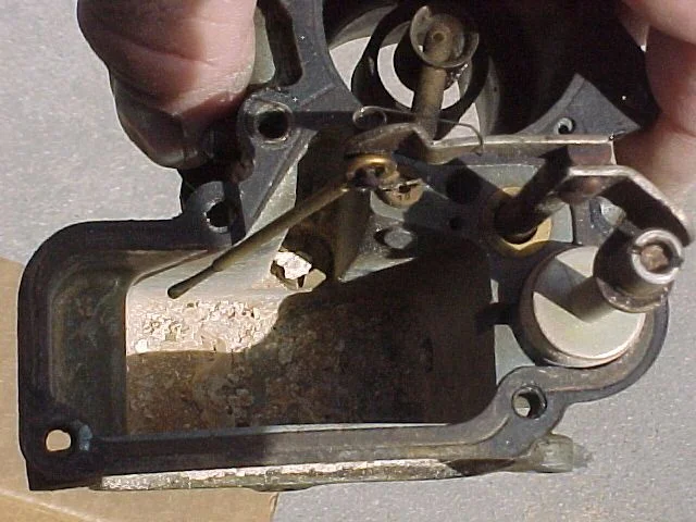

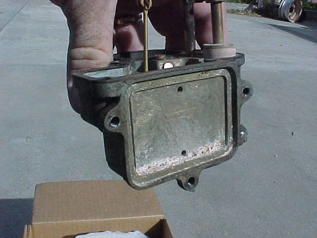

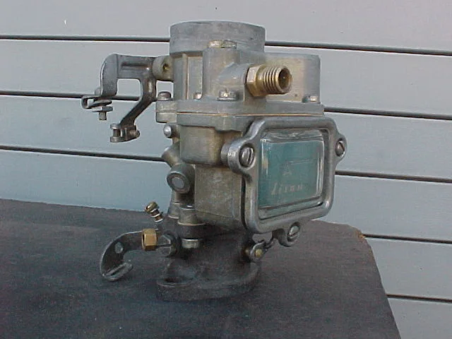

Finally got time to post some photos. Your first carb broke the record for most crud in ANY carb I've worked on!:eek:
Of course, the lighting was all wrong for the 'after' shot,but you get the idea!

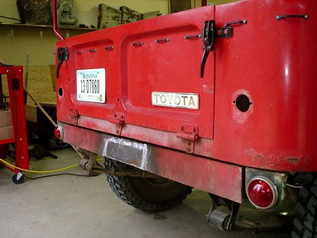

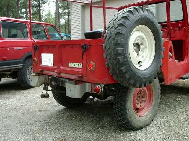

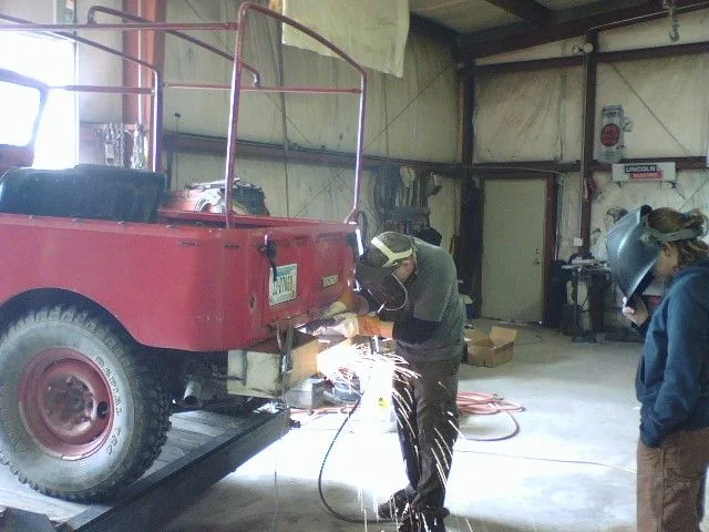

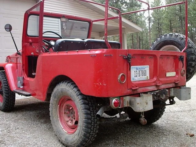

You might have noticed there were no pics of the behind, this is because of a huge growth back there, shameful. I took it to the welder today and had no less than 70 pounds of steel removed. The rear frame crossmember had been cut out and replaced with this C-channel...it will be replaced someday with a stock piece.
I was thinking about sticking some reflectors over the turn signal holes...

Phil, that's pretty funny about the rear end, I remember asking for pictures of the rear too!. :lol:

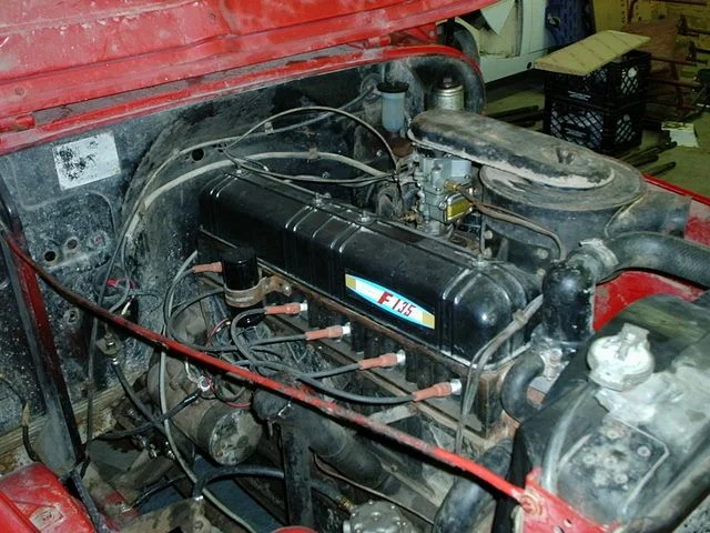

That looks great!!! :clap::clap::clap:
To think you got this going in Jan, and now it looks, and sounds like it's ready to go. She looks really nice! Any chance we can get a short video of her in action?
