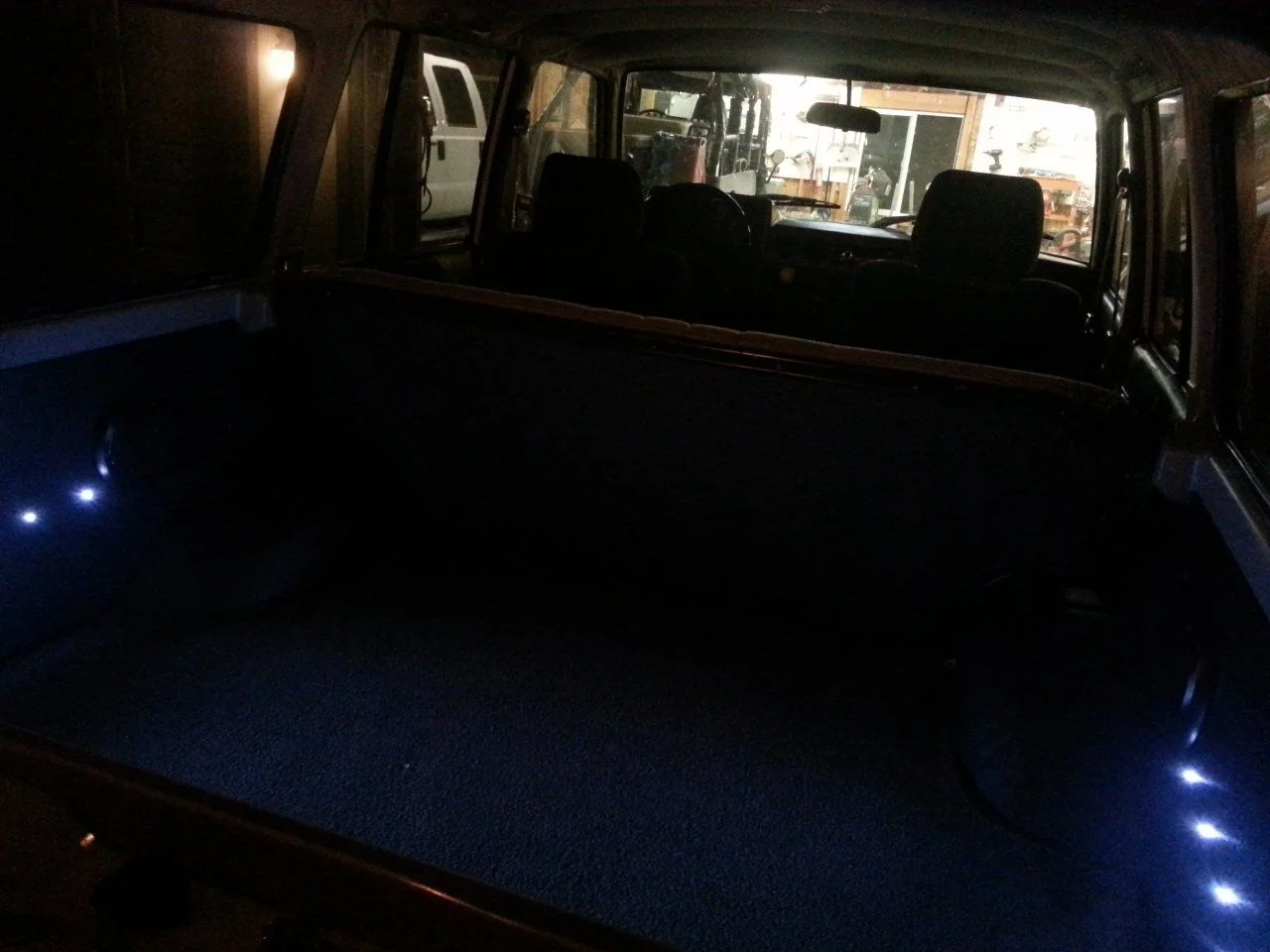

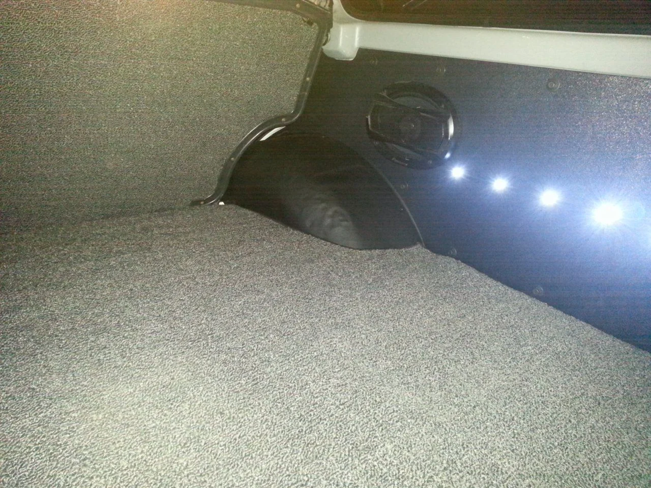

My LED light Mod. These are wired to the cargo light switch.
Just enough light to see what you're doing, but not enough to be overwhelming.

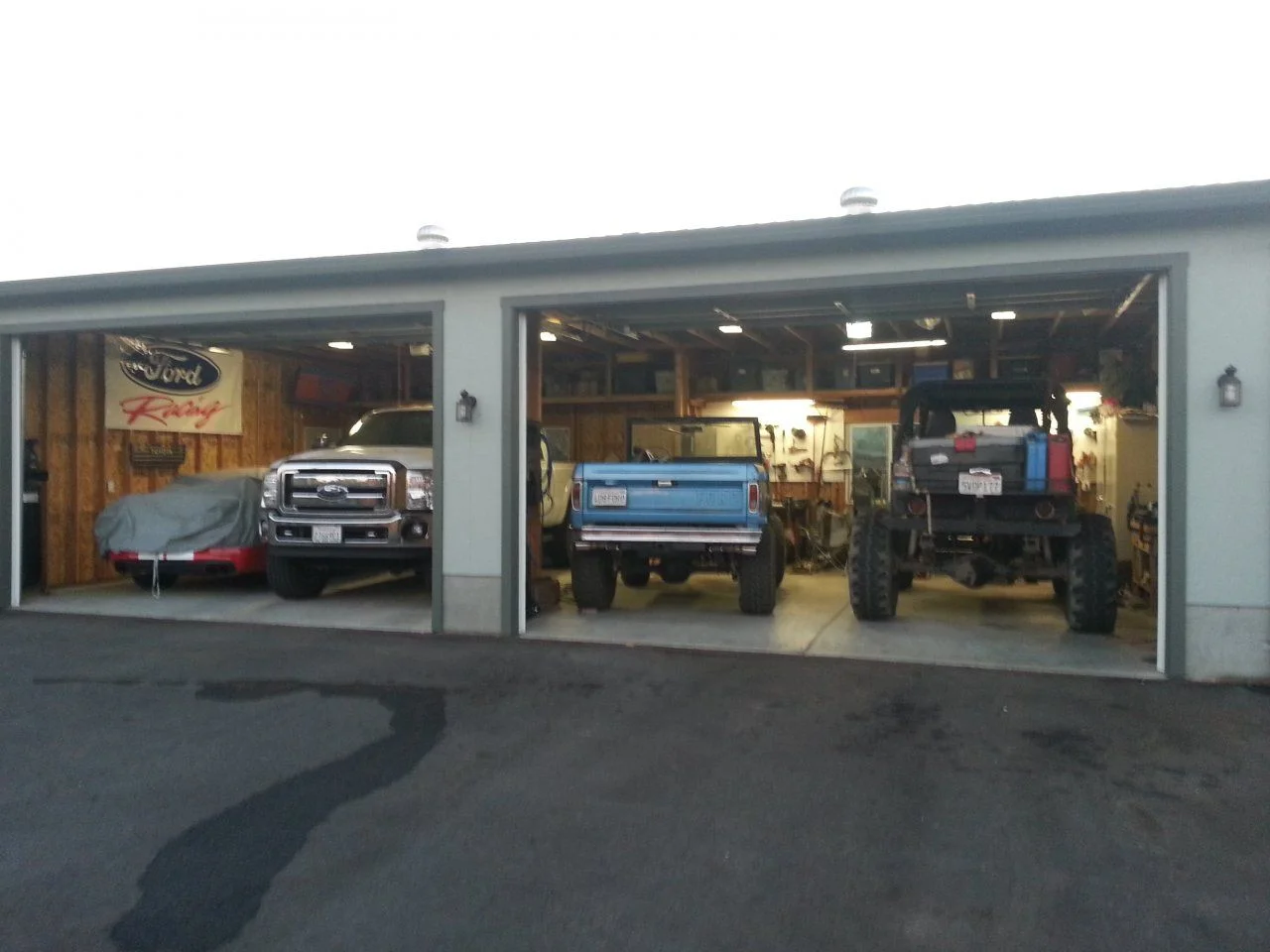

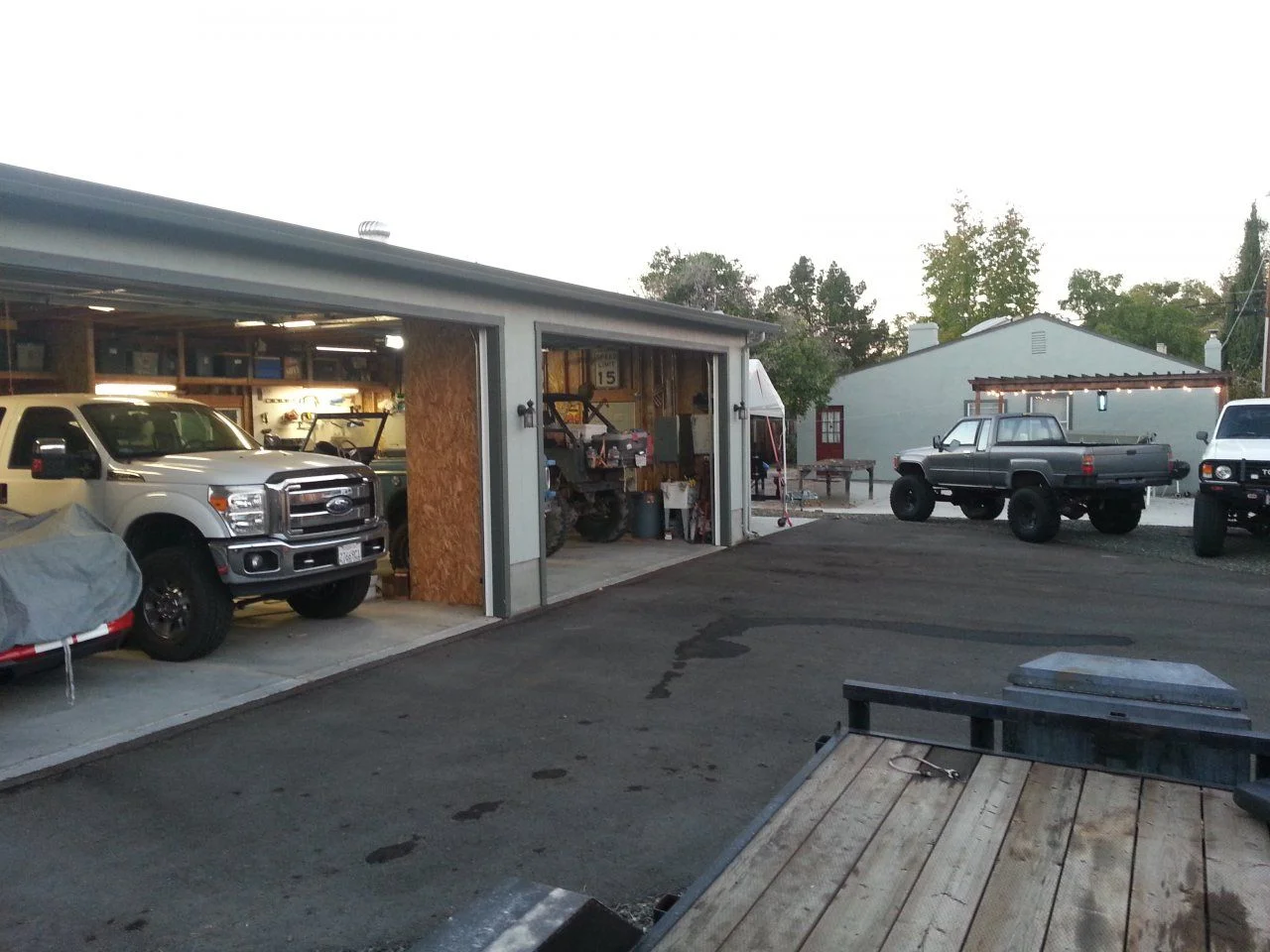

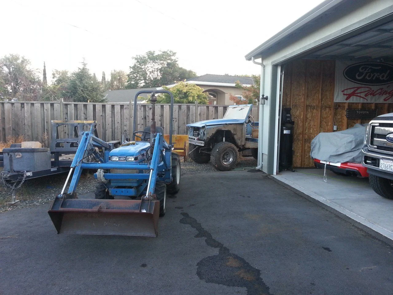

The Toyota has now been relegated to being reliable transportation so its spot in the garage has been requisitioned:
Yes, that is a Ford 1220 tractor - which as a side note shares the same starter as a 22R-E. Weird. It's diesel and has a smoke stack. I win.
Go outside, Toyota.
