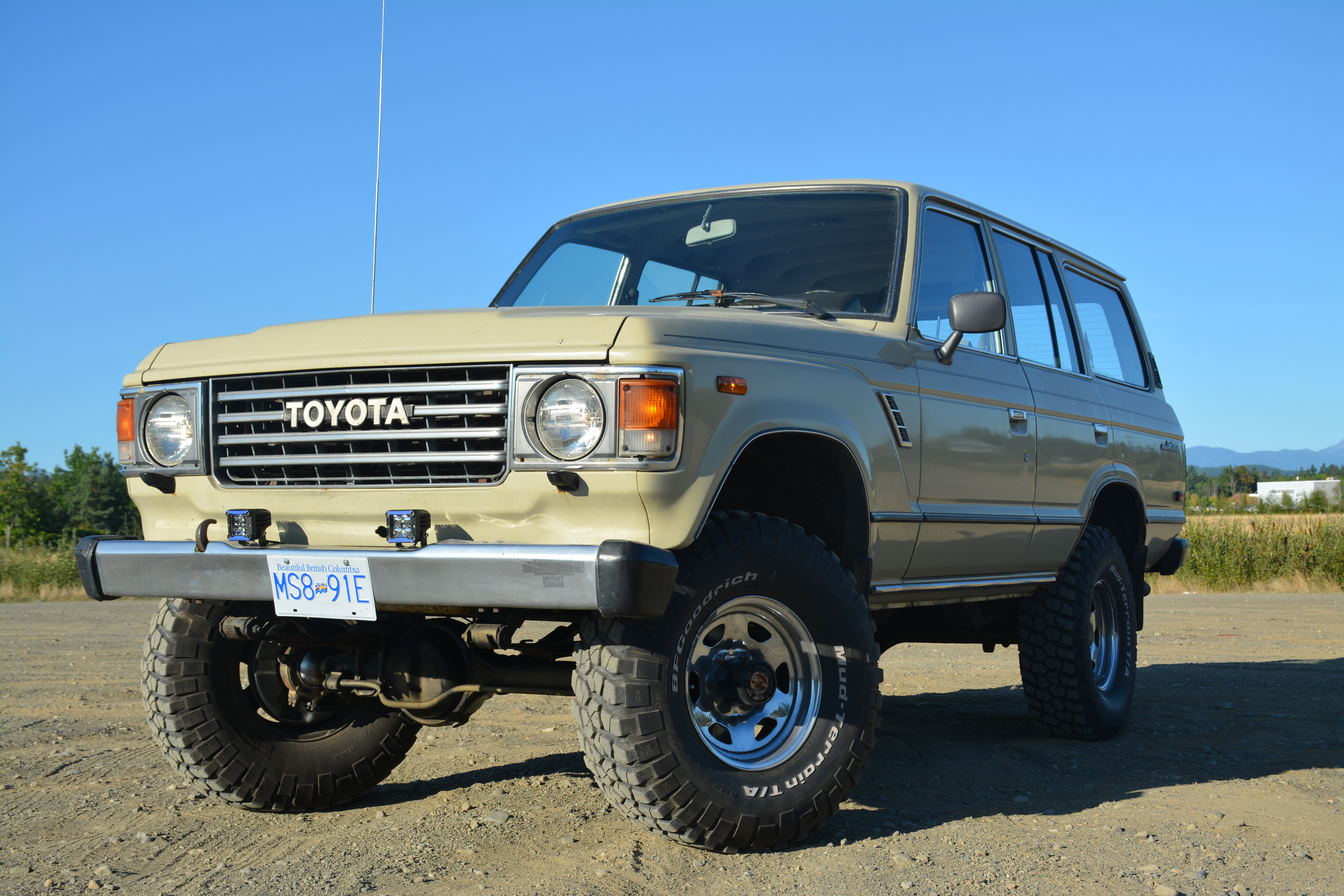

So ive already done quite a bit of work. here was the start to having it road ready again and at this point i just thought it was all i was gonna do to daily drive it… i was very wrong. I repaired the worst of the frame right away and fixed the front end, took the time to fix every switch light bulb and even got the a/c working and converted to r134a
Had a bad leak coming from the rear main oil pan and pinion seal so i replaced those and i took it out for a good 1400km trip and in the middle of the week after that my radiator started leaking i left it as it was not to bad yet. I was investigating more oil leaks the main one coming from the fuel pump spacer that i found broken in 2 pieces i fabricated my own out a 3/8” chunk of steel plate. At this point i was getting annoyed with the amount of leaks it had. Luckily the next thing that broke was the alternator had it rebuilt localy to drive it again. So i drove it a couple weeks more back and forth from work until i went to leave and saw a huge puddle of gear oil on the ground i found that it was coming from my t-case shift rod seal. I had it, parked it in the back of my shop and started to think what next… thats when project Sasquatch started

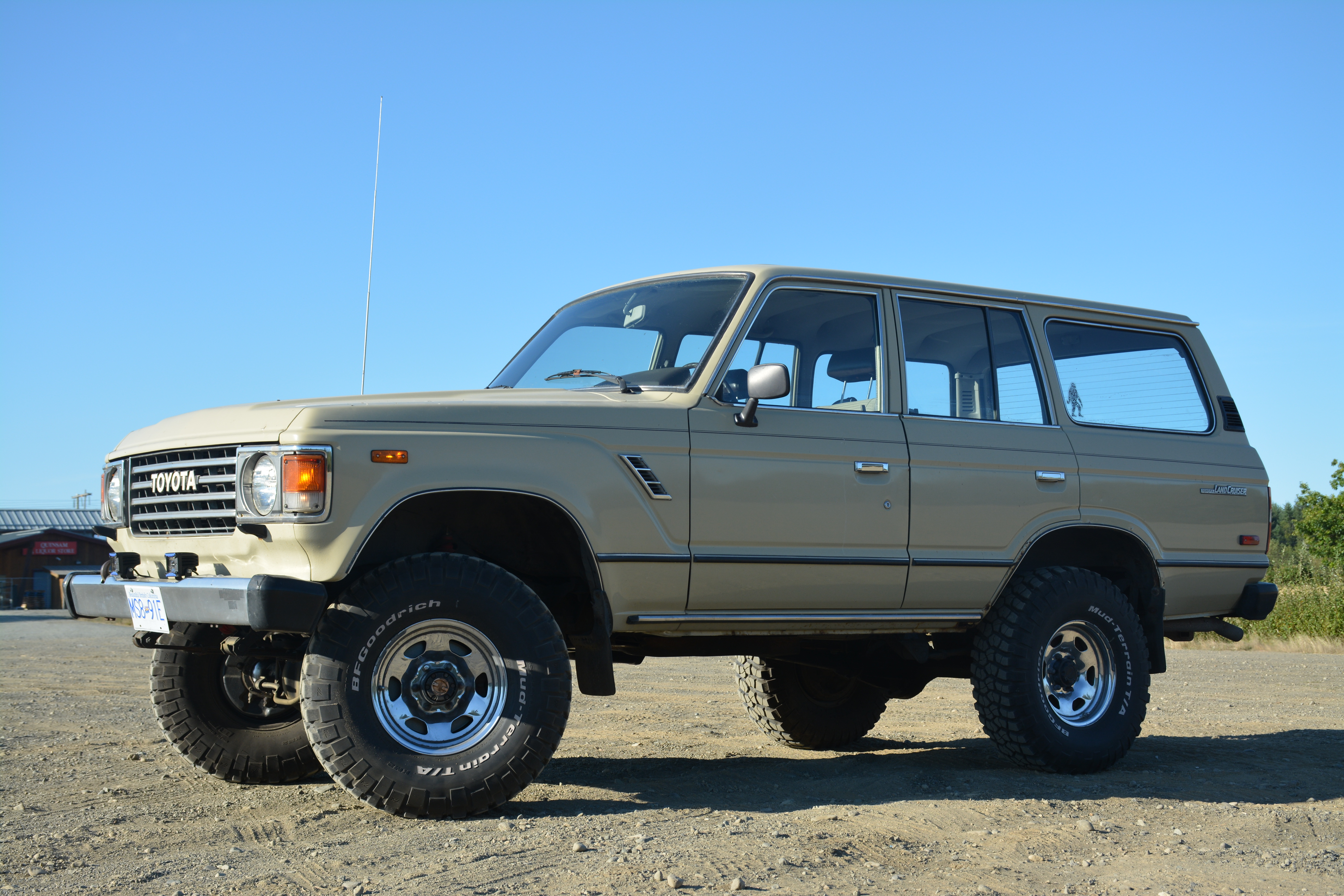

those rockers looks surprisingly good for a 60 in BC.
The only rust on the body is around the rear fenders, the left rear outside edge of the rocker and two penny sized holes in the drivers floor area. It will all be fixed. everything else is mint. Here is above the gas tank, the rest of the underbody looks like that
