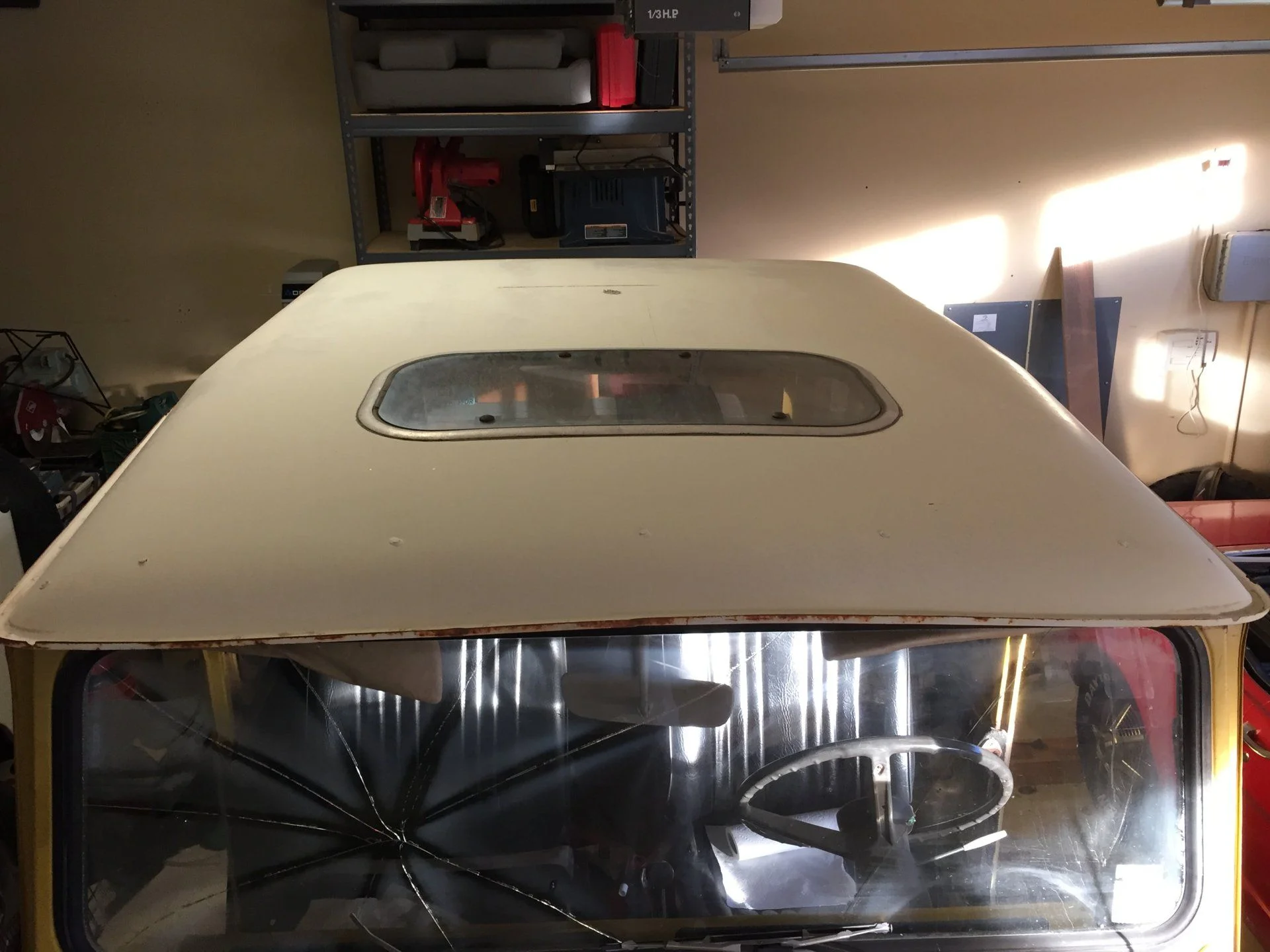

I've been thinking about taking advantage of a key leftover part from this build: the hard top.
At the start of this project, Pikachu had a top. The ambulance doors must have been stored outside in knee-deep mud for many years and were trashed.
However, the fiberglass top and sides were/are in okay condition. Not good condition, but okay condition. I'd like to spend some time bringing it back to life, and to have the option of a hard top when I need it.

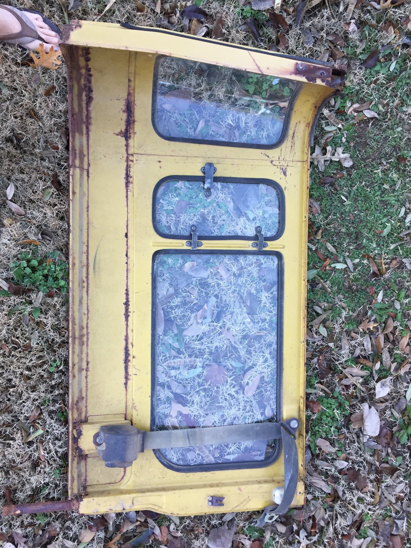

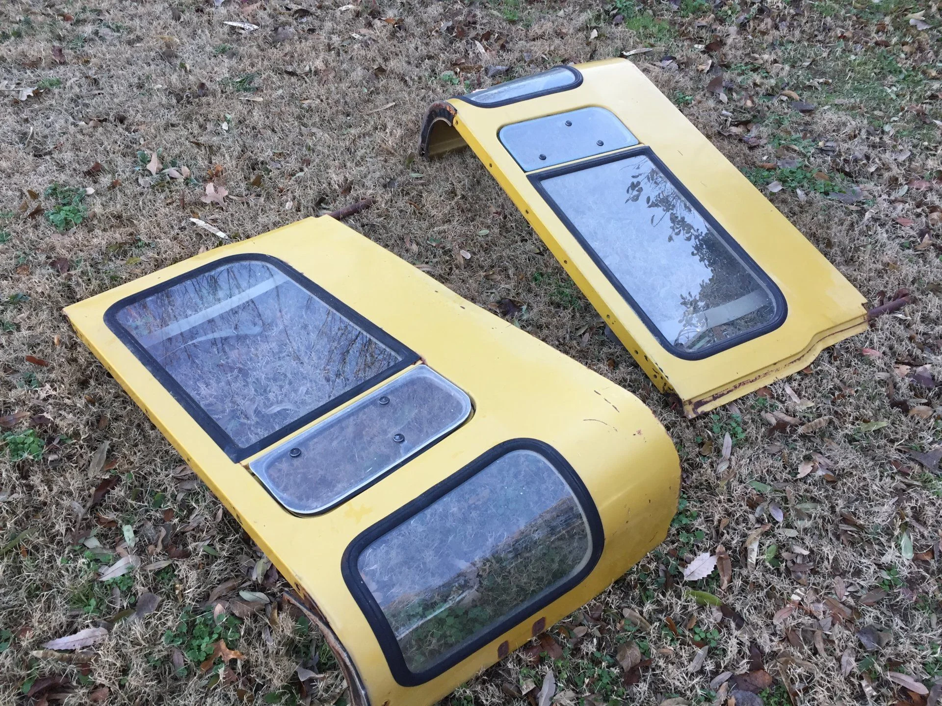

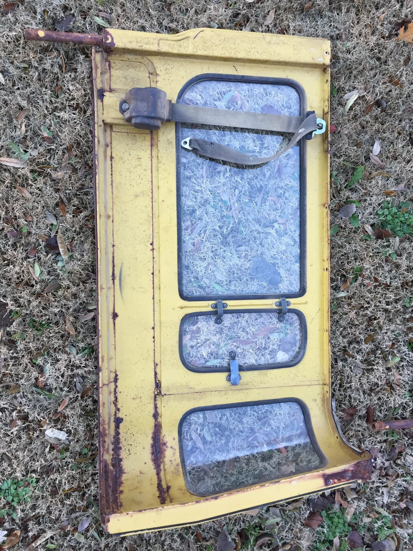

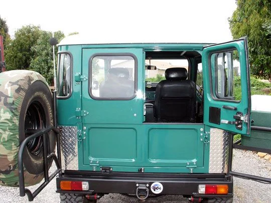

I love having a tailgate, but I also like the period-correct look of the square rear windows on a late-model hard top. So, I decided to take the road less traveled and find a set of bottom-rusted amby doors that are candidates for something along these lines:

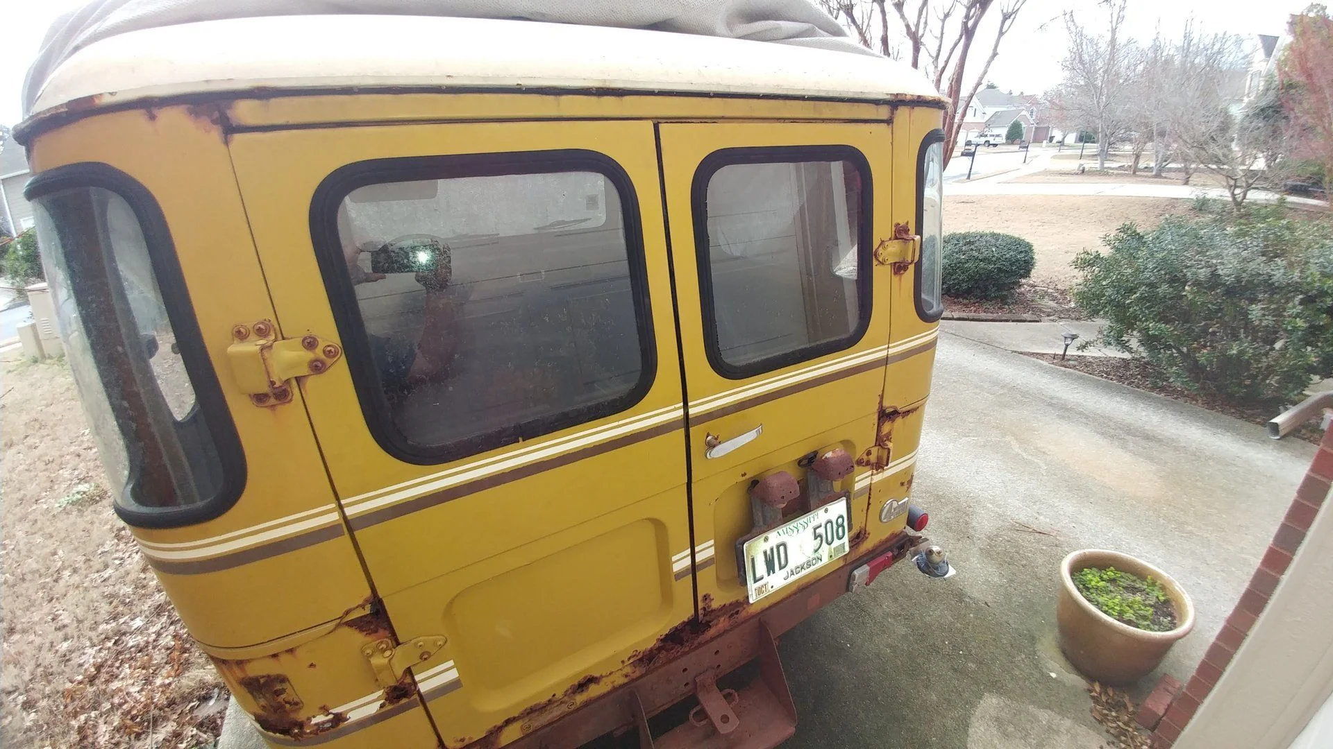

I'll be tackling this project over the next couple of months. Here's a set that are on the way over from @JVZii, since even the uppers on mine were too trashed to work with. Interesting that it is a mustard 40 with Mississippi plates.
I really like the hybrid rear door idea....seems like it would make much more sense with a rear bench too! Hoping i can find a top soon for 'ole red... By the way, really great speaking with you yesterday!!
Dang! You’re walking the path that I’ve been debating with regards to the rear doors. I saw the same thread where they cut the bottoms off to make a tailgate and hinged the tops to open outwards. It’s a slick setup and I’ll be watching with eager anticipation in hopes that I pickup a few hints on the process.
