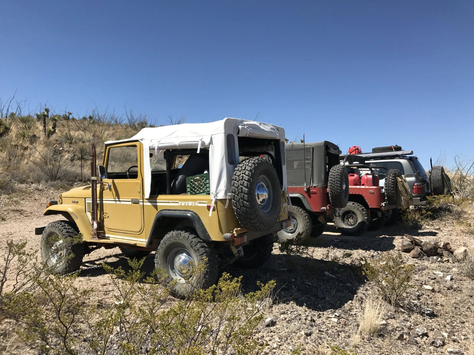

So, in the spirit of why we have these trucks, I just returned from a fantastic trip to Big Bend State Park on the U.S./Mexico border for some wheeling and camping with old friends in the new trail rig. In the crew are a '75 FJ40, a 76 FJ40, another '77 FJ40, a 1998 UZJ100 with factory lockers, and Pikachu of course. She ran beautifully.

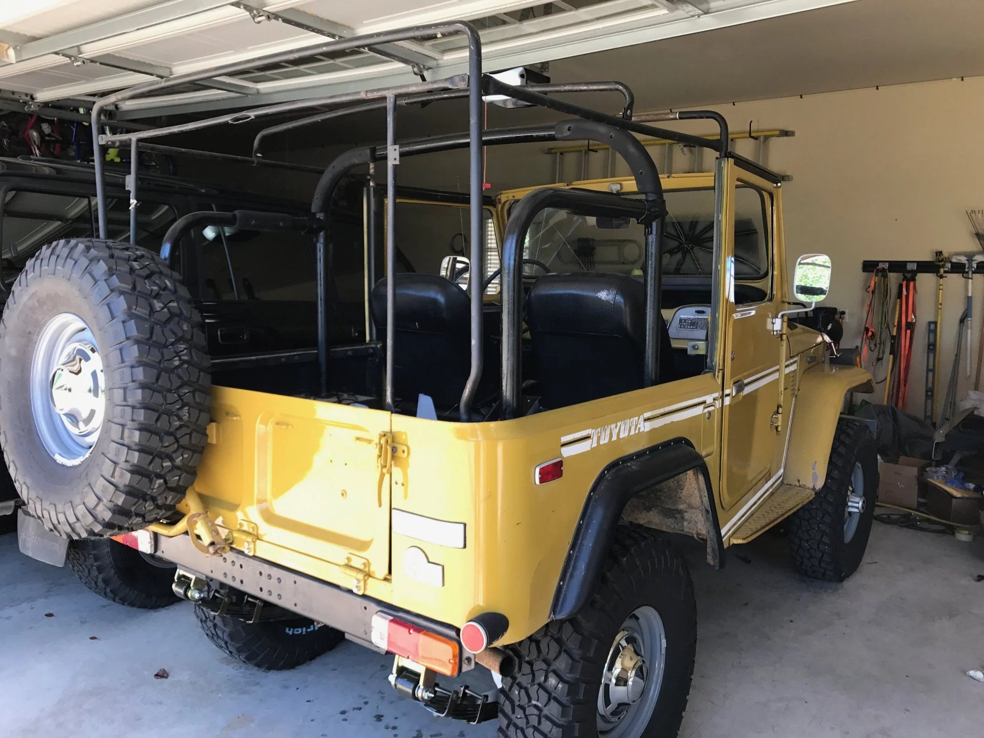

What an amazing job you have done! I feel the urge to "borrow" your design! Don't you have ,by any chance , a photo of the rollcage used as a base for the soft top?
Thanks. I think you may be referring to the bows that support the OEM-style soft top. Here is one picture that I took during the install. Hope this helps.

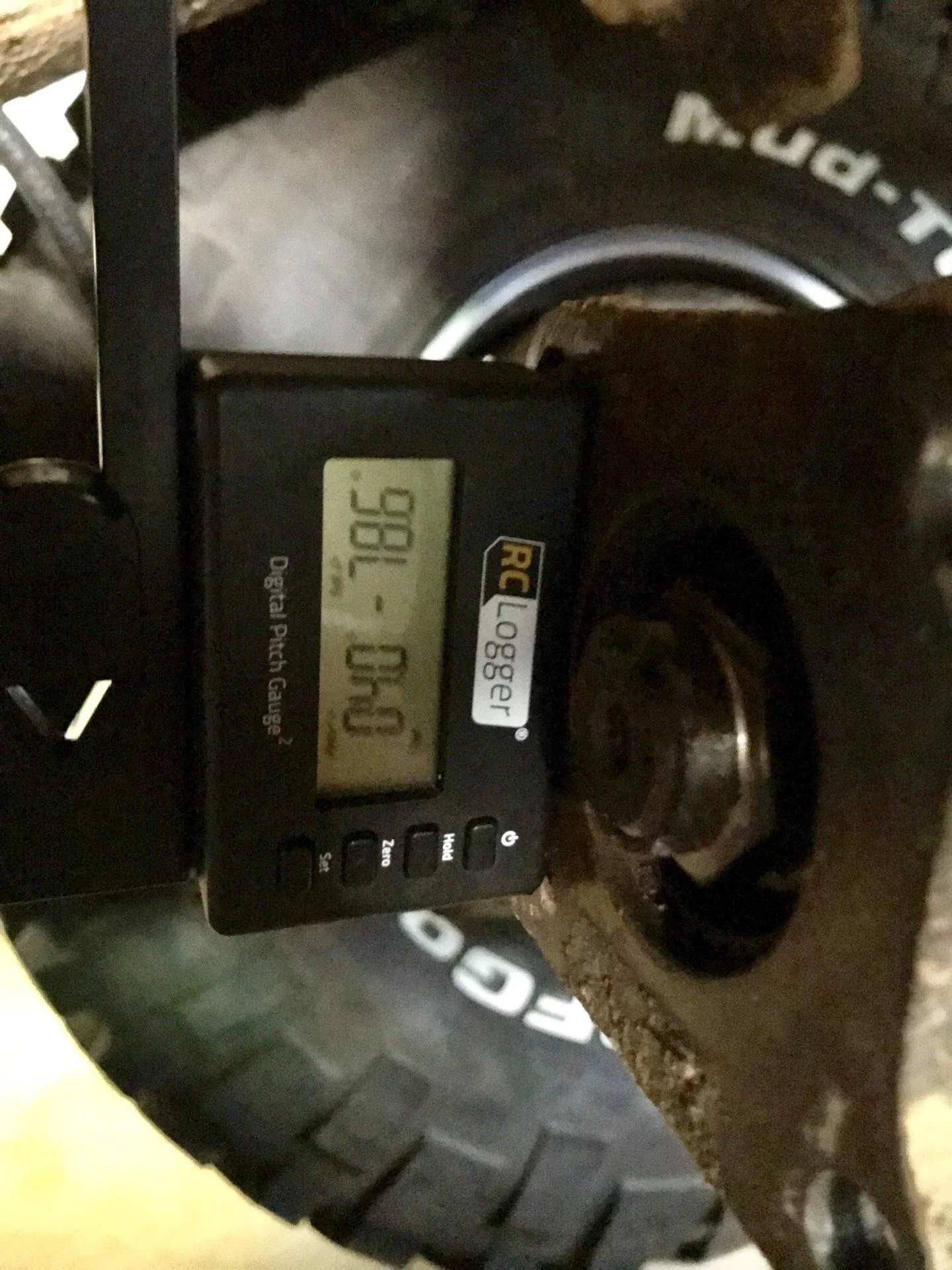

Thanks, Lee. After reading this, I immediately noticed that my rear diff was slightly angled upwards. And, it looks like we are about 4 degrees upwards. Is the solution to install 4 degree shims on the rear spring packs to make the flanges parallel? Where is the best place to buy them?
Contact @orangefj45 , Georg @ Valley Hybrids & Cruiser Brothers for some steel shims.
