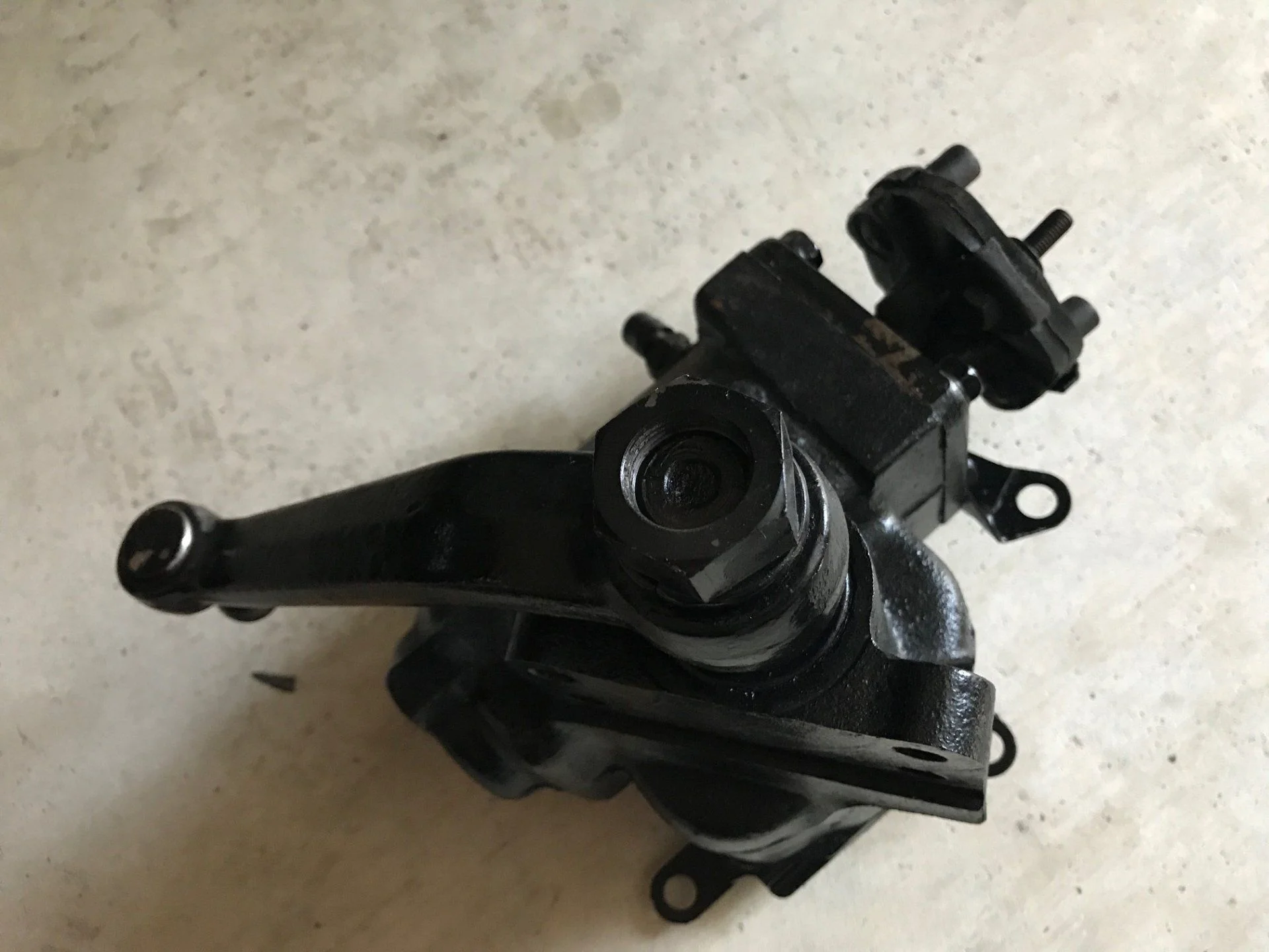

Picked up the rebuilt steering box earlier this week and installed it last night. What a huge difference.

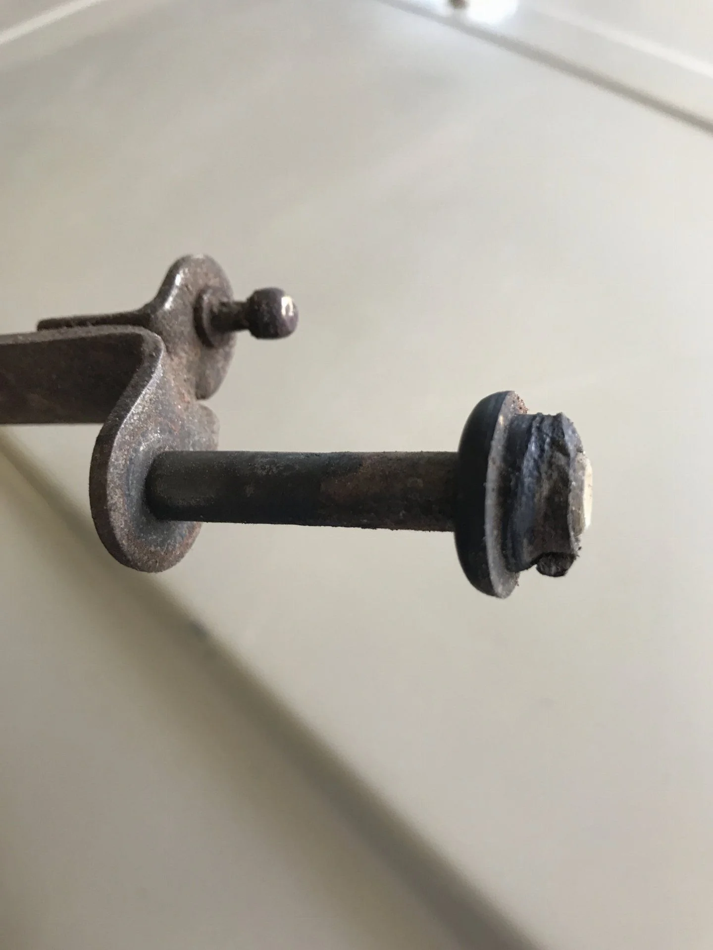

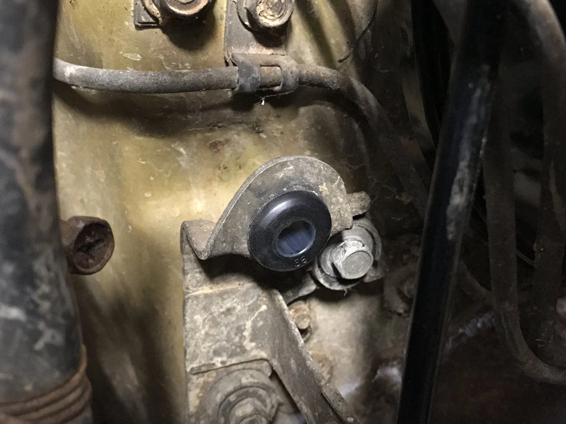

I've had a little bit of an issue with the throttle sticking after getting up to speed lately. I originally suspected a weak spring on either the carburetor linkage or on the accelerator pedal mechanism, but noticed that the torque rod grommet was out of place and badly worn. Found that Cruiser Corps sells these for cheap and installed it. Also added some oil to the linkage between the carb and accelerator and the problem seems to be solved.

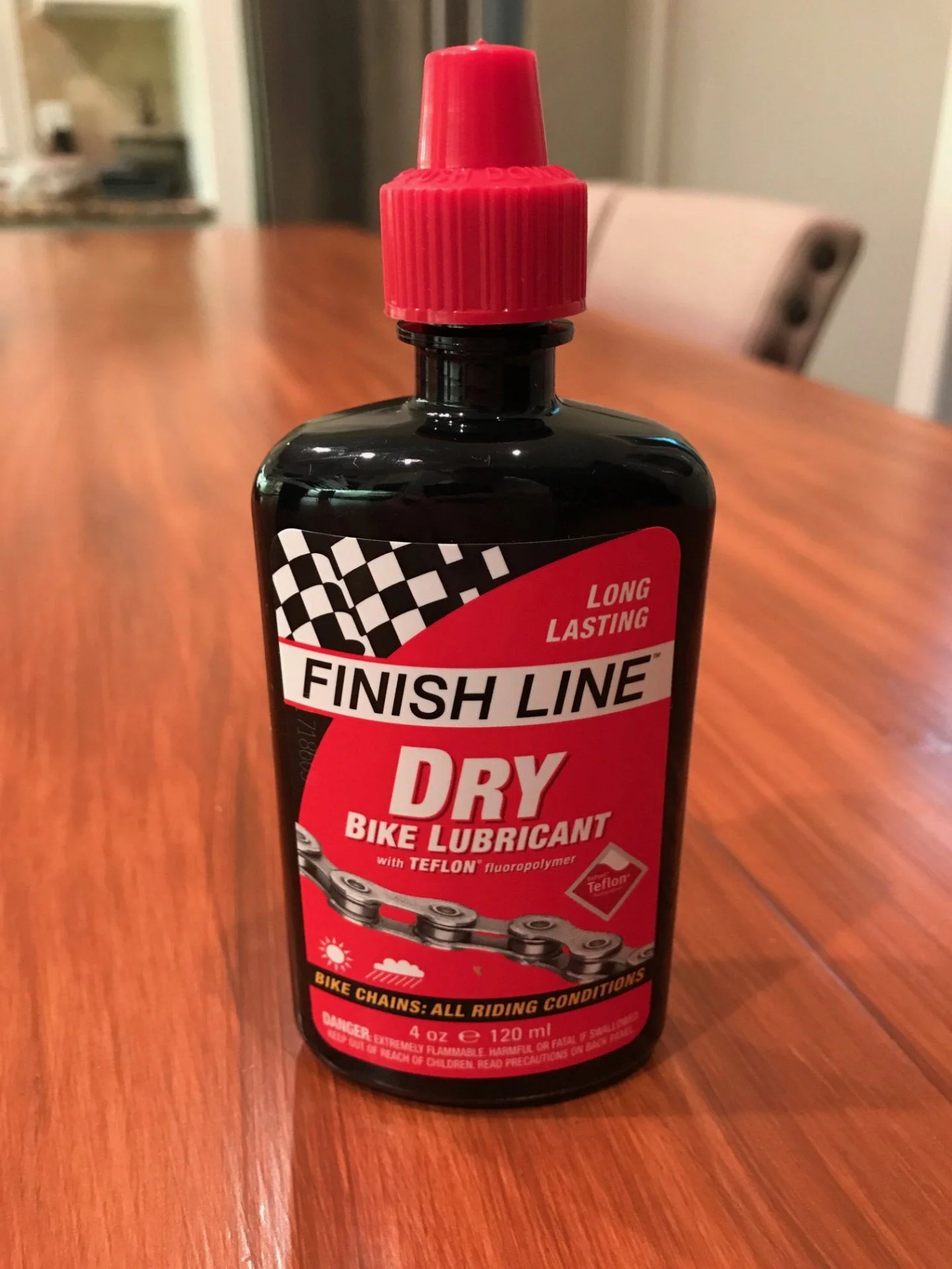

Somewhere here on MUD I read that the throttle linkage is better lubed with a dry material than straight oil... as the oil will buildup dirt and gunk. I use a dry-type bicycle chain lube from one of the bike shops here. Works like a champ and keeps the linkages nice and clean. I also use it on the hood clasps.

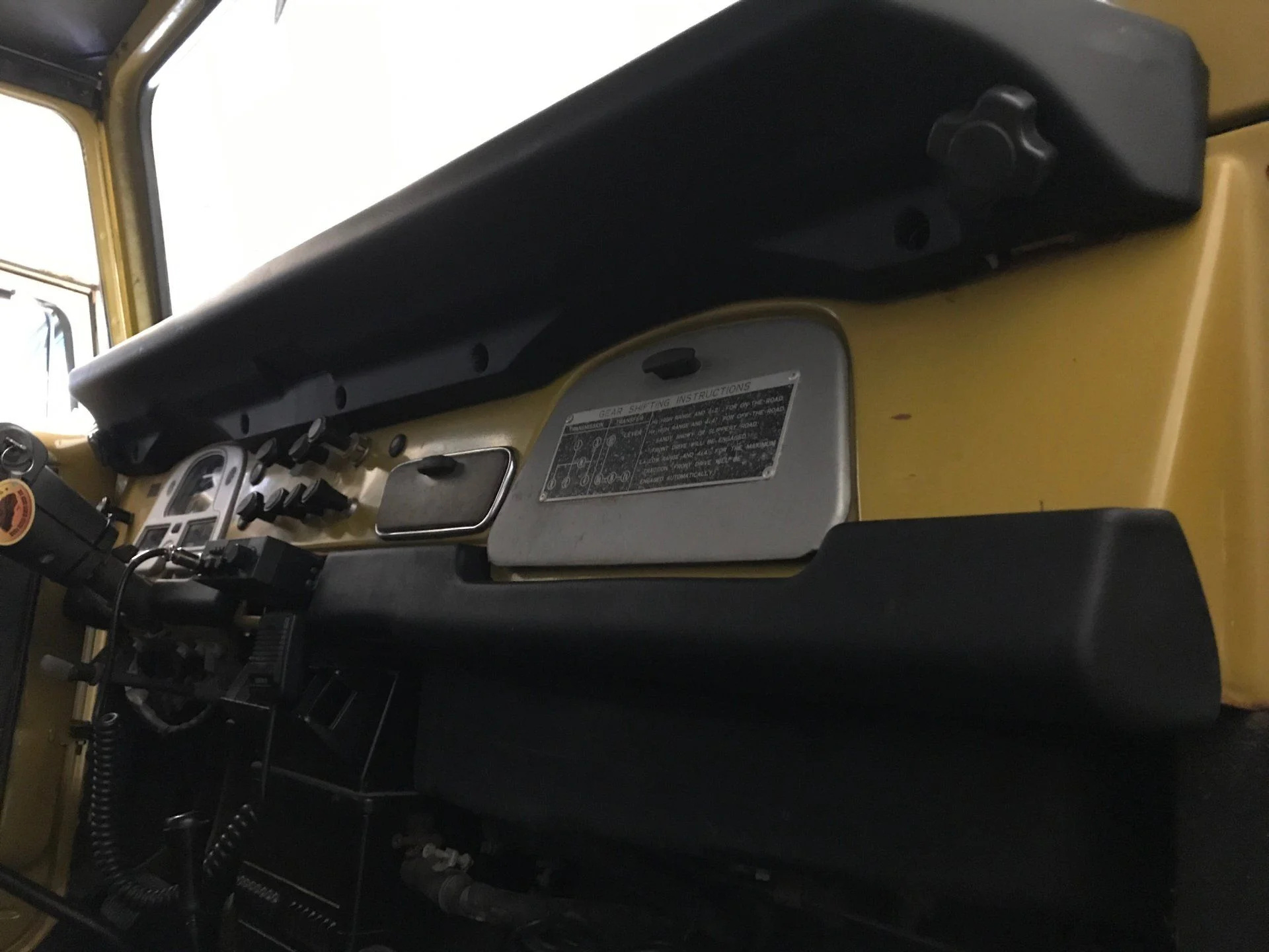

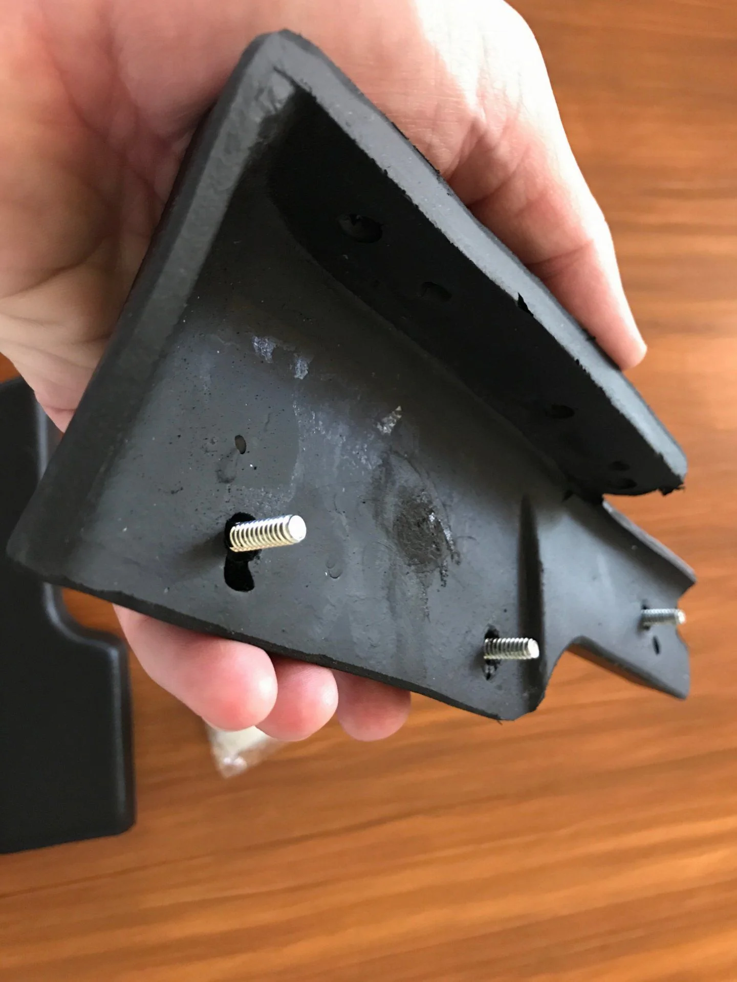

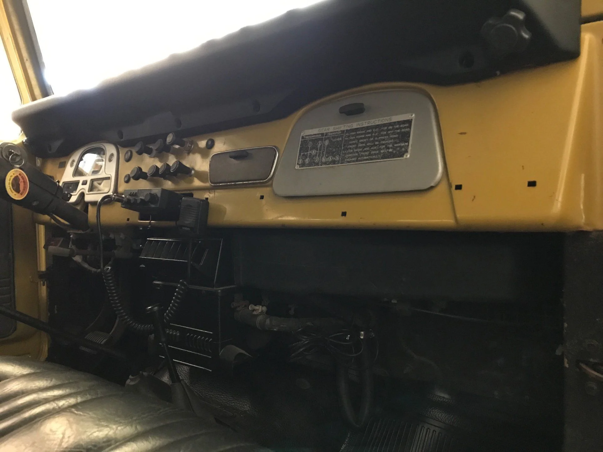

I decided to pull the trigger on lower dash pads. This guy at fj40dash.com really makes a nice set. I installed them and it really brings this dash back to life.
These are threaded in the back, but come with lock washers, nuts, and screws for the bottom of the pad for the OEM holes underneath. I'd definitely recommend this product.

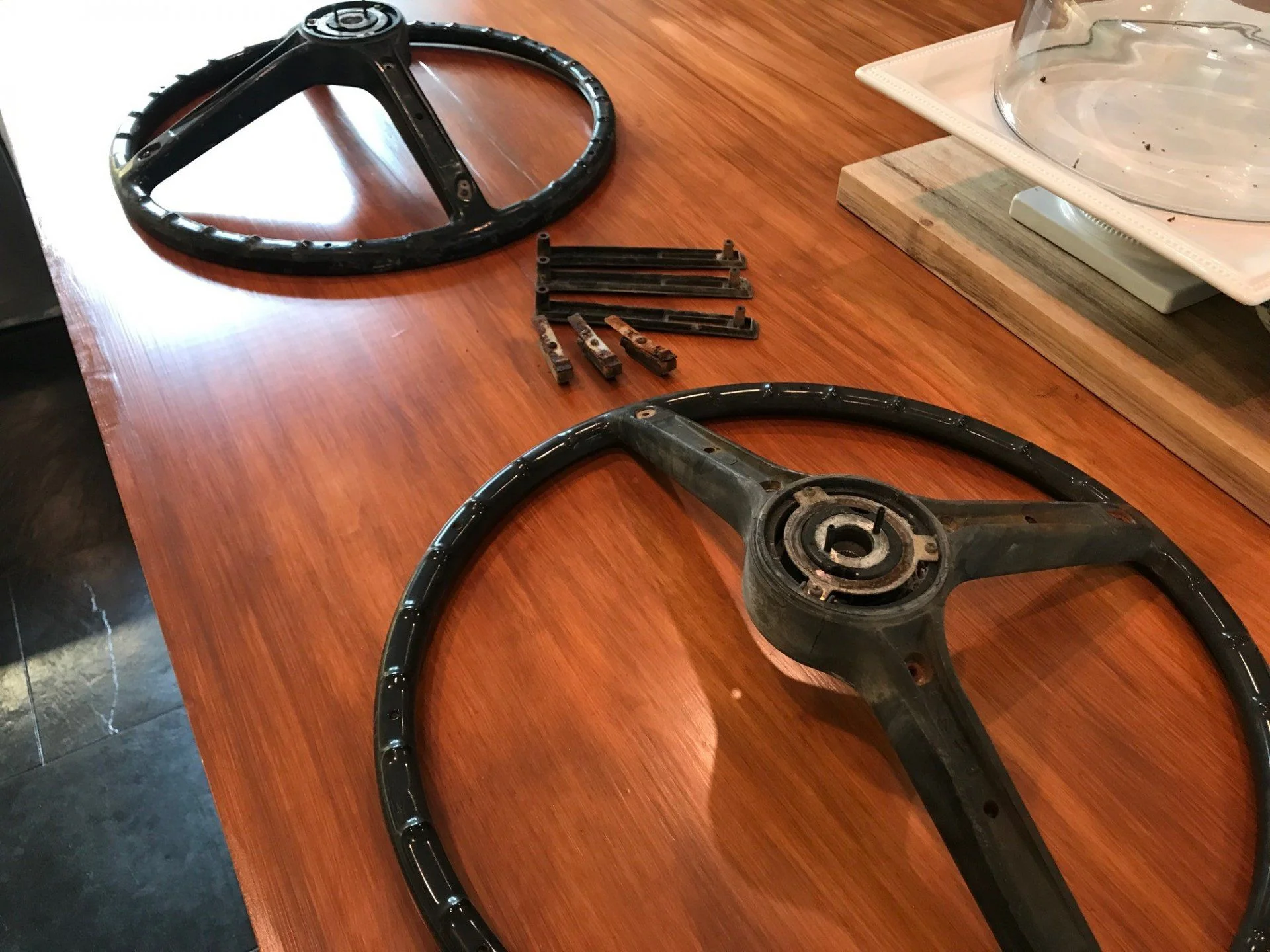

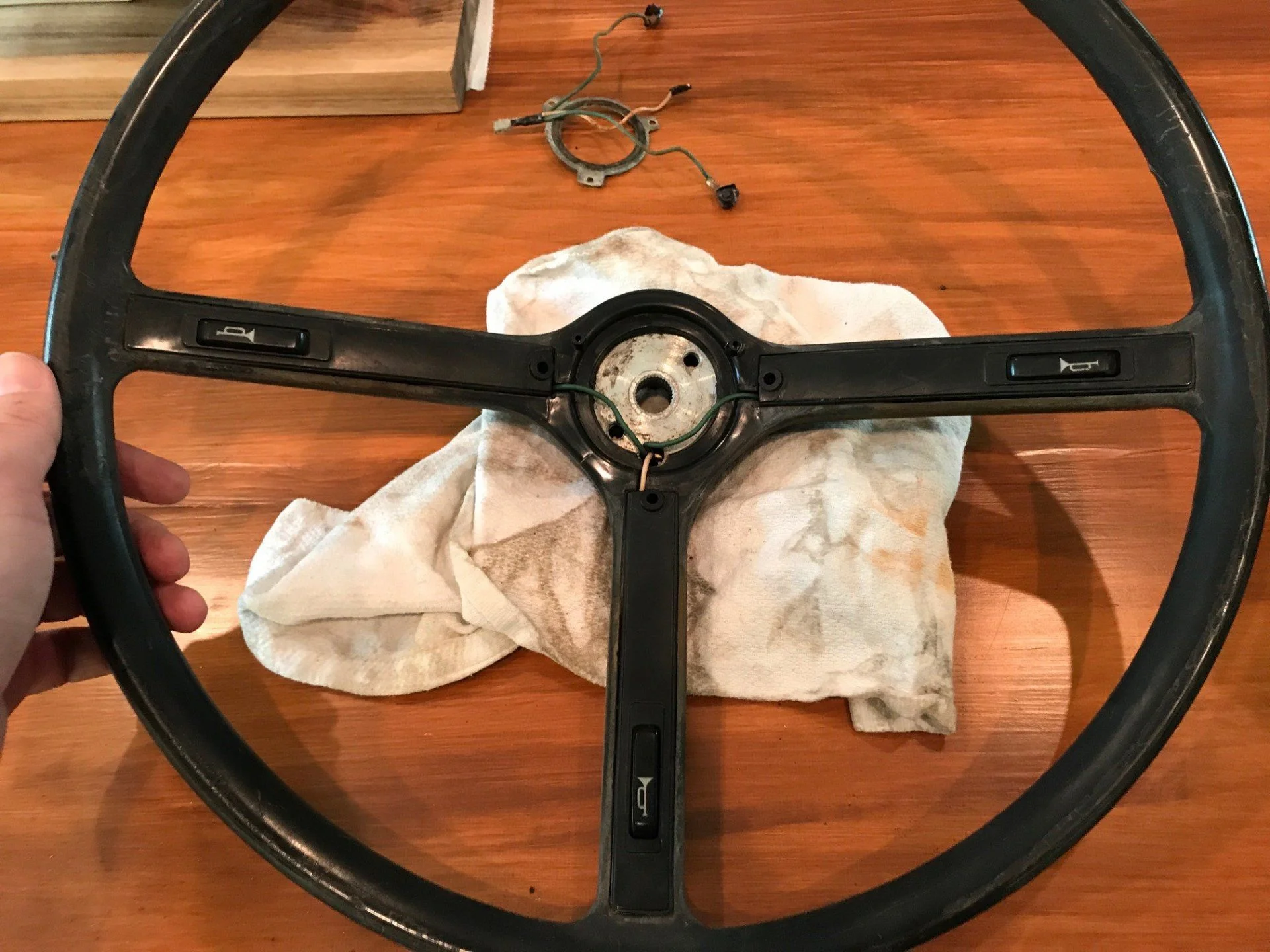

Despite my best efforts, the steering wheel won't quite center with the wheels straight. The 40 tracks nice down the highway now, but the steering wheel is off by about 45 degrees. One spline on the pitman arm it's slightly too far left, the next spline it's too far right. So, I removed the steering wheel to fine tune it.
Naturally, one thing leads to another and I find that the wiring and contacts for the horn are literally corroded in half. Funny how the body and frame are so rust-free, yet the Mississippi humidity still found a way to leave its mark after 40 years.
I can't reinstall it like this, and a functioning horn has been on my list anyway. Gotta fix it.

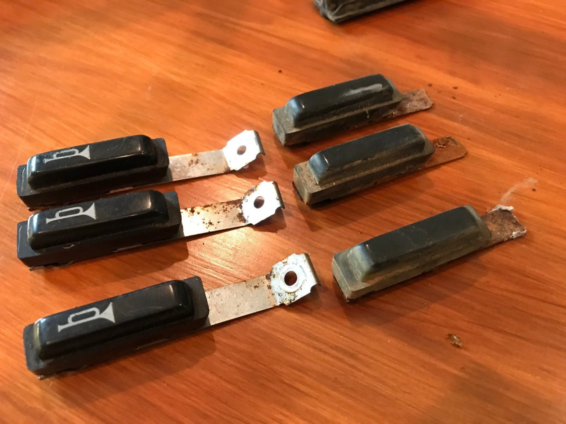

My buddy @Drewk and I have what I'll call a "shared" parts bin with a random assortment of spares and misfits. I looked in there today and found a steering wheel from one of his former parts rigs. The wheel was in rough shape, but the horn contacts and wiring were near perfect. So, I swapped them out into mine.
I had to use a grinder to remove the old corroded terminals in my steering wheel. Then I used some stainless machine screws to put the contactors back together through the back side of the wheel. Not exactly OEM, but works great and I have to remind myself that this is a trail/camping rig and not a show truck.
Back in business. Good, working horn and a straight wheel.

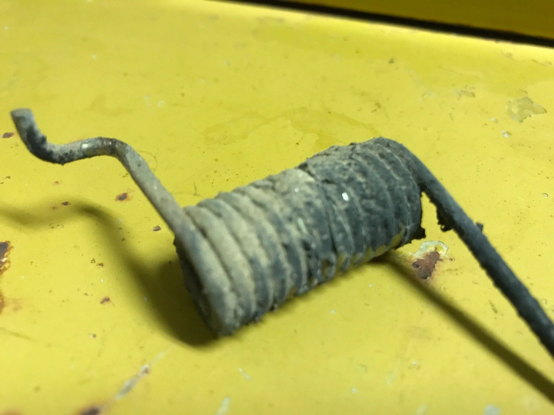

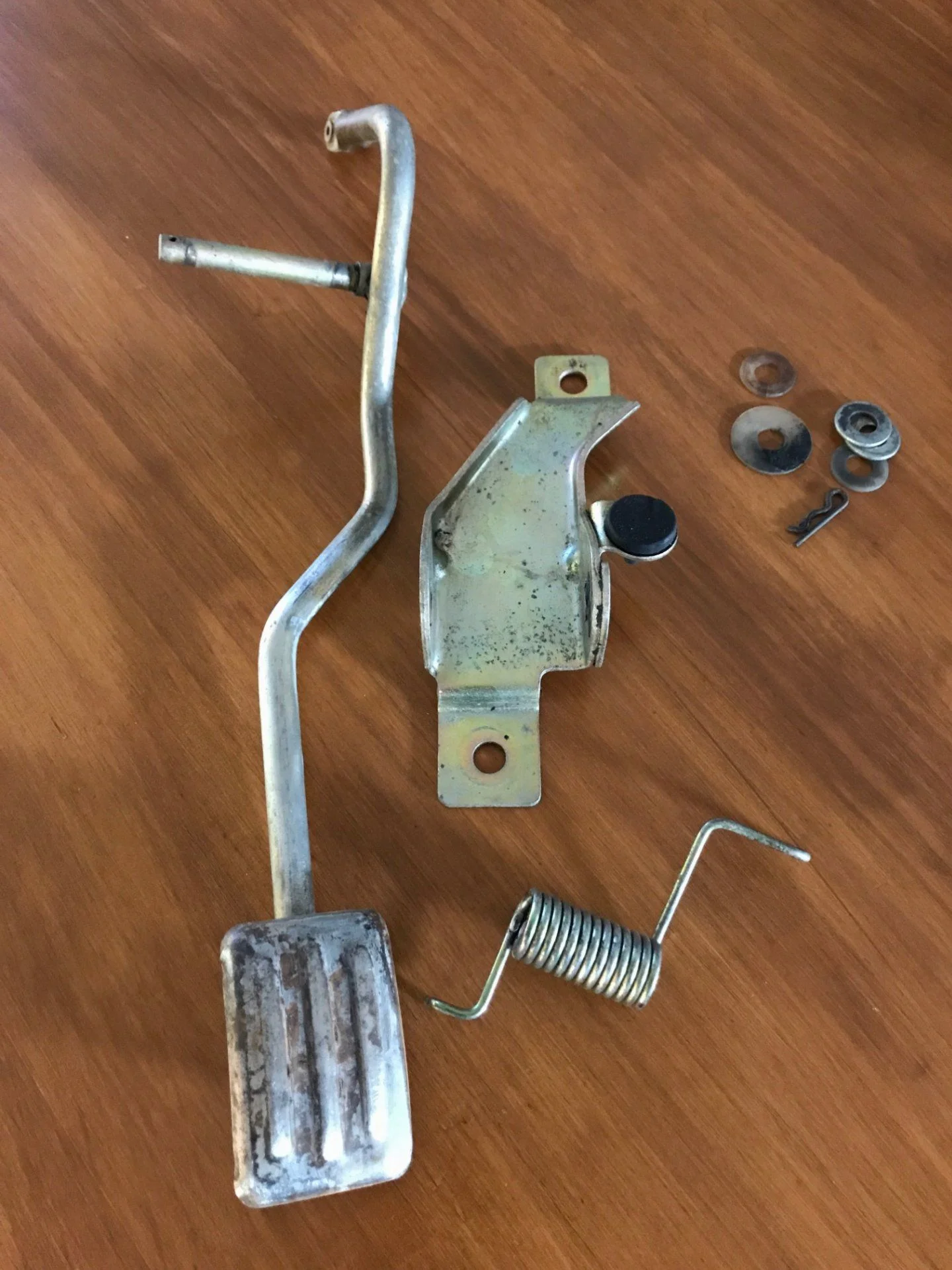

So the throttle sticking issue has come back and is happening 100% of the time when driving in 2nd, 3rd, or 4th gear. I ordered some dry lube, disconnected the linkage arms, and still had the issue.
The next suspect was the accelerator spring, which was sprayed with this old sh*tty bedliner from way back when. I pulled it, dipped it in carb cleaner, and reassembled. No dice.
I'm starting to suspect the diaphragm on the side of the carb.

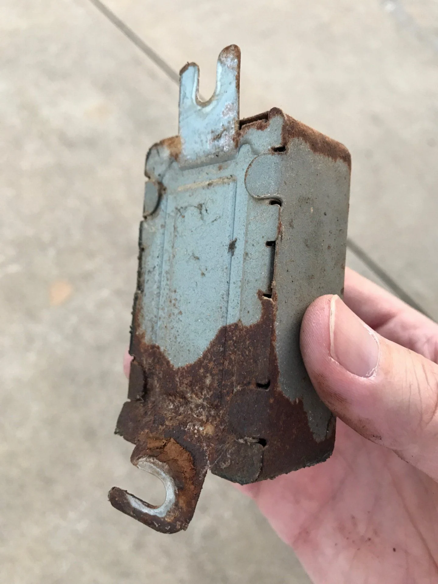

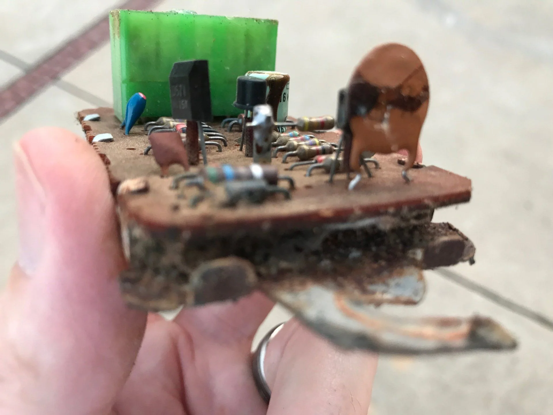

Made some progress with the sticky throttle. By this past weekend, I suspected that it might be caused by vacuum, because I could remove the hose connected to the electrical VCV on the DS fender and it would idle up to EXACTLY where it would stick when driving. Finally disconnected the emissions computer to isolate it being electrically controlled. Problem completely went away.
This little unit had been exposed to a good bit of moisture for a long period of time.
View attachment 1536851 View attachment 1536852 View attachment 1536853
Carson, the emissions "computer" controls the function of the fuel cut (idle) solenoid on the carb. Without the computer, you will want to power the fuel cut solenoid with 12v that is switched with ignition, otherwise it may stall at idle and be hard to start. On my 1980, the computer (looked just like yours) simply completed the ground circuit for the solenoid to turn it on, so all I had to do was to permanently ground that wire that came into the computer. Not certain if yours will be the same, but a quick inspection of the factory wiring diagram for your year would tell you pretty quick.
The little computers were cold soldered at the factory, and the solder joints at the terminals are notorious for cracking and causing intermittent open problems.

Thanks, Lee. Interestingly, it idles just fine with the computer gone. Maybe 1977 is wired differently; I'll check.
