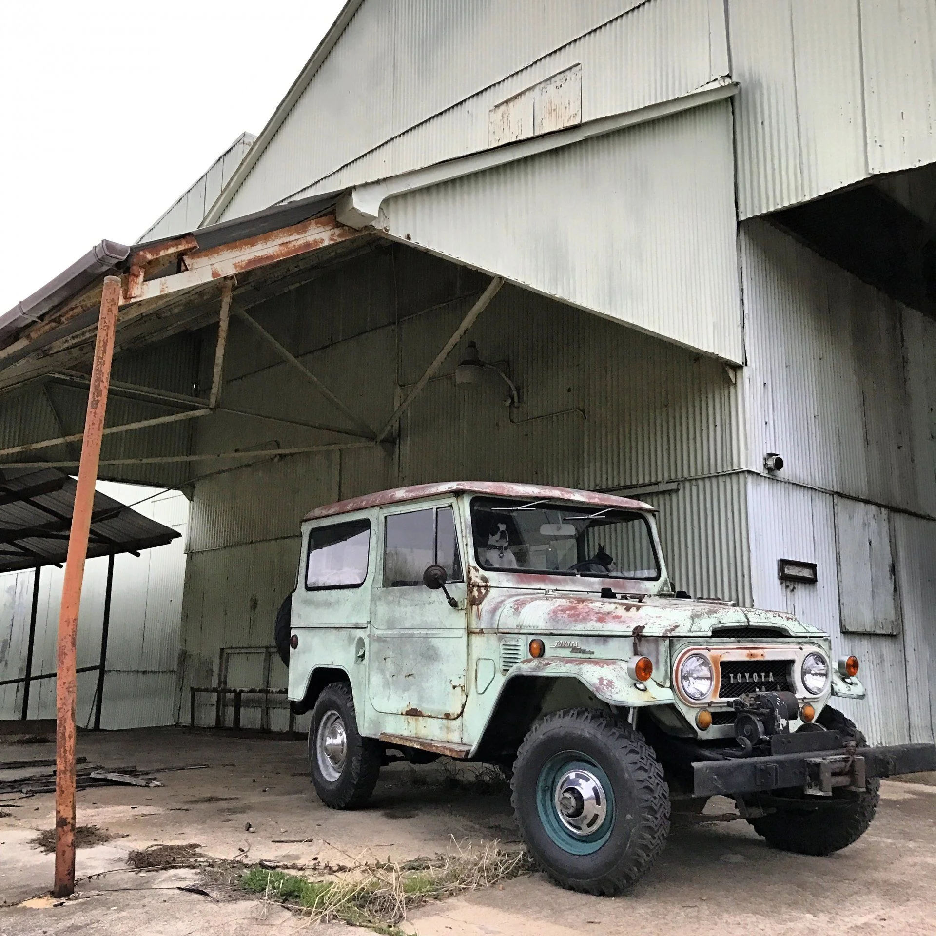

I picked up Patina today. Chris got me worked in and Rob hooked me up.
Motor. Runs awesome.
Wiring. I got a new Alternator. Rob wired it as a stand alone. Same as the DUI. So as for electronics I have a Toyota key, distributor and alternator.

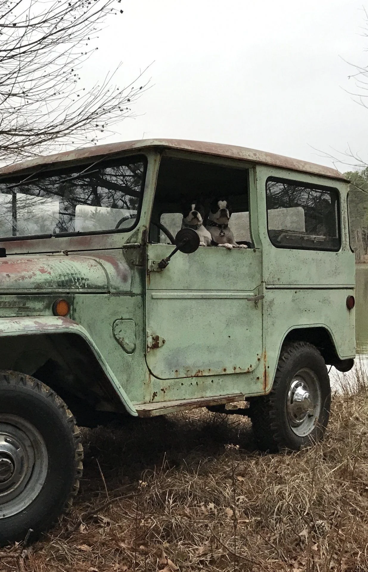

I puttered around the farm a bit
So I felt good about her and hit the road.
A fresh 2F with 30" tires moved damn good
I may have even gone a bit over the speed limit too

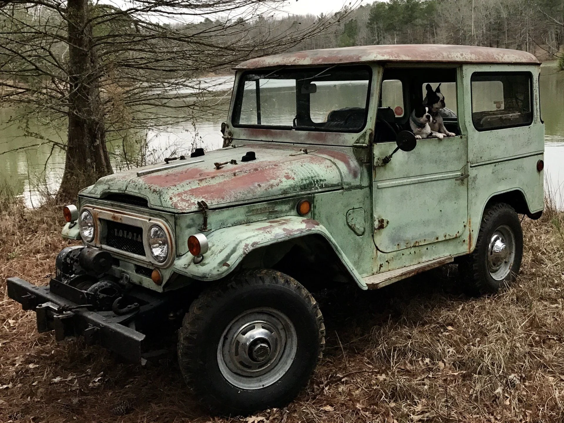

Poser shots
