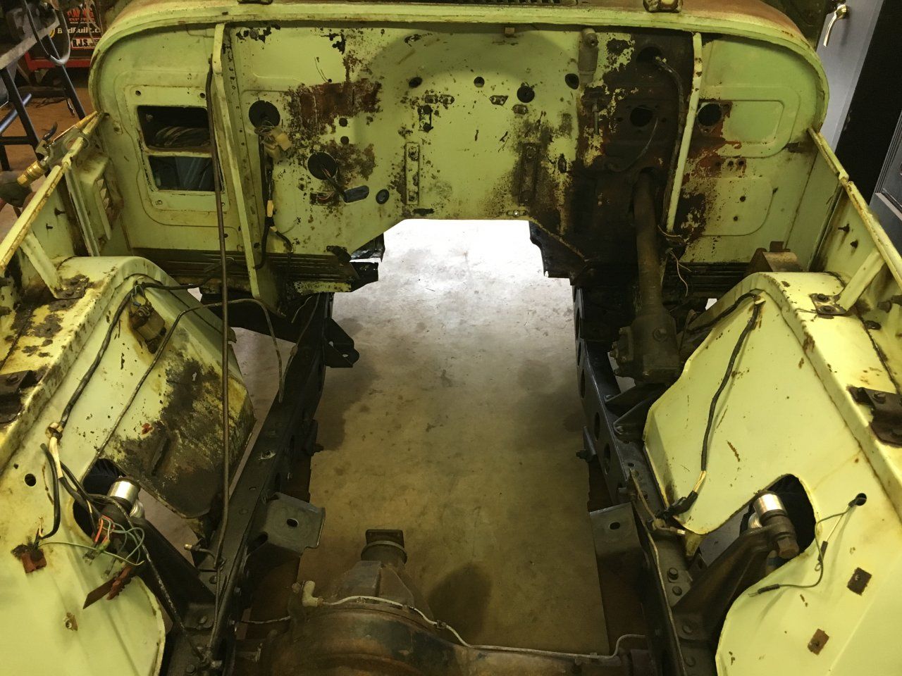

I got everything out this afternoon that is coming off to be cleaned up or tossed.
This is the final under hood pic
I spent a dumb amount of time taking the column shifter off. I ended up cutting it off in the end but I still had to remove an the hardware.
This is what the rust bullet stuff looks like after it's been applied. This was very rusted. Worst part of the truck.
All I did was pressure wash then apply the spray
Tons more to do. I've got a full day tomorrow.

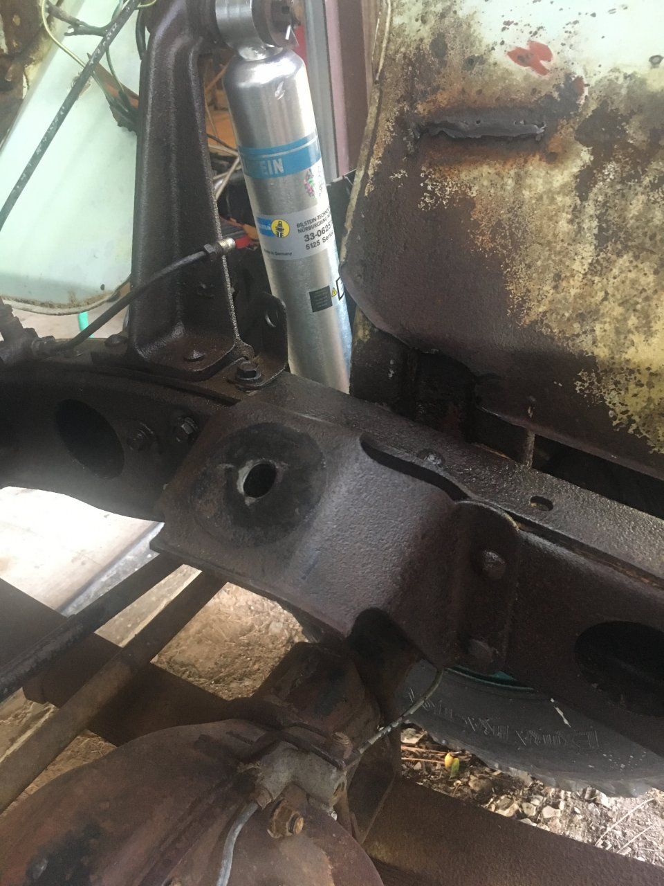

Man, this Rust restorer is the cats ass. Perfect for this project. You can see the imperfections but it puts a slight satin coat on everything.
I've done the engine compartment and about 1/4 of the frame with 2 cans.
I'm wire brushing flakes off. Hitting with air then painting.
So damn cool.
For comparison the axle and springs are still bare.

So the longer it cures the more black it looks.
Unlike paint, if you miss some dirt and spray this over it you don't get painted dirt. Just the metal that is chemically bonding turns.
It's interesting and I'm happy with the look unpainted. I'm brushing all the underside and hosing it with this stuff.
Lookin good.
It turns black on the rust. Goes on clear then the rust kill happens and it goes black.
