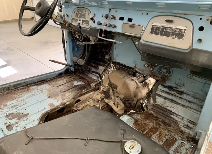

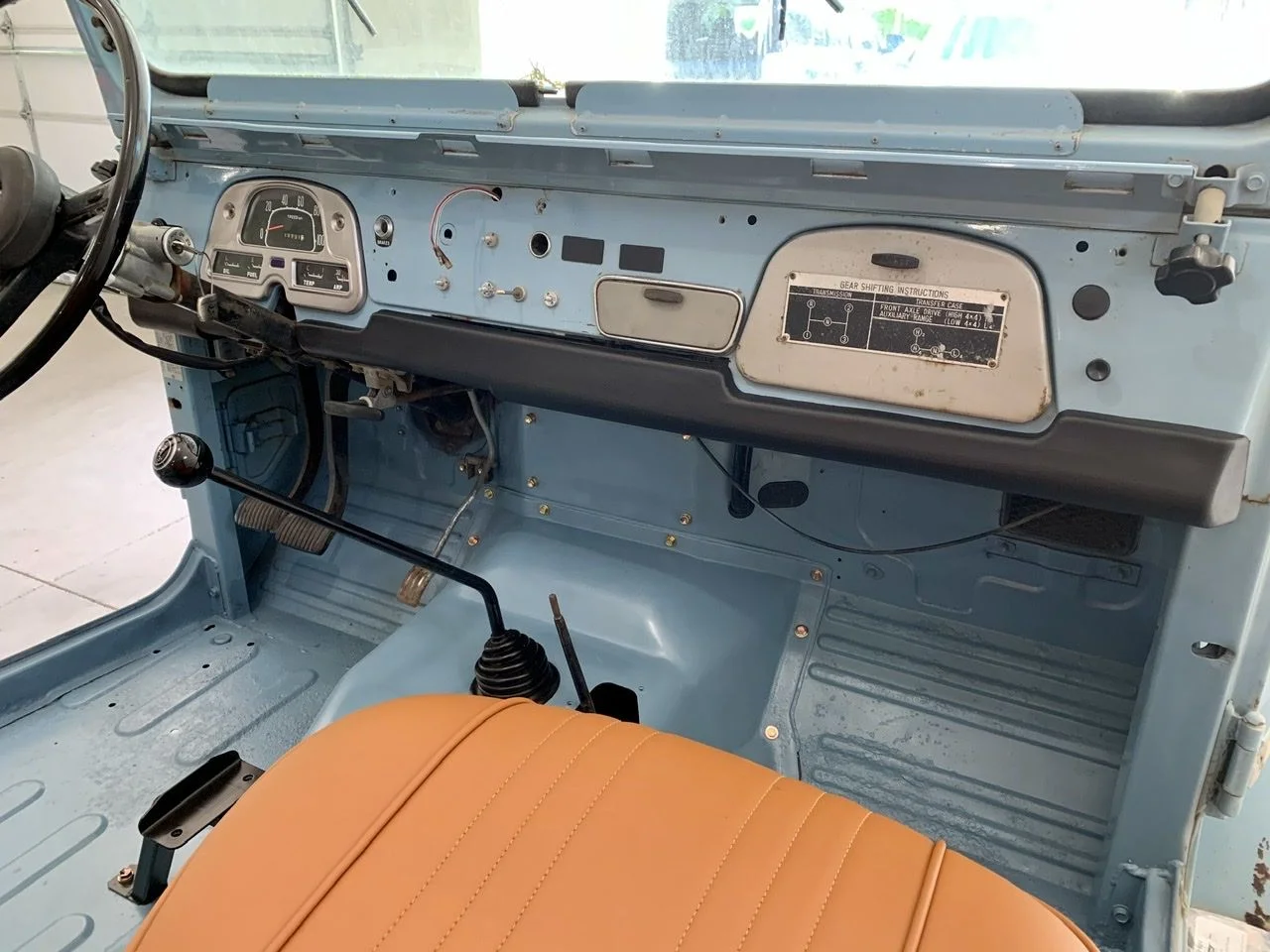

Not sure how I feel about this... the PO has cut out from the radio hole all the way to the glove box. I decided to try a pre-73 lower dash pad from FJ40dash.com @fjgoober in an attempt to cover the cut-out. It looks better, but you can still see through the top. In all seriousness, it is a top-notch repro. I’ll probably get his top dash when the time comes.

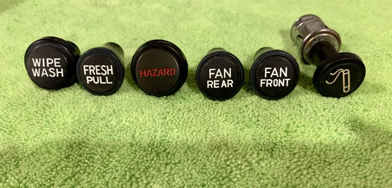

A little arts and crafts tonight. Got all my knobs refreshed and lettering re-painted, looking pretty good but not @ToyotaMatt OEM shined!
Definitely looks better with the trim but what the heck? Why did he do that? Are you skilled enough with the welder to put new metal back in? I know I couldn’t. Looking at the work you do I have a feeling it’s going to bug you unless you fix it right.

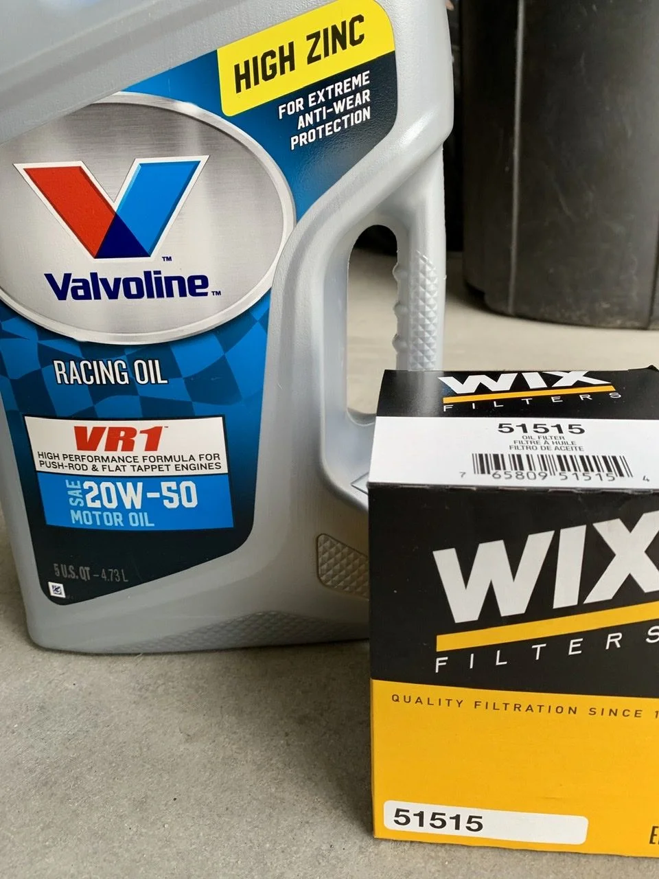

Kept it simple today, did the oil change and continued to strip the dried carpet adhesive out of the bed.
Sorry @ENDO, I didn't see your question until I re-read the quote. No, they are not new. I re-freshed the originals.
1. Chucked them up on my drill attached to a punch with the knob set screw.
2. I used Flitz plastic polish, put on a microfiber and then let the drill spin the knob in the towel.
3. I got some Testers model paint, Gloss Red and Gloss White and some fine tip brushes. Paint as best you can in the script recesses.
4. It's hard to paint in the lines, so I gently ran a paper towel over the face of the knob with model paint thinner to clean the residue paint after a min of drying.
5. Re-do any spots until you're happy with the results.
Hope that helps answer your question.
Answered perfectly thank you sir.

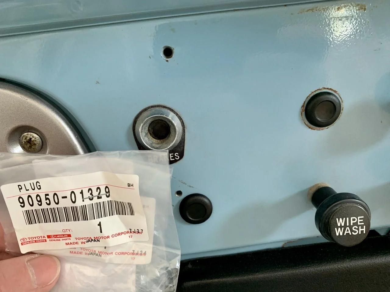

Small dash plugs still available from Toyota. Filled in missing Choke and original plug location.
90950-01329

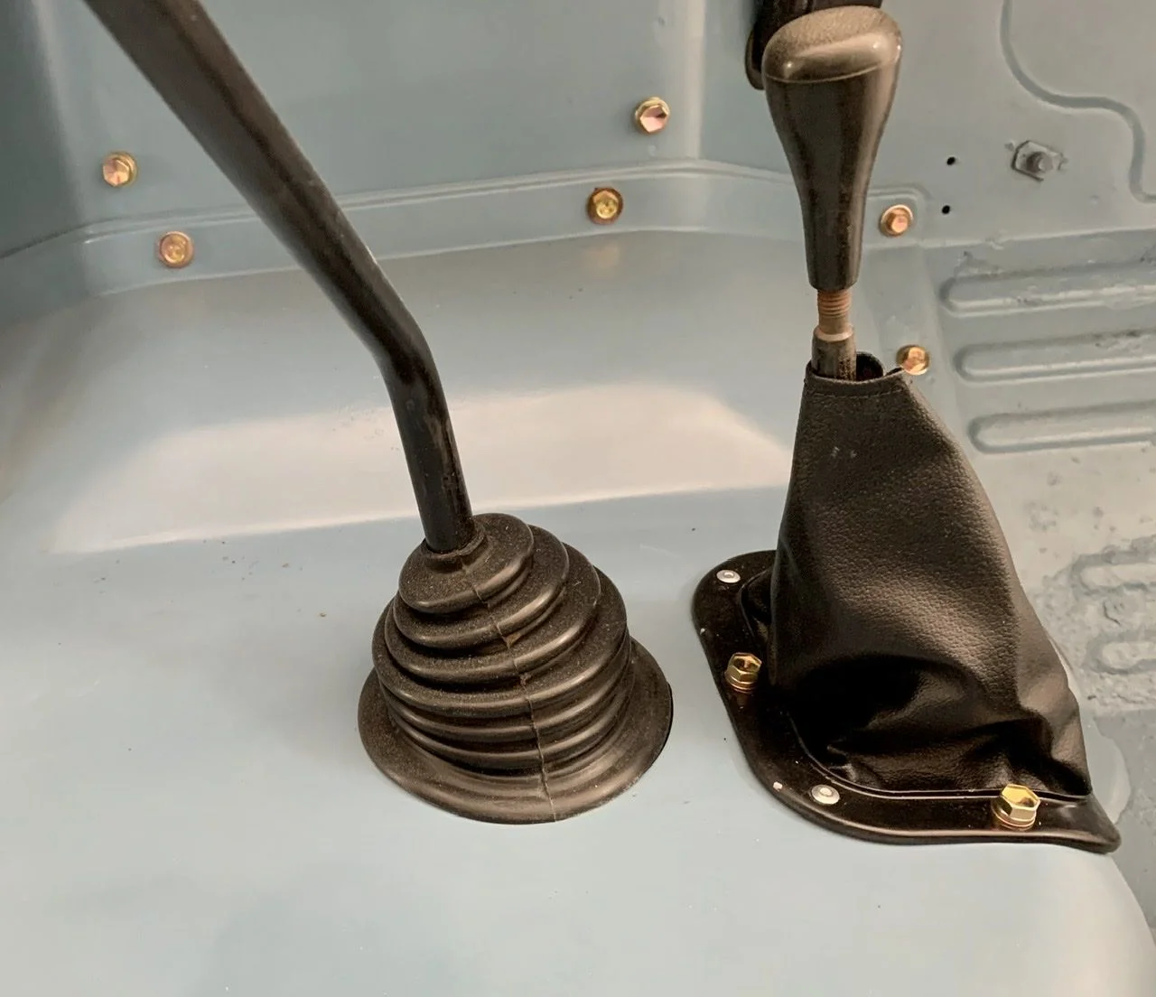

Small project today. Deconstructed my original transfer-case shift boot. ‘73 only model year exclusive. Drill out the 4 rivets holding the metal surround together then separate the bits. I cleaned up the rust and shot the metal with primer.
Next I took a new OEM 74+ Trans shifter boot assembly, still available and blew that one apart to just use the boot.
I’ll throw some black paint on next, then rivet back together.

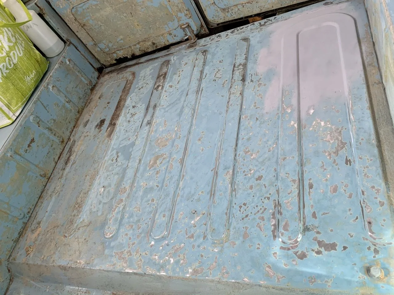

Finally got a chance to dive back into stripping the 40 year old adhesive out of the bed. Previous attempts with adhesive remover or acetone were unsuccessful. I had to get the drill and synthetic flapper discs. Took awhile, but it looks better. Just need to do the passenger side top of wheel well now. You can see the barn doors covered in it as well.

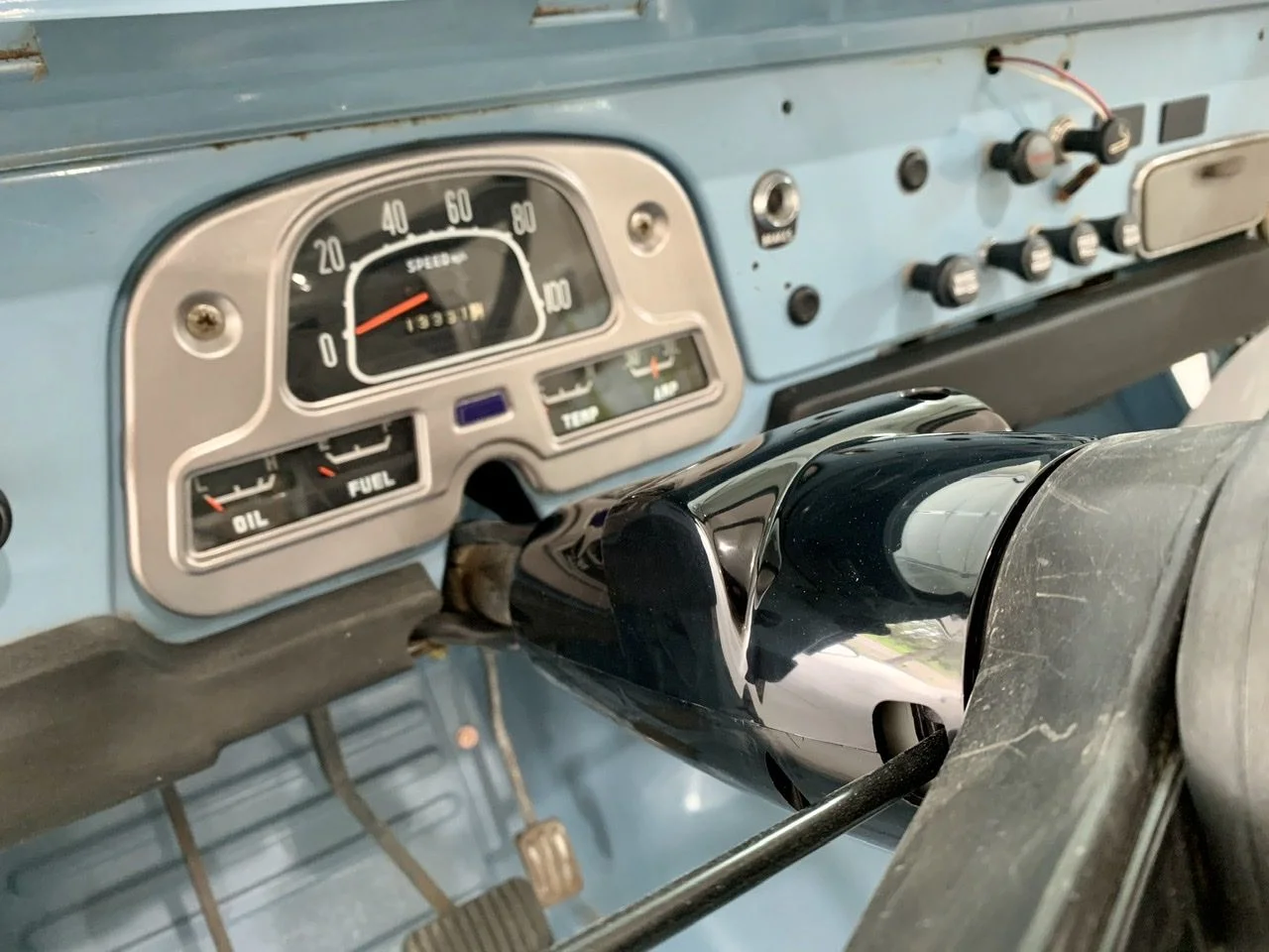

Also installed a new steering column cover. Still available from Toyota. The machine screws were M4x10 and the others were #10 pan head screws x 3/4. Definitely is shiny!
Transfer case shifter boot project complete and installed. A little mad I nicked the paint, but in the end this project is far from perfect. 🤨

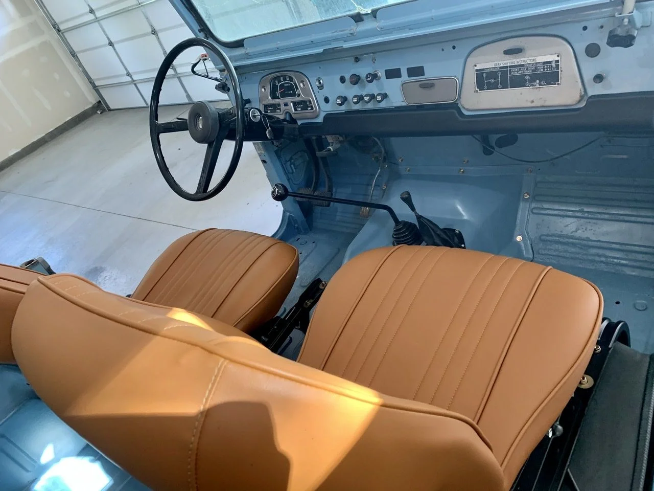

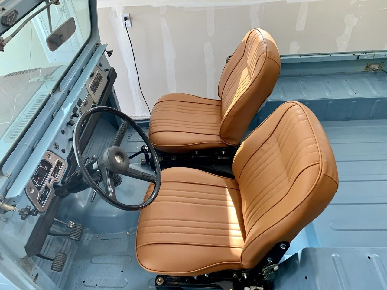

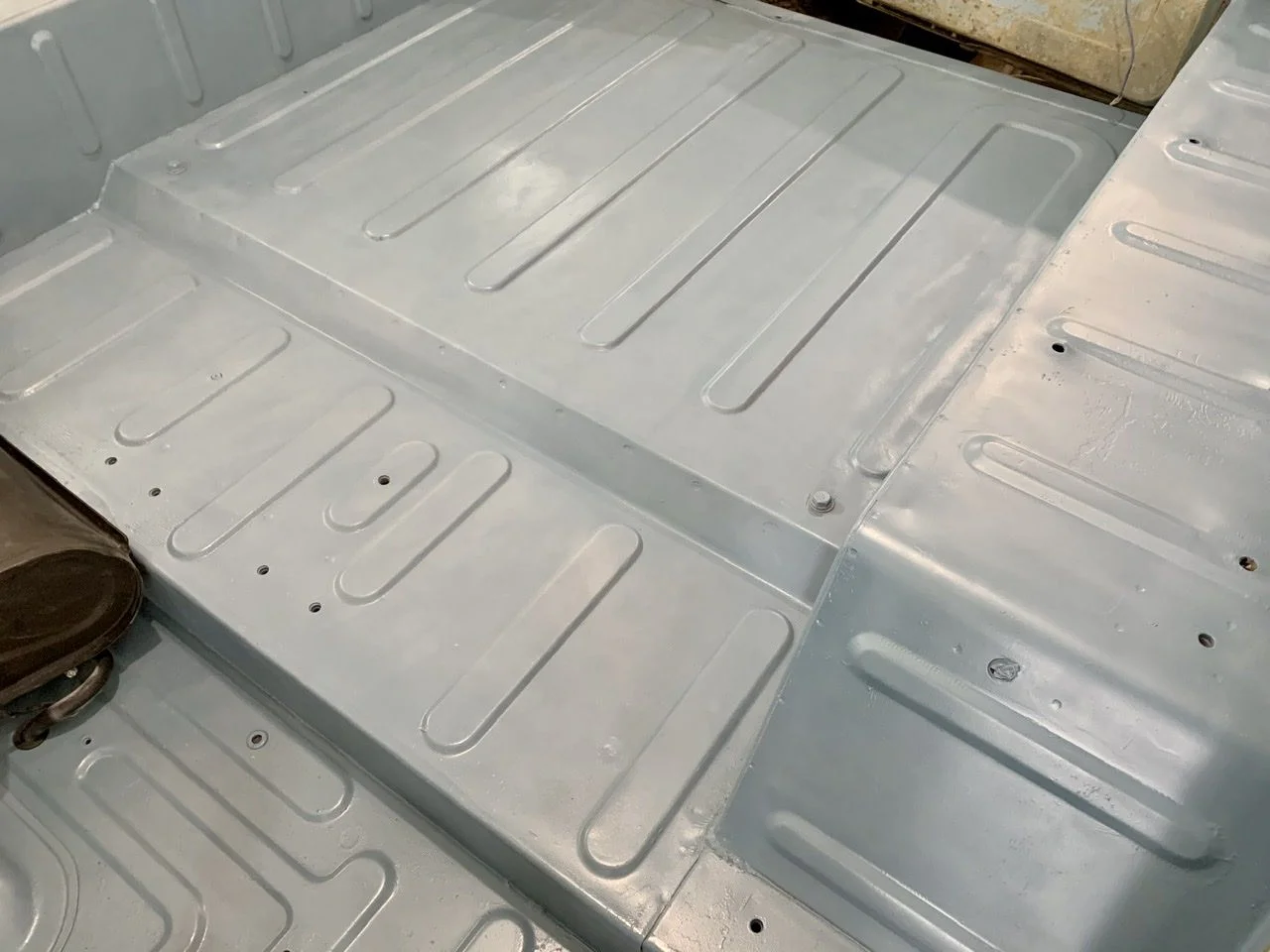

Finished up the back floors and got everything repainted. Got both front seats installed and looking pretty good. Last thing to tackle is the adhesive on the back doors. Hopefully start up is coming soon!
