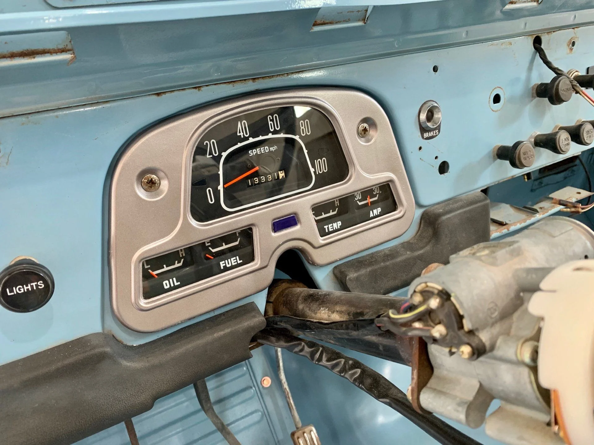

You have all the Super Rare Standard options that made a 1973 FJ40
one of the most Unique stand alone years in my opinion .........
- SKI Goggles style single back up light on drivers side
- seperate FAN FRONT and FAN REAR Switches and very very rare matching text font logo knobs !
- 1st generation Back Lit Knob headlight switch , how ever a 1 model year only
fixed knob type , NO rheostat Dimmer feature .
even more fascinating , is instead of the Bulb simply being fixed in a socket
in the rear of the switch in a solid fixed position at all times .....
a 73 headlight switch , the Bulb socket is attached further inside the swicth , to the back side of the Contacts main housing BLOCK .........
this may seam confusing TECH , but as u pull out the Knob on a 74-84 Lighted
knob headlight switch , the further away the knob face becomes from the fixed mount bulb LUMEN's , hence the TEXT FONT word LIGHTS gets dimmer or lower visible usable LUMEN's
but on a 73 only the Bulb travels along with the contacts box fixed to it and gets sucked further inside as u pull the lights knob out for park , then full headlights 2nd step ......
hence steady Bright even LUMEN's at all times ...........at all 3 knob positions
why TOYOTA ended this design feature on the 74-84 switches and opted for
a flawed minor yet significant impact change still baffles me to this day ?
why ruin a good thing and replace with a semi flawed approach ?
Again Nice score John
