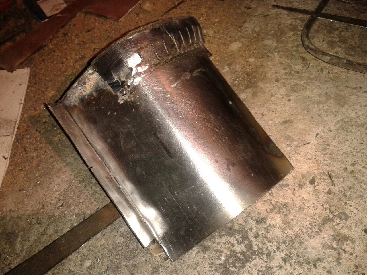

Photos for the days work...
Inner quarter panel/floor pan drop.
And the lower quarter panel wrap -under. Went with a flange/rosette weld since the existing panel was so badly warped, the seam helped hold it a little straighter. The smaller upper piece tying into the wheel well was not planned, but guess what? Found more rust the other day...so....yeah...

Which rubber are you referring to? The seam sealer or the tires? I usually don't bother if I am sure the metal is clean both sides, and that splatter is going to be minimal. Although sometimes, with the vintage steel, it just can't be perfect, so if I get welding splatter, I will throw a welding blanket, (or more likely one of my old leather jackets) over anything that needs protection.
I was talking about tire rebuilt yet my DS rear rocker and fender flare, Iguess you removed the sealer . I repaired it a completely different way than you. I build a solid piece including rocker, back of the rocker and fender lip, adjusted then welded. my way was less OEM style.
