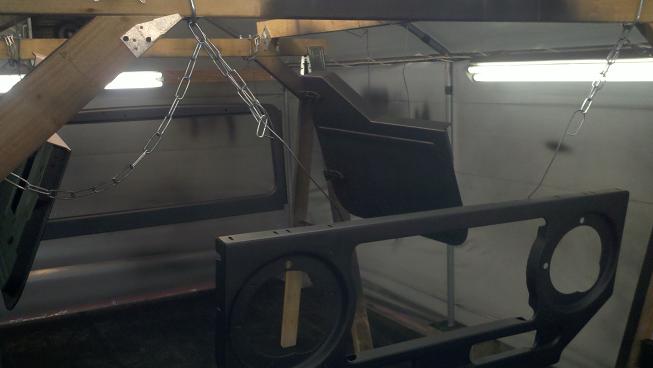

Finished the body work on a few body parts and put them back into the booth. Laid down a coat of DP90 and few coats of primer filler. Now they are ready for blocking and wet sanding.

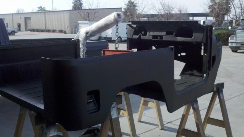

I fitted the barn doors with new hardware and prepped then for paint. Next I added some 3M seam sealer to the one remaining seam I had left. It’s finally ready for some color!
Day 97
Prepped the tub top and bottom for bed liner (Upol Raptor black) before I painted. I thought it would be safer and easer this way. Then I placed The tub into the booth and taped everything off. It’s time for some primer sealer!
