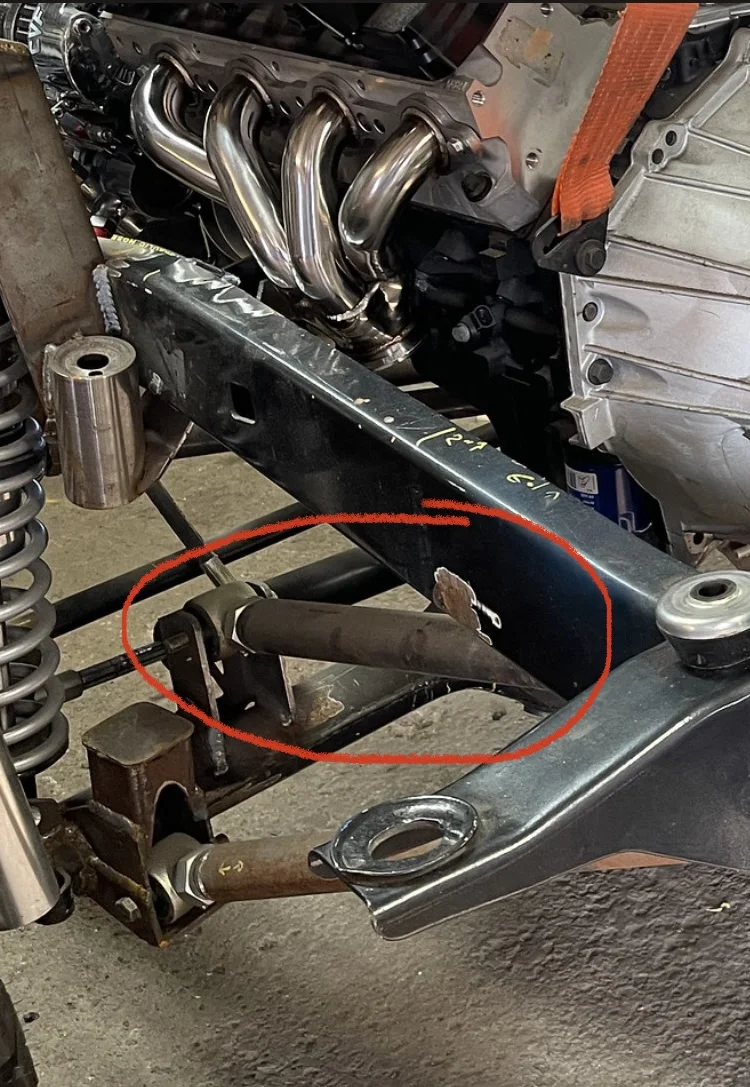

Some updates guys .... definitely getting there
Stainless exhaust parts coming next
Custom fab on front/rear sway bars ... waiting on parts
Engine SET in position now as far back as we can
Rear bumper almost done
Front bumper extensions under way
Sorting out the exact position of the twin sticks

Through the frame sway bar for the win! Pretty sweet idea! Looking forward to seeing how that works out!
