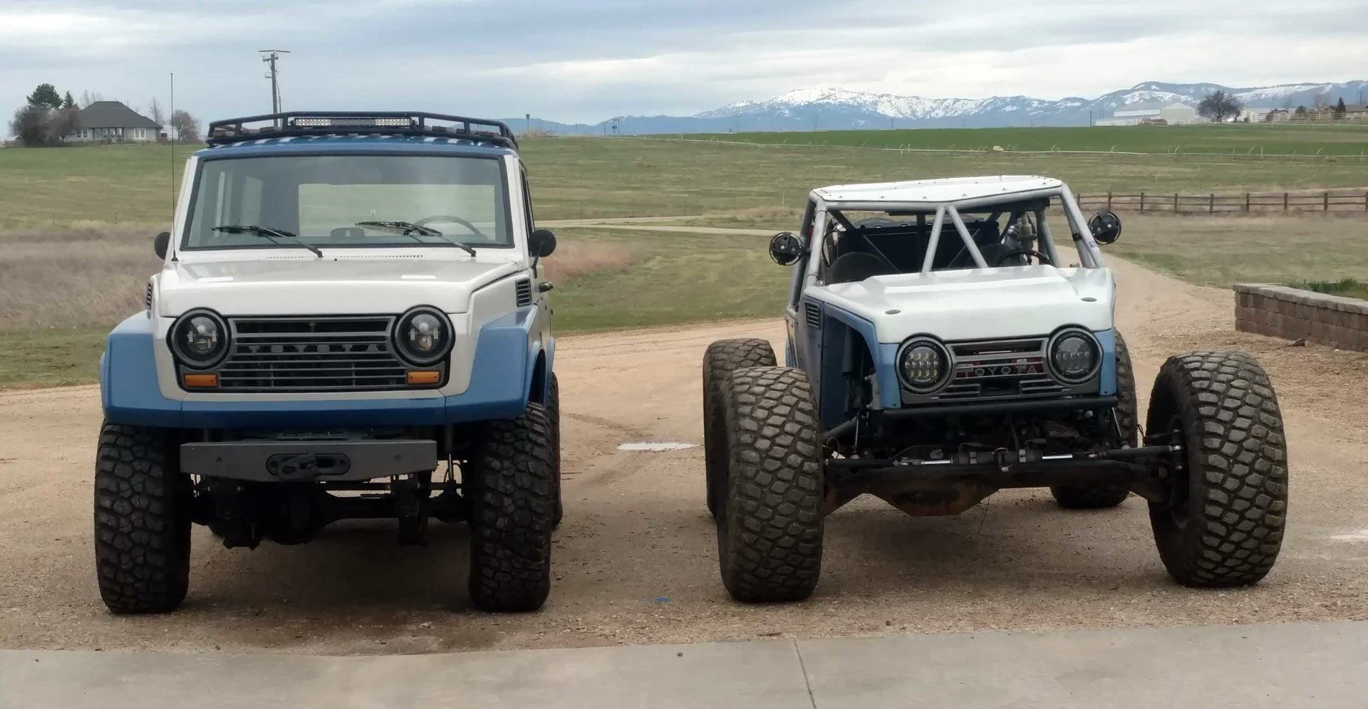

Most all the manufactures will build you an axle to fit your pig, most mention are based on the Dana design.
I would use a custom housing based on the Ford 9" as it looks most like the Toyota housing and make your pig look less like a jeep.
I uses these in one of my pigs, Signature Series Front Housing
I also like the fact they look 'custom'
You can see the size difference here.
