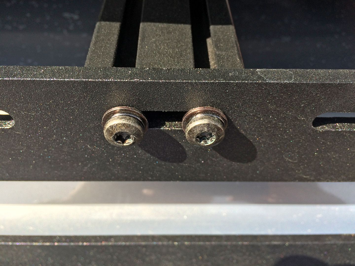

This is the best solution for hardware I have found. It is a black zinc finish. Essentially the same thing as normal zinc plated but with a darker coloring. Due to the weight and size of the machine screws they get a more tumbled look than the smooth washers and lock washers but that is my only complaint. Aside from powdercoating the screws or painting them this is the next best thing.

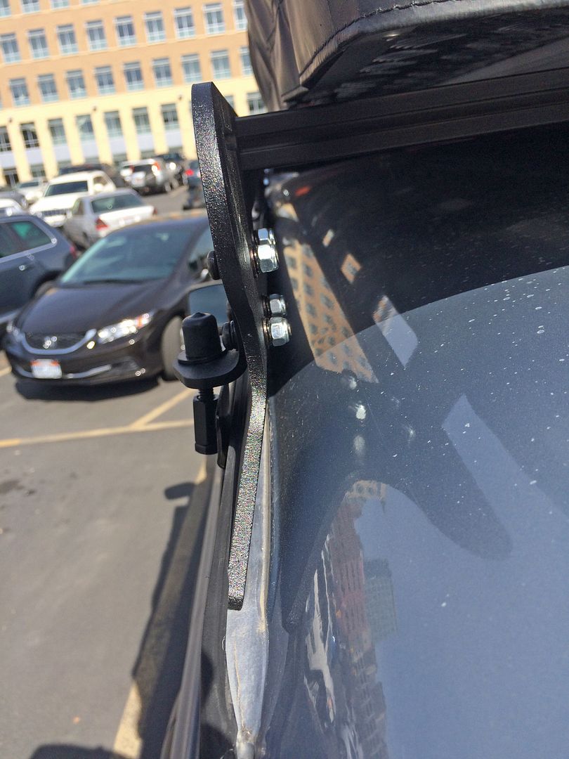

I snapped a few more photos. Only had my cell phone so there's not quite the quality of the earlier ones but should help with some questions.

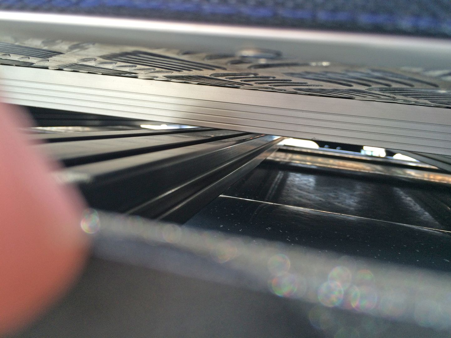

Clearance under the crossbars. Approx 1" . Little hard to see since my tent is on the rack.
Black Zinc hardware. Fender washer + lock washer

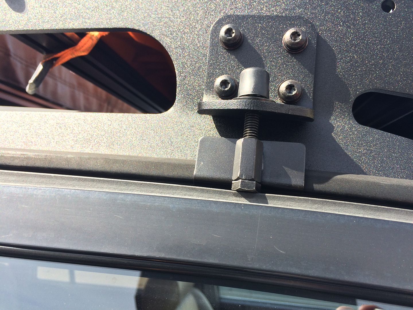

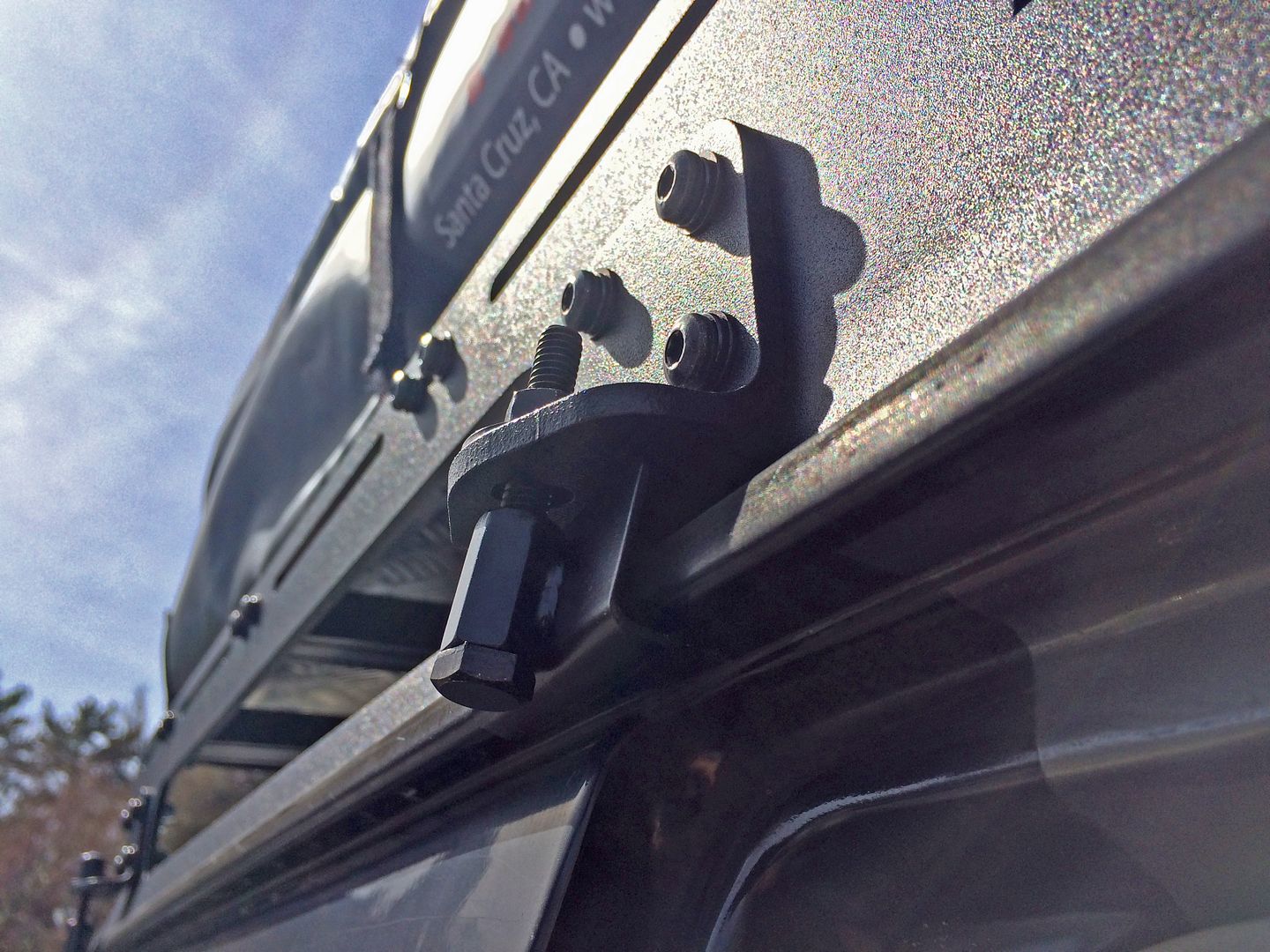

Feet bracket shows how it curves under the gutter

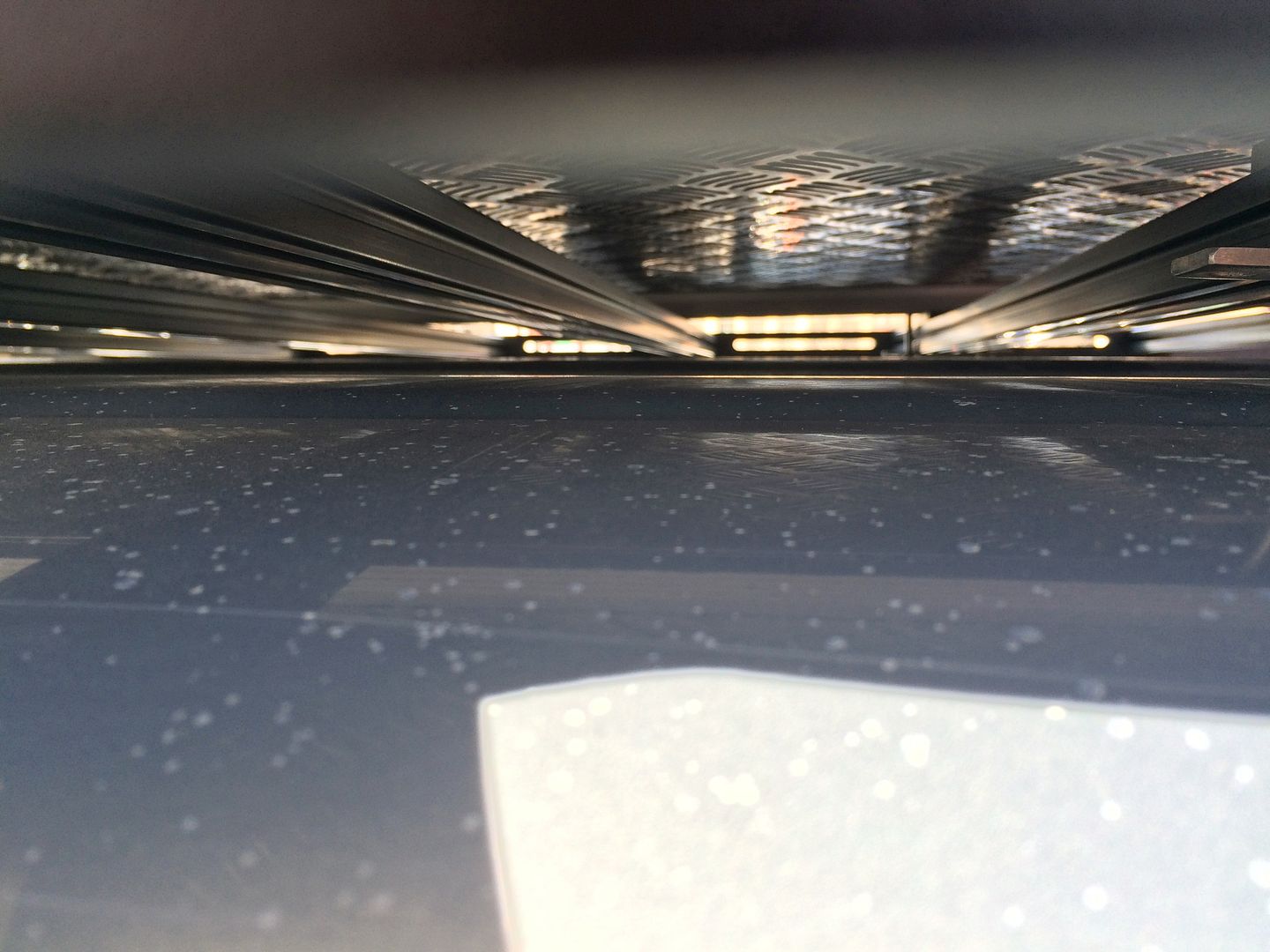

From the rear, rain gutter clearance. Should still allow rainwater to flow out normally.
rain gutter from the front

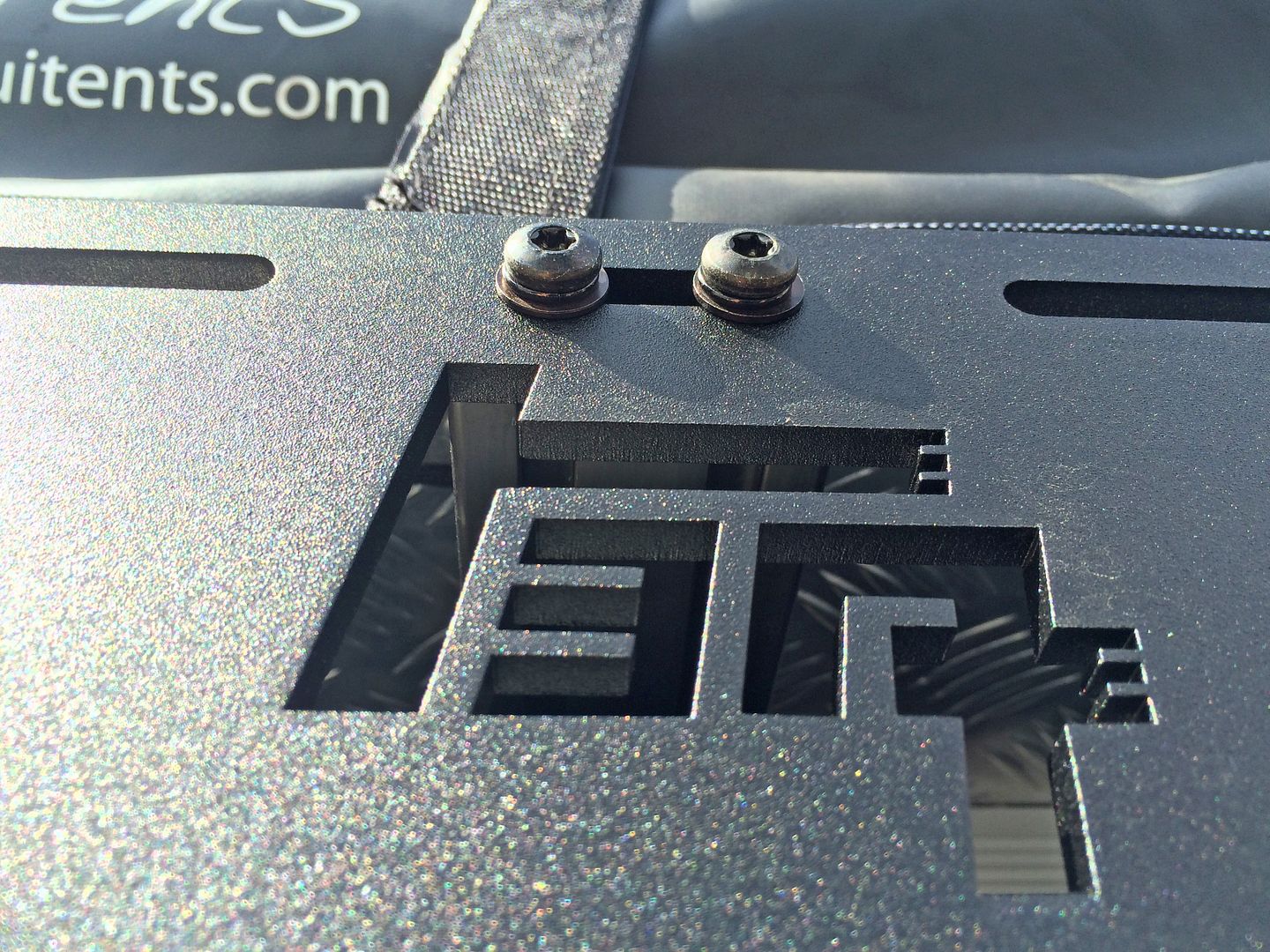

textured powder coat and zinc hardware

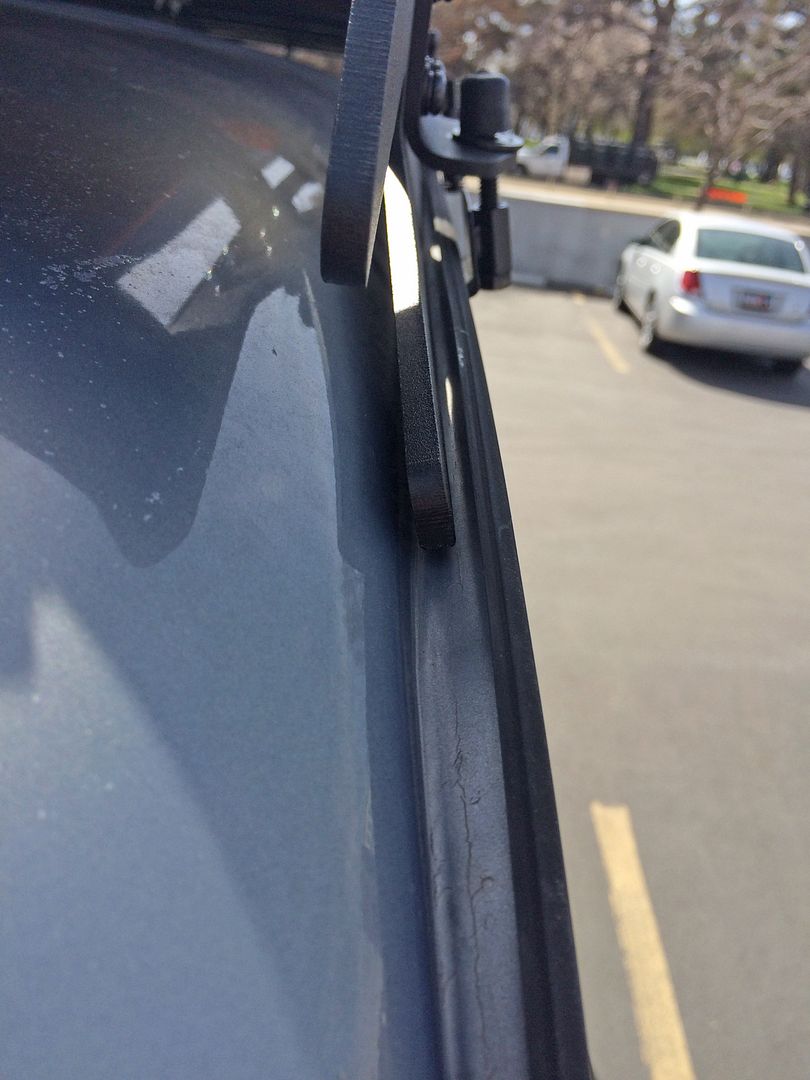

bolt head clearance at the front door. The rest are a non issue.

How the angle of the 1/4" bent aluminum "foot" was angled to meet the angle of the drip rail. Since there is an angle introduced I was quietly considering how the bottom of the rack's feet and the drip rail mated. Were they flat to flat or pointed bottom from angled foot to flat of the drip rail? I was just waiting for more pics but your last batch answered that.
Basically I wanted maximum material contact between the rack's long mounting wing and the drip rail. Thats all.
