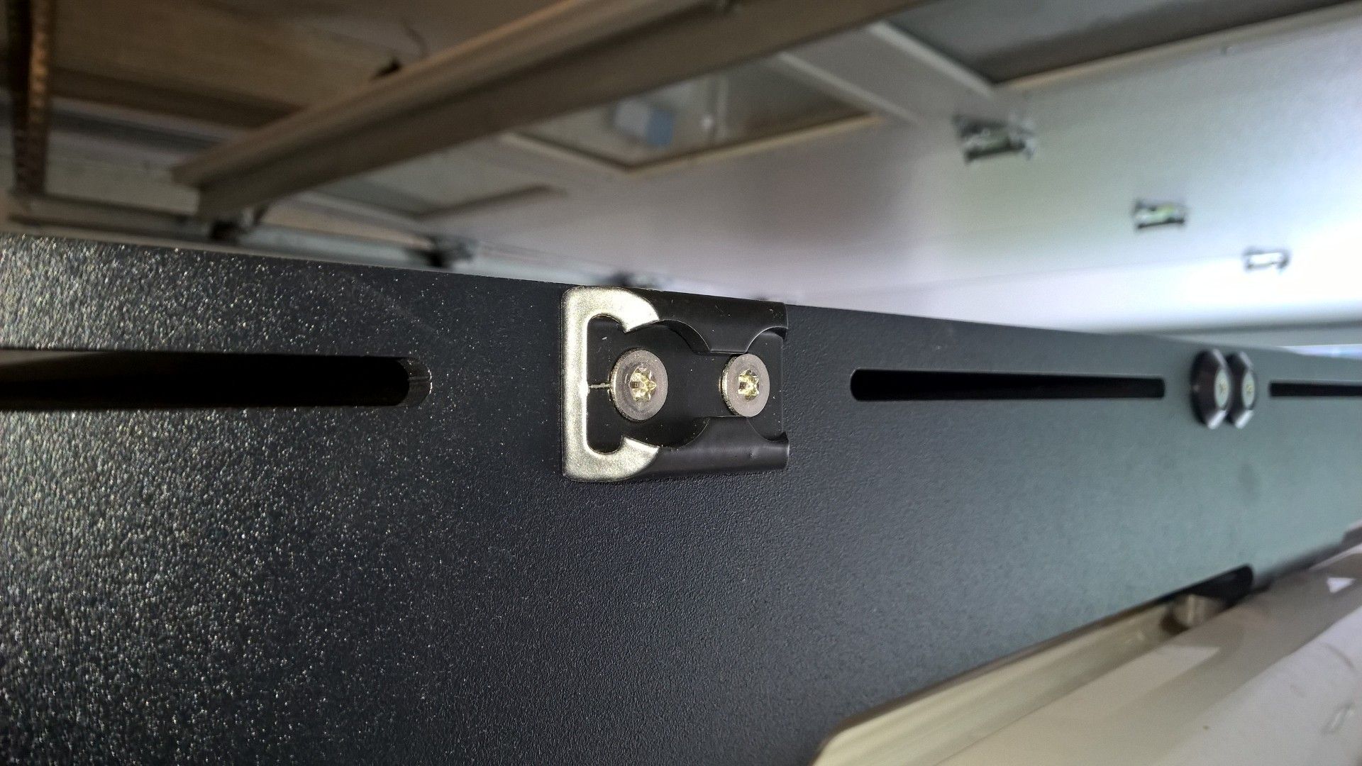

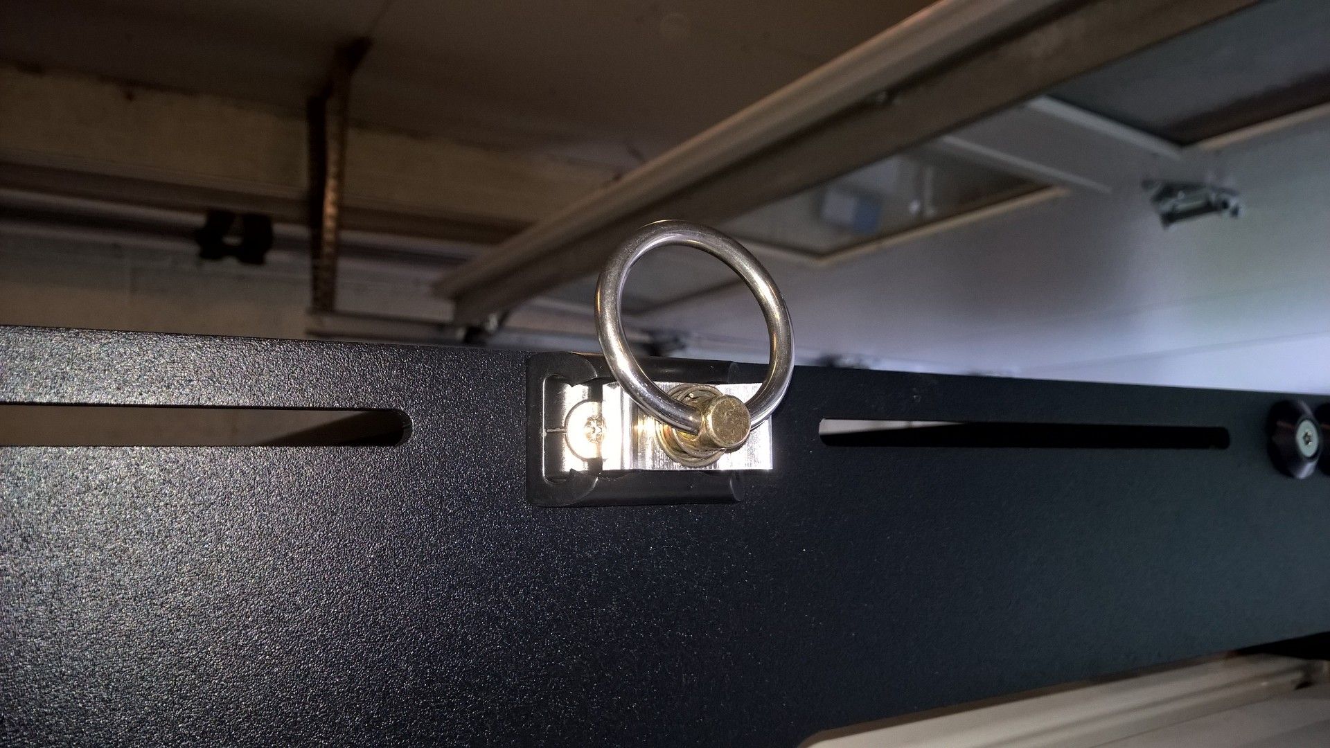

These little beauties from US Cargo Control arrived today, thanks to @619TOY for the great idea.
Installed on the side rails, using the bolts for the cross-bars, to put the rings on the outside of the rack.
I did confirm with USCC that the rings would hold a load from multiple angles. The idea was to be able to utilize the full floor of the rack for large loads, i.e. drywall etc. The Prinsu rack for the 200 measures 48.5" wide, and the supplied rings use up some of that.

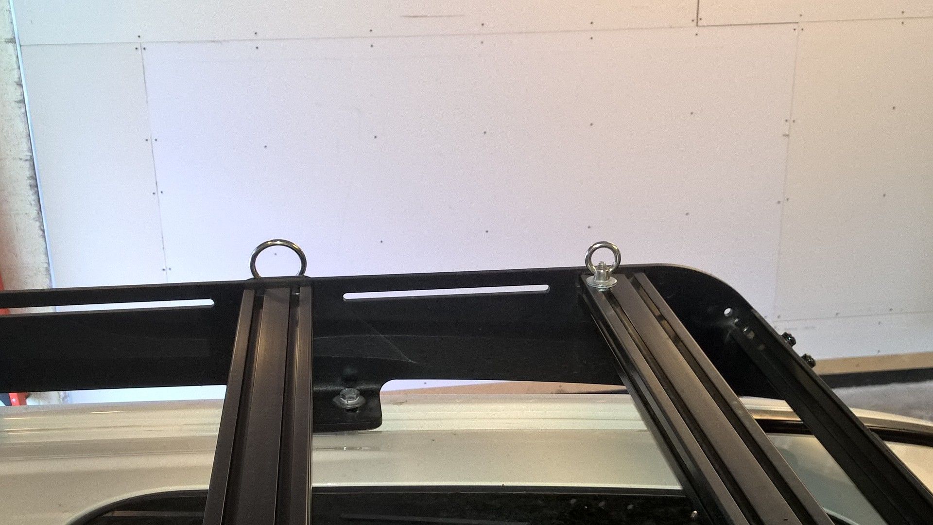

Personally, I'd recommend choosing the quantity of tie down brackets and rings that you want, not what the kit dictates. Plus, I don't think the rounds look quite as good. FWIW I mounted two on every crossbar (one driver and one passenger) and an equal amount of rings. I've never needed close to that many, but I like the versatility they provide. You could probably get by with less:D

What @619TOY said is true, but another issue is the hardware needed. The kit's hardware is not for the 80/20 cross bars, that needs to be sourced separately.
Ah, because the hole spacing isn’t the same as the channels on the 80/20.....
So where did you source them if I may ask....and thanks in advance!:cheers:
Hole spacing is actually on, but the "nut" portion needs to fit in the 80/20 channel. 80/20 sells all of this, and @619TOY also many threads ago linked to where he got some hardware. I ordered a few of several styles of t-channel nuts to see what worked best.
