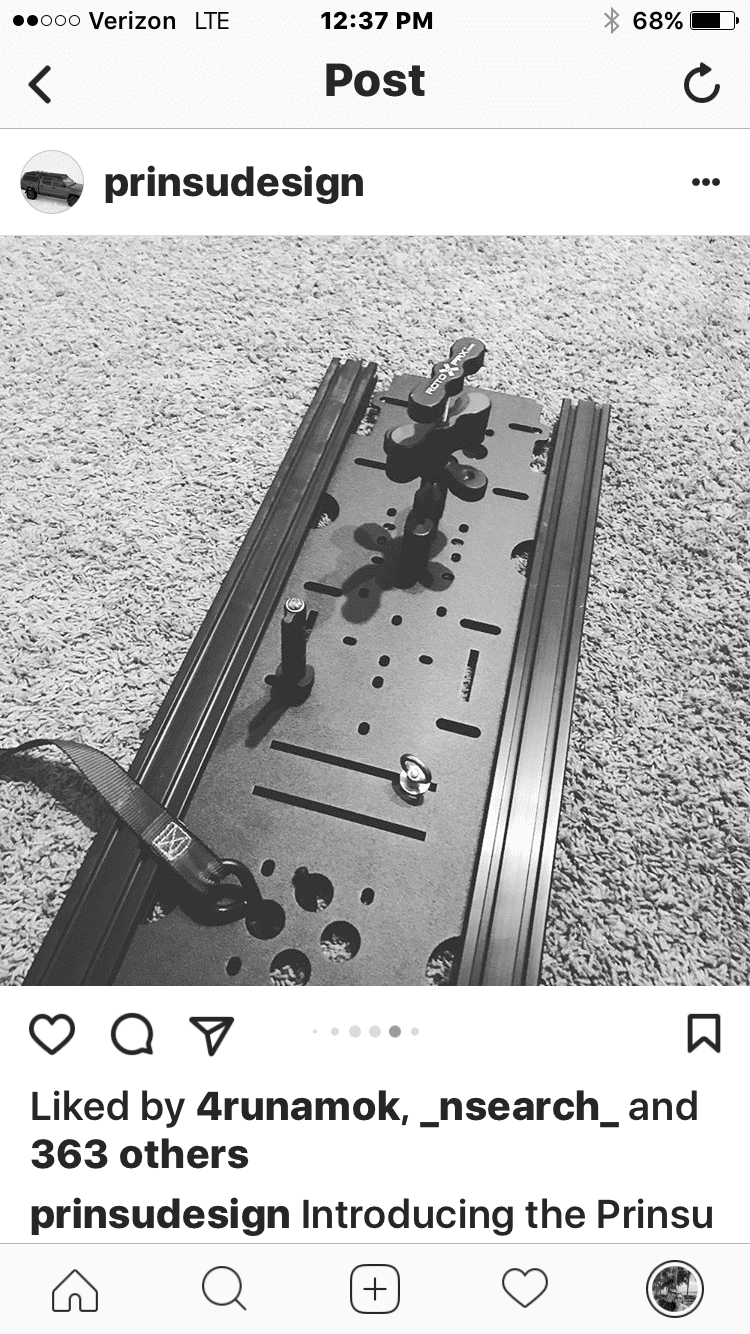

And they're introducing a plate mounting system to mount just about anything
