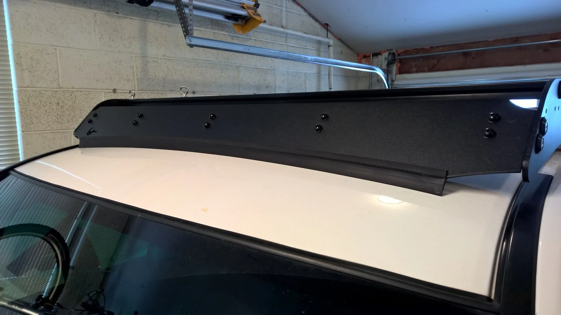

don't know if it is entirely necessary, but I wanted to eliminate as much wind noise as possible, so I added weather stripping to the bottom of the wind dam.
Vertical Bulb Trim Seal Bulb Diameter: 0.5" Grip range: 0.039" to 0.14" | Trunk, boot, lid, hood, hatch rubber (10 Feet) - - Amazon.com
I was concerned about the weather strip rubbing on the paint, so I also got a small strip of 3M clear protectant film:
Amazon.com: 3M Clear Bra Paint Protection Bulk Film Roll 2"-by-60"-inches: Automotive
I haven't seen any issues with the weather strip yet, still need to get off my butt and add the 3M.
I did have some wind noise/vibration above 30mph. It sounded like it was coming from the fairing, so I tried opening the sunroof while moving to see if I could confirm that. When the sunroof was opened the noise/vibration disappeared. The noise/vibration would go away also when I used the sunroof's tilt mode.
My fairing was already in the lowest position on the side rails, and I was not willing to drill new mounting points as others had. The edges of the fairing were already at the forward edges of the side rails, aesthetically I didn't want it protruding beyond. I used packing tape to fill the void between the roof and the fairing, even at highway speeds no more noise/vibration.
I tried sourcing the "noise reducing edge trim" from Prinsu, but I ended up getting weather stripping from a local specialty automotive store. They had at least a dozen choices, and I was able to select what I thought would work best. So far no issues.

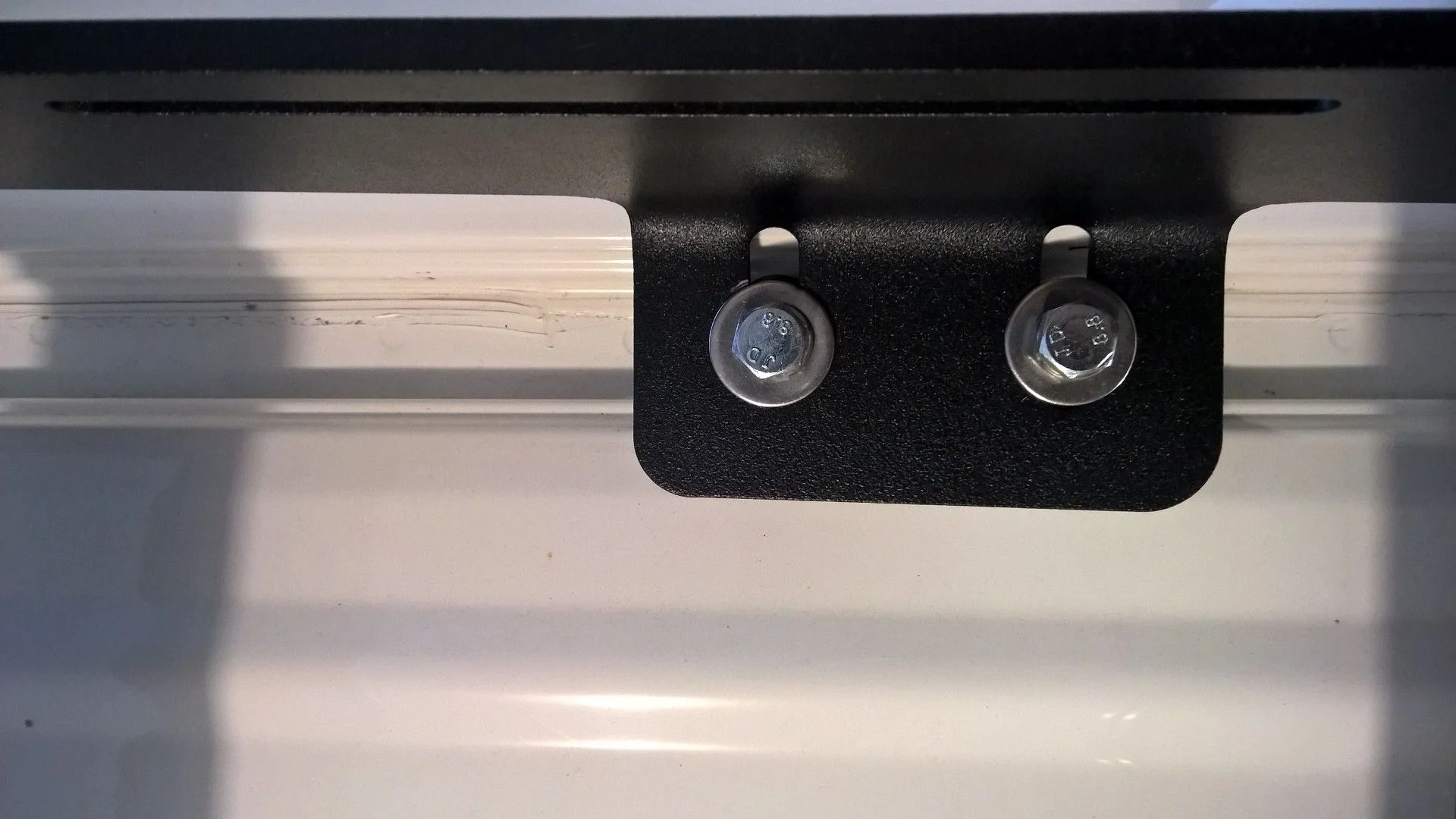

Yossarian, what size is the mounting hardware you used on your rack back in post 26? I think it classes up an already classy rack. I am expecting my rack to be delivered in the next week or so and would like to have all the parts ready for assembly... thanks!
Here you go, took me a while to look it all up again. I copied what another did on their rack on the Tacomaworld forum.
The screws I got at tamperproof.com
The washers I got from jegs.com, p/n ALL18663
From Zach in another post on TW, "Yes, 1/4"-20. Holes are typically only tapped to a depth of about 1.25" so plan accordingly if you are getting new hardware. 1" length works the best"
Hope that helps.

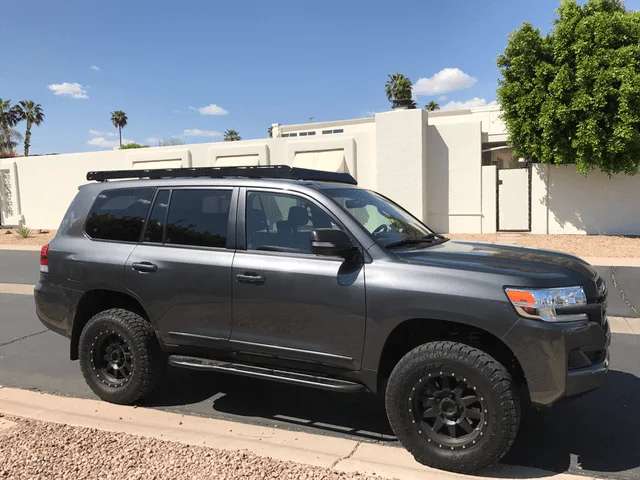

Can you give us a couple of overall vehicle shots with the rack?
