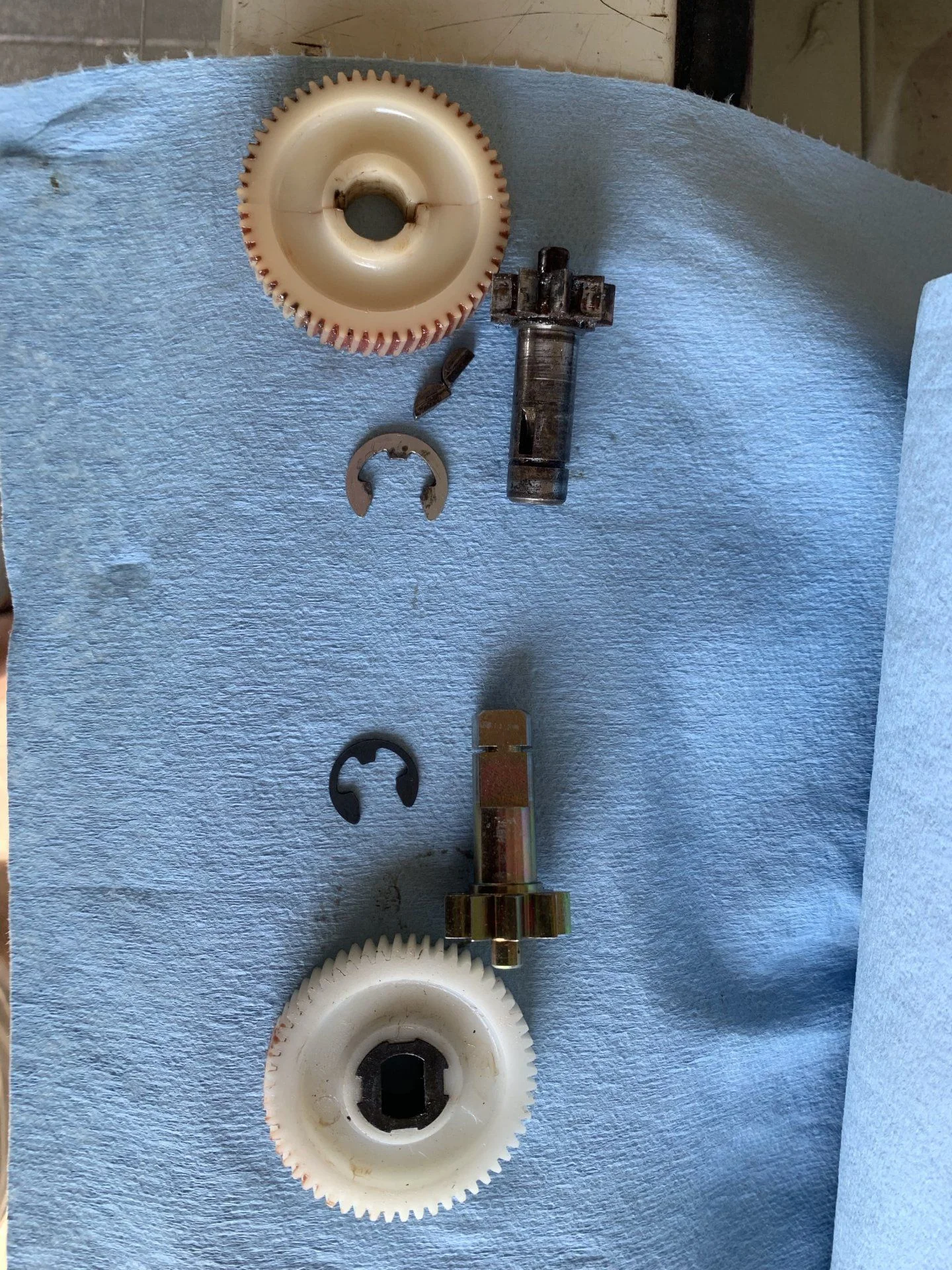

We still need to know which shaft type is being printed. There are two that were used. Can you let us know? Thanks.
Not the greatest photo but here are the two types side by side.

Regarding the existing model it has the slot type hole.
If you need the other I could model that and print it for you. I'd just need accurate dimensions on the hole required to model it.

Do you know what the difference is? I assume production year.
Hello @WarDamnEagle,
The top one came out of my '77 but there is no way to tell if it was the original gear. My guess is that it was original but difficult to confirm. Toyota sold the replacement gears with the mating shaft so as long as you have the matching shaft the sets are interchangeable. I have managed to buy two NOS OEM gears with matching shafts and both were of the lower type in the photo.
My educated guess is they started with the top design and went to the bottom design at some point due to the failures. Not 100% certain that assumption is correct and I wouldn't begin to know when they changed over; again, assuming that theory is correct.

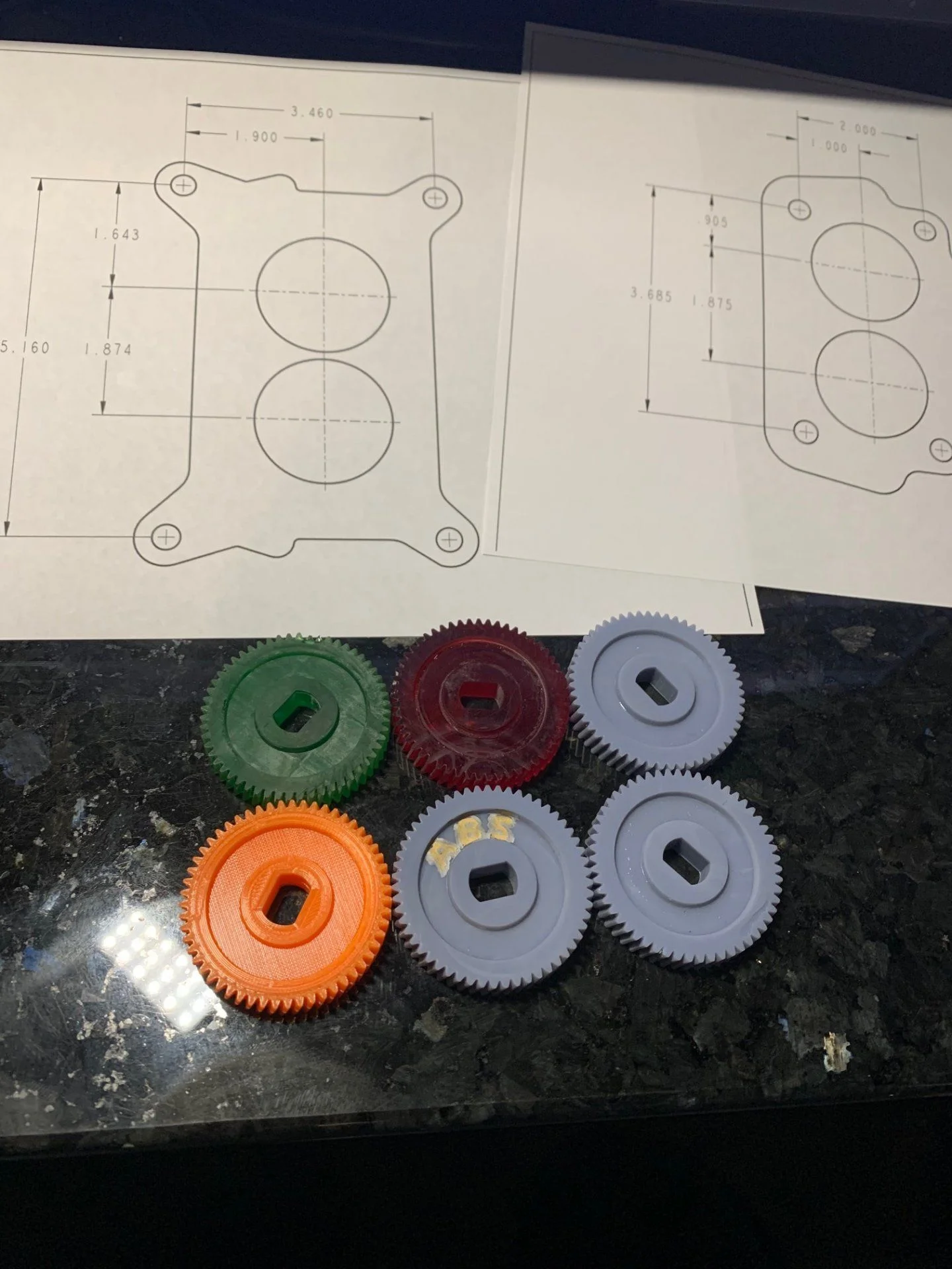

All of the files I've seen for the 3D printed gears are for the D shaft with the two flats.
I have one being printed now and will test it here later this month.
