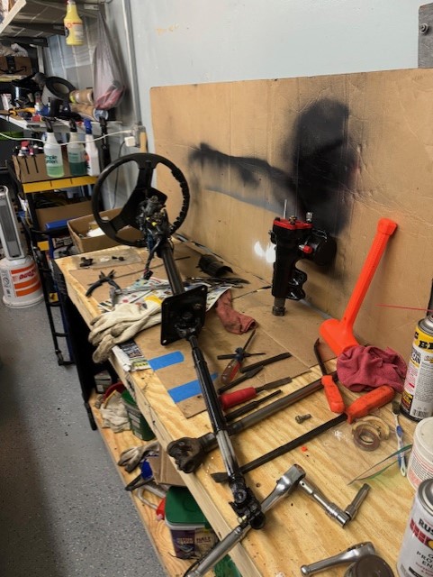

“I had no idea a 60 could steer so well.” That’s what I thought as I returned from my shakedown run after getting all the air bubbles out of the steering system after reinstalling the steering gear box. Admittedly, the old box was leaking pretty bad and the adjustment screw had been maxed out, I guess I was just used to the sloppy steering maybe after driving it for so many years. It drives so nice now; it's well-mannered and even holds the line when you let go of the wheel for a second (that was not an advisable course of action prior). Big thanks to Chris @Jakes40 for the assist with the replacement inner shaft yoke. :).

I highly recommend rebuilding your leaky, wandering, steering gear box. I had redhead steering do mine.

Excellent! I just got a spare box for mine yesterday from a forum member, may just send that and the 105 sector kit to RedHead and have it done right!
Look in to Blue Top steering gears as well. The story goes it was started by former Redhead guys who split off when Redhead QA allegedly went down hill. I went with Blue Top for my 2500 Suburban gear box. It also helped they were cheaper than Redhead.

Id be wary of Redhead rebuilds on an 80 steering box. We got three in a row with the same leak. After shipping them back and forth for them to fix it, they finally just sent us a new box. They all leaked from the adjusting bolt on top. I even tried new Toyota seals on there and no luck. I'm guessing the teflon rings inside were either knicked or sized wrong.
^Any recommendations besides Redhead? I have 40 PS box that I’d like to get rebuilt?
West Texas Off-road is talked about a lot in the 40 forum.
Ugh, good to know...may need to check out Blue Top or just bite the bullet and try to do it myself. I got a quote back quickly from Redhead for $556 plus tax/shipping and an extra $110 for additional ports if I want them. This is with my OEM spare box and 105 kit plus a spare gasket kit. Honestly, this is not a priority item for me, just a "beef it up" option from parts that I collected in anticipation.

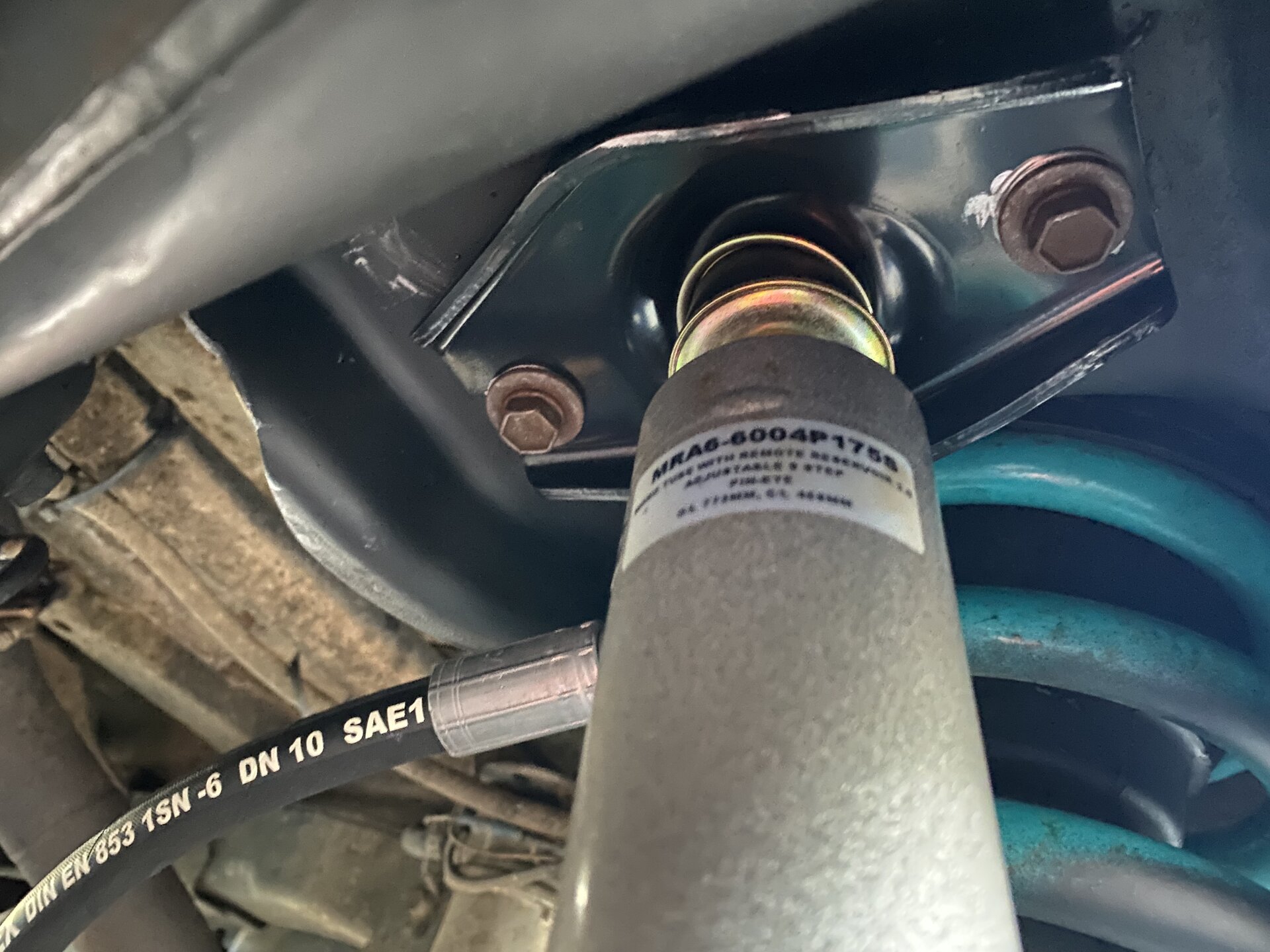

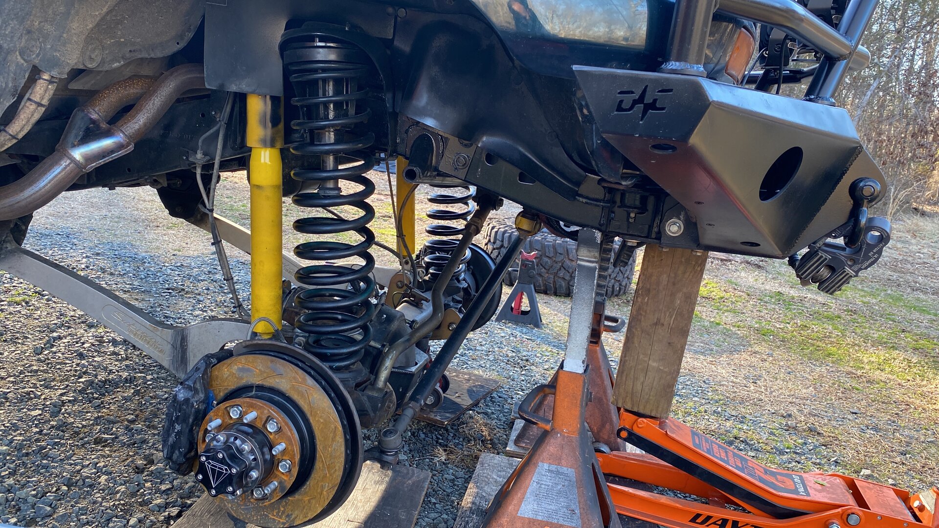

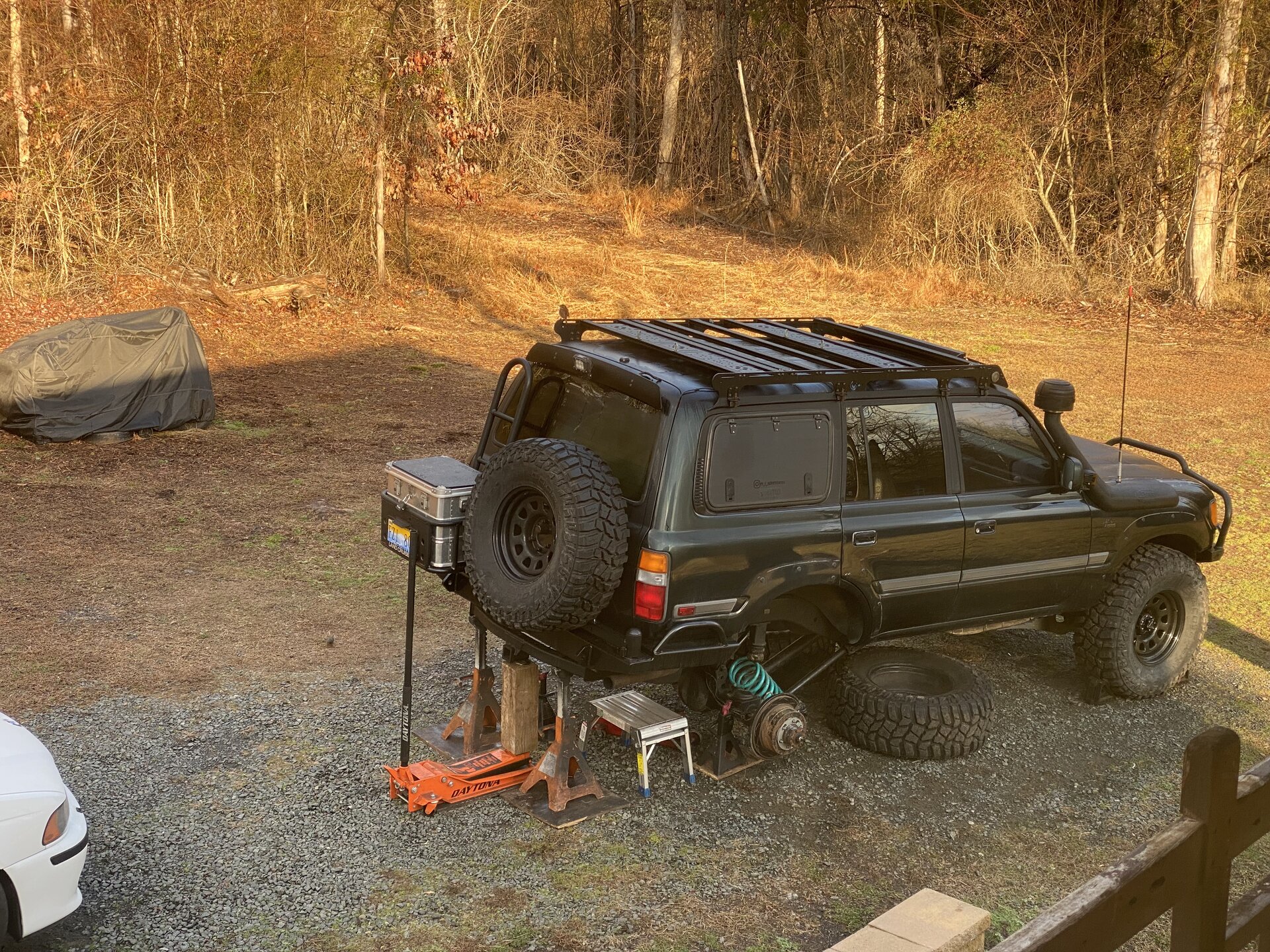

Well, nothing like death wobble to instigate a near complete front end rebuild…
New TREs, track bar bushings, front hubs, bearings, and flanges. Wheels balanced and alignment done. Wobble better but still there between 40-45mph. On to shocks, steering dampener/stabilizer, and reinstalling front sway-bar. And it’s not the driveshaft, that’s been pulled and wobble still there; DS eliminated as culprit. Fun times! Oh and replacing rear shocks while I’m at it.
