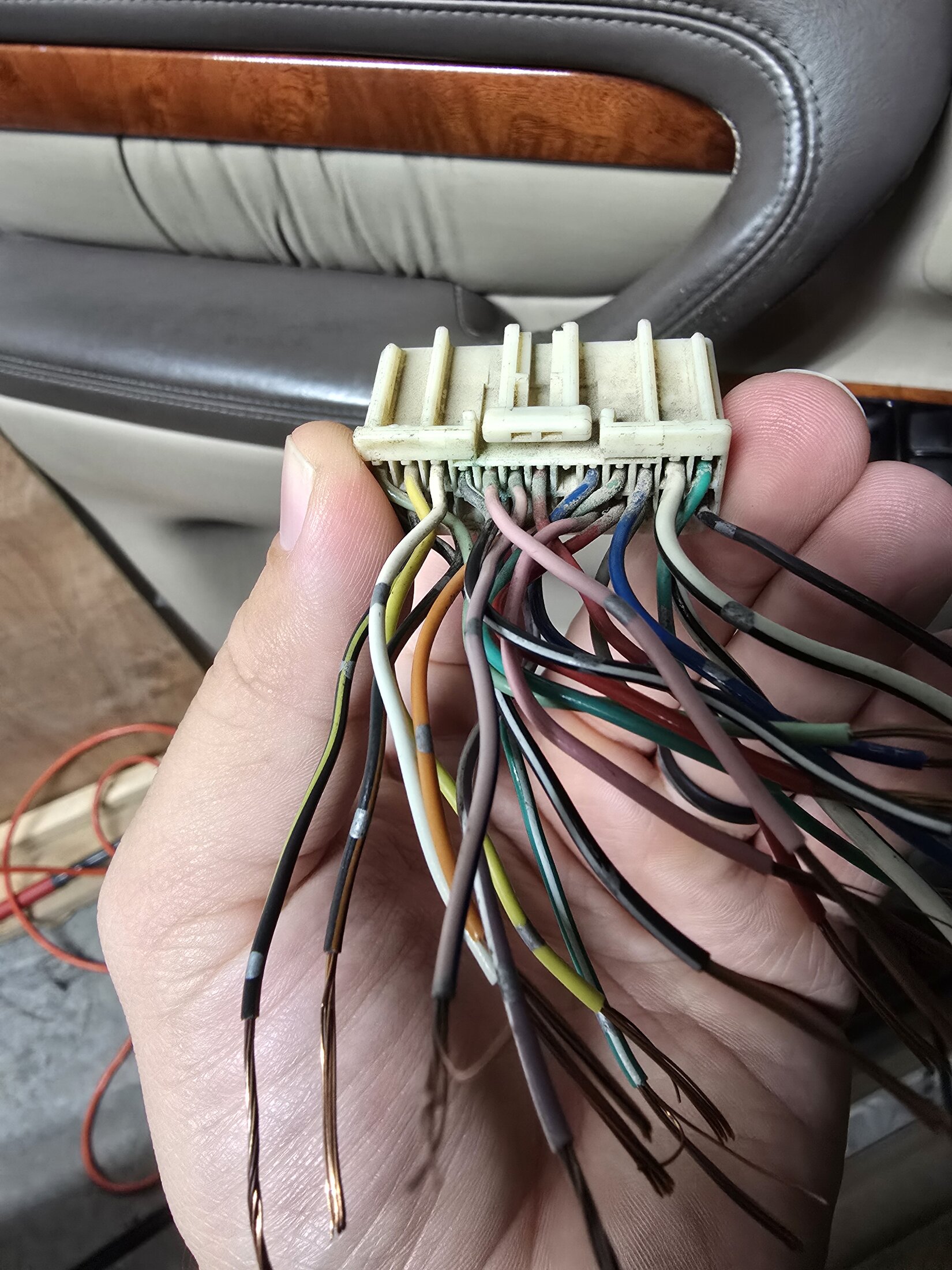

I was under the impression that a right hand drive bezel would work for my lx470 so I ordered one from overseas and now that I have it the wiring diagram is completely different. Has anyone had this issue or know a solution. Here is a picture of what my A harness looks like. Completely different than what the chart shows. The other 3 harnesses are different too. Any advice would be greatly appreciated!
yeah it is definitely different, good news and bad news, good news is you have the connector and electricity doesnt care about the color, and you have the connector, but probably not the pins to re-pin it. Bad news is it makes it harder to confirm you are wiring the correct wire to the correct spot, if it were me, id go through and label each one of those with the known color before i did anything, then id go one wire at a time (as recommended in general) and re-wire. OR you could get the correct pins and re-pin but you would end up in the same spot you are now, so id just do what i just said and label those all with the known colors and begin wiring.
but on the other hand, maybe they didnt wire the center console the same? hmm, interesting actually. which center console did u get (3 knobs or digital)
if the center console is wired the same internally, then id also consider removing all pins and just place them in the spot corresponding with their color

I got the one with the 3 knobs. Would there be a way to determine if the center console is wired the same internally? Here is the one I got
2 options i can think of, hook a coupla things up and test if those work , or find a wiring diagram from japanese version and see what each color is and correlate them to your colors
Looking at it again, not even the empty slots line up. On harness A there should be 6 open pins but on mine there are only 3 so I can't really even test it that way. I guess I'll have to look and see if I can find a Japanese diagram.

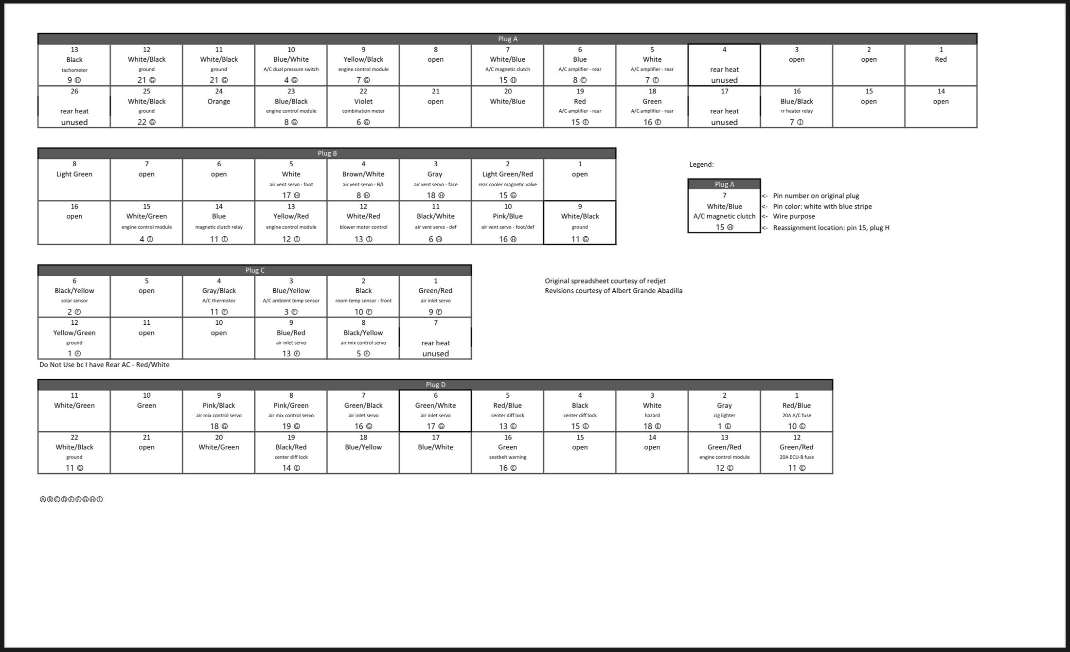

DO NOT USE THIS PINOUT DIAGRAM:
This is the pre-03 Nav Delete master sheet that I used…
You could also read through this thread…
That was my error to upload that older pinout sheet… when I begin this conversion back in 2021, I read through this entire thread to date, and I downloaded the pin out sheets as I went through the thread. Fast-forward to this year, When someone asked a question regarding this in 2025, I accidentally grabbed the older pinout sheet rather than the updated sheet. My fault.

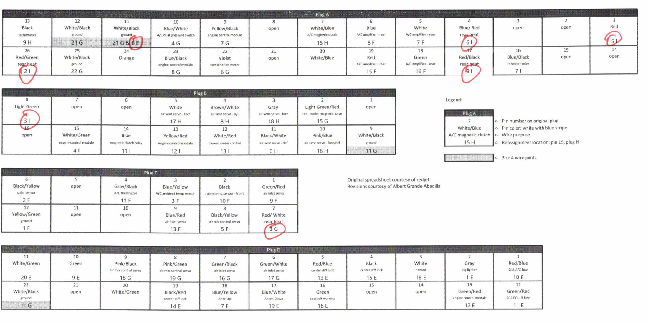

I cross checked the two wiring diagrams I used (mentioned above in post 1071) and the wires circled in red below are the only ones not connected... I don't have rear heat controls (tho I do have a heater under the driver seat), just rear AC... So, the only ones not connected that might matter are the ground from 8E or the random wire from 3I... I cant really figure out how either of these could cause my clock to reset everytime the truck turns off. All the other wires listed below are connected (I believe correctly).
I'm also surprised it seems like no one else has this problem?
Maybe try grounding the 8E wire, and then cycle the ignition off to see if the clock holds time memory.
Yeah, thats my thought.. I am clearly an electrical novice, but I believe toyotas (older ones at least) use switched grounds, so this will be my first place to start. Heading out on a 2 week trip tho, so it will unfortunately have to wait a bit for a resolution.
