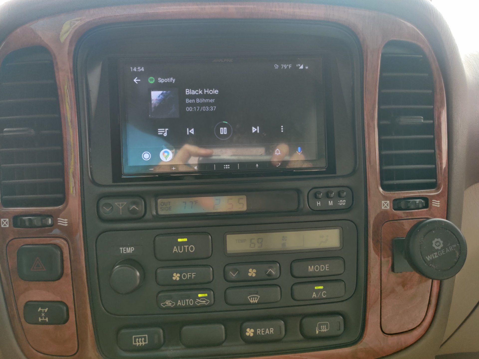

Aight guys, I finally crossed the finish line today. Thanks everyone for this amazing thread, and especially to @TXSunDevil and @BillZ260 for helping me with my troubleshooting. For those of you who were following along, I ended up rewiring the mag clutch wires, and cleaned the contacts on the controls. Pretty sure my controls just had bad contacts the whole time. :bang:
Here are my lessons learned:
1. "Cleaning" the HVAC controls isn't a soap and water or even air duster type deal. I initially decided mine were good after disassembling, as it looked brand new inside. However, it turns out these old controls have issues with oxidation/corrosion on the button contacts - causing them to be finicky. I would strongly recommend that you clean your secondhand controls prior to testing them. I used CAIG's Deoxit D100L with the needle tip and it worked wonders. I had no visible oxidation or corrosion from the start, but got 69% of my inop buttons back after one application, and a second application on two stubborn ones. They now all work. Some guy did a great writeup on FB on how to do it. If he hasn't posted it on MUD, I'm gonna get his permission and post that here so future guys can use it.

So you think the biggest part of your problem was that button with the green light here labeled A/C?
One of them. If I remember right my buttons worked like this:

AUTO, OFF, FAN, MODE, Recirculate, and A/C
Mode and Recirculate needed an additional application of Deoxit to get to 100%.

From my research after the fact, it seems as though see Deoxit is somewhat a temporary solution. Some people claimed the contacts degraded again after around a year. Looks like the the other option is to replace the contacts, there's a thread on here that that's pretty detailed for that.

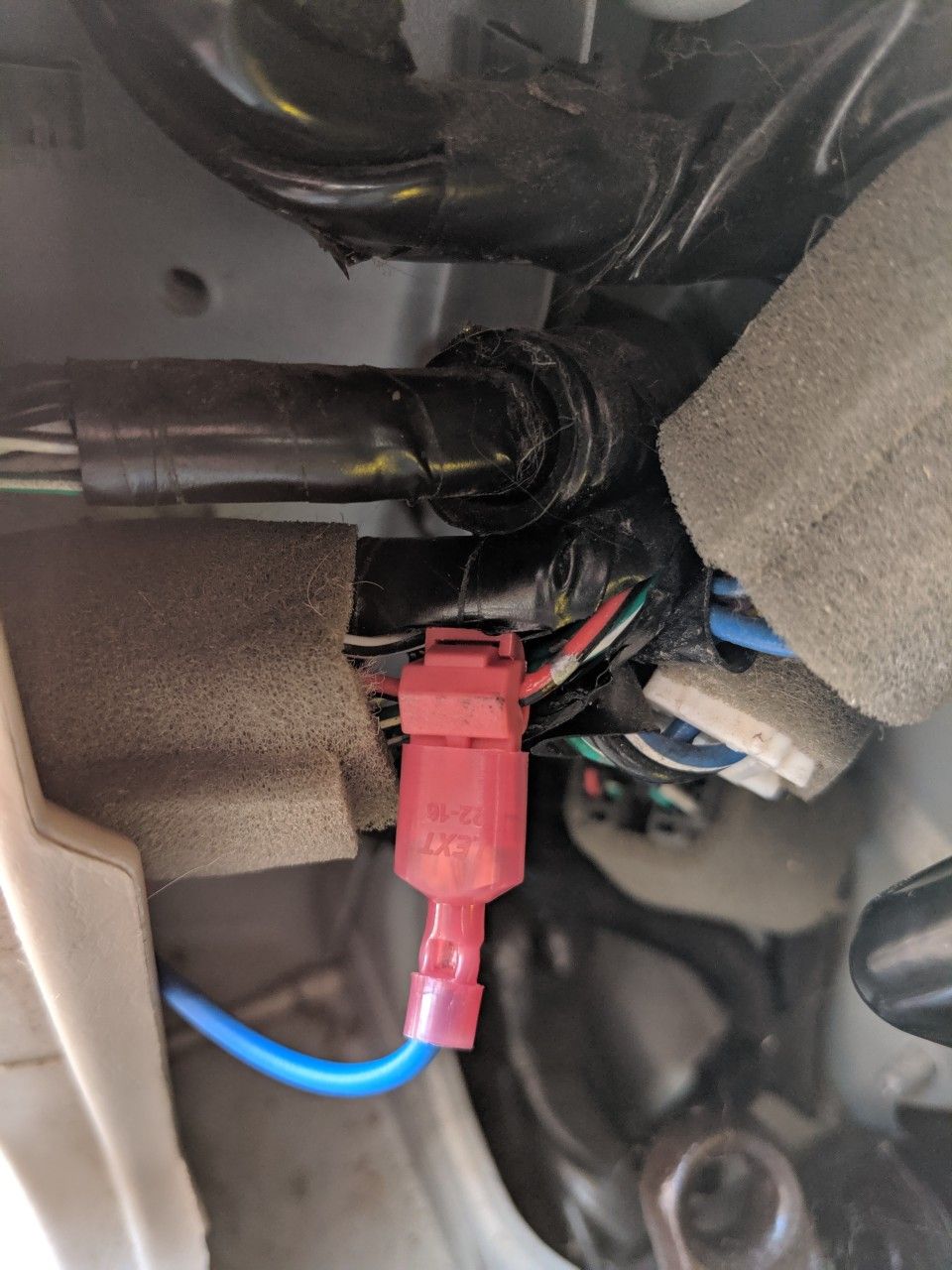

I got all of the wiring completed last night late. Going to hook up the LC bezel when I get home to test. Tell, me, none of the "Rear Heat" had wires to hook up to in the factory dash harness. (My factory bezel has the REAR button) Is this normal? 2002 LX with ML.
Also, crunched for time because I have to put this back together before going camping Saturday and I still have the speakers and amp in, and interior to install. Does anyone know off the top of their head which wire to tap into for reverse light for backup camera?

No clue on the backup camera. But my man, where are you located? You look like you could use another set of hands? I doubt you're near me....but still
@1gr8FoSemty Here's a pic I found of my conversion for the backup camera. Looks like red wire with black stripe in the driver side tool compartment behind the tail.

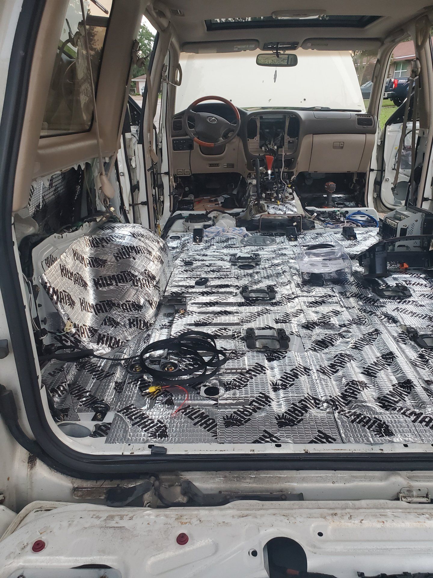

/Engage Beast Mode
How many sq feet of Killmat so far?
