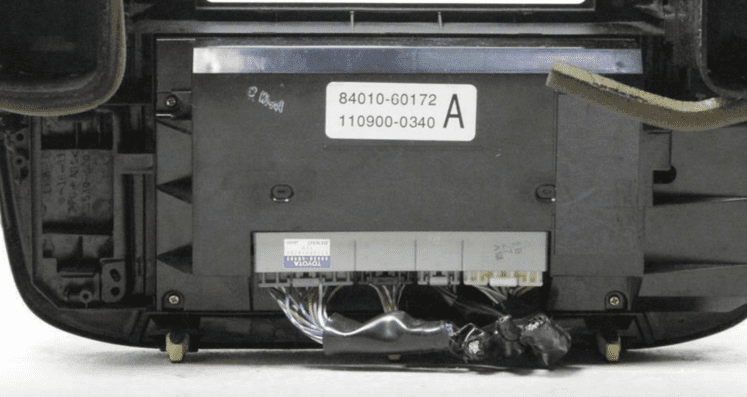

I ran into some trouble. Converting an 02 LX w/ ML & Nav to pre-03 digital LX HVAC controls and Alpine ILX-W650. Followed the pin-out guide to the best of my ability, but it seems I messed something up. Dealing with two issues after the project and I'd apprecaite some help!
1. Digital controls don't function. They light up, but it seems that no buttons function outside of Ant up/down, Temp, Diff lock, and hazards (though some buttons have lights on)

Quadruple check the pinout wiring. Sounds like a ground may be missing or a wire got put in the wrong spot. I am not sure on the stereo wiring. I am sure others will chime in
Rechecked them this morning for the 3rd time. I'm 99% sure I spliced the right wires, as I labeled everything and went 1 wire at a time. Only abnormality is that my Non-Nav pigtail had D12 blue/white and it's going to green/red - but it looks like other people have had that. Everything is going to the proper color and all the connections look good. I even went thru the remnants of the Nav pigtails, wrote down the remaining wires, and crosschecked them to ensure I didn't need any of them. They checked good.
At this point I'm wondering about the connections themselves. Is it possible to check for voltage at any/all of the pins using a multimeter and a ground? Or is there another way to troubleshoot this that I'm missing? Or I know it's unlikely, but now I'm starting to wonder if my eBay HVAC control set is faulty...
Edit: Used a wire that gave me good voltage when connected to chassis ground to check grounds. All the grounds check good except for the yellow/green on plug C. I'm gonna redo that one, but even when I use the multimeter on the bare wire from the dash I'm not getting ground. Weird.
Also, now the defrost, rear defog, and mirror heat work, but not every time I push the buttons. Most times they stay unresponsive. What could cause that? Bad pin/connection for ground?
There is a troubleshooting section in the FSM. See post #544 by @BillZ260 and it links to the troubleshooting steps for the AC.
I kinda went through some of the same, so after some reading, I pulled my entire LC HVAC control apart and started cleaning and actually testing all the buttons, because some folks have had switches or buttons go bad. Yours being the LX version 'manual' control, looks like all buttons, you might pull it apart and check for dirt/gunk. I cleaned and checked continuity on almost everything in that control, very tedious but a bit of fun. But it ended up being a wire I missed.
You can also try continuity checks from your connection PIN to the relay or other end of the circuit. I bought a Power Probe which made this trouble shooting power and grounds a lot easier. On the lead continuity, I set my volt-meter to BEEP and made a long lead and tested away.
On yours, I'd question the control unit if you have triple checked the connections. Maybe just needs a clean?
Thanks guys. I invested in a PowerProbe, thing sounds amazing (and perfect timing, my cheapo multimeter is getting ancient). Unfortunately, it won't be here for a week. In the mean time I'll check fuses while I wait to see if I somehow blew something and if that's why it's giving me issues.
I'll also give the controls a clean. I do have my concerns, the knob is pretty lose making me question how well it was taken care of.
