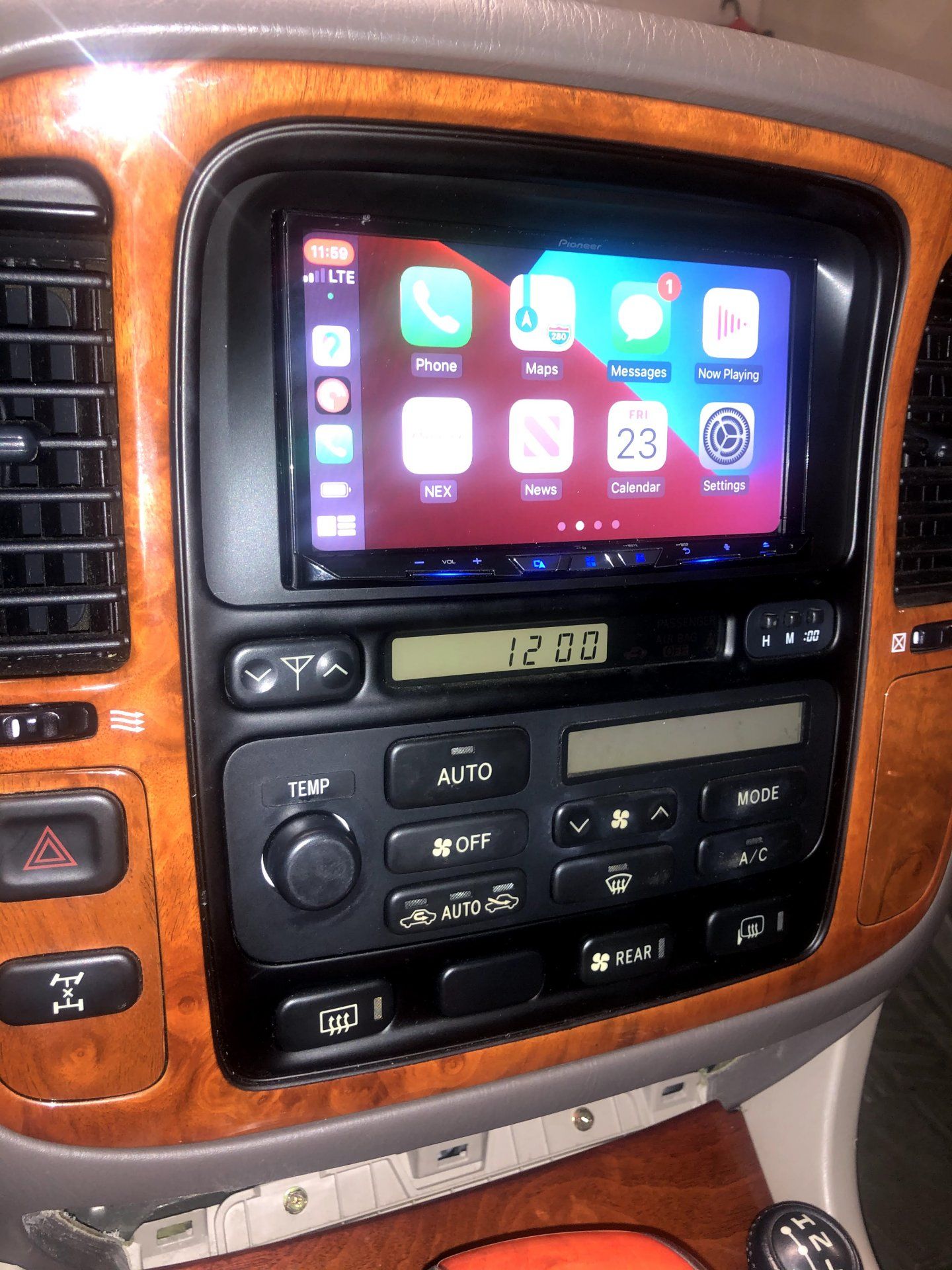

The nav-delete was easy and I am sooo glad I did it. Follow the spreadsheet and label all the connectors (original and replacement) with their letter designations prior to making any cuts. Make check marks on your printed spreadsheet as you go. There are a couple of good videos previously in the thread. Use the recommended solder tubing connections. Make sure you have enough red ones. I had to buy two kits. I used a heat gun with a reflector head attachment. The hard part of the nav-delete for me was sourcing the replacement heater controls. I wanted the LC knob style but couldn't find one where I could also have the pigtails. The pigtails are very important. I ended up getting an LX470 digital version with pigtails and I am happy enough with it. I needed new right/left mounting brackets, double DIN trim bezel, antenna Y connector, and antenna connection adaptor. Sorry, I don't have the details of those in from of me.
Here is the hard part, and it almost broke me. This second part, after the nav-delete, of installing the new head unit definitely takes a step up in skill. My plan was to install a standard aftermarket double DIN head unit and continue using my Mark Levinson amp and speakers. I used the Metra 8113 harness. But it didn't work. No sound. Then I tried a TYTO-01 and it didn't work either. After lots of research, and I hope someone will tell me if I am wrong and they were successful, but I don't think this is possible. I think the ML amp is only compatible with a stock radio. The ML amp doesn't have a standard "remote" or "trigger" input.
Eventually, I removed the amp and ran new speaker wires down to the amp location, and spliced to the wires that run to the speakers. I continued using the 8113 harness for basic power and ground. In this scenario, I ended up with four working door speakers only, no tweeters, center, or sub. But, oh well, good enough for what I want. With all that said, after the nav-delete is done, any reputable car stereo shop should be able to install a new system for you. They normally will not touch the nav-delete portion though.

One last pointer...after everything was working but before buttoning it all up, I cut off the old unused connectors. Whatever you do, don't cut all the wires at once in one big bundle. Rookie mistake, I know. There are still some hot wires in there, and you will blow fuses, maybe multiple. Nothing like having that good feeling of being done, and then quickly thinking you fried the whole thing. Haha.
Wow, simply amazing. Thank you so much for this thorough and thoughtful write up. Just the push I needed. I'm going to start sourcing the parts this week.
Your set up looks so awesome, and if anyone can chime in re: the ML amp, I'd love to hear your input. I may have a local shop do the head unit install all things being equal.

I made a video on YouTube, it seems daunting but it's not that hard. I changed the controls to manual by doing the wire splicing, then had a professional upgrade my amp and speakers while wiring in my backup camera.
Thanks for the video.
IMO interesting and very understandable that you hired a stereo installer for the stereo portion of the upgrade. If I get time I'll do a writeup of the conversion I just completed (2002 LC). If I had to guess, I spent probably 2-3X more time on the stereo stuff than I did the actual nav conversion. The nav conversion part is more intimidating as you're cutting so many wire harnesses and it's somewhat irreversible, but it's also contained to a small area with very specific wiring instructions. For a full stereo upgrade (with amp, speakers, backup camera, etc), you've got to pull off every door panel, several side panels, tailgate panel, find reverse wires, run power from the battery, etc etc. Also keep in mind that all of these cars are ~20 yrs old and the people doing the nav conversion are probably at least the 2nd owner if not the 3rd. I know in my case, once I opened things up for the stereo part, I started finding a lot of non-stock stuff done by prior owners that I didn't know about and had to deal with - speaker upgrades that changed wiring harnesses, brake controller that tapped into various wire bundles, a backup camera system, a hands free calling thing. All of these mods added time to me figuring out how to safely remove them and clean up all the unnecessary wires and taps. Part of this is my OCD - I'm sure I could have just taped some of them off, but as long as I'm in there I want to clean everything up so if I have to open it up again it's not such a rats nest.
For those that are not as cost sensitive, outsourcing the stereo upgrade makes good sense. It would probably be difficult to find somebody willing to take the risk of the nav conversion (even though it's not that risky if you just ensure you understand and stick to the wiring diagrams in this thread), but once that's done the stereo upgrade is pretty straight forward although labor intensive. I'm sure it would be expensive, but for some people would be worth the money to regain control of their nights and weekends and get the time to enjoy the truck for the reason they bought it.
