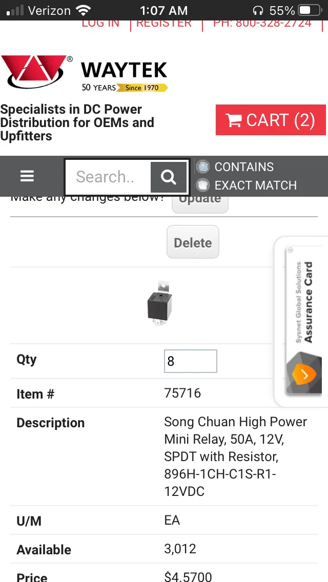

Rereading thread I noticed @slcfj62 recommended part # 75716 from Waytek.com since the relays originally mentioned are no longer available.

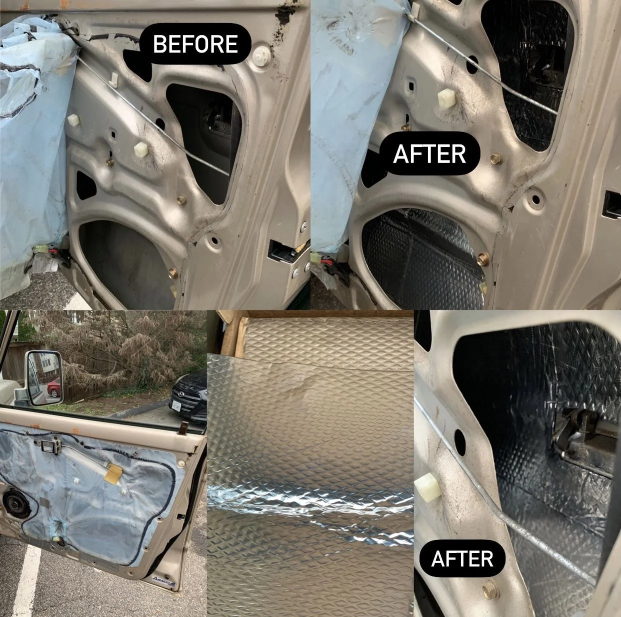

I took the opportunity to put in some sound deadening too.

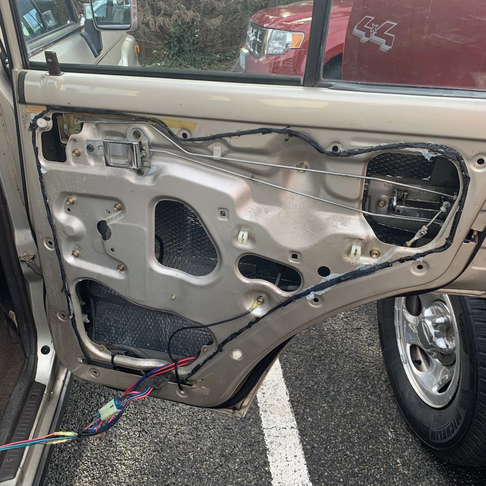

Did sound deadening in the passenger rear door and after buying a bunch of wire to extend the relay pigtails attacked adding the relays. It came out wayyy cleaner this time.
The relays will mount down low out of the way of the window without putting any stress on the wires. Still plan to add some split loom and a ring terminal for the ground.

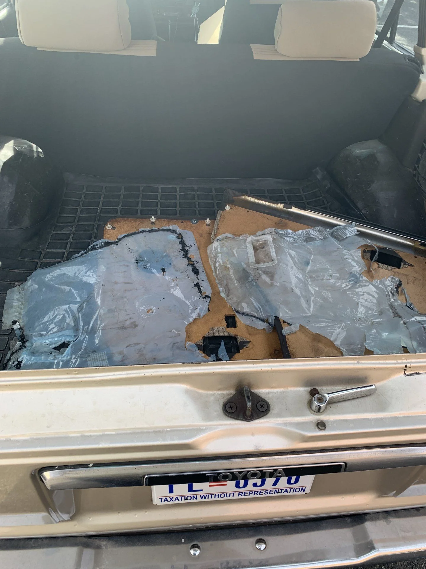

First, I want to thank everyone for this post. Its fantastic! and while I wait for more Amazon stuff to arrive, I wanted to pass on a piece of advice.....Do not think that you are smarter than everyone else and order waterproof relays. I thought that it had to be better. The problem is, they do not fit through the switch plate hole in the door panel. Oh well, its been a learning experience. I'll be doing what NearJetties has done and extending the wires a bit, and instead of doing all of them at once and soldering the connections, I will be using the crimp and shrink fittings and extending the wires- one door panel at a time.

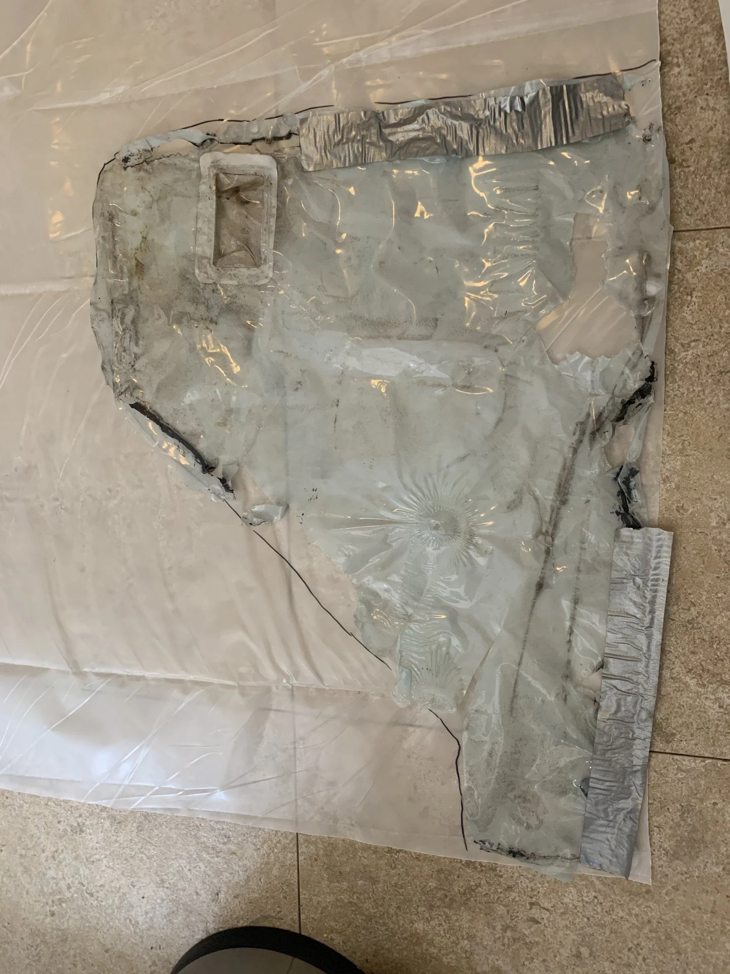

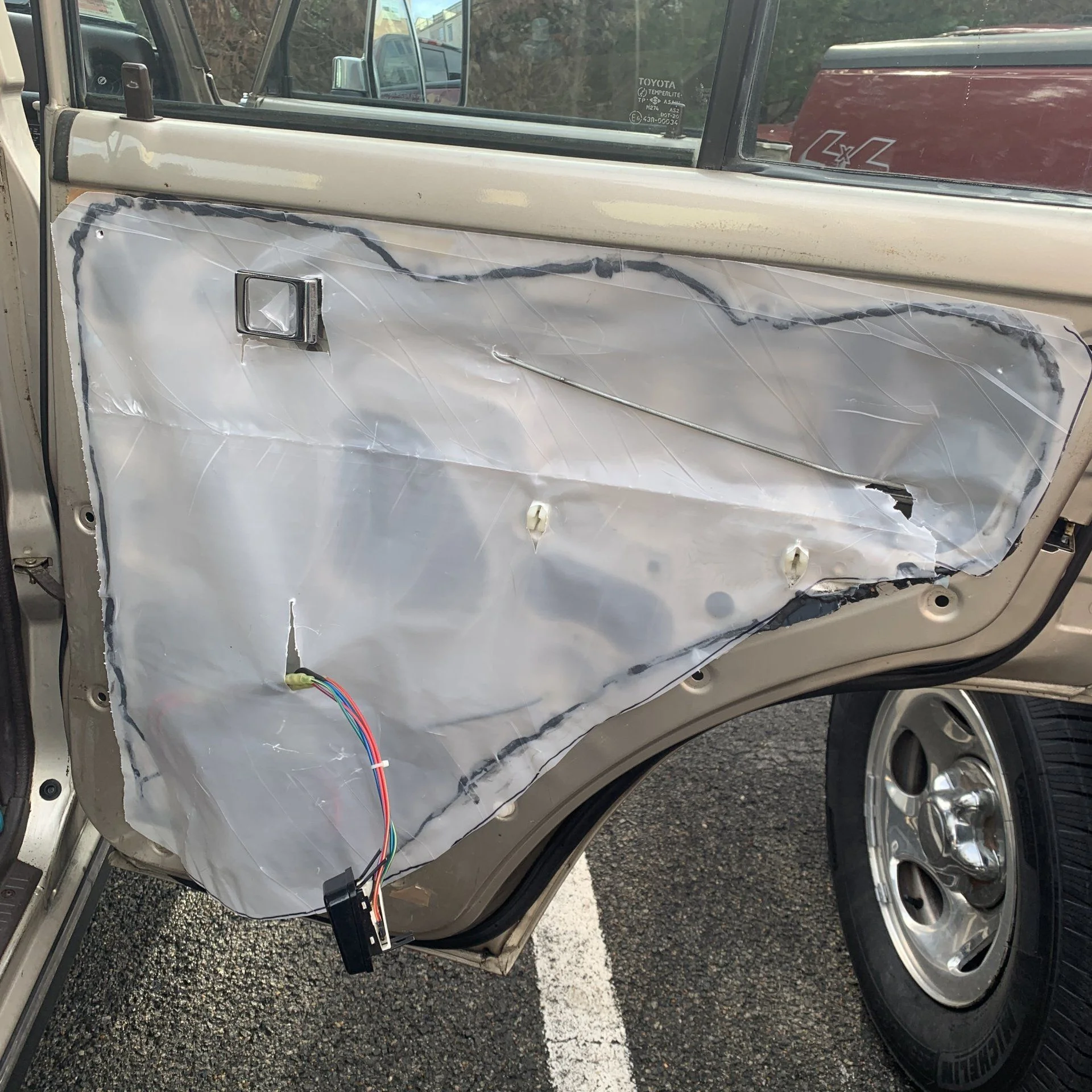

Good time to redo the weather barrier if it’s seen better days too.
I used the waterproof relays and had to squeeze the switches through the hole instead. It was tight but worked.
View attachment 2544058View attachment 2544059View attachment 2544060
I can see that you used the waterproof ones now. I missed that. I can open up the holes for my switches as I had new door paneI and don't have holes for them. I was planning on moving the switches to the center console, but abandoned that for sanity reasons (not that I am sane, mind you).
I am going to try to use Cascade Audio Engineering VB-2 as a weather barrier. Supposedly gives additional noise and vapor protection. We'll see. I have to get the switch to fitted first.

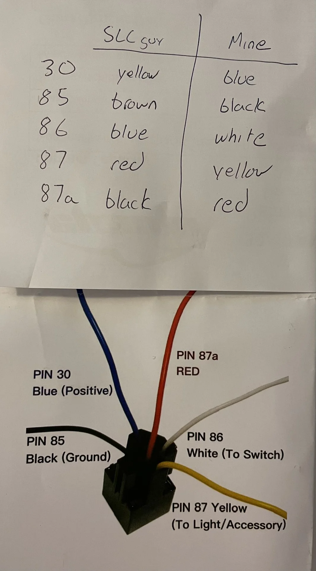

After a day of frustration, I figured out I had it the relay wired wrong and had to move the wires. Easier than starting over. So, I should have my wiring done tomorrow and I can start figuring out what to do with the lock actuators. Anyone found a suitable new replacement? I saw an old thread about Torfab having something, but nothing on their website. Any suggestions?
Ok, a day of success. Unfortunately, I used the diagram on post #191 to understand the set up, but the pin #'s were wrong. For instance ce 30 is Yellow to the connector, etc. You have to decipher the colors and pin #'s from SLC's original post. It works great! Happy happy. Now, those power locks...the to back door locks are not activating. Any way to test? Maybe its in here and I missed it.

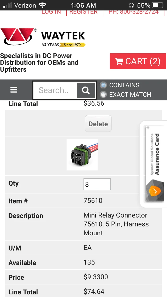

After an agonizing hour of reading this thread and trying to source the proper materials I’d like to double-check with the community before purchasing. Are these the materials needed for this mod? I’ve got the 30/50 amp mini relay spdt and then a mini relay harness with what appears to be the pigtail. The only thing I’m not sure about is if the wire gauges are correct for the pigtail - this is the description:
  • Mini Relay Connector 75610
  • Category: Mechanical Relays & Connectors
  • Connects to 5 pin, weatherproof 3-12 ga and 2-18 ga, GXL 12" leads
  • Terminals included
  • 185°F (85°C) - 40°F (-40°C)
  • Use crimp tool stock no. 419
  • Heat Stabilized thermoplastic connectors for relays
  • Terminals (when supplied with connector) are brass, bright tin plated
  • Connectors for panel mounting can be stacked together

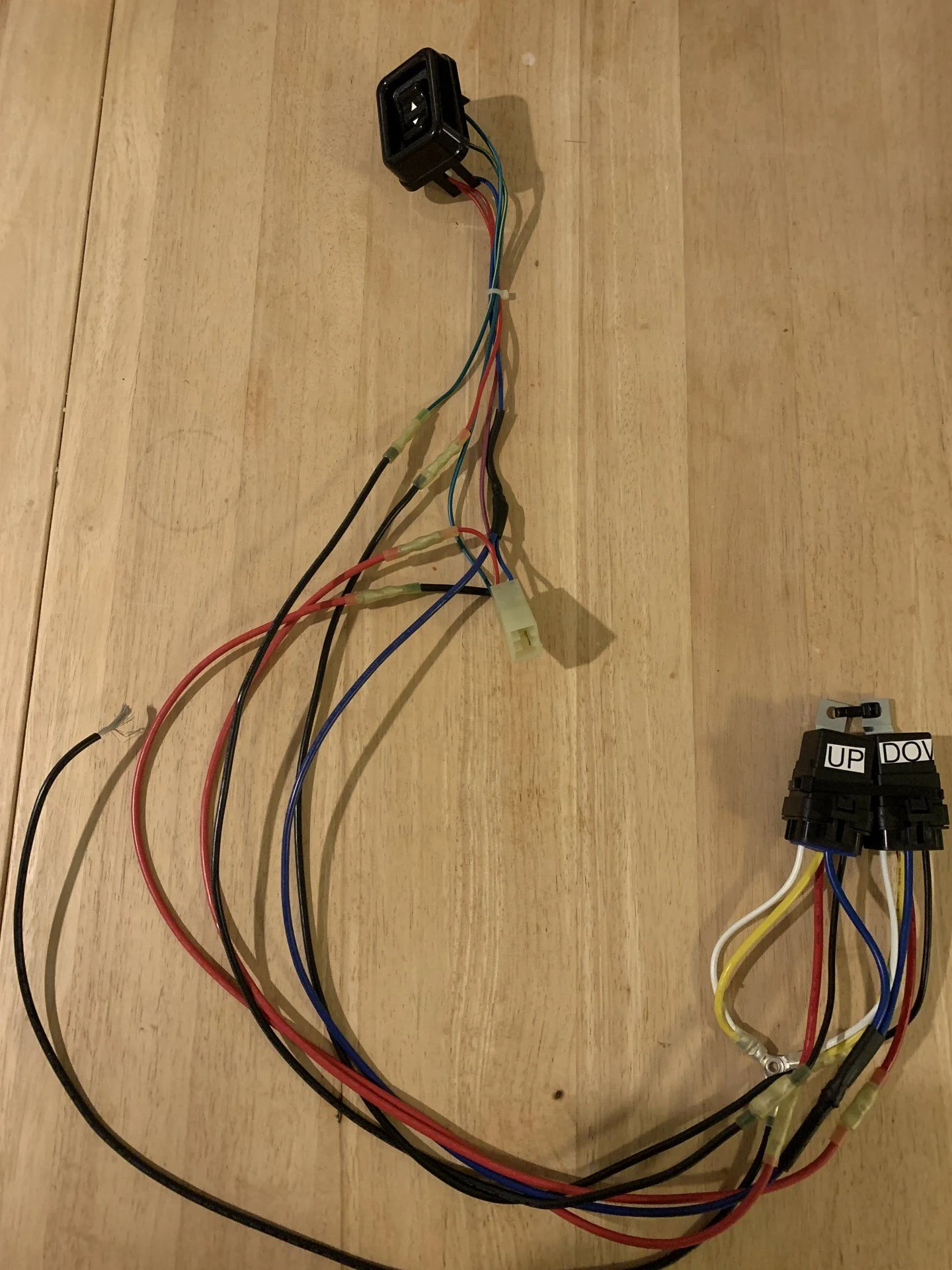

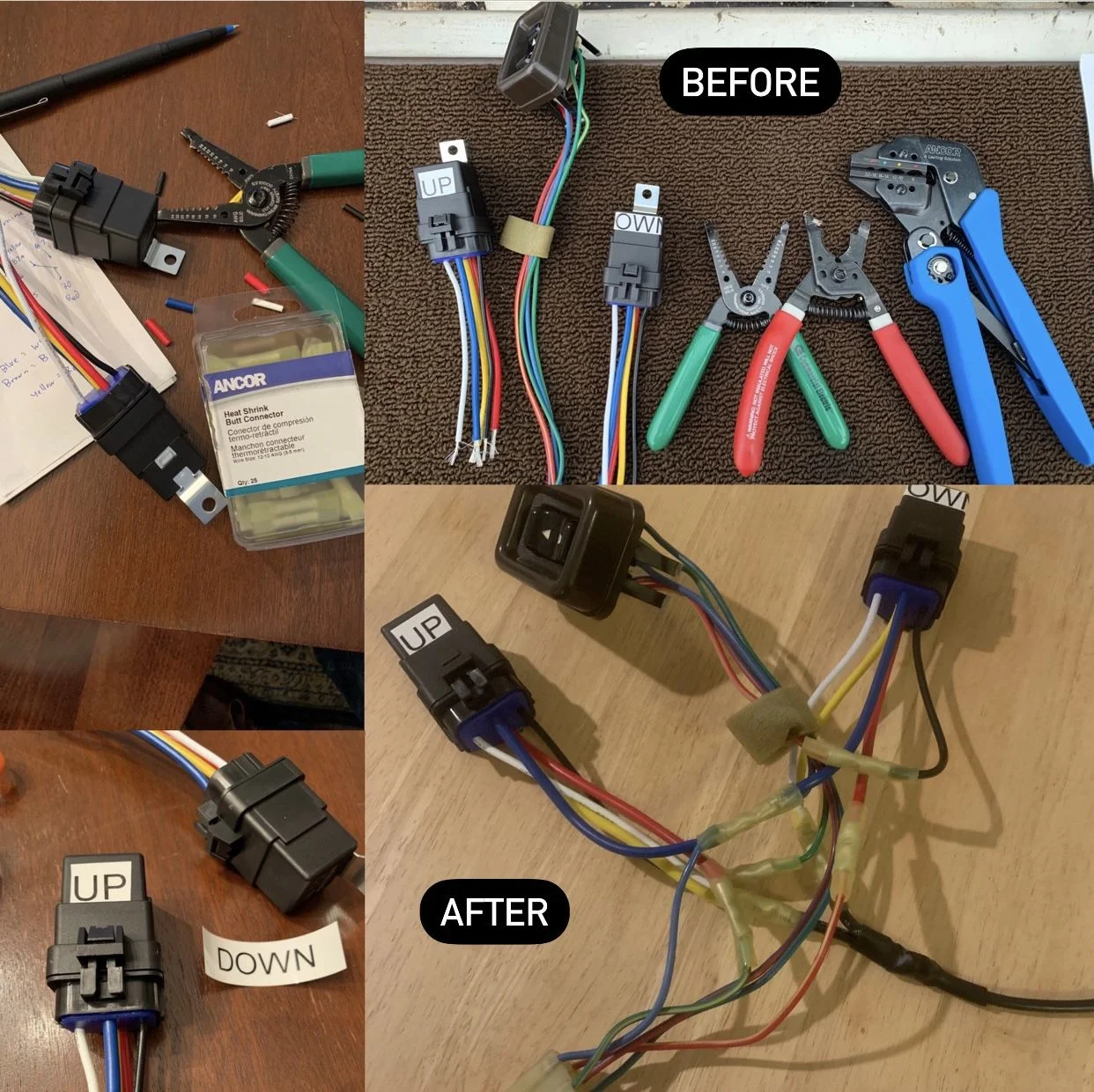

Just did this mod finally. Even after completing just one window, the power increase is notable even on the stock windows. While I had the switch out I noticed my fan for heat/ac stopped working. I guess this entire car is wired as one system??
Mapping the wires threw me off at first so thought I would put on a crib sheet for those with a similar relay setup. 14 gauge ground wire worked for me with a self tapping metal screw in the door itself. Now just need to find the right place to permanently secure the relays.
