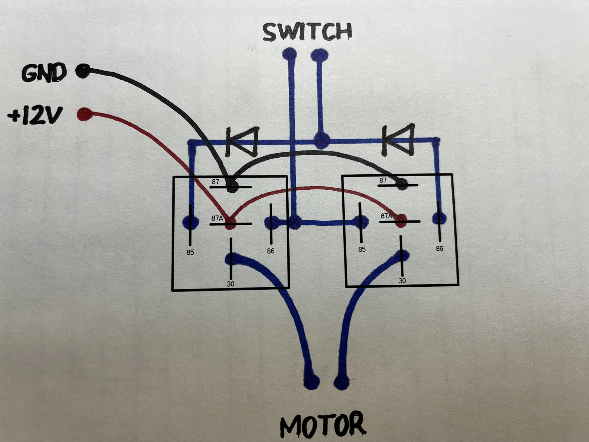

A much simpler way would be to use the factory wires and switches to trigger the newly installed relays.
The relays would switch the current for the window motors ( 5-7 Amps ) and the factory switches would only switch the current needed to trigger the relays ( .1 Amp ) All switches work as before, including the lockout switch. ( I should post the diagram. I’ll draw it up tomorrow and post it )

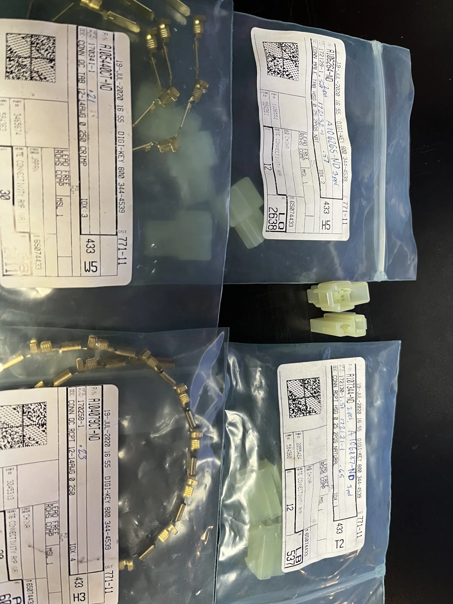

Thank you for the kind words on my install. I ordered the connectors from Digikey.

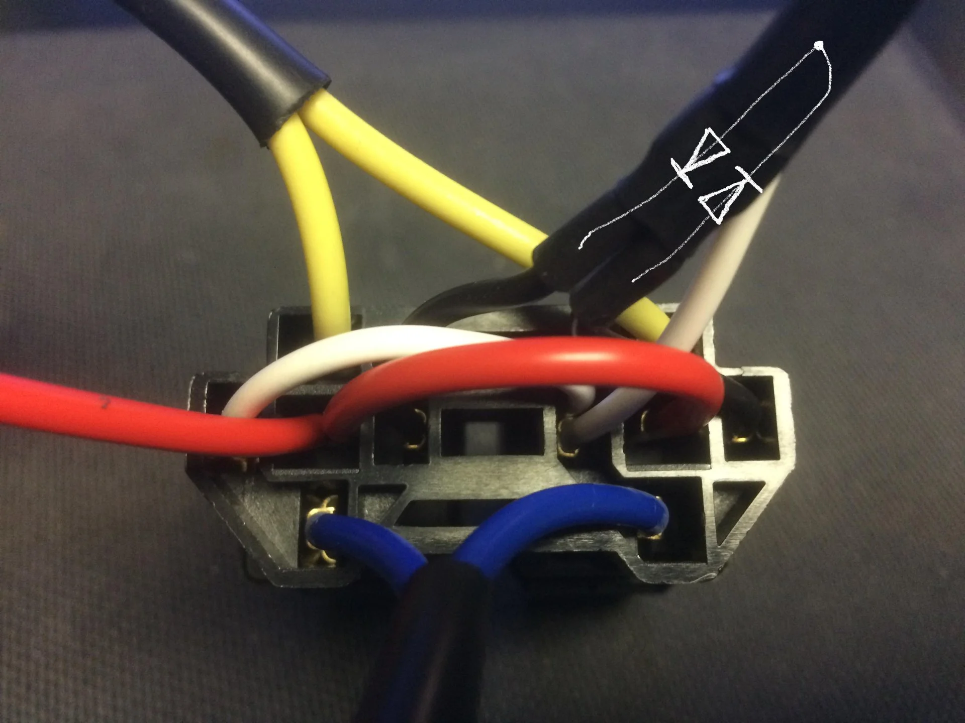

As I promised, here is the diagram. Hopefully it makes sense.
The diodes are 1N4001 or similar.
As I promised, here is the diagram. Hopefully it makes sense.View attachment 3082947View attachment 3082953

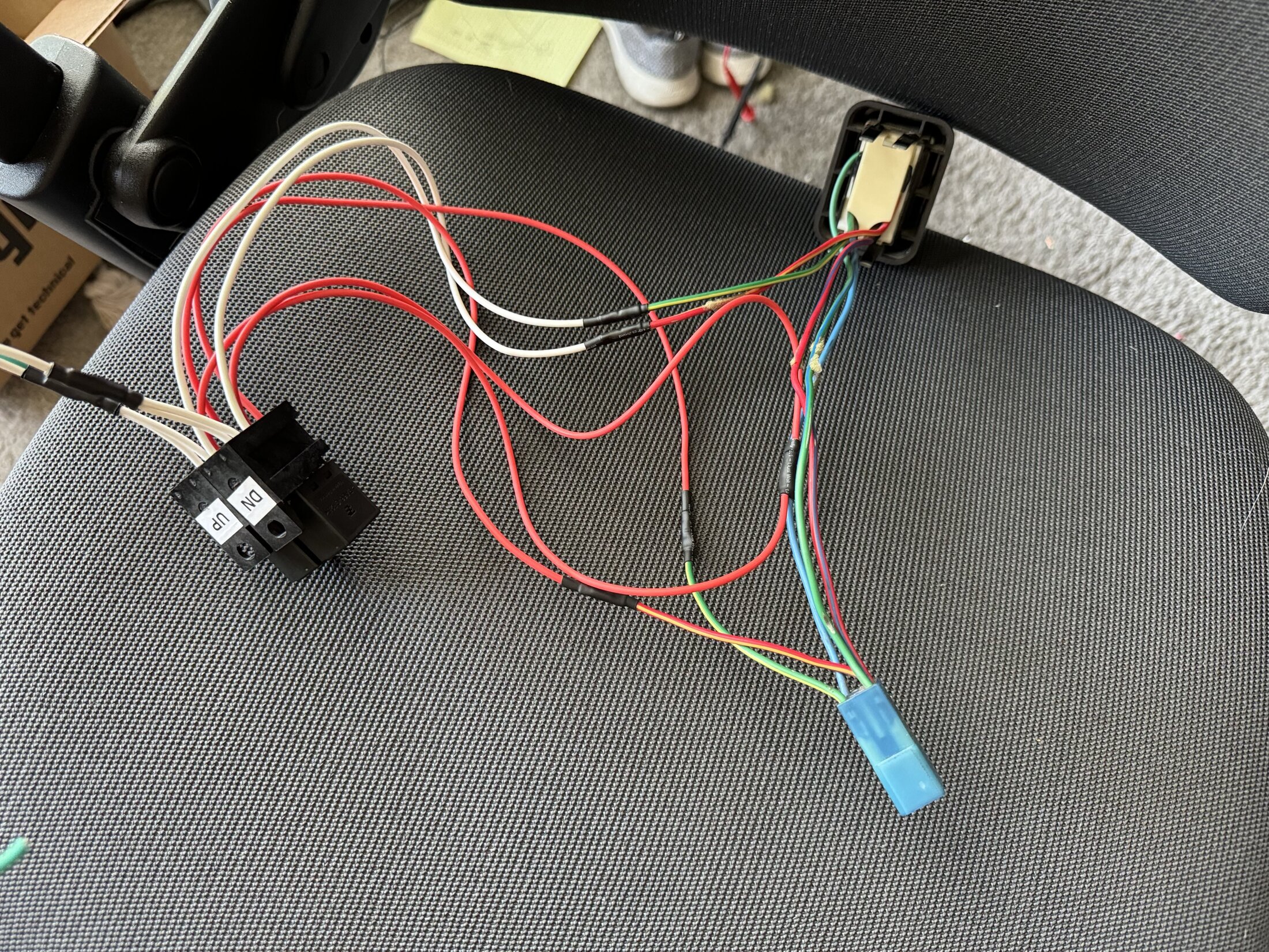

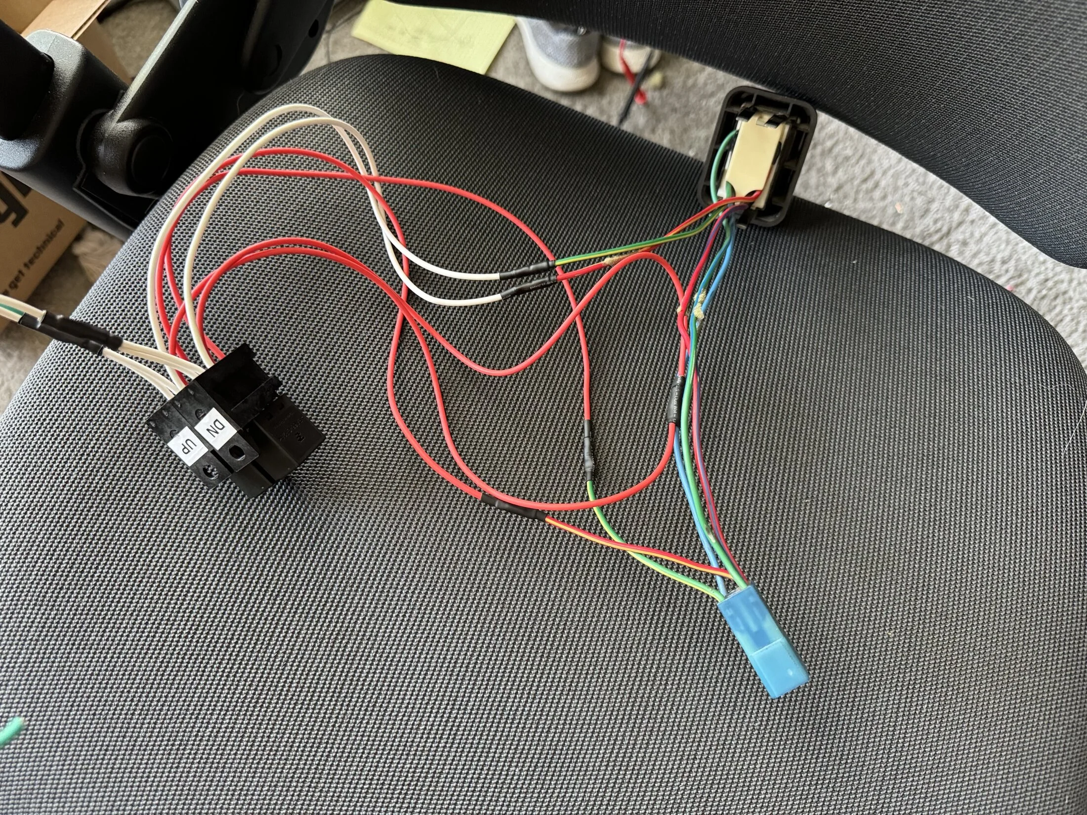

Did this and the main relay fix today. I didn’t want to use the large relays so I bought these mini ones. Here’s a parts list. Rated to 30A and not made in China crap relays.
Total cost for good parts, $40
The relay holders nest/connect to each other like the above post

Also changed the wiring on the relays and went with the diodes on each relay, so I can keep the window lock out switch functional and keep my switches happy with only a small current flowing through them. Every switch works as intended from the factory.
I don’t like to cut factory wires so I got some connectors and made the relays plug and play at the window motor plugs.
Let me know if you want to know more about the diagram or have any other questions.
I'm a total novice when it comes to wiring. But from the photo of the actual relays together. It appears as though 85 on both relays are wired together and fed to the switch and 86 from both relays are wired together, with diodes between, and then go to the switch.
Am I crazy?

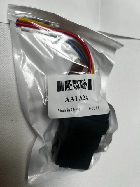

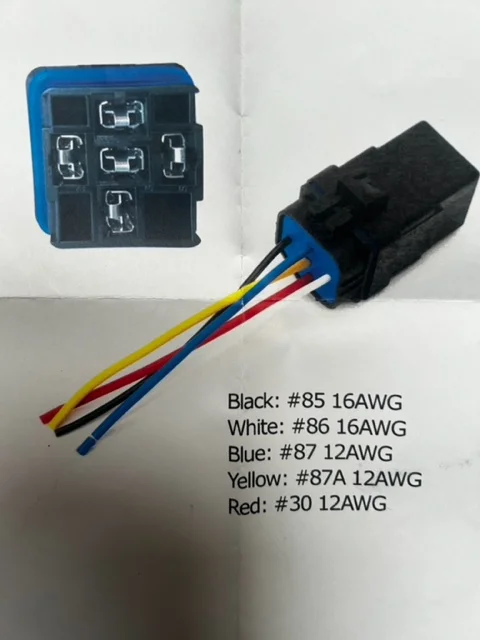

I have a set of 5-pin SPDT relays for anyone willing to pay postage. I bought these back in 2022 for this mod, but on the advise of LA Z I decided to go with a smaller relay. Perhaps @LA Z can confirm that these will work if you are willing to use this slightly larger version (actual size = 2-1/8 x 1-1/2 x 1-3/8'). It is also possible that I bought the wrong type, so postage payer beware. Pic's follow:
