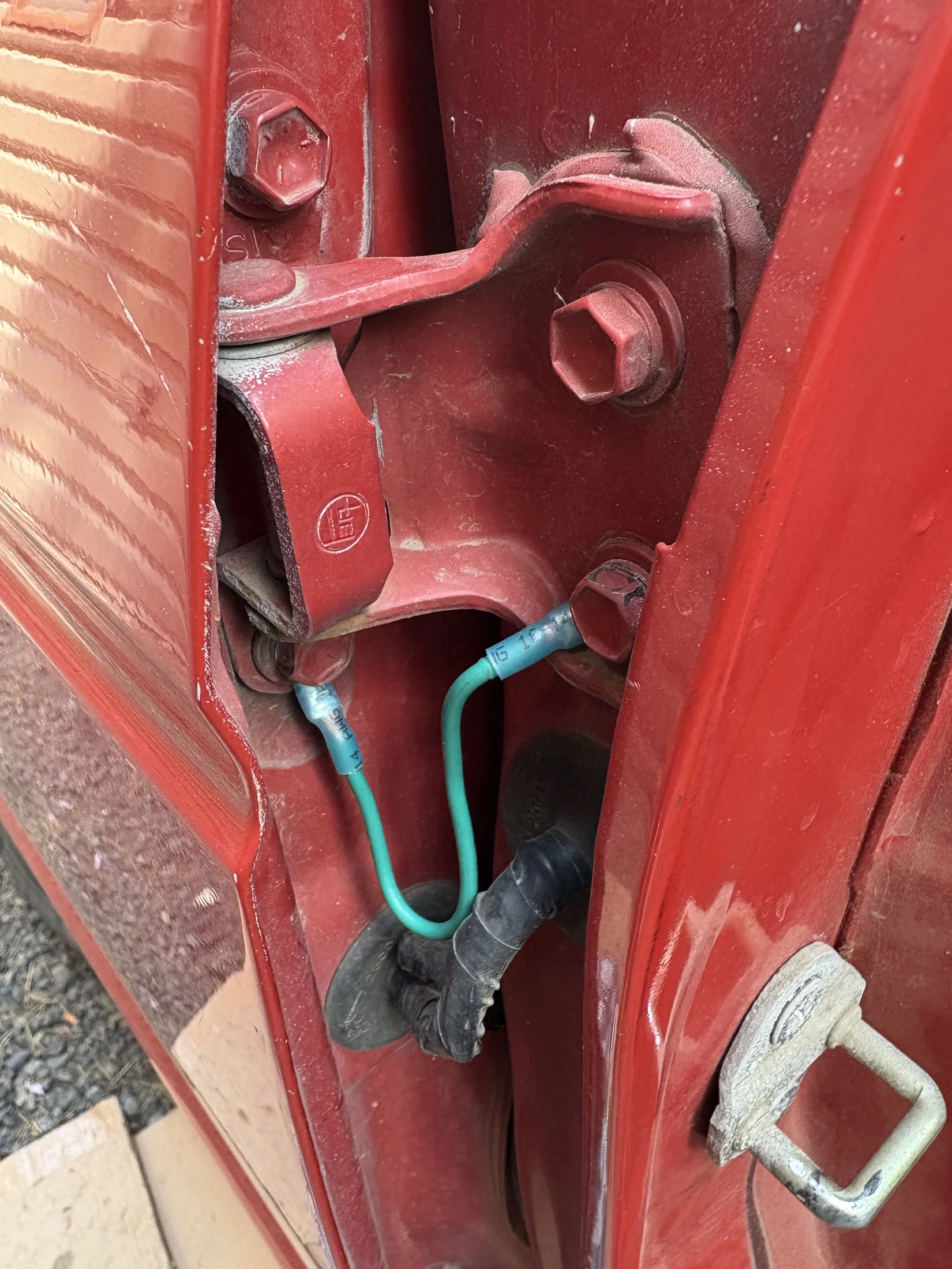

Quick question; are any of the existing wires in the rear doors ground? Running a round wire is a bit of a work for me in the rear.....

Regarding new ground wires for the door-I took the easy way out and made short jumpers that go under hinge bolts-with the doors open the bolts are easy to access. Some may frown but it’s my truck!!
Threading through existing looms looked like a lot of work and potential damage and drilling new holes wasn’t desired. We will see how these survive but at least they are super easy to replace and are doing the trick as the windows work really well!!
What you may find lasts longer will be to track down some grounding flat braid and use it instead of those short jumpers.
Yes-better solution and I’m gathering material and tools to do that in addition to replacing battery cables and various ground straps around the truck. These were super easy and more of a “proof-of-concept” than a final solution-wanted to see how much of an improvement the relay upgrade would be.

Regarding new ground wires for the door-I took the easy way out and made short jumpers that go under hinge bolts-with the doors open the bolts are easy to access. Some may frown but it’s my truck!! View attachment 3963368Threading through existing looms looked like a lot of work and potential damage and drilling new holes wasn’t desired. We will see how these survive but at least they are super easy to replace and are doing the trick as the windows work really well!!
