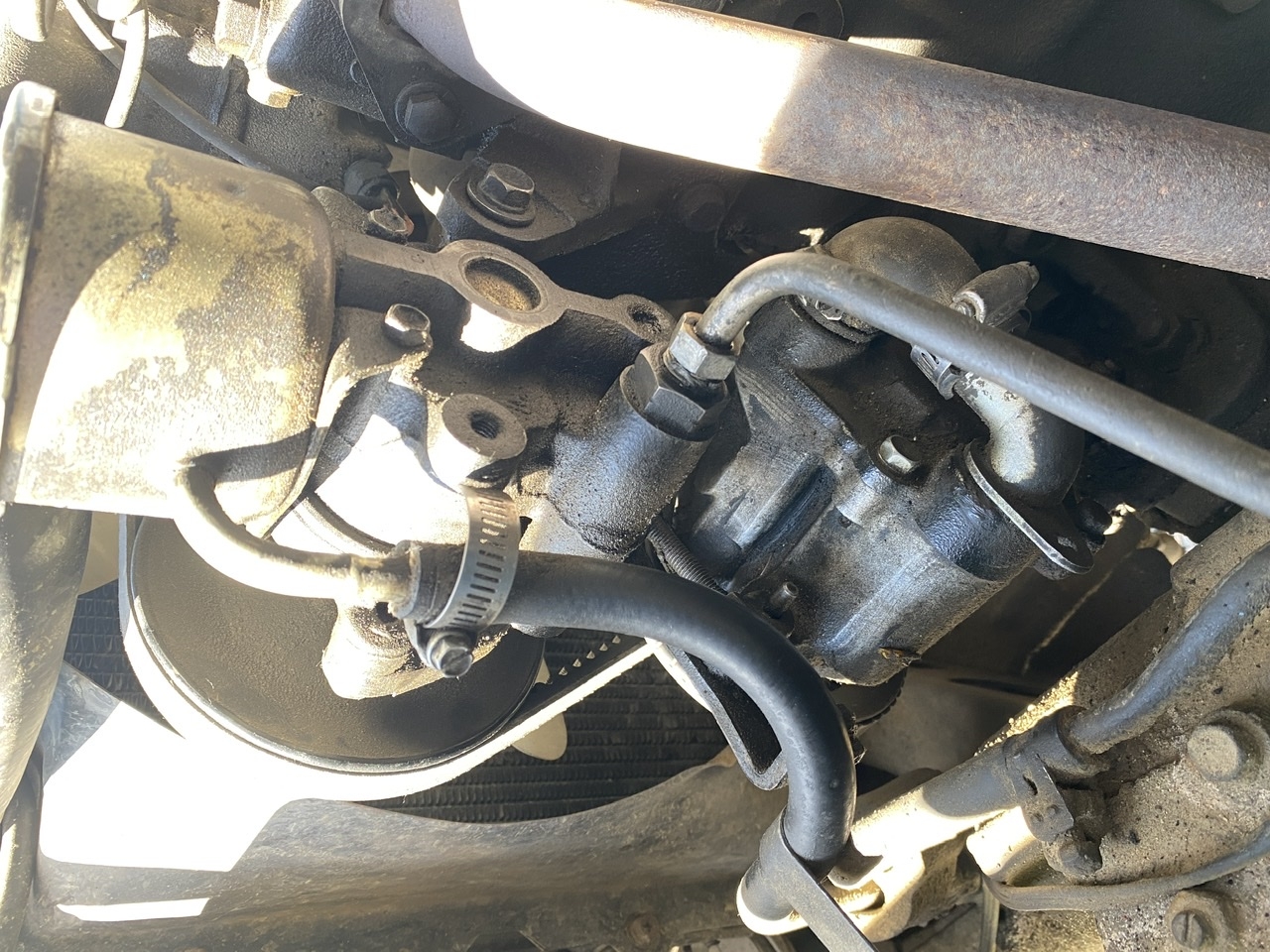

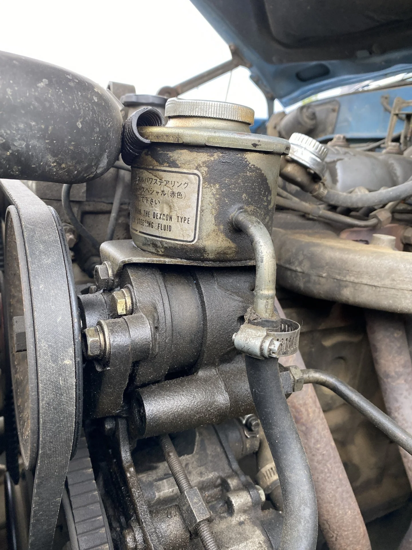

I’ve got a leaky, messy power steering pump on my FJ60. I watched a few videos and convinced myself it’s doable to DIY the replacement. Curious what you think of these options:
Cheap: Remanufactured pump from Napa or similar. Reuse the existing reservoir.
Medium: Pump and reservoir replacement from Toyota Parts Deal.
Spendy: OEM pump/reservoir assembly from SOR.
I’m leaning toward medium, mostly because I’d rather not monkey around with the old reservoir. Any other insight from your experience replacing one of these would be appreciated too!
Your own “medium“ option is actually the best. As OSS pointed out - new OEM, with reservoir, is still available from Toyota and will last you another good long while. I got mine from Camelback Toyota online years back - I think they’re more reliable and just as competitive as Parts Deal.
There are some good threads on here about replacement, with various strategies about accessing the bracket bolts. Like a lot of people on here, I found it easier to take the whole bracket and pump assembly off together, then I put the bracket back on before installing the new pump.
Whatever you do, take a good look at your smog pump while you’re in there. If the PS pump has been leaking on it for a while, it’ll be the next thing to go.
It’s also a great time to replace that engine mount right in there, if it needs it.

Hmmm interesting. Partly I was thinking of replacing it because the power steering doesn’t seem super, uh, powerful. Also there’s a funny rumbling noise from under the hood in that area, so my logic was, since I know it’s leaking, why not replace it and then see if that happens to also resolve that mystery noise.
