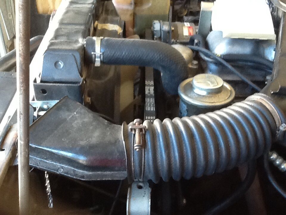

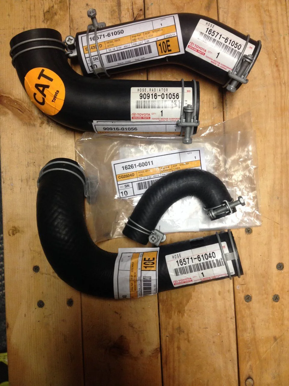

FWIW - My $0.02 worth, take a look at Danny's, Erik's, and your upper radiator hose. I would suggest to get the same one as Danny's because it places the downward bend further away from the radiator, thus further away from the Crank/PS/Alt belt. Here have a look at all three below.
Erik's: (seems to be possibly installed backwards? But apparently works.)

Mike look back a few posts, I sent my three hose part numbers - I don't know which is the top one, but should be easy to figure out - just call @beno (Onur)
Thanks Danny, I noted those part numbers and will definitely come in handy in the near future as my project continues to evolve. It was a mistake on my part purchasing after market hoses for my 40, not happy with the way mine look.
This is the one you are referencing: 16571-61040 :D
Got a full set of the hoses and new Toyota hose clamps ready for installation.

So , the hose number 16571-61040 fits the '81+ model thermostat housing ? Due to rust in the block and not wanting to ruin a new radiator , I use a Gano filter in the top hose - that longer top section hose looks like it would work better than the fubar one I had to make up to get it all to fit .
I need to fix this quick install but cannot find a factory hose long enough to install my filter setup neatly . Made this mess with two aftermarket hoses cut up ....ugly . Be nice if the later model thermostat housing/hose would make this a cleaner install and clear the power steering pump planned for this summer .

Sarge, I posted, back a few pages, the three hoses I bought from cDan for my '78 FJ40 - I don't recall which is which, but @GA Architect say's 61040 is the top hose and it certainly looks like it. Call Onur.
16571-61040
16571-61050
90916-01056
BTW @Weber Sarge - I'm not running the 'mortar-looking' thermostat housing that @roma042987 sent Mike - mine works fine with the proper hose for my year. The longer section to the radiator, coupled with the two 90*s give me plenty of clearance.
For my '77 FJ40, here are the four radiator hoses I have.
16571-61040 - Radiator inlet (upper hose - 8/76 to 1/79 )
16571-61050 - Radiator outlet (lower, radiator side hose - 8/76 to 7/80)
190916-01056 - Radiator outlet (lower, pump side hose - 3/69 to 7/80)
16261-60011 - Water pump by-pass (3/69 to 7/80)
Here there all are:
I would try the hose from a 82 fj40, it may be the hose and/or the t-stat housing
I would ditch th PS cooler tube and just use a small tranny type cooler(did this is my 82). The OEM PS cooler is like the tube..and it goes under the rad.I used Jim C's smog pump kit on my fj60,going to get one for the 82 fj40 as it just make its easier to work down there.
Can you use a shorter belt for blue and run ALT-WP-CR and remove the Air Pump and run green WP-CR-PS? May need a different belt for green.
I think that would allow you to miss the rad hose and you would likely no longer need the air-pump as an idler pulley.
You would also have WP covered with both belts - if one belt fails, WP still works.
not sure if this pic helps, but 82 fj40, added OEM PS, fj60 pump/bracket, OEM PS box, used the OEM belt that for a 82 with OEM PS
