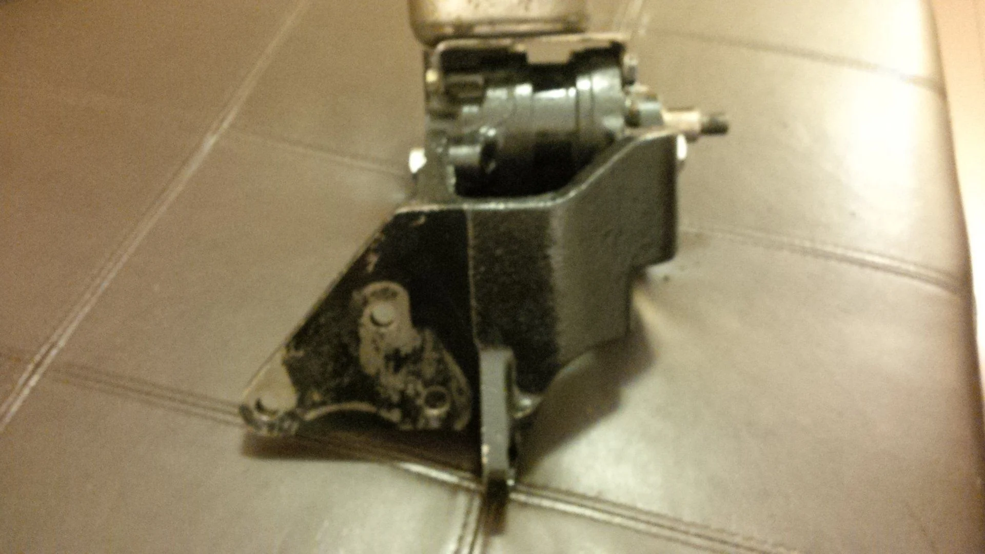

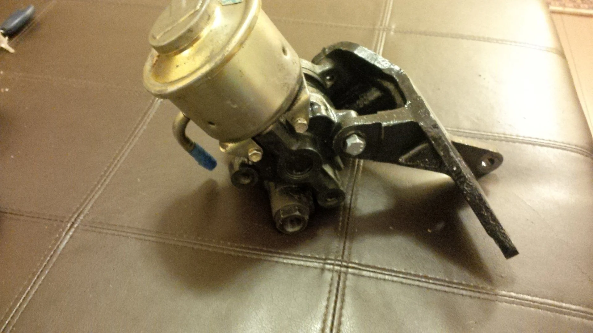

Please remove the pulley and post pics/ measurements of it. Pics of the pump and bracket would be a great idea as well.

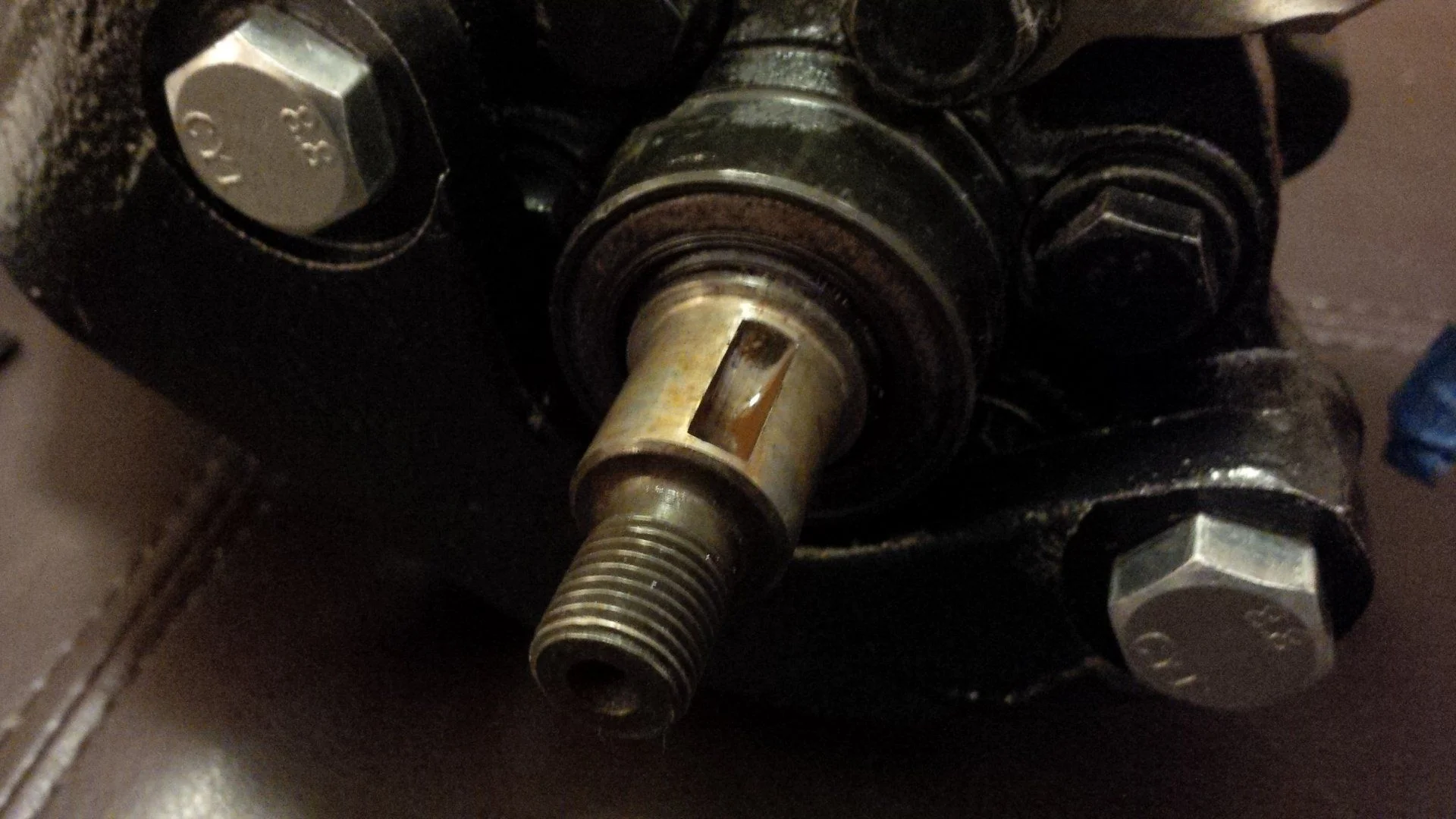

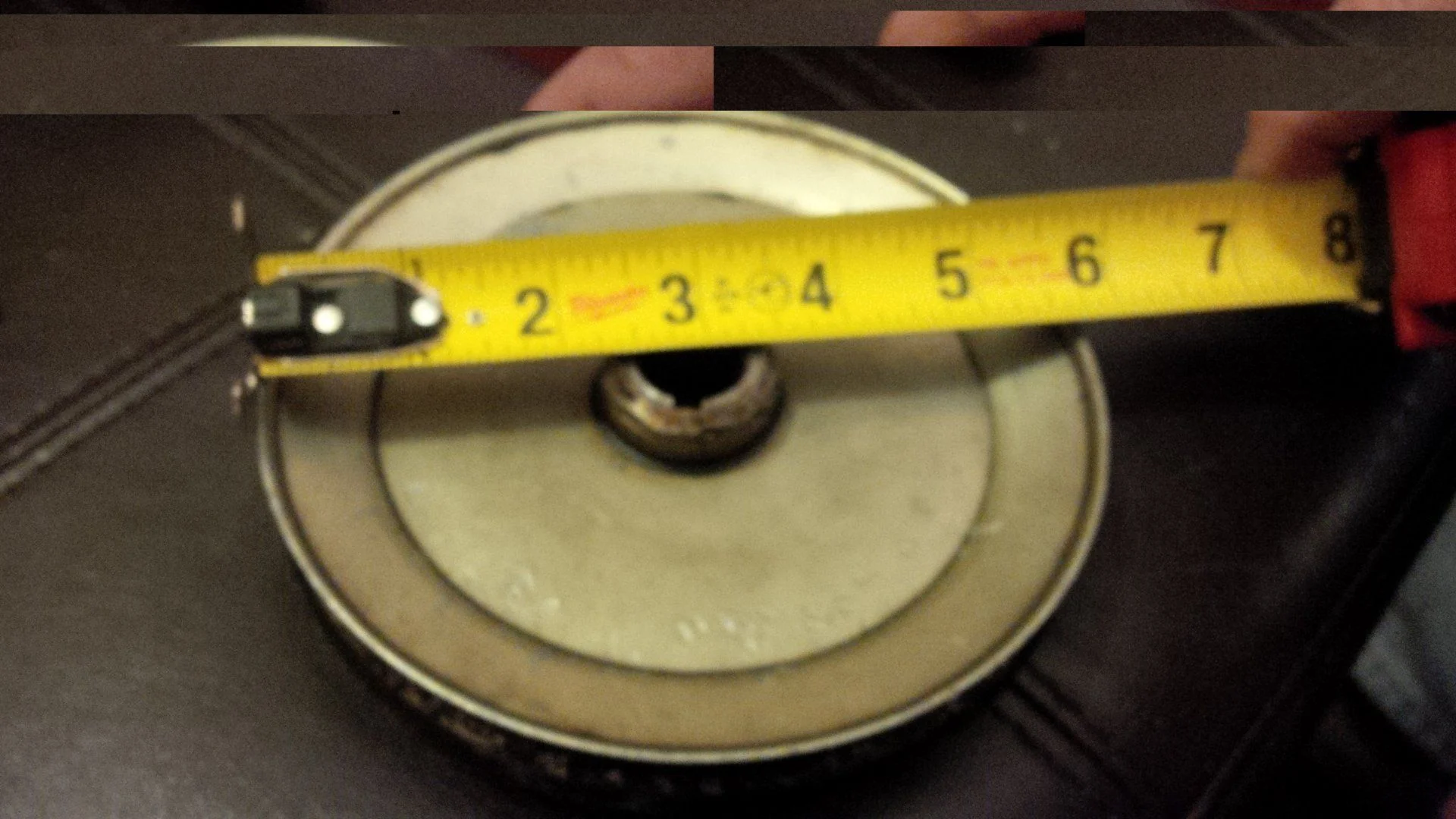

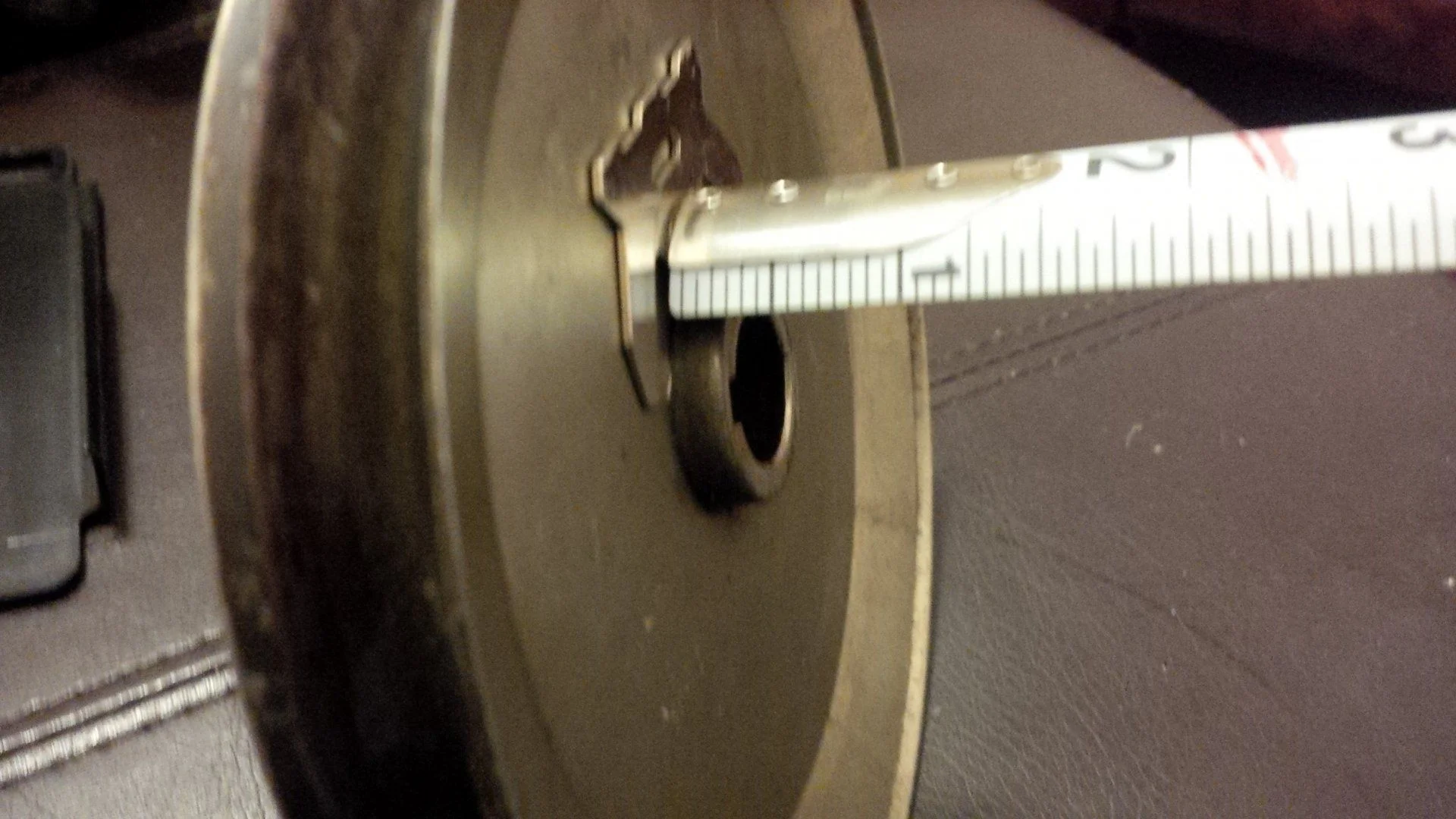

Georg, here are the pics you requested. Please let me know if you need more.
full
full
full
full
full
full
full
full
full
full
That's perfect!
I'll check tomorrow morning.
When I sold you the pump, there was no pulley on it. But I knew the pump and bracket came off an FJ60. I grabbed the pulley from my box of ps pulleys for the same setup. Maybe I had an oddball pulley in there?! I guess we'll find out tomorrow.....

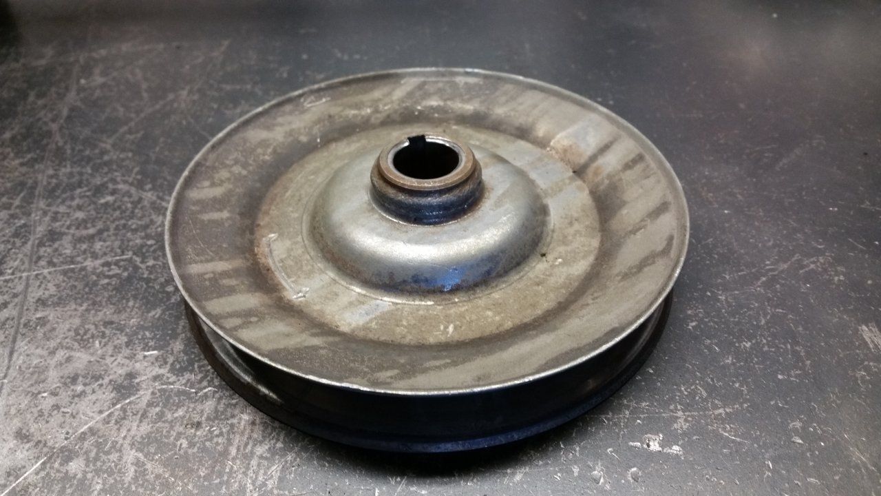

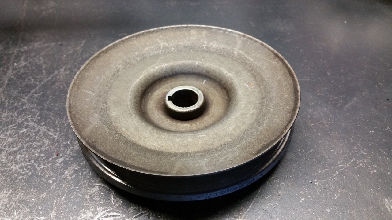

Here are some photos of the correct pulley.
Roma, Yours looks like the correct pulley for an FJ40, thanks for all the pics! I need a pulley just like yours.

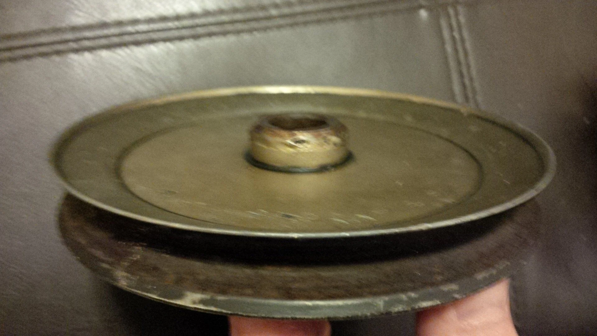

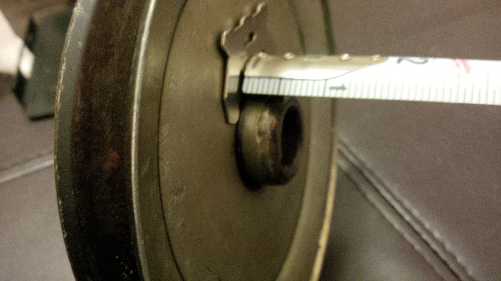

Here are some add'l pics with measurements of my pulley.
The back side of the pulley :
Front side of the pulley:
Clearance along belt (.5cm / 1/8"):
My guess is the wrong pull was a mini truck or something, much deeper step in the proper pull....

@ErikinSC Erik thanks for the verification and pics! That's the culprit.

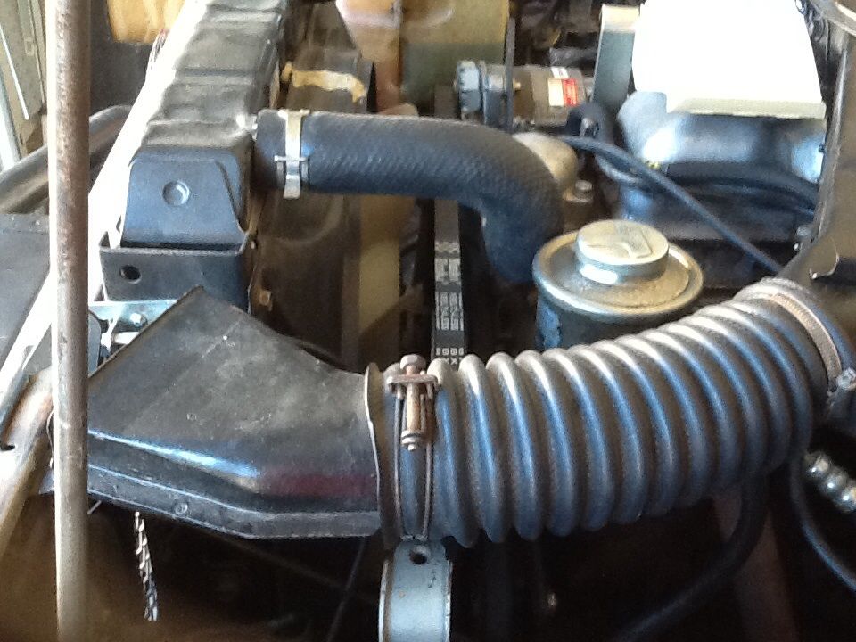

FWIW - My $0.02 worth, take a look at Danny's, Erik's, and your upper radiator hose. I would suggest to get the same one as Danny's because it places the downward bend further away from the radiator, thus further away from the Crank/PS/Alt belt. Here have a look at all three below.
Danny's:
image-jpg.1031081
Erik's: (seems to be possibly installed backwards? But apparently works.)
image-jpg.1031076
Your:
