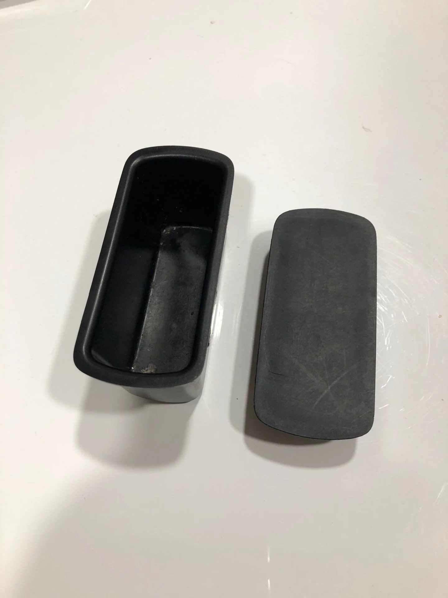

When no-AHC poverty isn't enough...you can get a blanking panel. (Insert your own empty pockets joke here.) This came out of a wrecked '98. (Pocket that's more common on an LC shown next to it for reference.)
Swapped my pocket over to the blank 58839-60020 when I installed the ScanGauge II mount from @CruiserGarage

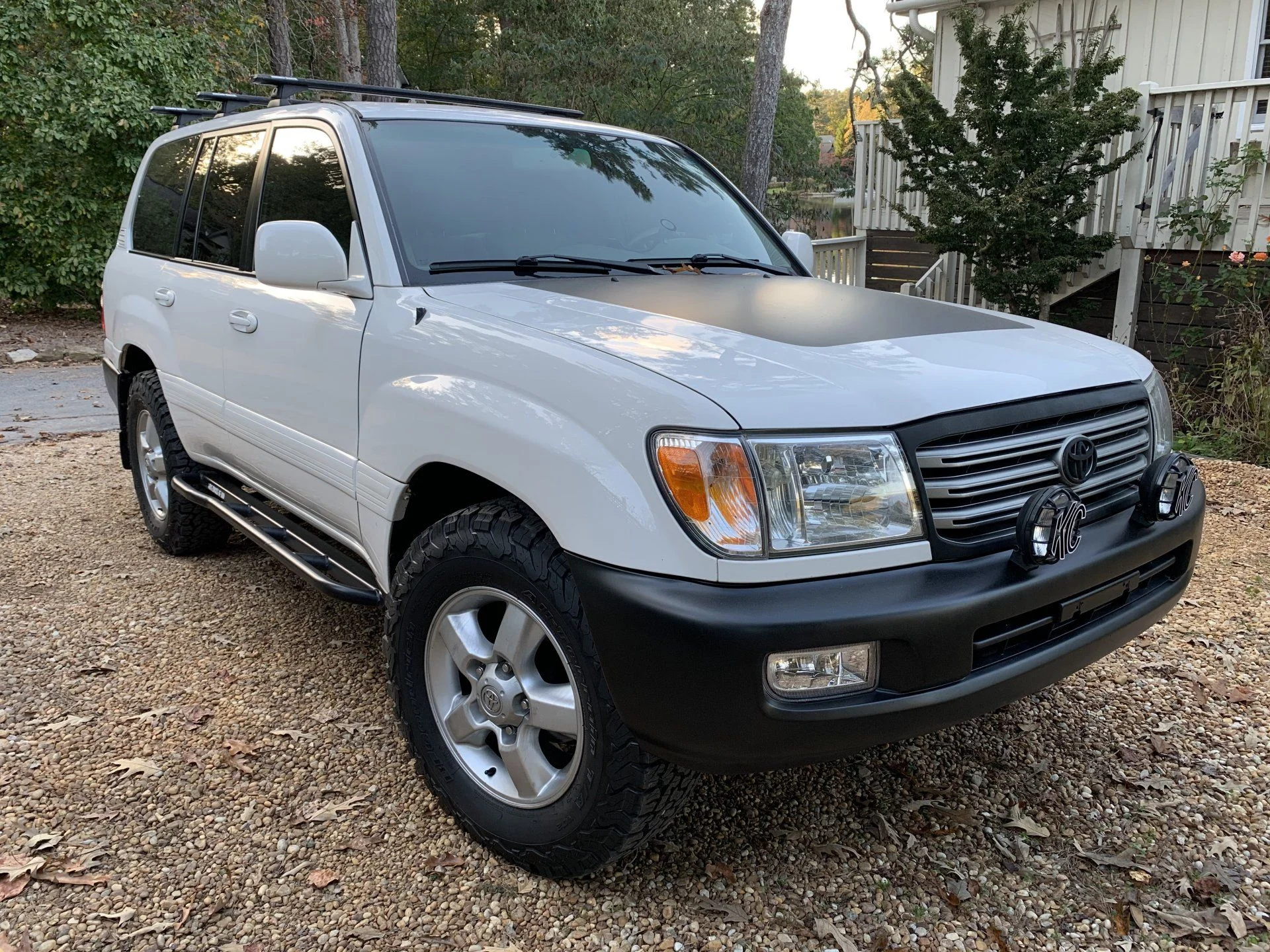

Champagne is definitely not a poverty item - or color. Repainted bumpers with a matte Rustoleum bumper and trim paint. Happy with the look. Just hope the paint holds up. View attachment 2473338View attachment 2473339View attachment 2473340
You need a black grill and delete the fog lights and remove the side mouldings to get a true poverty pack look also normally on those the mirrors will usually be matt black manual mirrors with chrome door handles and the chrome mouldings around the windows would be matt black with the shiny plastic part on the b pillar and around the top of the glass color matched to the rest of the door (in your case white)
