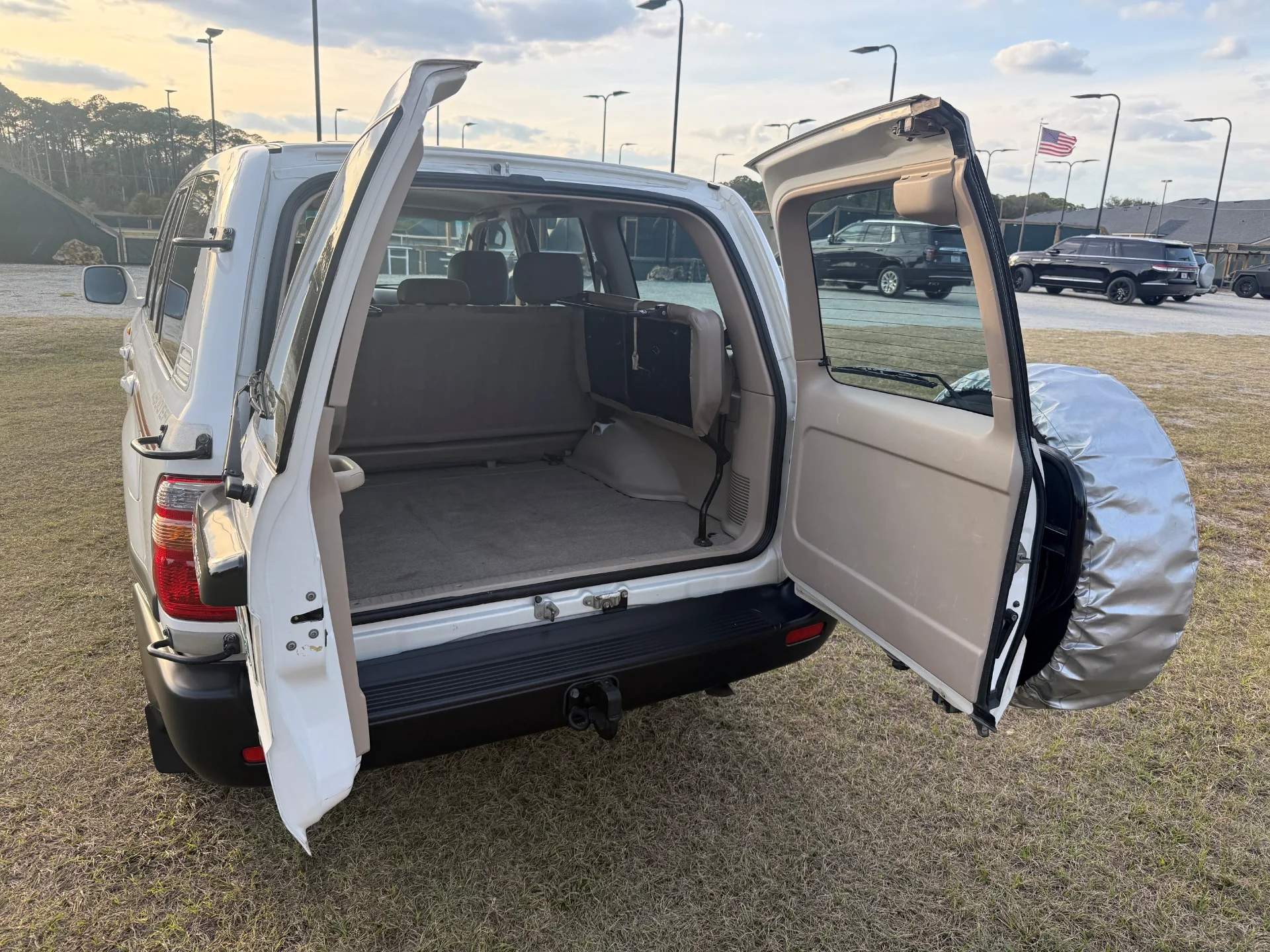

Here's my low spec 100-series from the Middle East. Comes with Cloth seats, no CD-player, steel wheels, black hardened plastic front and rear bumpers, no sunroof, and 5-speed manual transmission.
I like that rear jump seat
