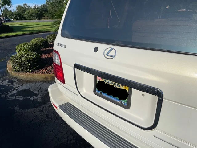

Worth a shot, but any of the 100 series come without a rear wiper and just a plug in its place? Dont think I've ever used my rear wiper out of all my 100's over the years. A lot of delete plugs out there with various sizes but thought I'd check to see if there was an OE part to go in its place.
I've been using this rubber plug made by Honda for years:
OEM Rear Wiper Block Off Delete Plug Grommet Cap For Mazda3 MAZDASPEED3 Scion xB | eBay - https://www.ebay.com/itm/323508153003?fits=Make%3AHonda&epid=1522119462&hash=item4b5296aaab:g:~gIAAOSwTm9aS-ON
It's a perfect fit @ 32mm.
I think @jerryb has a metal one that he painted to match that looks nice.
hmm they have a rear wiper delete kit for my Golf wonder if that'll work on this
you have to measure the outside hole and inside. It's not as easy to find one that works. It's not exactly flat on the inside. Normal ones had on ebay domestically weren't good enough for me.
I went through three metal ones before i found one. I cannot read my ebay from 4 years ago to say who it was from. I think the netherlands though.
Thanks Jerry. I'm going to roll the dice on the Honda one since it looks like it can conform a bit and has that nice inner lip to seal it up.
Ironically i used to buy these in the early 2000's when I would build out my JDM hondas. full circle.

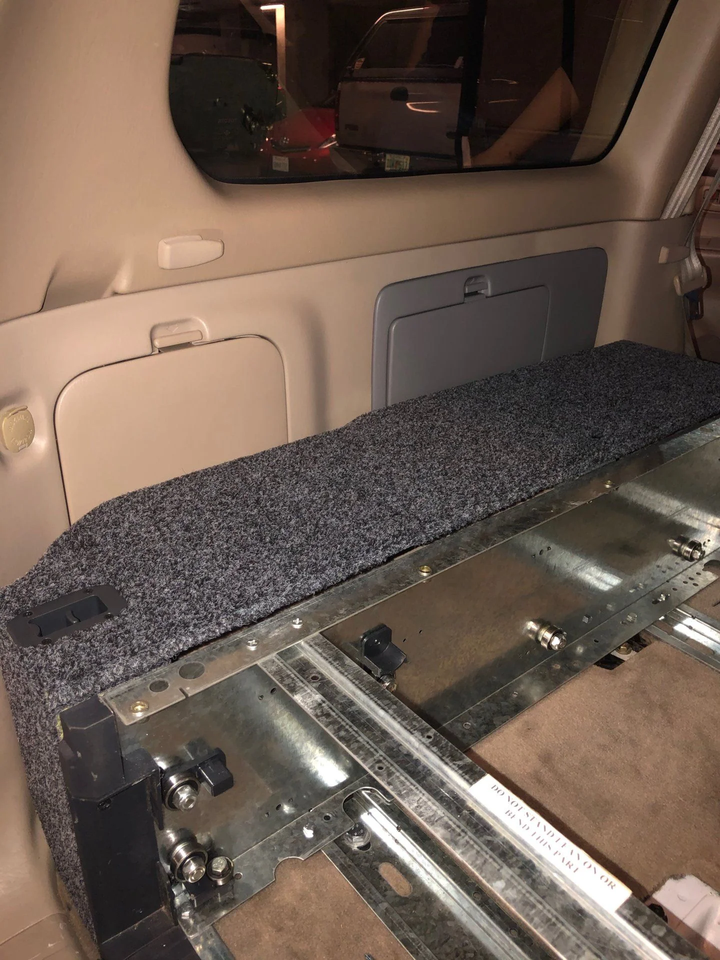

It's a winner. Slightly blocked by my ARB drawers but you can still get the cover in and out as long as what's in the pocket won't immediately fall out.
View attachment 2232579View attachment 2232580
Is this usefull ? I mean, Is the volume interesting? Can you give me an idea of what this can accommodate? If we can believe this to be a "universal" measure, how many boxes of tissue can fit into it? You are free to give another reference ;)

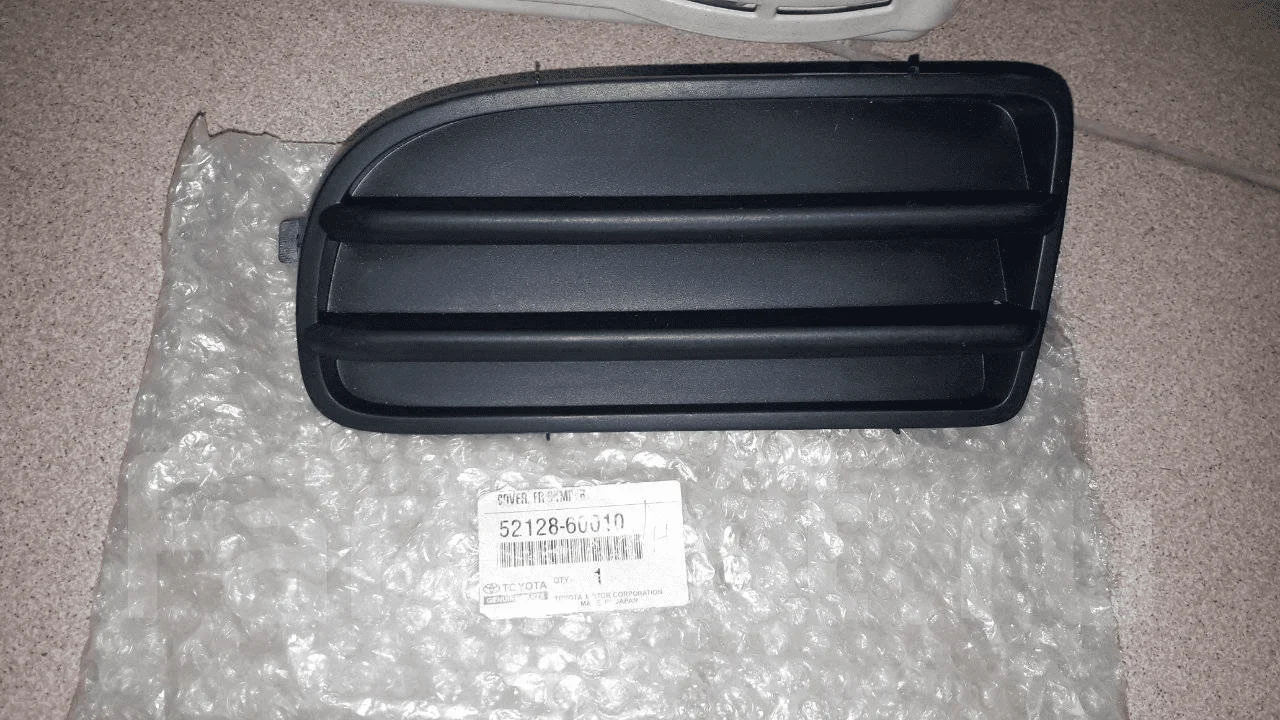

Foglight Delete Covers
52128-60010
52127-60010

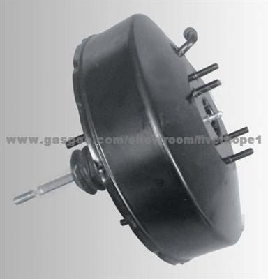

Electric Brake Booster/ABS/ATRAC Delete
-I have not seen anybody do this mod yet but somebody might be interested! I checked and Toyota uses these components with our same brake calipers. It would also require a F/R proportioning valve. Not sure how one would deal with the ABS/ATRAC errors.

So, I have been contemplating doing the abs delete/vacuum booster for a year now. I have been driving the LX without ABS for a long while now. Most of my vehicles over the last 30 years have been deleted or never equipped. While my ABS has be out of commission i have seen little to no negative affects, including snow and rain. Even with a few threshold braking moments I have never had any moments I wish i had it.
Anyways, The master and booster are the easy part. The rear proportioning valve assembly is the issue since there are a lot of components that go into the oem LSPV system and some of which are NLA. I doubt anyone else here has completed the conversion. I'm thinking of just adding in an adjustable valve that I can fine tune the rear bias. I know it won't be as designed and maybe a slight drop in total braking performance but it should be close.
I have worked with a lot of proportioning valves on my personal street and track cars, and while working as a race mechanic. Those environments see a lot of threshold braking and the systems work quite well.
Air-cooled 911's/944/928 I've worked on have a small preset valve in the rear lines that works extremely well. Porsche listed the bias ratio, which I don't recall, but I've considered adding this to the equation. Standard, the aforementioned run a 60/40 split and they offer 4 different units that will increase the rear bias as needed. Based on the numbers I have regarding the LC/LX brake specs and added into a bias calculator, these trucks have approx a 75/25 front to rear bias. Adding steel bumpers, tires carriers, etc to the rear and substantially increasing the rear weight will allow for more rear bias.

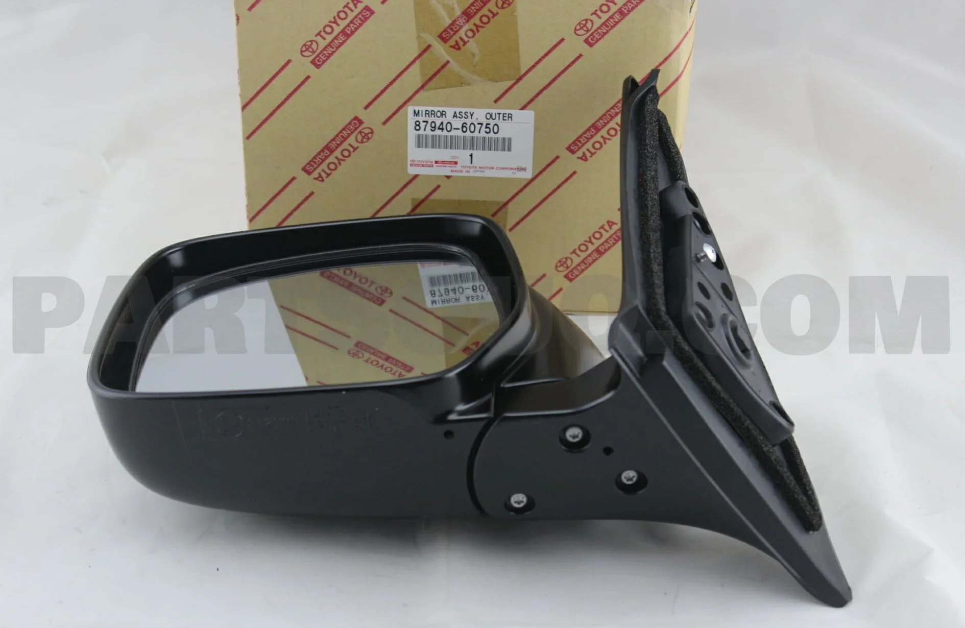

Non power black plastic mirrors
8794060750 LH
879106A050 RH
Was looking to replace my janked finicky power mirrors with these but the last set I could find just sold. Amayama doesn't list as out of stock but I can't see them getting any if no one else has them.
A company out of Oz sells manual repro's for a very nice price, and has sold a lot of them. Would prefer to spend a bit more for the OEM but looking like it's not an option.
@kevgentile Most folks with modded 40/60/70/80's report better brake feel when they delete the LSPV. I don't know if there's was internally rusted/clogged or the decline in performance was due to the change of suspension springs, vehicle weight, etc. Anyway, I do have ABS/LSPV delete in my 70 series along with the rear proportioning valve and can say the brake FEEL is really good. Good feedback and response. I don't know if I would give up the higher brake boost and Electronic Brakeforce Distribution of the 2000+ years for it though.
My T1N Sprinter had a similar load sensing system. I tore it out and lot of other components due to rust, and it causing a lot of inops.
I have to admit that the braking performance in my '99 is very good and I was very surprised at how good of a system it is once I got in it having spent so many years in German brands.
I'm sure there would be a drop in braking performance but probably marginal. Considering 99% of the braking is going to be well under emergency/threshold situations I would be willing to give up the current set-up for a very basic and near maintenance free one.
