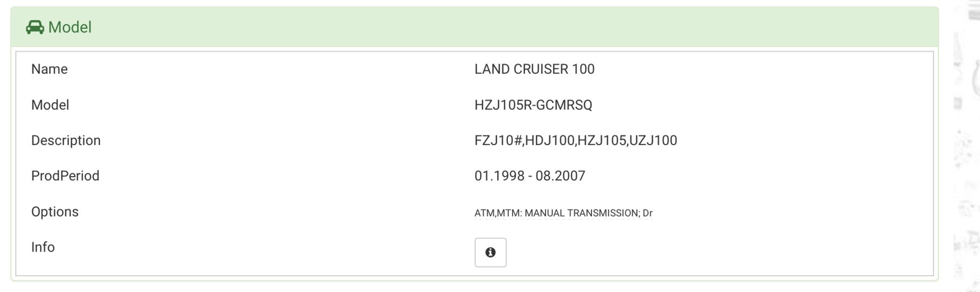

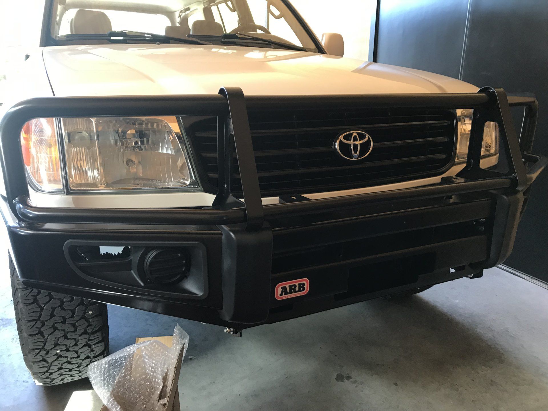

If anyone is interested in the factory 105 black grille for your Cruiser here are the part numbers for the three different variations. These versions are not available in the US so you’ll have to order from an overseas supplier, I ordered the 98-02 version from partsouq. I know some of paint yours and it's cheaper that way but I'm picky and wanted a factory all black version. I also attached pictures from the site to show the correct chassis code associated with the black grille and it covers all years.
98-02 5311160330
03-05 5310160260
06-07 5310160350
Looks so good
A white hundred with all black trim probably looks fantastic... are your side moldings black aswell?
Your truck looks great
I would love to see some more pics if possible. I have a gold and a grey, but someday a white with black trim land cruiser would be very cool.
@sr5pickup Grill looks amazing!!!

Ok, not sure what is going on but, when I put in my vin (2006) and a customers Vin (2007) on that site I get the 5310160260 part number for both. I also put in a customers vin for a 2004 and got part number 5310160270 ?? Let me know what you guys think.

Don't use Vins, it will give the part numbers for that specific vehicle. You will need to use the chassis code
FZJ105R-GCMRSQ
