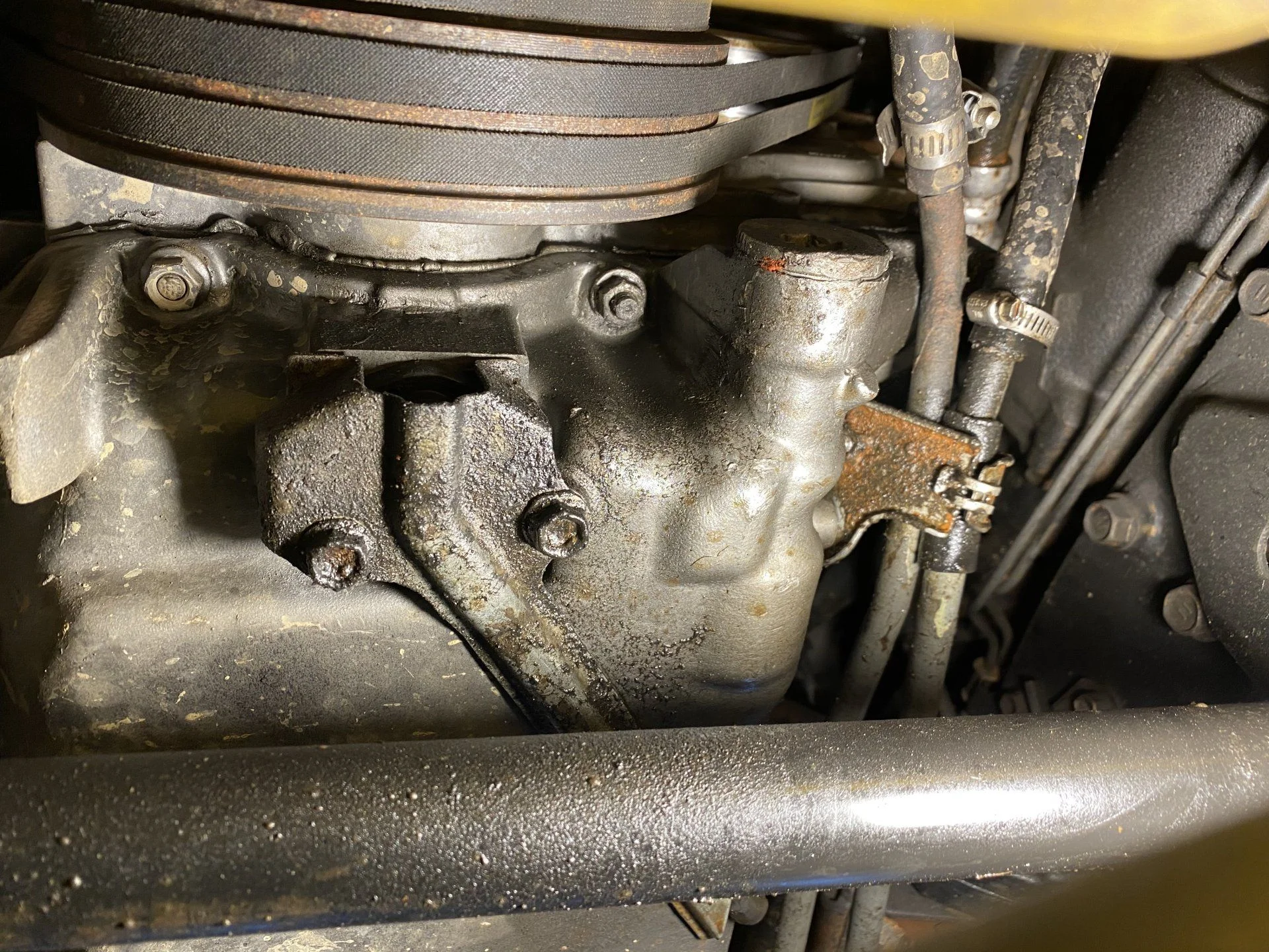

I was going through checking my breaks. Decided to check underneath my rig, dirty as hell lol. But I noticed there was quite a bit of liquid all over. A lot on the power steering pump, and some on the bottom of the oil pan. I think the liquid on oil pan is ATF fluid, but not quite shore. I checked my power steering fluid, and it was really low. Why I think it’s the power steering. What do you guys think? How can I test to see if the pump is leaking?

I just went through and tried to clean this area up best I could. Pain in the butt being under there and not getting drenched with everything lol

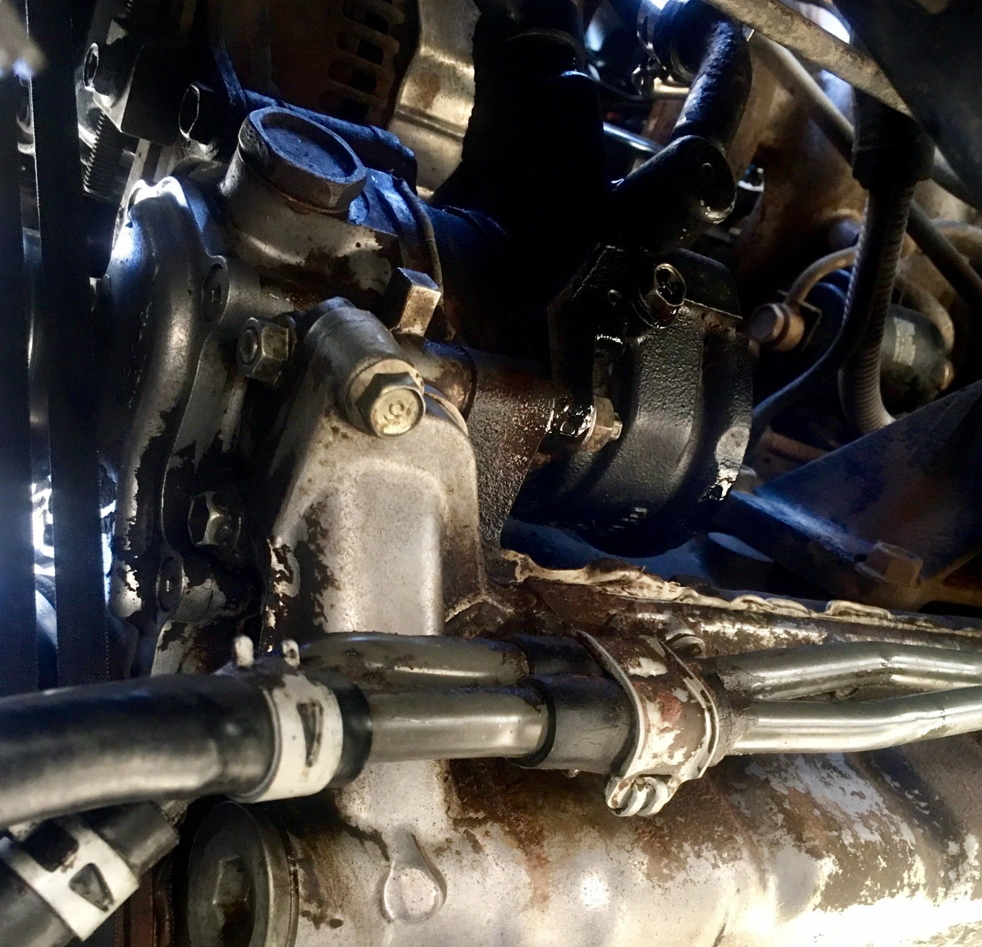

Went and ran the 80 for around 5min and kept turning the wheels back and forth and building some pressure. I don’t see anything immediate. What you guys see?
How does your steering gear box look? That could be leaking and the fluid being moved elsewhere while your driving.
i see a little residual from cleaning up but other than that it looks pretty dry. your going to have drive for longer than 5 min, we would usually tell customers to come back after a few hundred miles when trying to find a small leak. if it was wet after 5 min of driving im pretty sure that you wouldnt have an issue finding the leak.

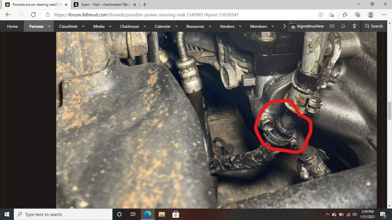

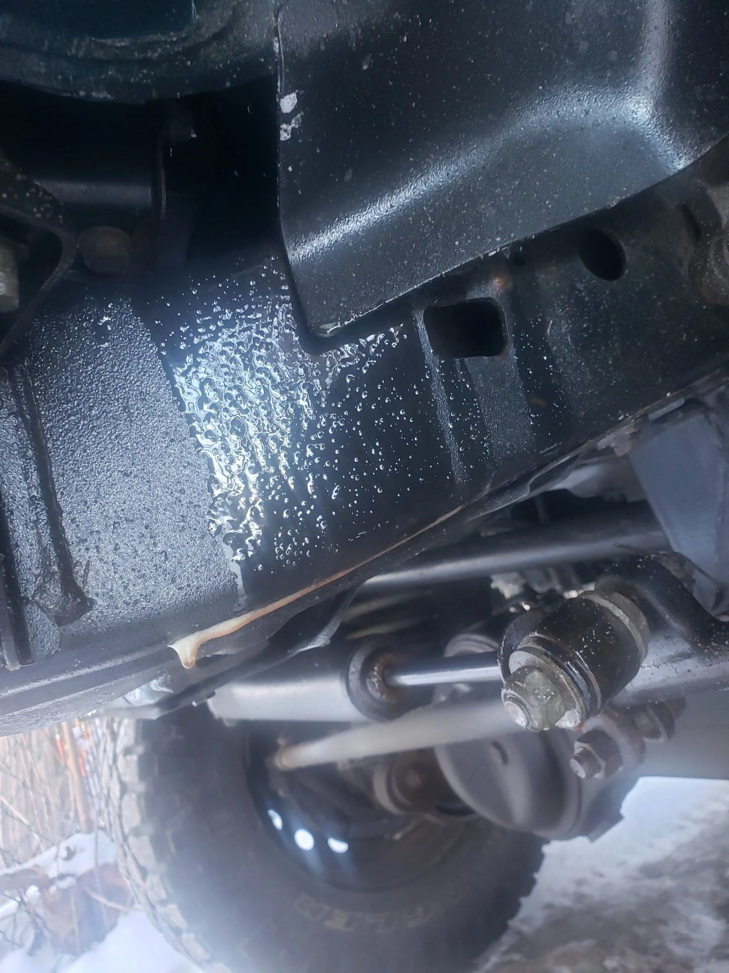

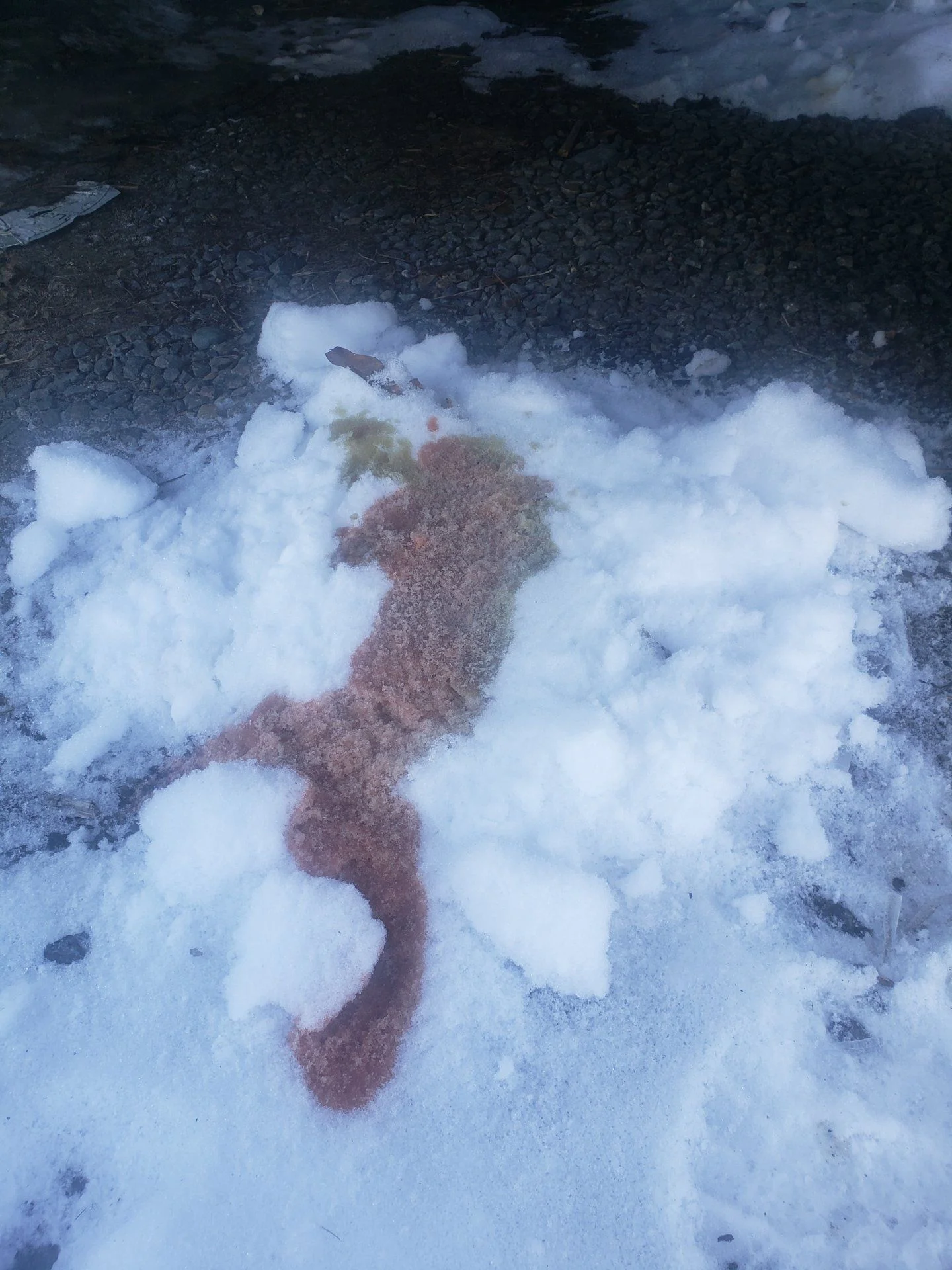

Here's a leak!
Low pressure side on my son's 80.

Oh that low pressure hose is a biotch!
She's done. Ended up using the Toyota spark plug tool to keep the hose straight and with the help of a compression and gear clamp was able to get the vertical section done by pushing down with a screwdriver against the clamp. Also was able to lever by using two screw drivers from the wheel well , easier to remove the other pipe with tire and skirting removed and put that end together rather peacefully.

Here's a leak!
WOW, now that really blows! Sorry to see that!

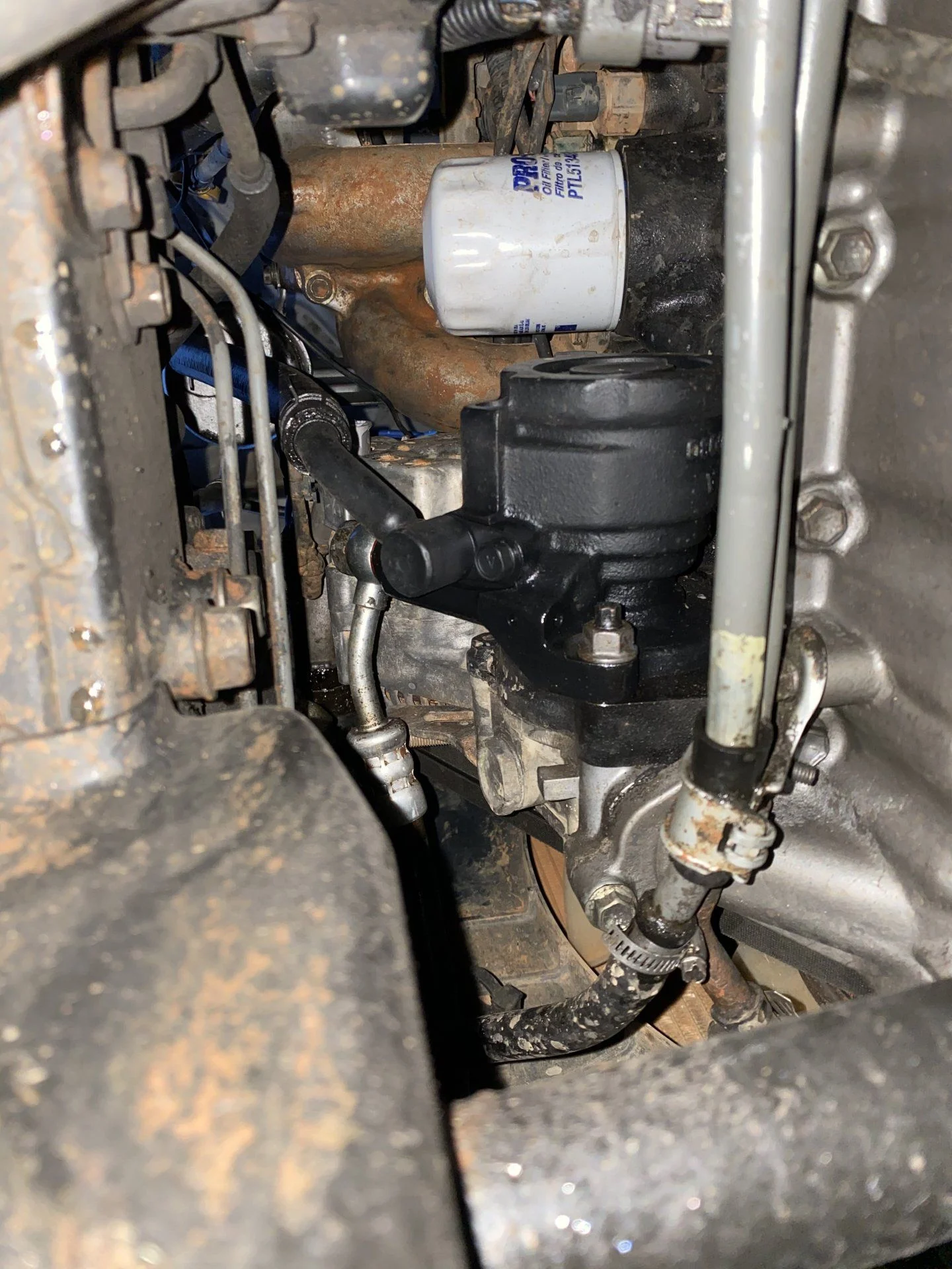

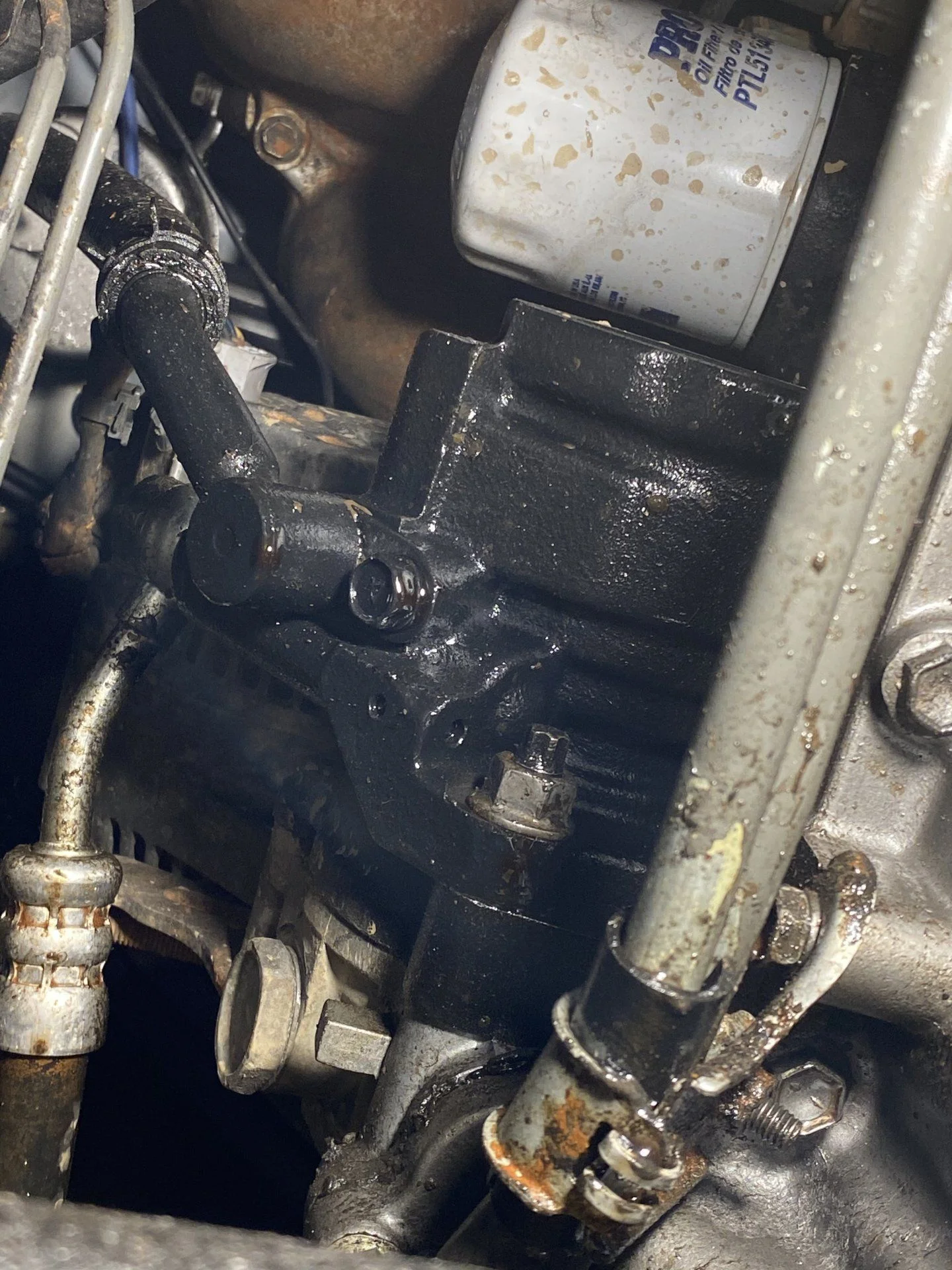

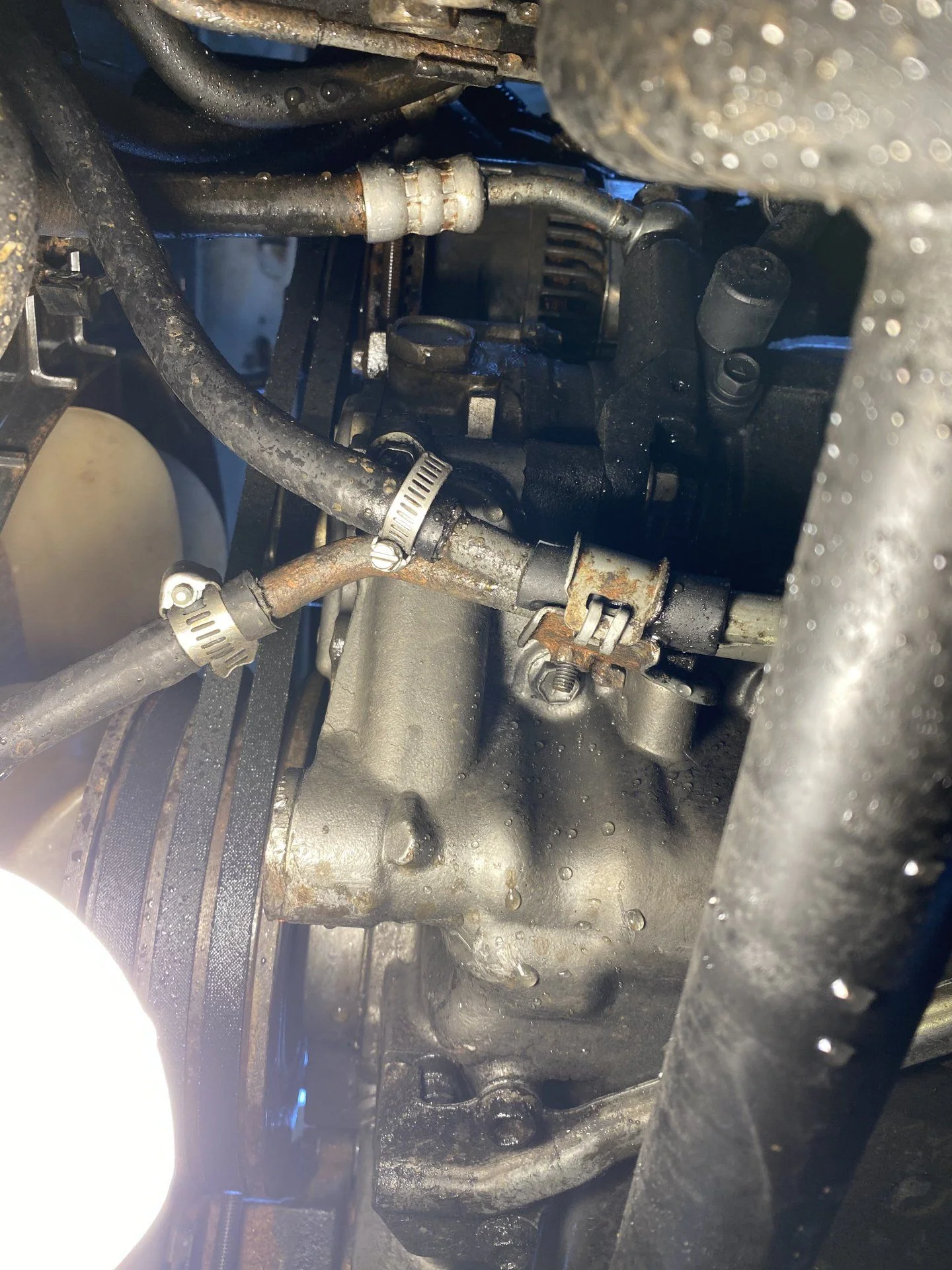

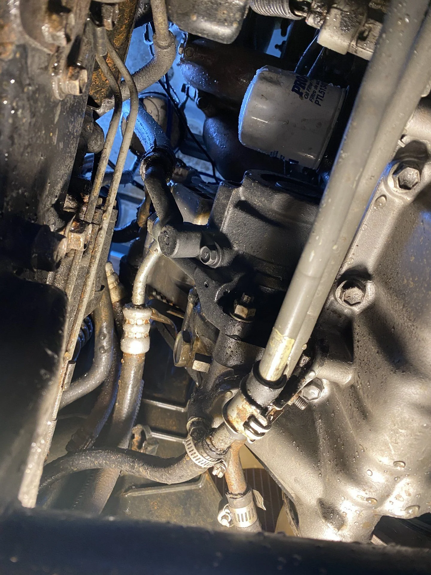

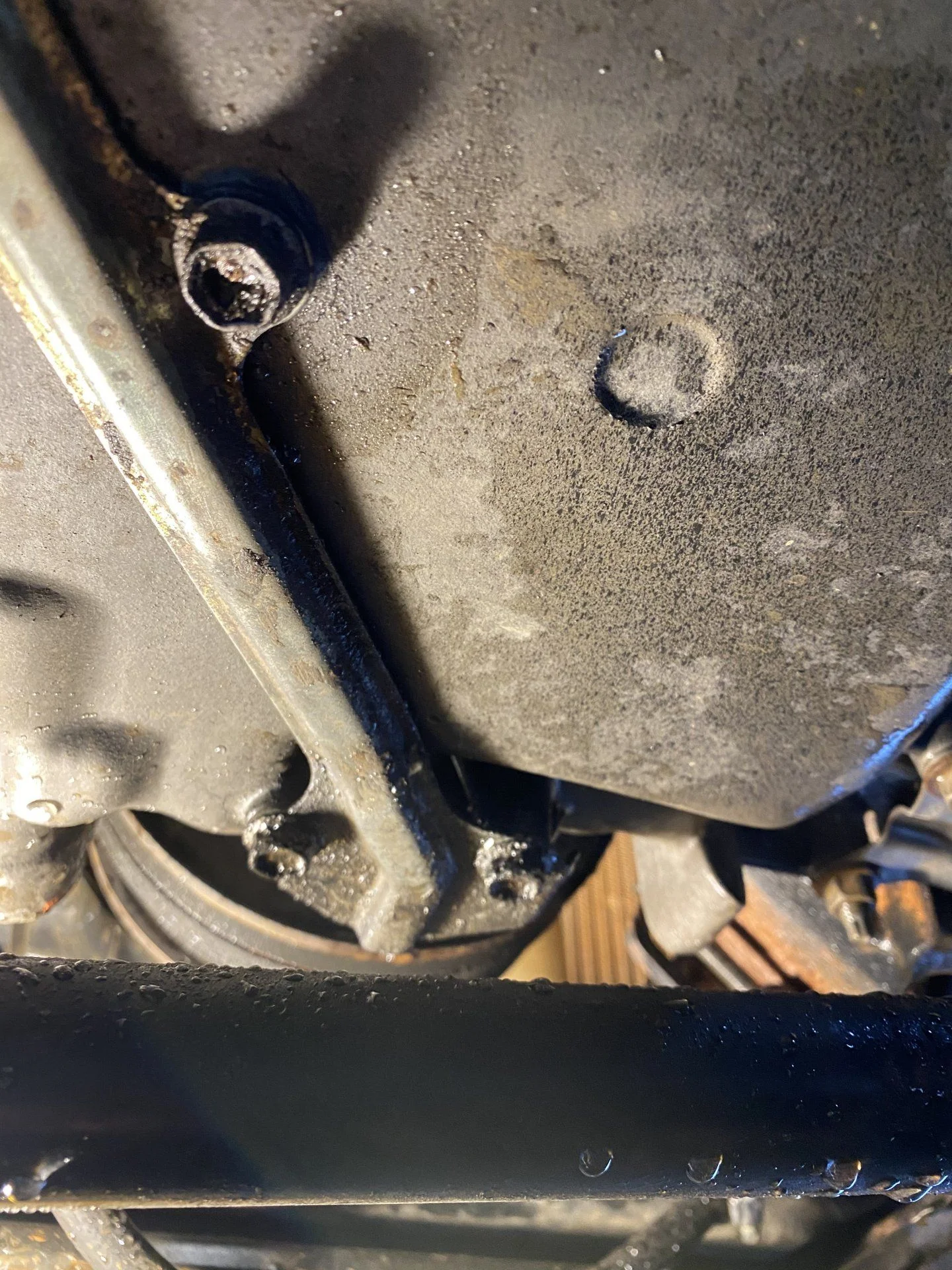

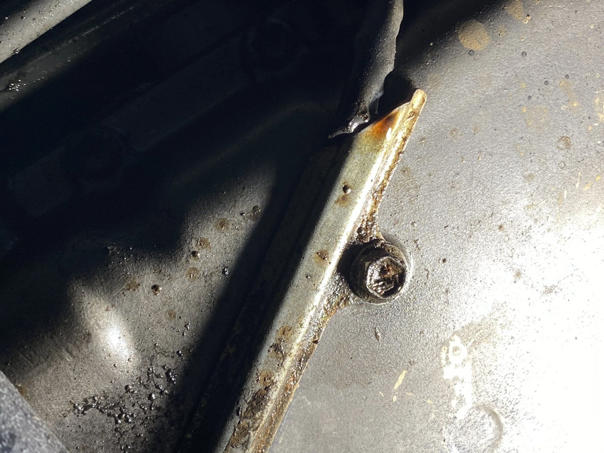

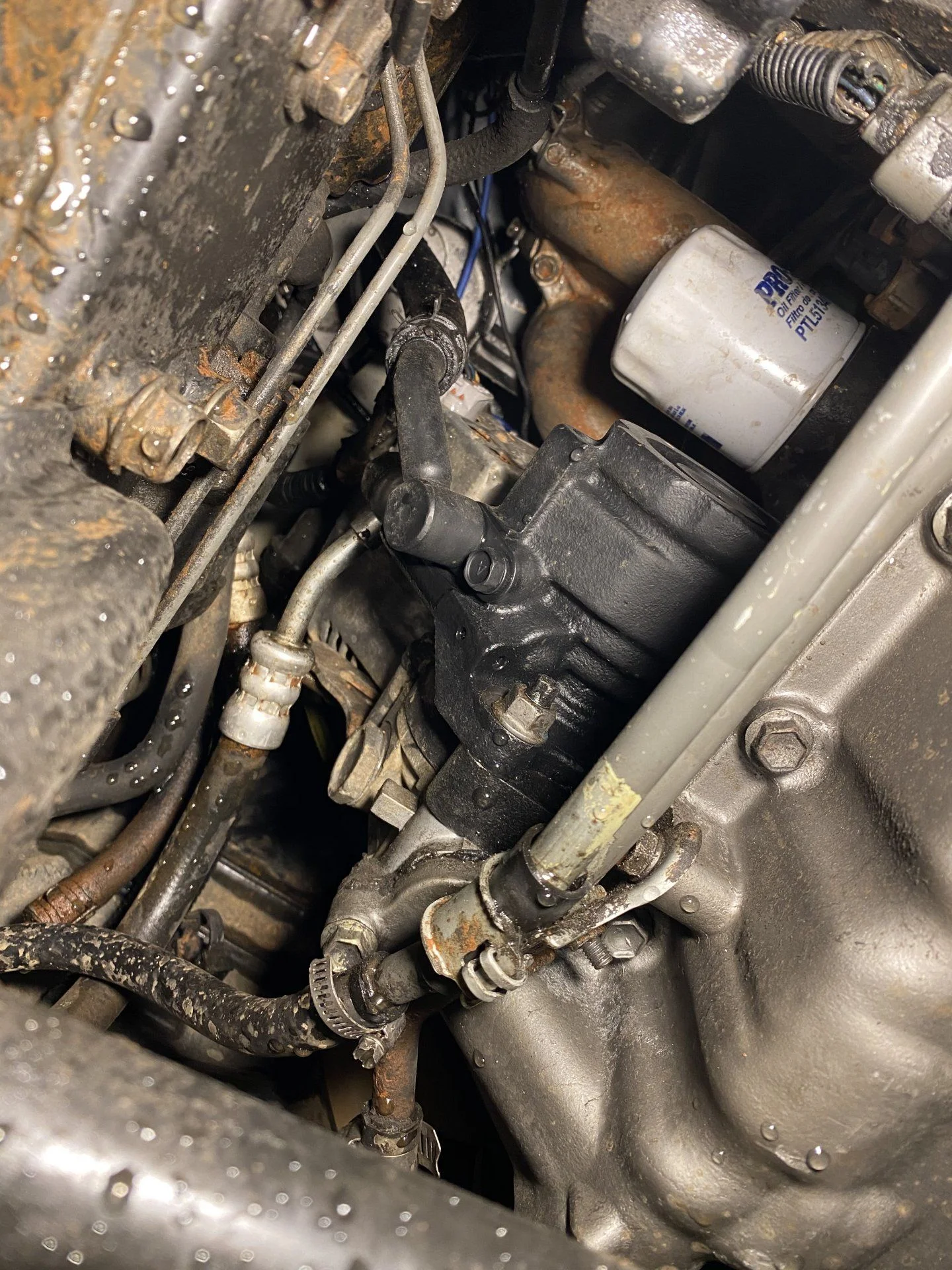

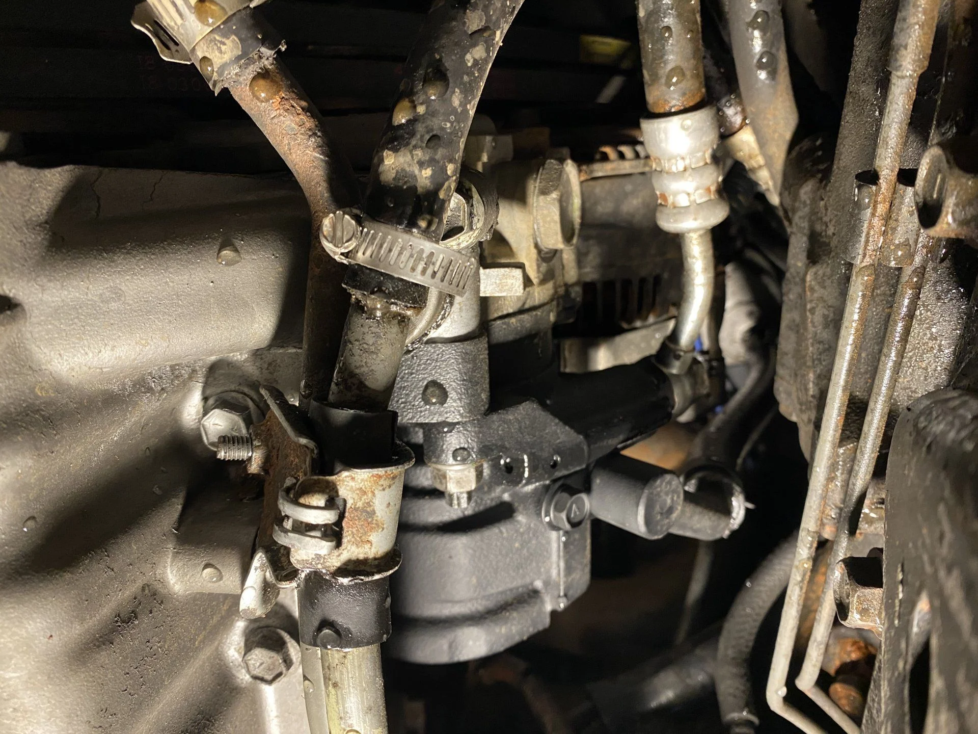

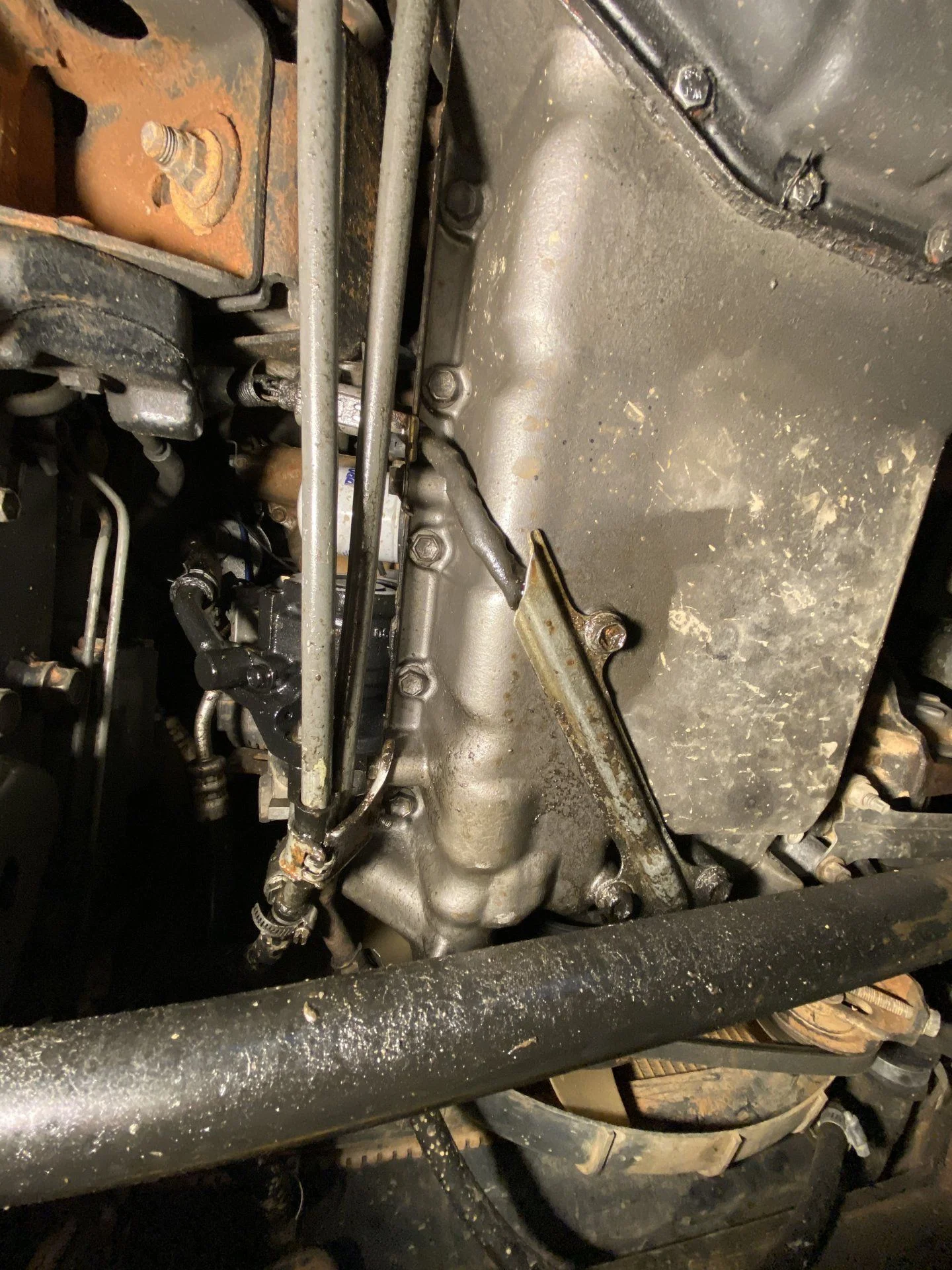

These are some pics I took after I got home from my 30min drive home last night. Sorry it was dark so I tried to do my best.

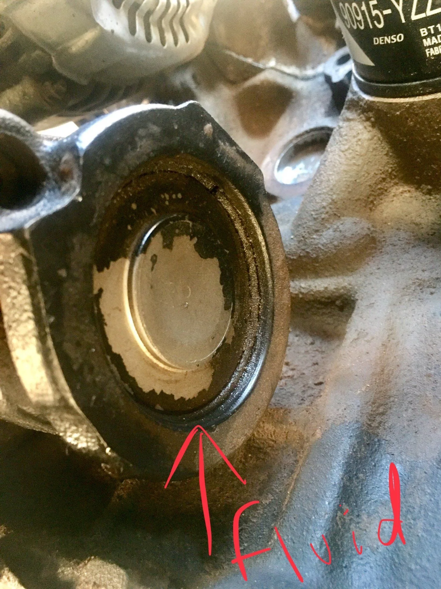

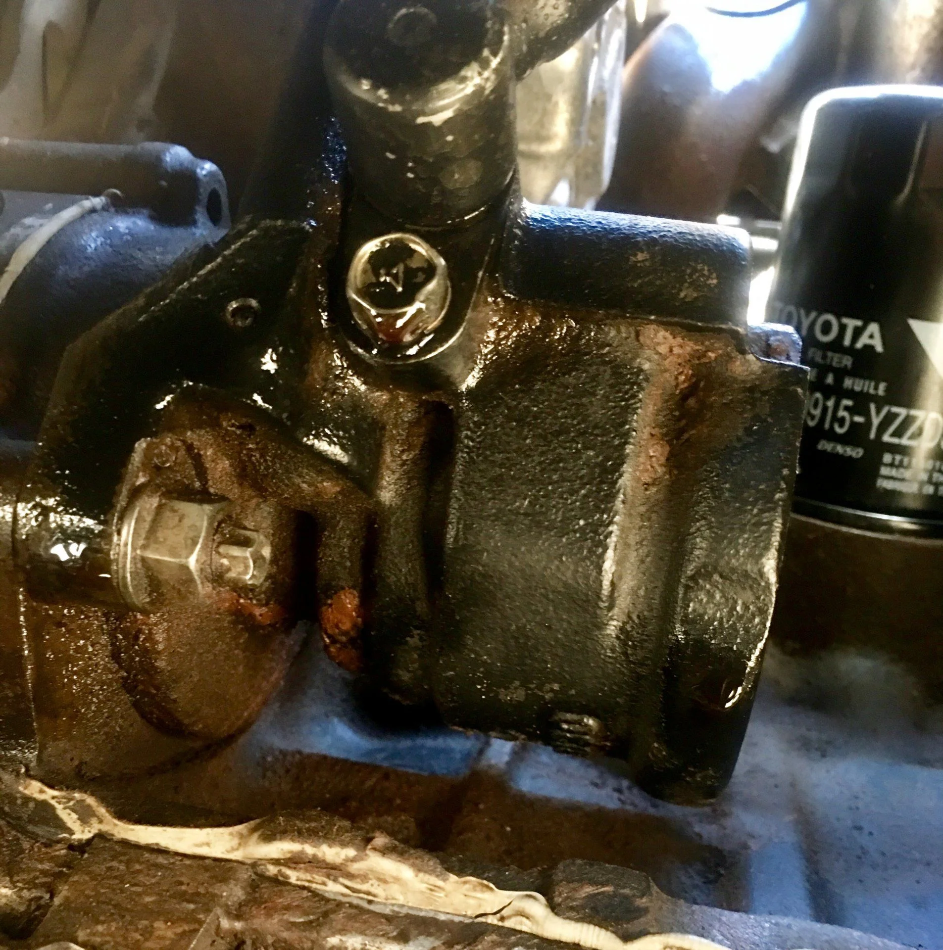

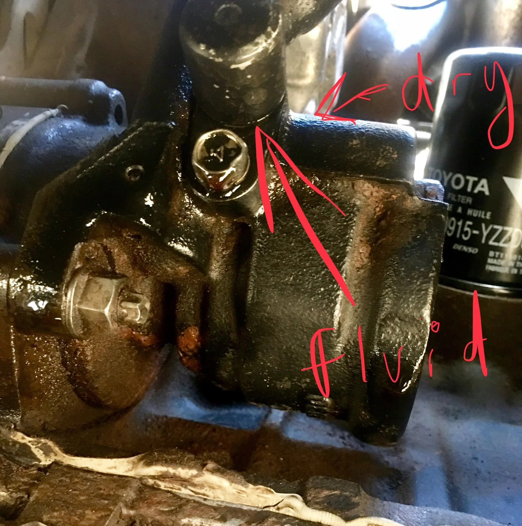

Just for reference, this is a ps pump leak. How I know is because I replaced the oil pump cover gasket, front main seal, distributor o ring, and low pressure hoses (which were crusty). After driving it for about 30 minuets this is what it looks like. Everything else above and around is dry. So will take off to rebuild and stop the hemorrhage. Just in case you are to replace the low pressure ps hoses beware the 3/8 lines are a pain to fit back in because they are 0.5mm smaller than oem and it makes a difference. Had to put them in boiling water and stretch before they went in. Also don’t laugh at my little stupid Toyota replacement oil filter.
Just for reference, this is a ps pump leak. How I know is because I replaced the oil pump cover gasket, front main seal, distributor o ring, and low pressure hoses (which were crusty). After driving it for about 30 minuets this is what it looks like. Everything else above and around is dry. So will take off to rebuild and stop the hemorrhage. Just in case you are to replace the low pressure ps hoses beware the 3/8 lines are a pain to fit back in because they are 0.5mm smaller than ome and it makes a difference. Had to put them in boiling water and stretch before they went in. Also don’t laugh at my little stupid Toyota replacement oil filter.
Thats really helpful! After cleaning mine and driving it home it seemed like my PS pump was pretty dry. Thinking it might be an oil leak cause when i got home and checked, it was low. I am parked on a hill so i cant say for sure. On the other side of the PS pump, is that the oil pump? New to the 80 platform so not sure what and everything is.
Very certain I have a couple of leaks on the pump. Everywhere else, dry
