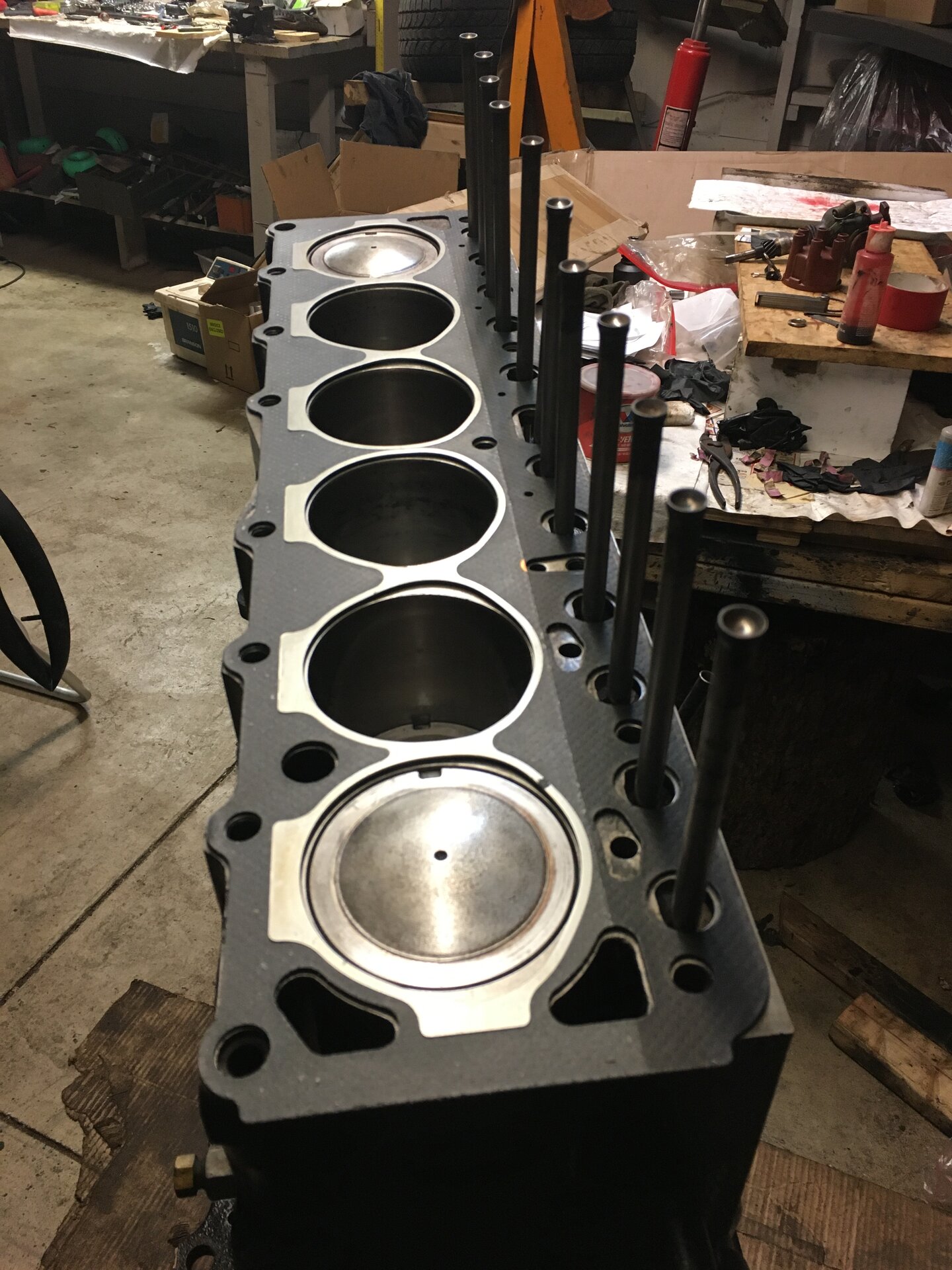

In my project, PO installed (and probably drive it) an older head (1974) on 2f (1976) with domed pistons.
But the engine is rusted and didn't start, I rebuild it,.. but never try to start or test it. I have found 1977 2F in "better" condition
this picture from this setup:
View attachment 3198520View attachment 3198521
Wow… that really looks great. Are those the original pistons and valves? Did you just clean and hone the block? What did you have done to the head?
I believe so. Someone swap this head for increased compression.
I have cleaned the block and hone it as much as I can.
But #4 cylinder wall still looks bad. The engine needs to rebore.
I clean the head and pistons and install new piston rings. I want to try it... but find a better engine from 77
the head is in better condition, I just cleaned everything.
