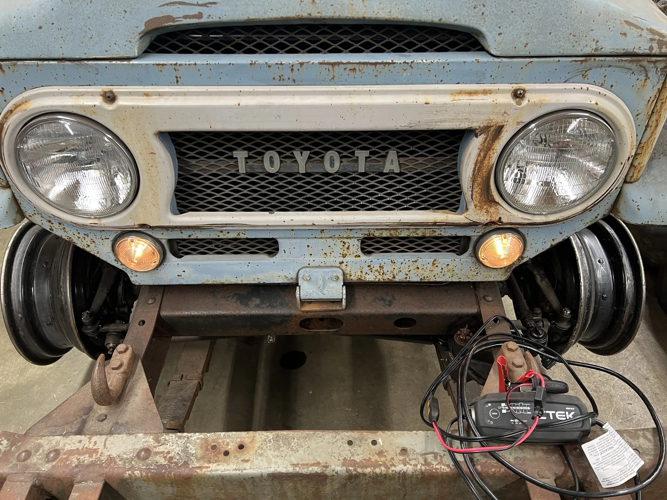

My milestone! First time lighting up the electrical system. Both headlights work!

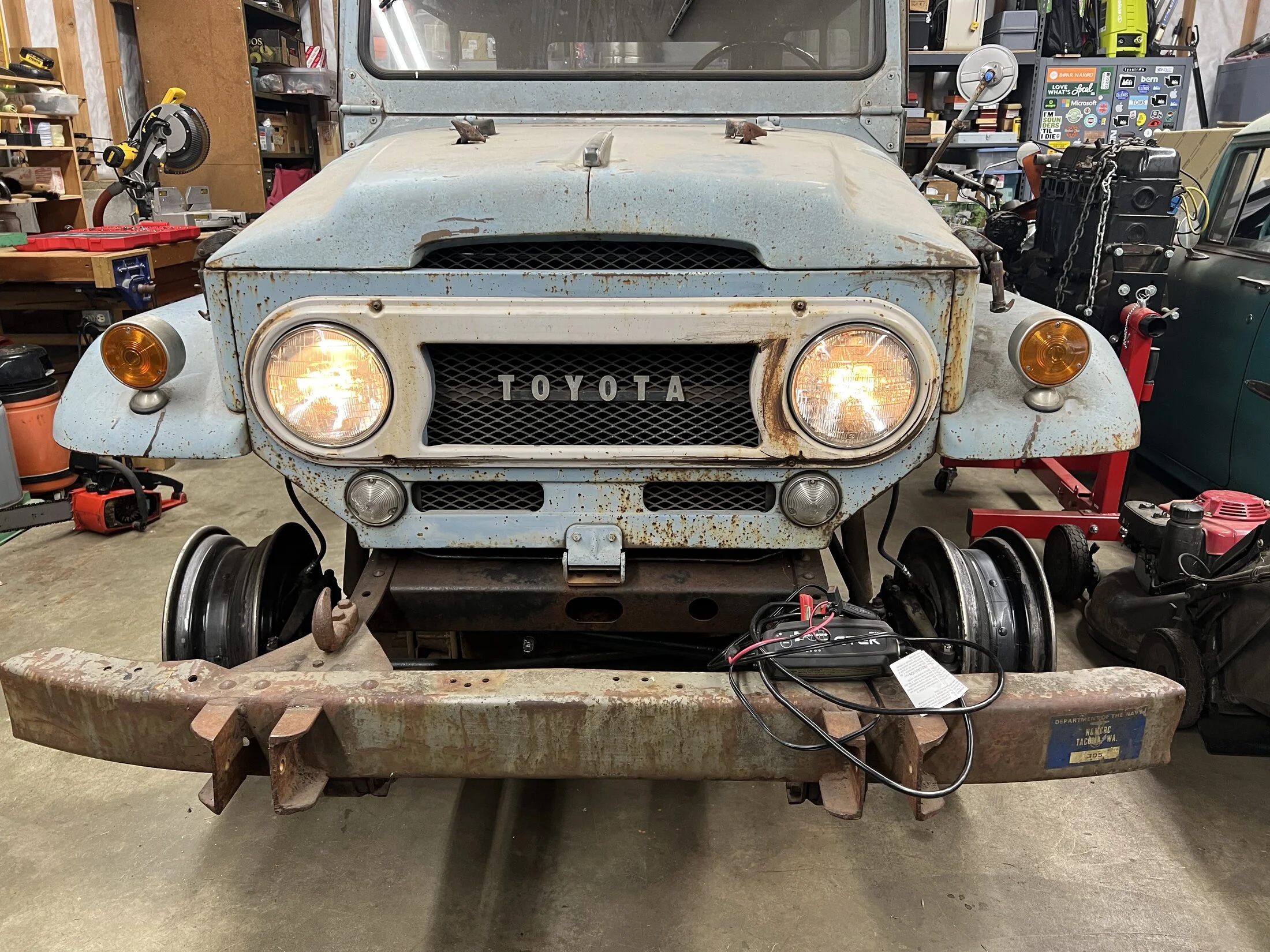

Bib lights cleaned and working. The passenger side was all crusty inside but cleaned up ok. I'm just using my stash of old bulbs for now. Maybe when I get really picky I'll look for a bunch of Koito bulbs.
The rear tail lights are not working so added that to the list. I also noticed that when I turned on the headlights, the bib lights turn off. I would assume they'd stay on like any other running light but I vaguely remember some post asking about this and it being normal. Another rabbit hole haha.

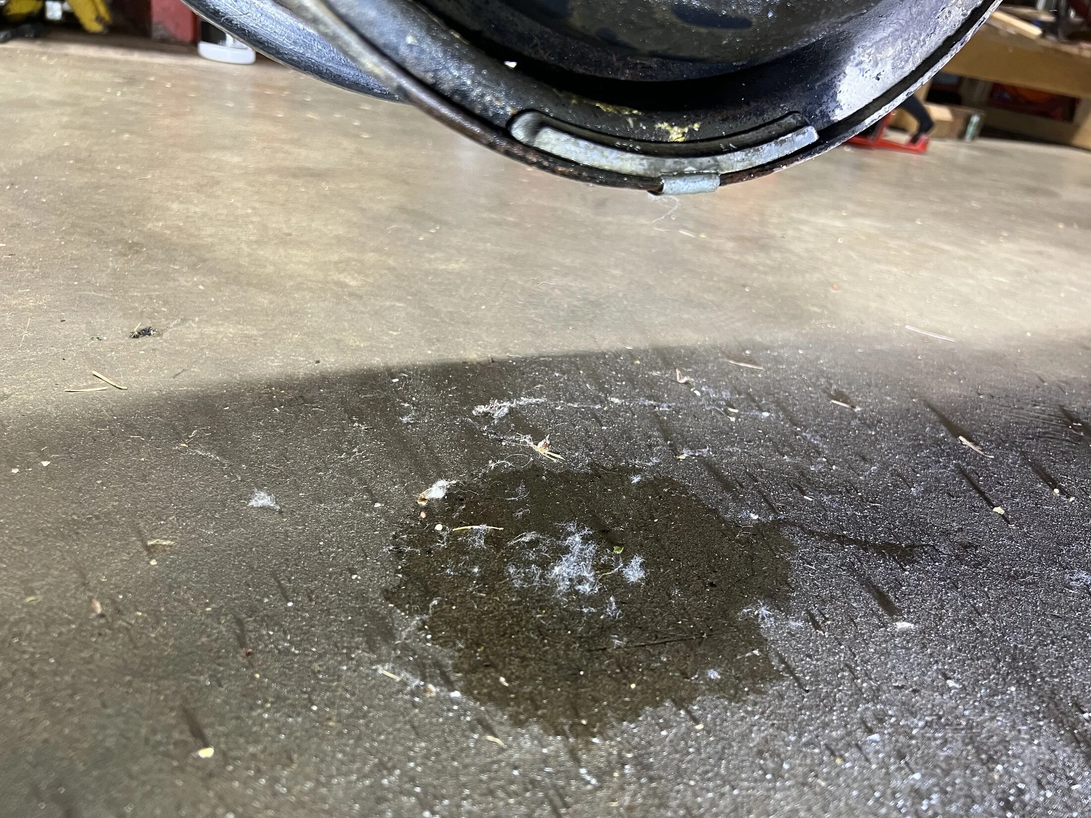

While this baby was sitting for almost a year, a leak developed or showed itself.

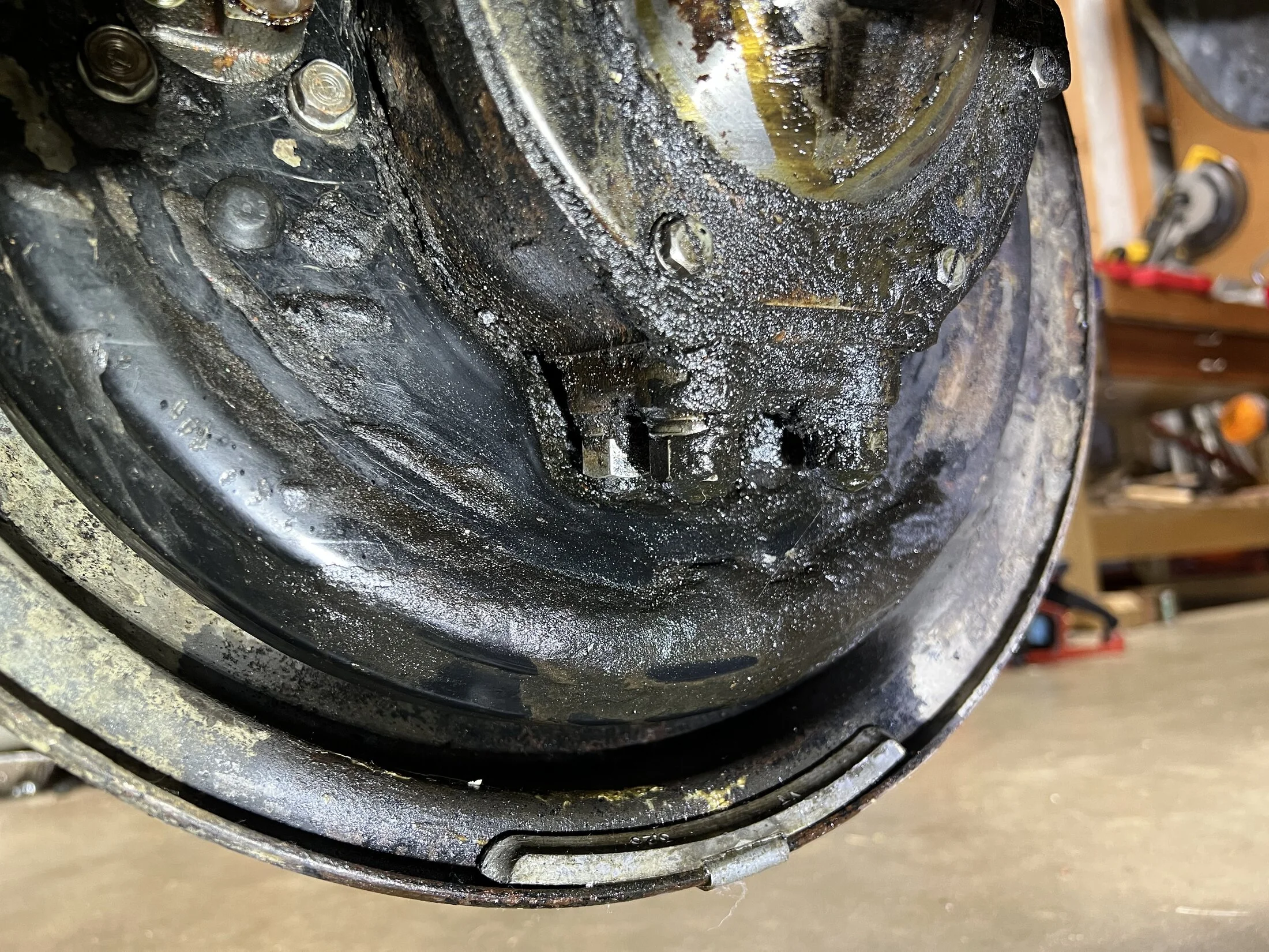

It has that oh so lovely smell of gear oil and from what I can tell it's coming from the birfields / knuckles.
The last thing I want to do is to get this thing running and driving and then have to park it again because it's leaking like a sieve so I plan to take care of things like this now. Time to go down the knuckle rebuild rabbit hole and put that on the list.
I couldn't get a good pick of the inner of the rim but it's dry. I'll be pulling it to inspect, but all that wet stinks to high hell of gear oil.

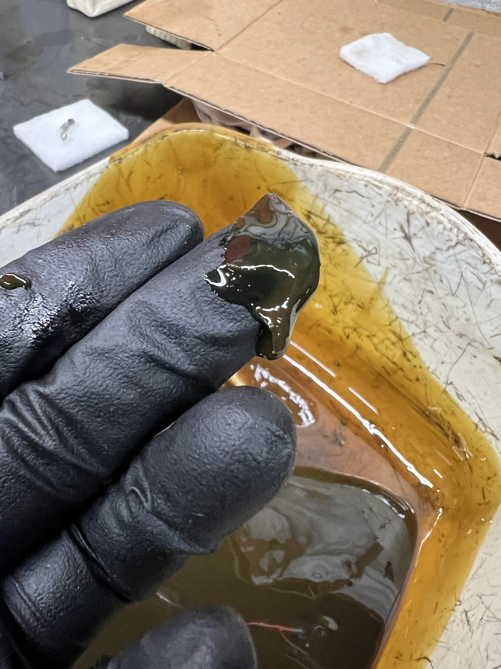

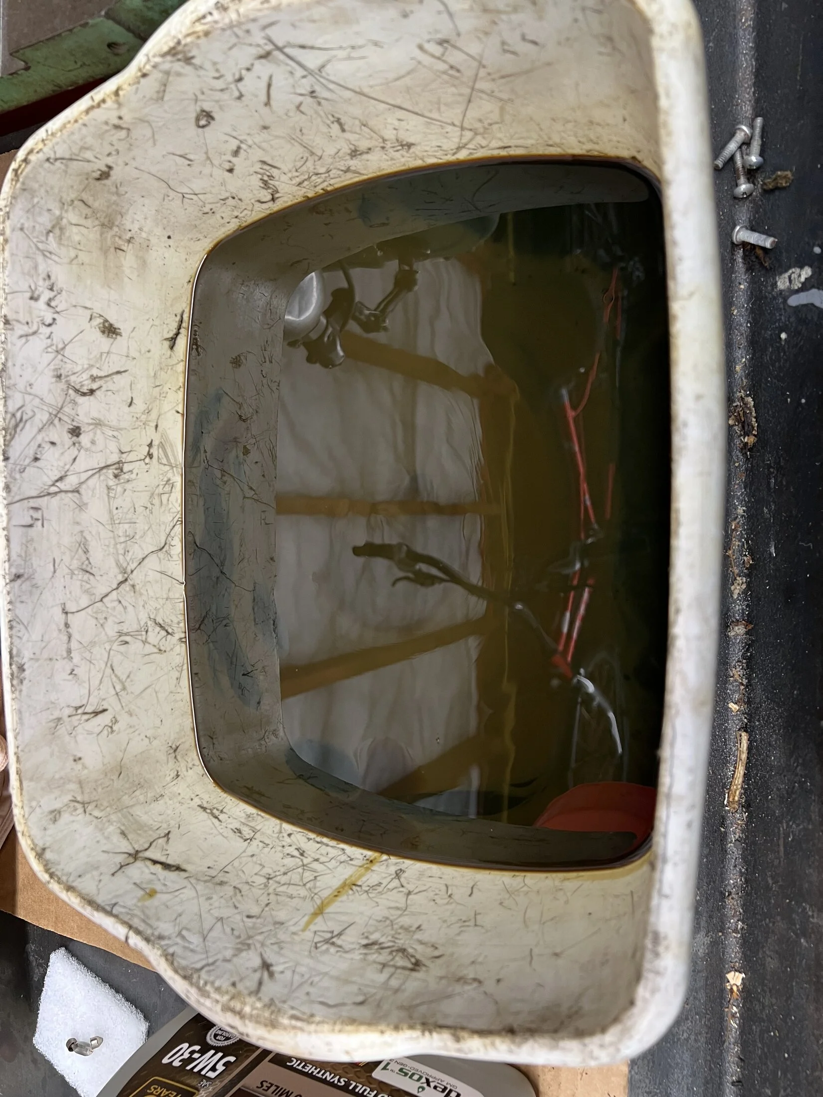

I did drain out what looked to be about 3 quarts of fairly decent looking fluid. Good lord this stuff stinks though!
Some globs of grease came out - odd. But no glitter.
I found the thread! Stock Turn Signal Functionality? - https://forum.ih8mud.com/threads/stock-turn-signal-functionality.1301980/
Seems like a easy "mod".
