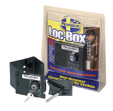

Mossberg makes a loc-box that should work with most shotguns not adorned with side saddles and what not:
Like any other mounting option you will need to find something solid to attach it to. The loc-box is designed for use on home walls so you will need to fashion a second and maybe third point that the shotgun can rest against to keep it from rattling around.

Yeah, that's the stuff. What I would like, ideally, is something like that that securely bolts to the inside of the tailgate, but can be removed completely so the gate can be used normally. Like, maybe a metal plate replacing the carpeted inner skin of the gate, with a threaded sleeve the lock would bolt to. I have cargo drawers, so if there is a permanently attached lock box, I can't get them open. I think maybe the answer is secure storage inside the tailgate.
