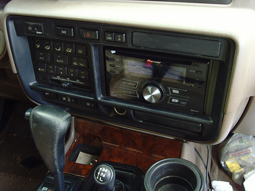

Just installed. It's a great unit for only $250
Pioneer FHP8000BT
*bluetooth phone (required in CA by July)
*iPod (included cable =5th gen or newer iPods)
*tUSB iPod Control on the FH-P800BT is compatible with iPod® (5th generation or later/Firmware Version 1.2 or later/iPod nano Version 1.2 or later). A 3rd or 4th generation iPod® requires CD-IB100II
*aux
*USB flash drive
*CD changer (but I didn't have the plug so I'll do that another time)
*wireless remote
aux & usb inputs for iPod, flash drive & aux (unsupported iPods, etc)

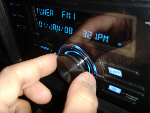

the center knob is like a rotary joystick. it's really cool, kind of iPod & joystick combined

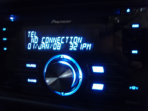

this is a example of the bluetooth phone screen- just push the phone icon to hook up to your phone.

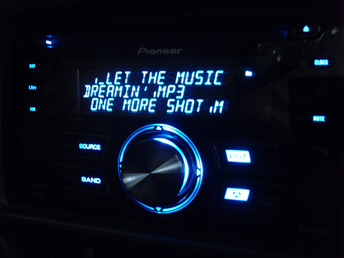

this is the scrolling list of music, you can toggle to just the track as well
nice remote to use the phone, etc

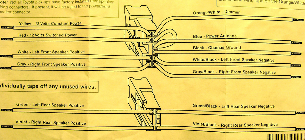

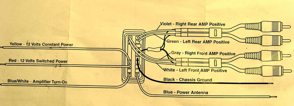

wiring harness options:
I have both aftermarket harness adapters for the LX450-
1. keep factory amp - I tried this as it is the most simple. only connect a couple wires and plug-n-play.
problem:The mid range & highs sound fine but the bass is terribly distorted. I don't know the cause.
I dialed down the bass on the headunit w/ no help. Crutchfield couldn't figure out what was wrong either.
This one did not work. couldn't figure out why
harness #1

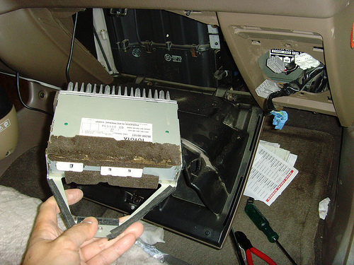

2.bypass factory amp - this harness requires alot more hand work connecting wires and running an extension to from the headunit to the connectors over by the amp.
harness #2
this is what I ended up with- making an extension harness to reach the 2 plugs by the amp location.

*harness #1 didn't work. The bass was terribly distorted. I think it was feeding the sub signal everywhere. too bad, it was the plug n play solution.
harness #2 is just like the one the LC guys use. My center console sub is not working now because of the harness does not have subwoofer wires. but it sounds clean and good anyway.
the pita is that the plugs are all the way over by the glovebox so you have to make a extension harness from the radio to the plugs.
below, you can see the 2 white plugs on the right, (next to the glovebox in the speaker hole).
removal of the factory amp behind the dash speaker
no cutting, it's a standard 2DIN opening and looks clean
reuse the brackets on the old radio, they bolt right up.

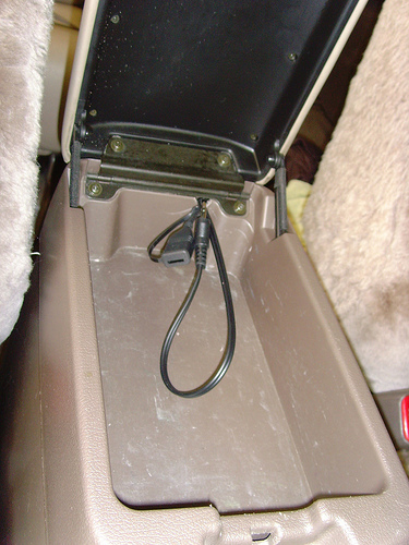

usb & aux plugs routed to center console for easy access
OK, I'm a little confused on this part cause reading through pigbuggy's install thread, it looks like he plugged into the harness behind the HU and just unplugged the OEM amp :confused:
this is for a LX450. it's different than a LC.
there are 2 plugs behind the radio- one that looks like the connector for harness #1 and a smaller CD changer controller plug.
the LC has 2 connectors like harness #2. The LX450 has those same 2 connectors but they are over on the side as pictured

Would this be the correct harness set?
70-1761 Toyota/Scion 87-07; Plugs into Car Harness at radio, (Power/4-Speaker);
When I search for 97 TLC on that site, it only shows the low level type harness (uses factory amps)
that looks like the right harness.

BT phone sounds clear. The caller comes thru the speakers so no problem hearing them. They don't seem to notice the diff between normal phone use. It's pretty cool, just start the car and your phone pairs up automatically.
Note there is a 'noise filter' -lo/med/hi. I have to play with that once the truck is at full noise w/ tires humming & exhaust booming at freeway speed :) I am not sure if you want less filter (or more) to keep from having your voice cut-out.
It also can download your phonebook, so you can dial & answer by name on the radio.
also, I think the BT Audio means that any BT music device can be paired and you can listen to music/books that way. I have not played w/ that yet.

well the menu goes from folder (you can scroll thru all your folders) ---click to-->song (scroll thru songs in that folder)
it's similar to using a iPod.
also, display options so you can show folder/song, artist/song, artist/album, etc
I have some weird extra folders in my flash drive, not sure why.
