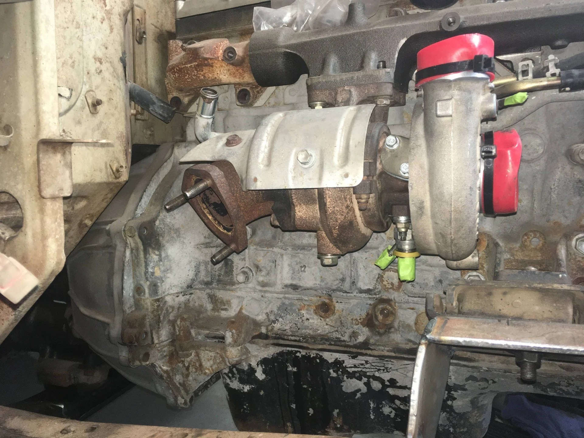

got a care package in the mail the other day, this one had my new to me turbo, crossover pipe, and exhaust dump. also not pictured is a h55 trans/tcase that I picked up for one of the cruisers.

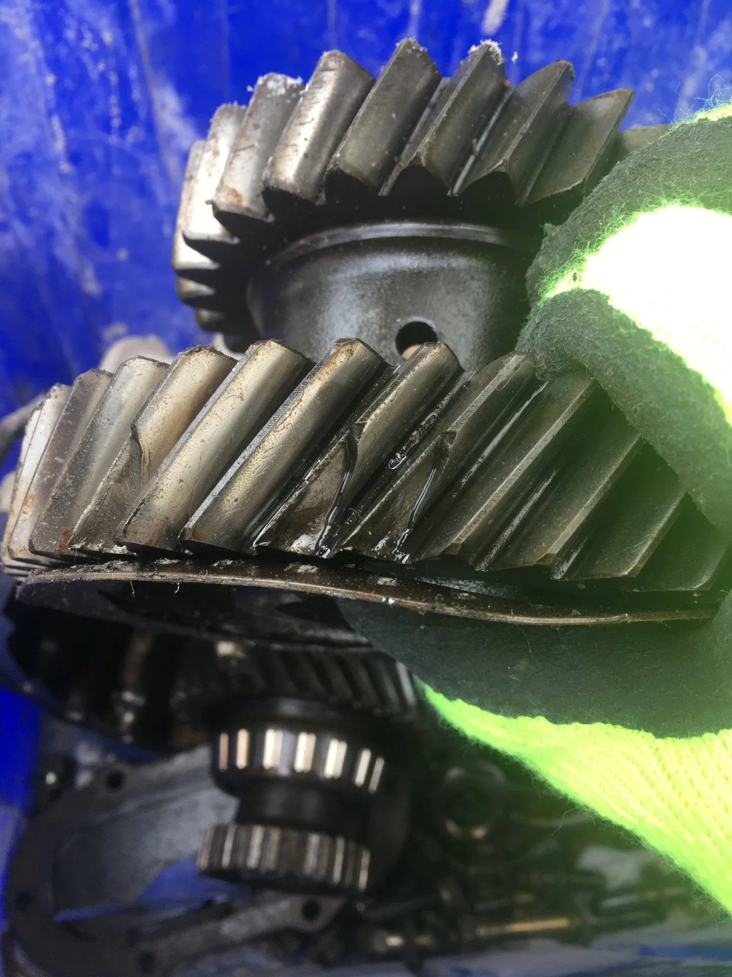

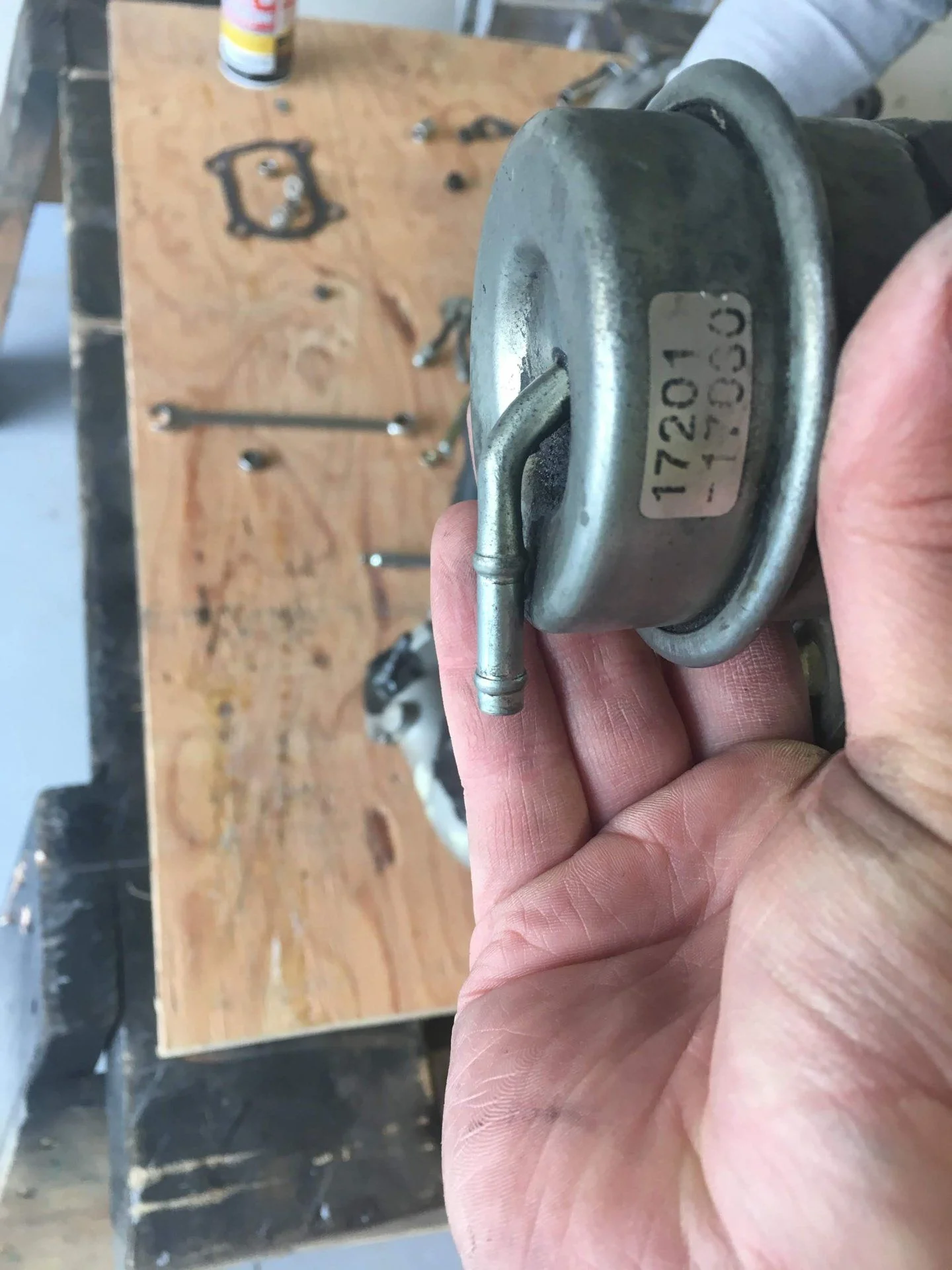

both packages came with damaged goods, the wastegate vacuum nipple was crunched a bit and the t case gears were damaged. the seller of the tcase set me a spare set so we are good there and I will pick up a new wastegate soon...
so I need a new wastegate as you can see in the previous post when I search the part number all I can find is a complete turbo... any insights to this?

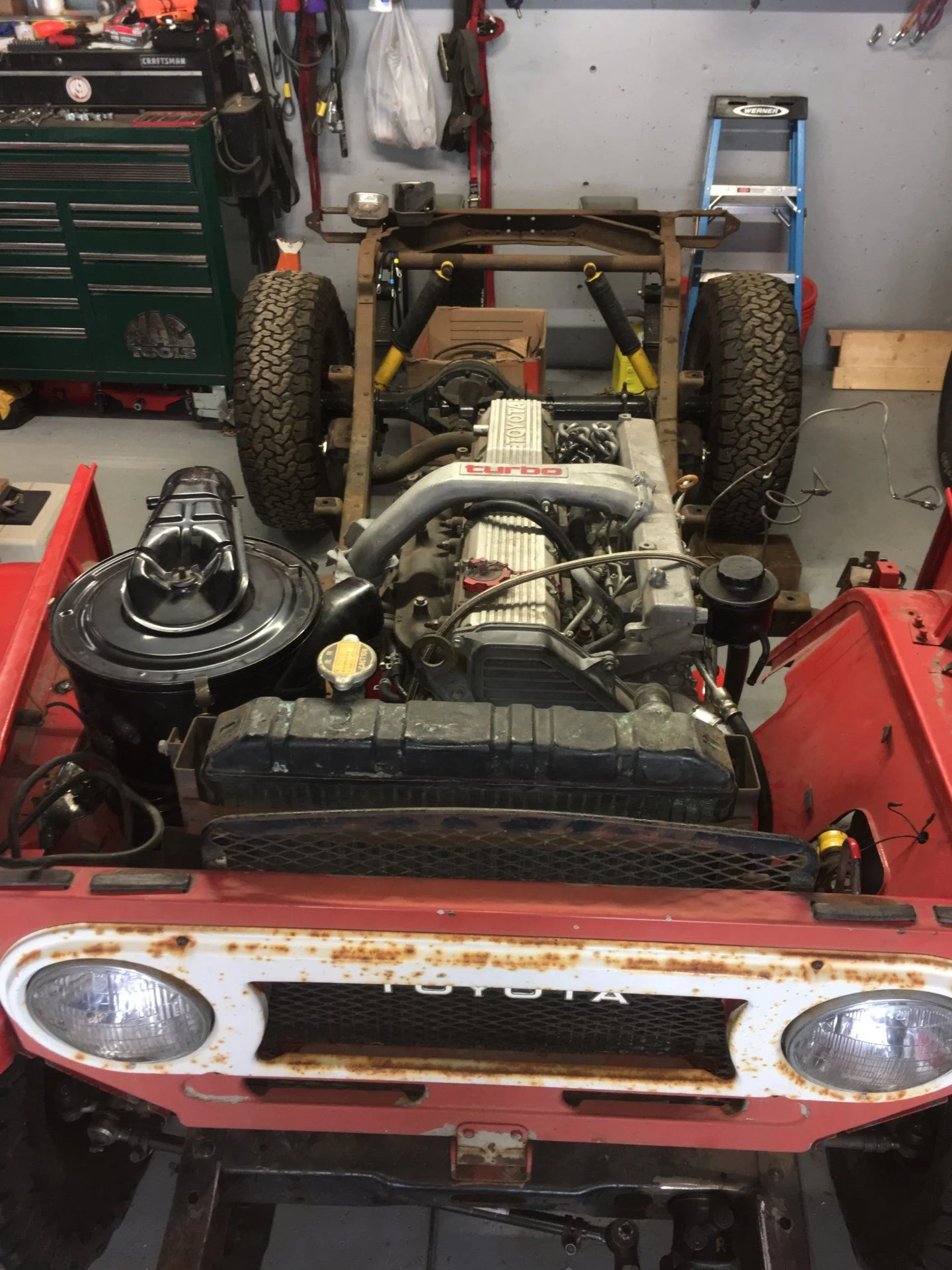

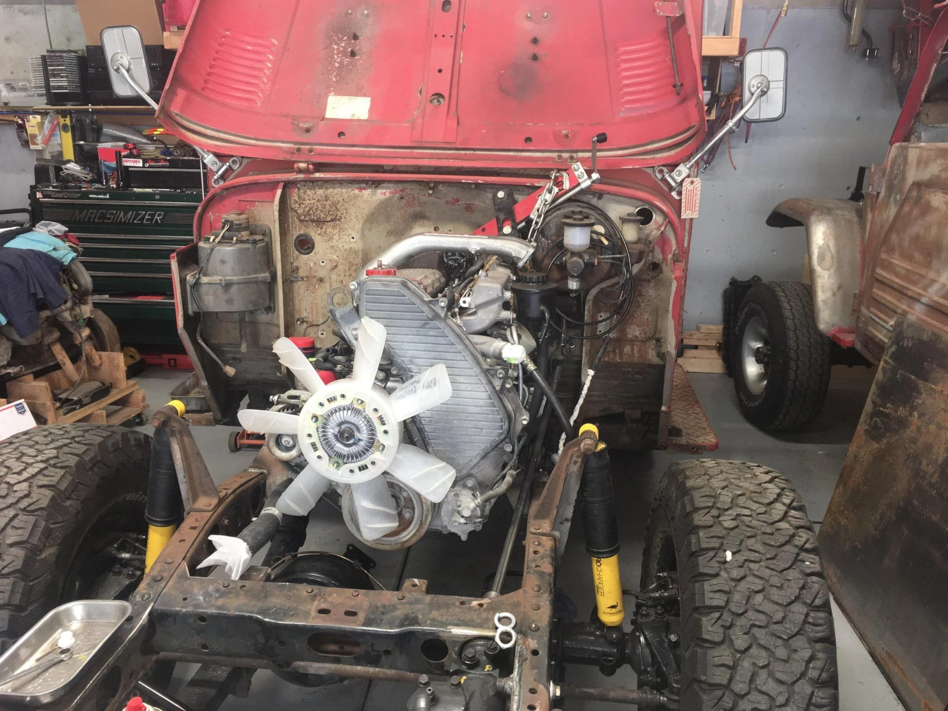

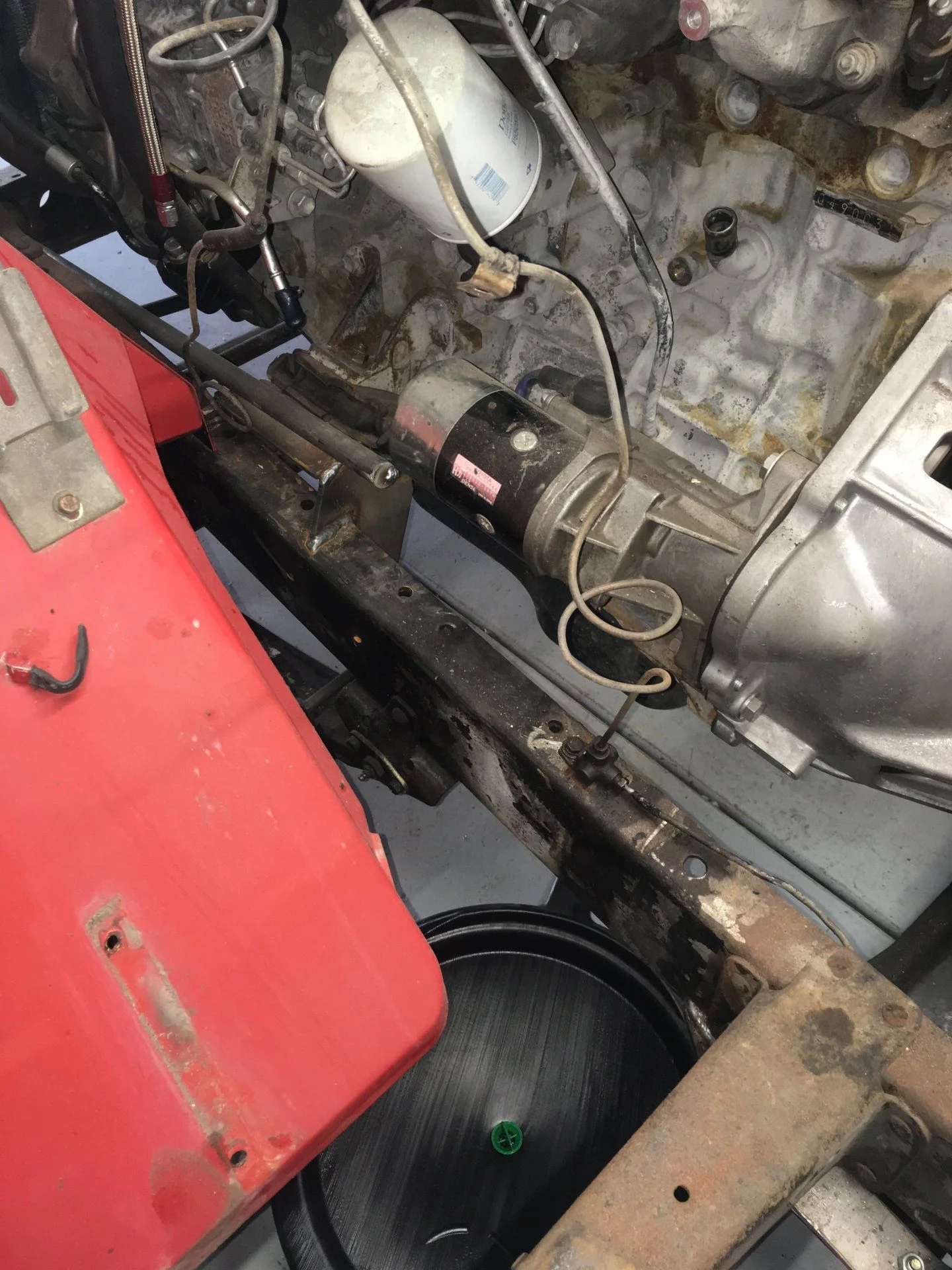

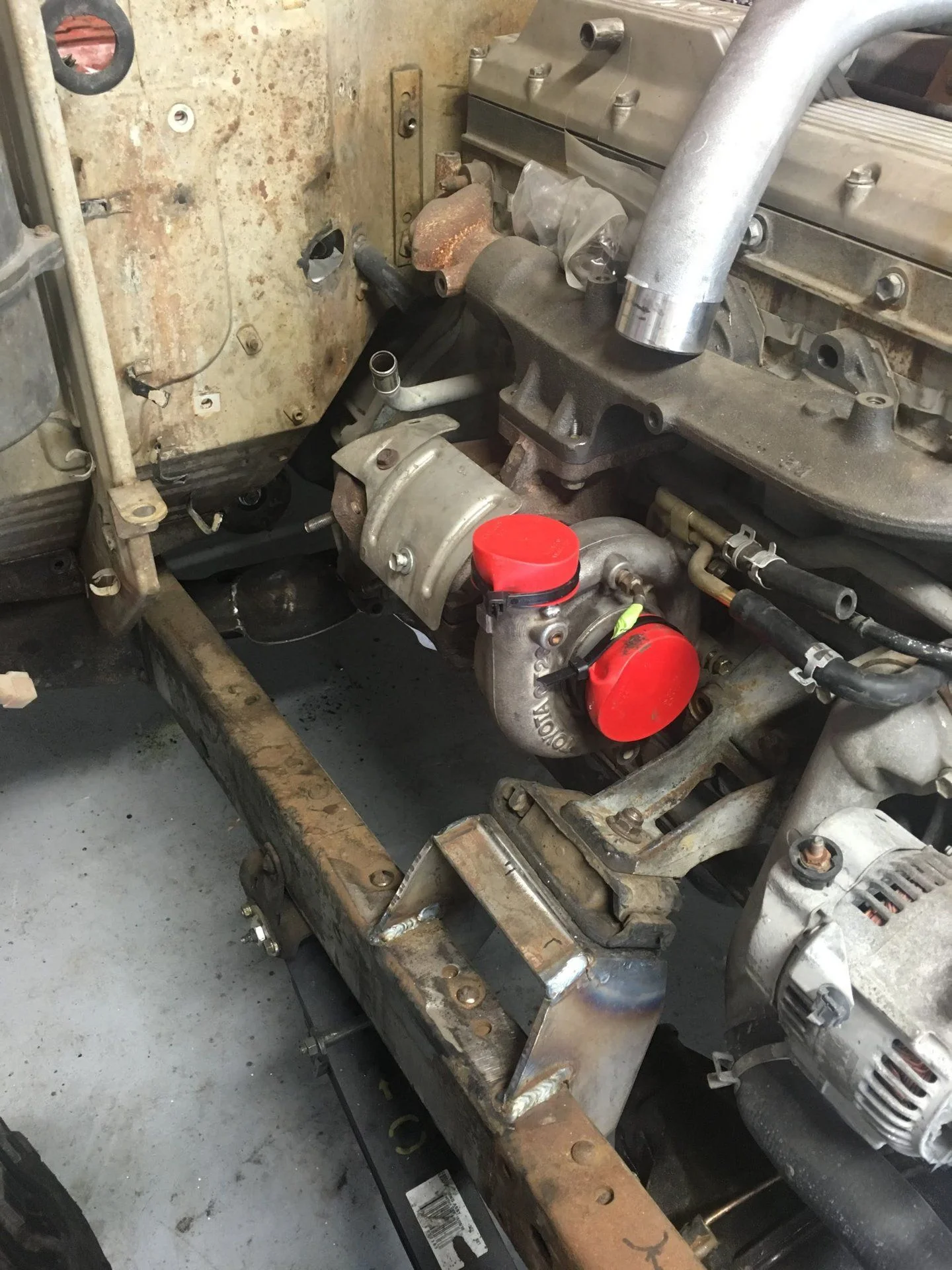

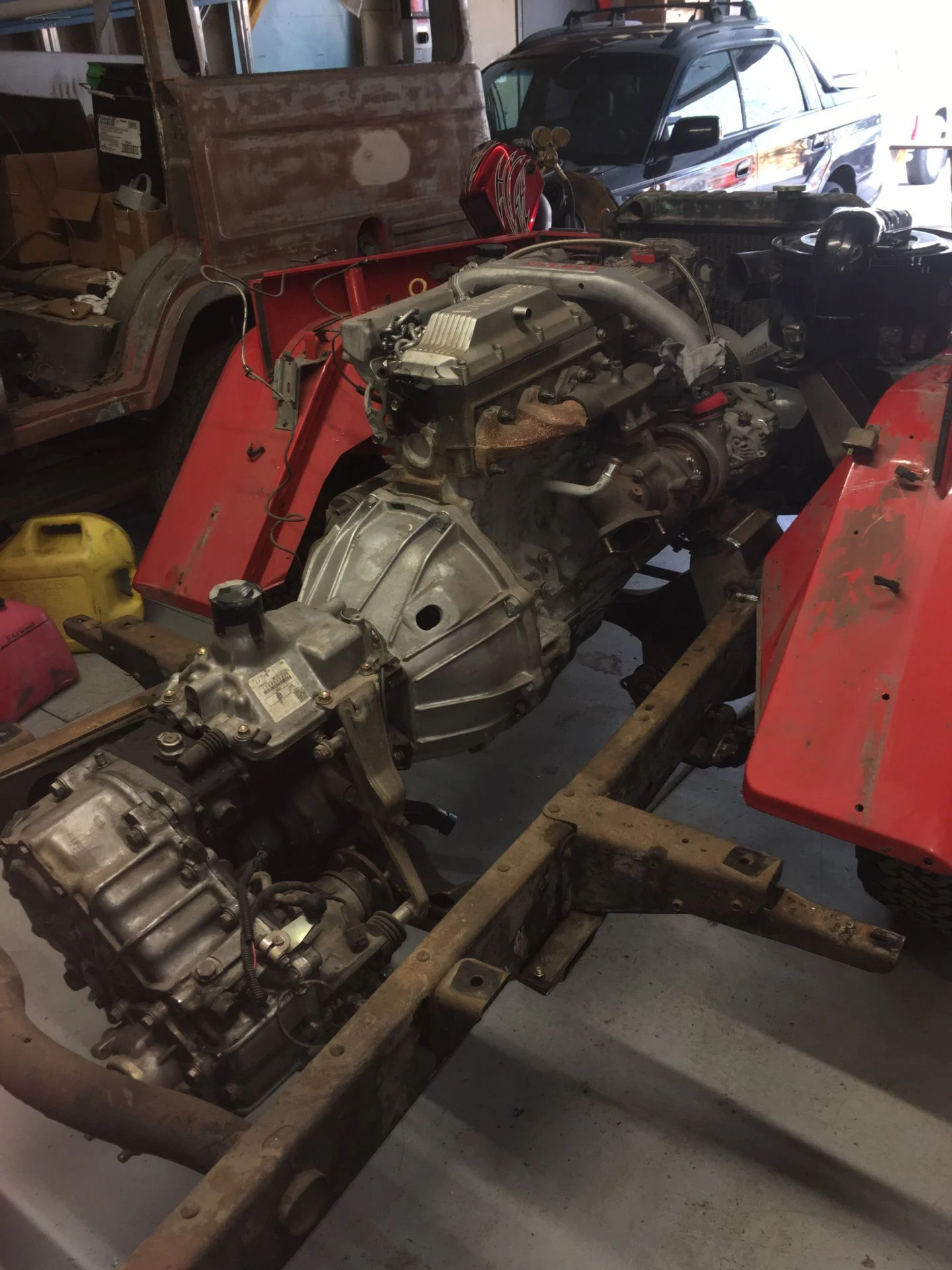

man, it has been nearly a year! life got crazy and now I need to catch up os here it goes.
- motor and transmission are in
- Air cleaner is mounted
- Drivelines have been made

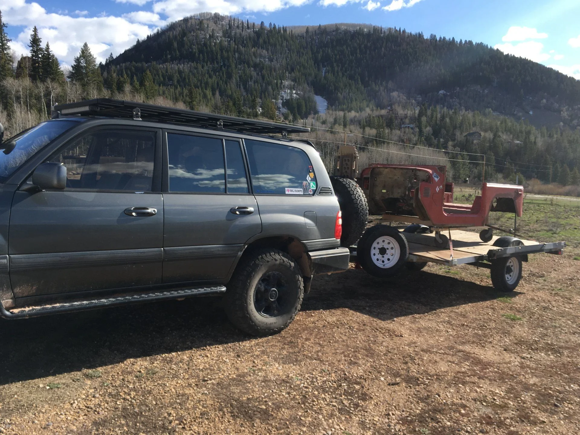

With My buddy only being able to work on this a little here and a little there it seemed like an ok time for me to take the body and get to work on that. I am trying to decide if I should blast it first and the take care of all the bodywork or vice-versa. I am also trying to decide between flares and going back to the stock rear wheel wells since I am only running 33x10.5 tires.
the shortlist mechanically
- clutch
- reseal the t-case
- run fuel lines
- add a lift pump
- turbo oil supply and drain, what have you guys done here?

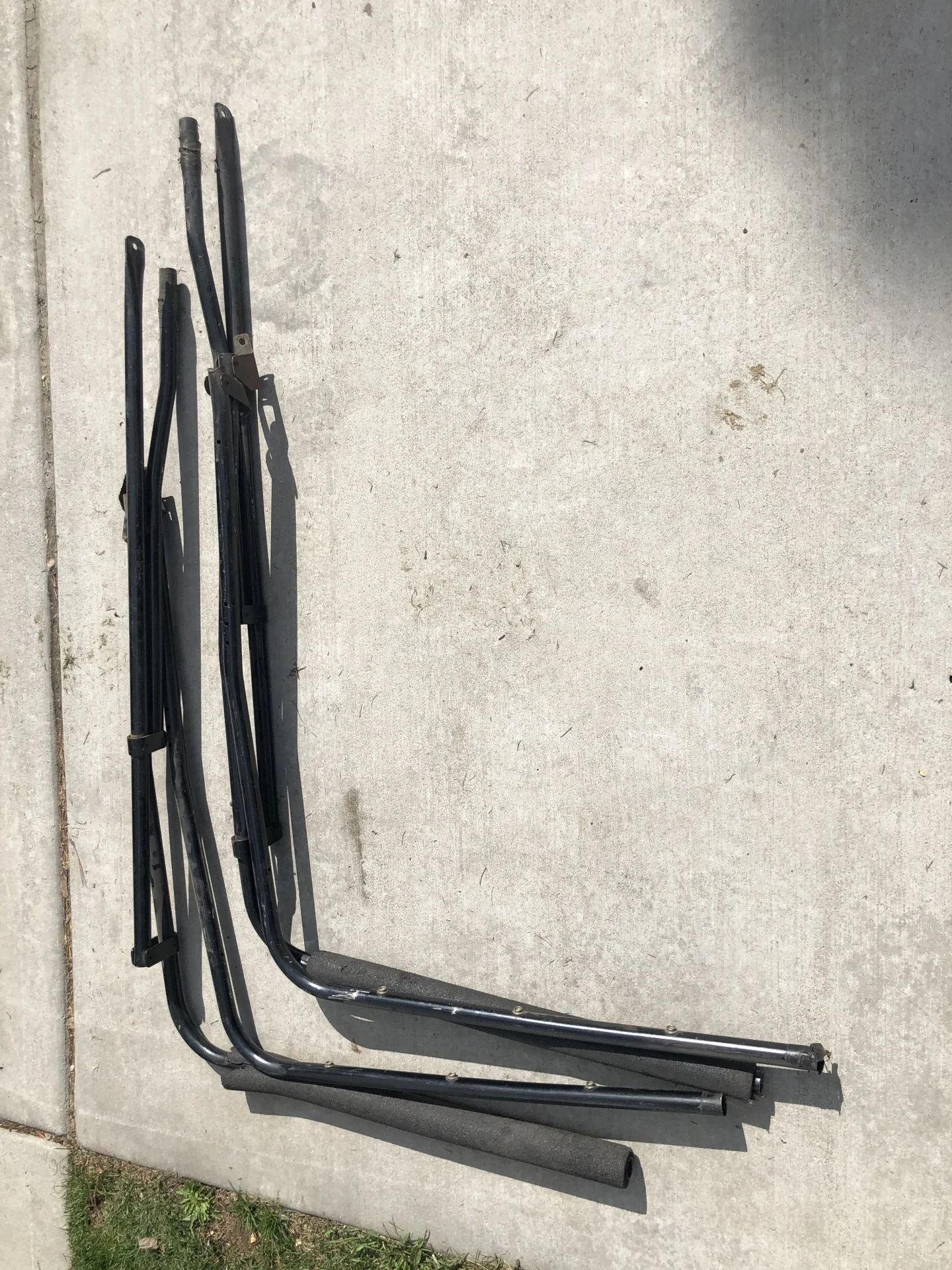

so I figured that this was an FST at one point in time because of the tailgate, the original bows are long gone but I was able to pick up a set of Pakistani bows and a top here on mud.

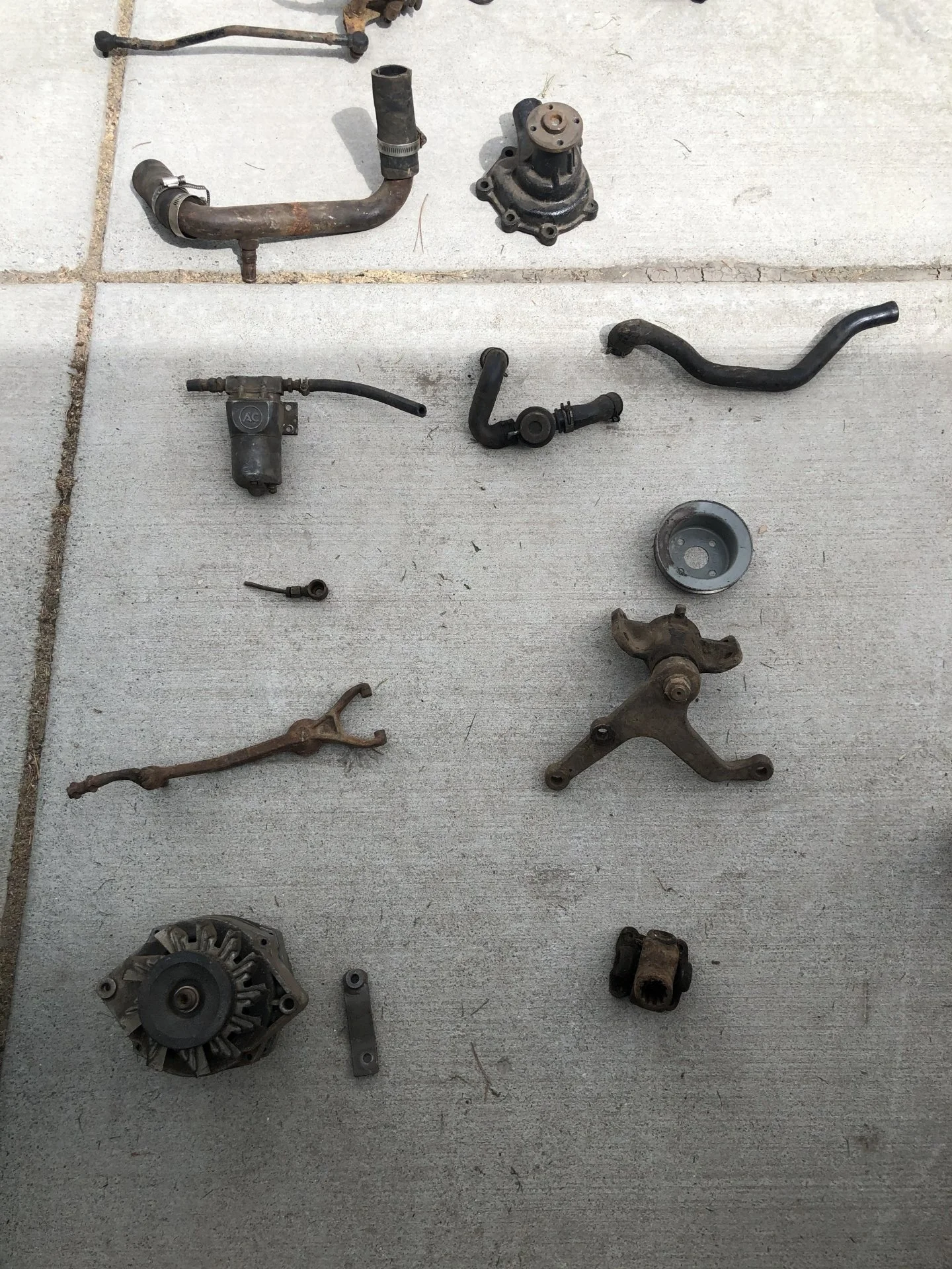

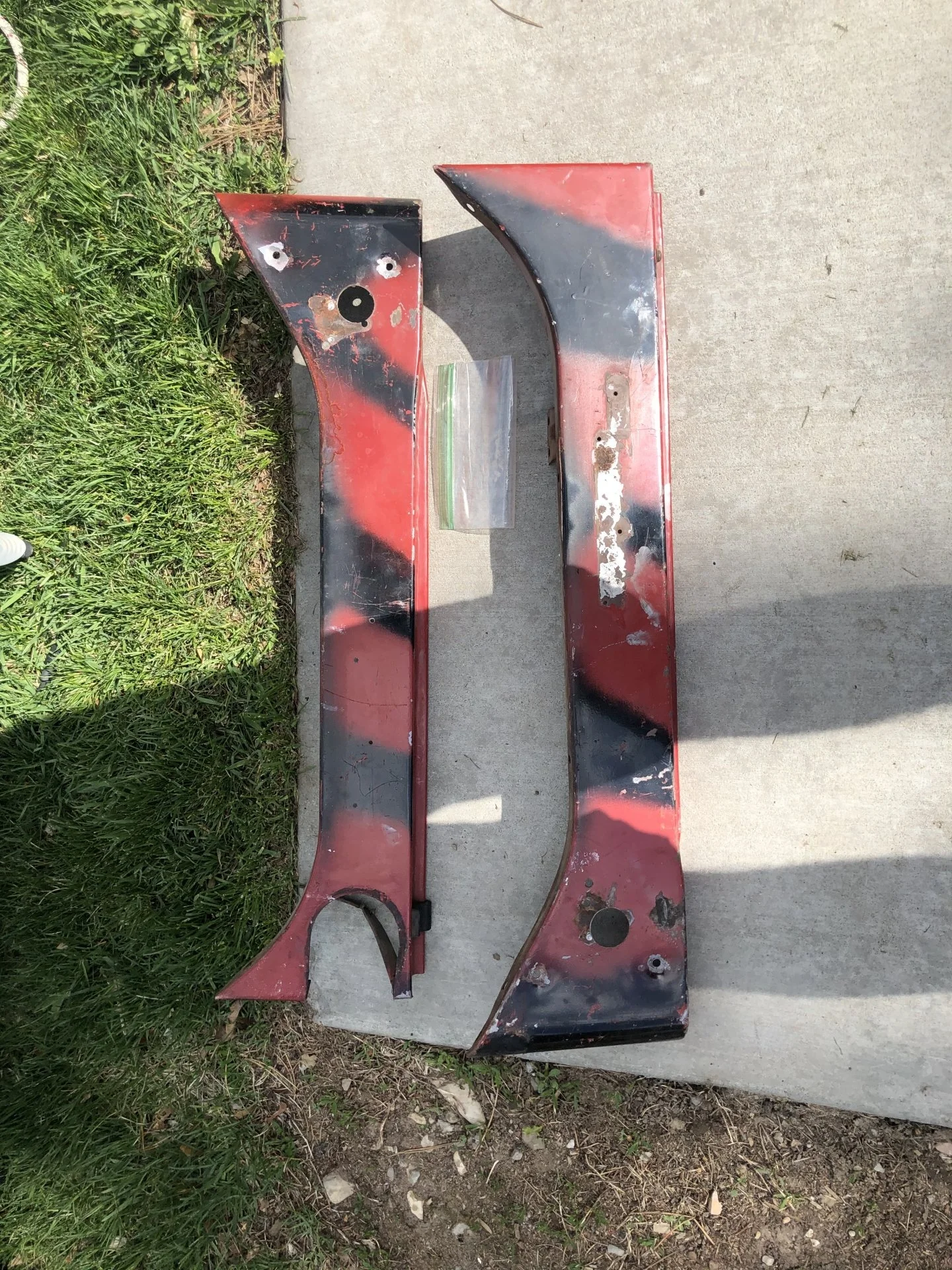

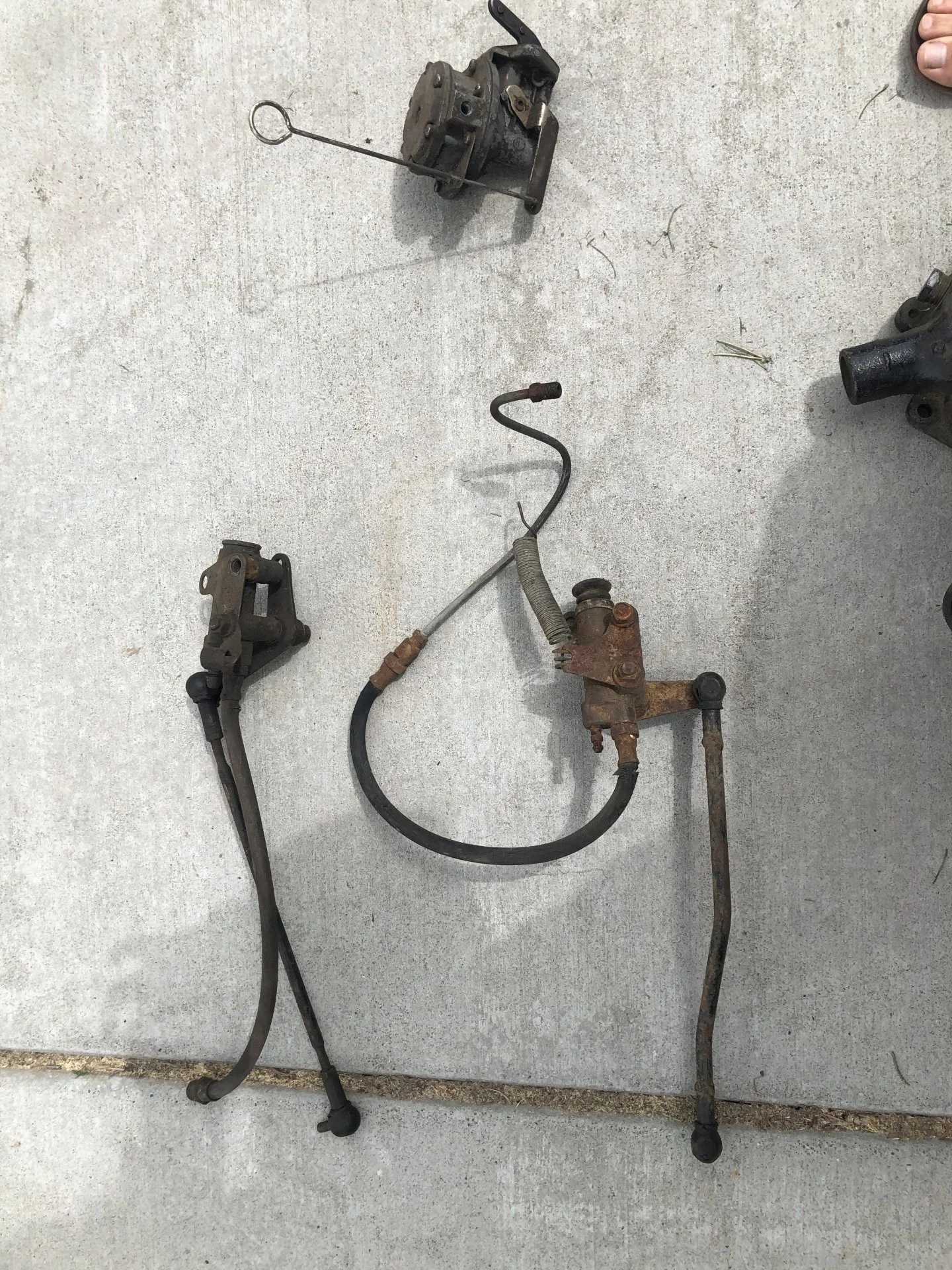

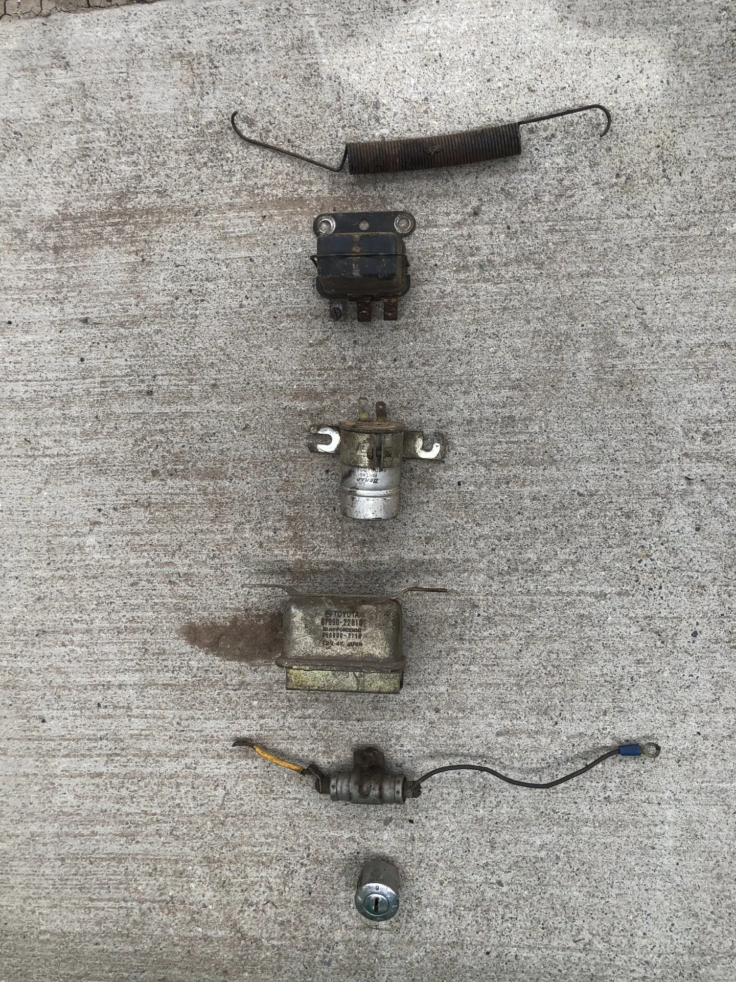

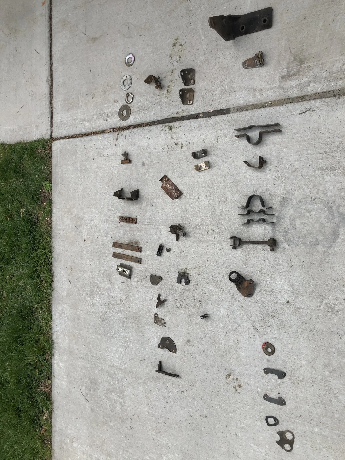

I have had some time to get my shop shorted out, here area few pictures of parts that i dont think i will be needing if you are interested let me know. I also dont know what many of them are...
I would like the aprons with the one cut for a snorkel. I only need the driver's side, but will buy both if that is how you want to do it and the price is right. Send me a DM. Thanks.
