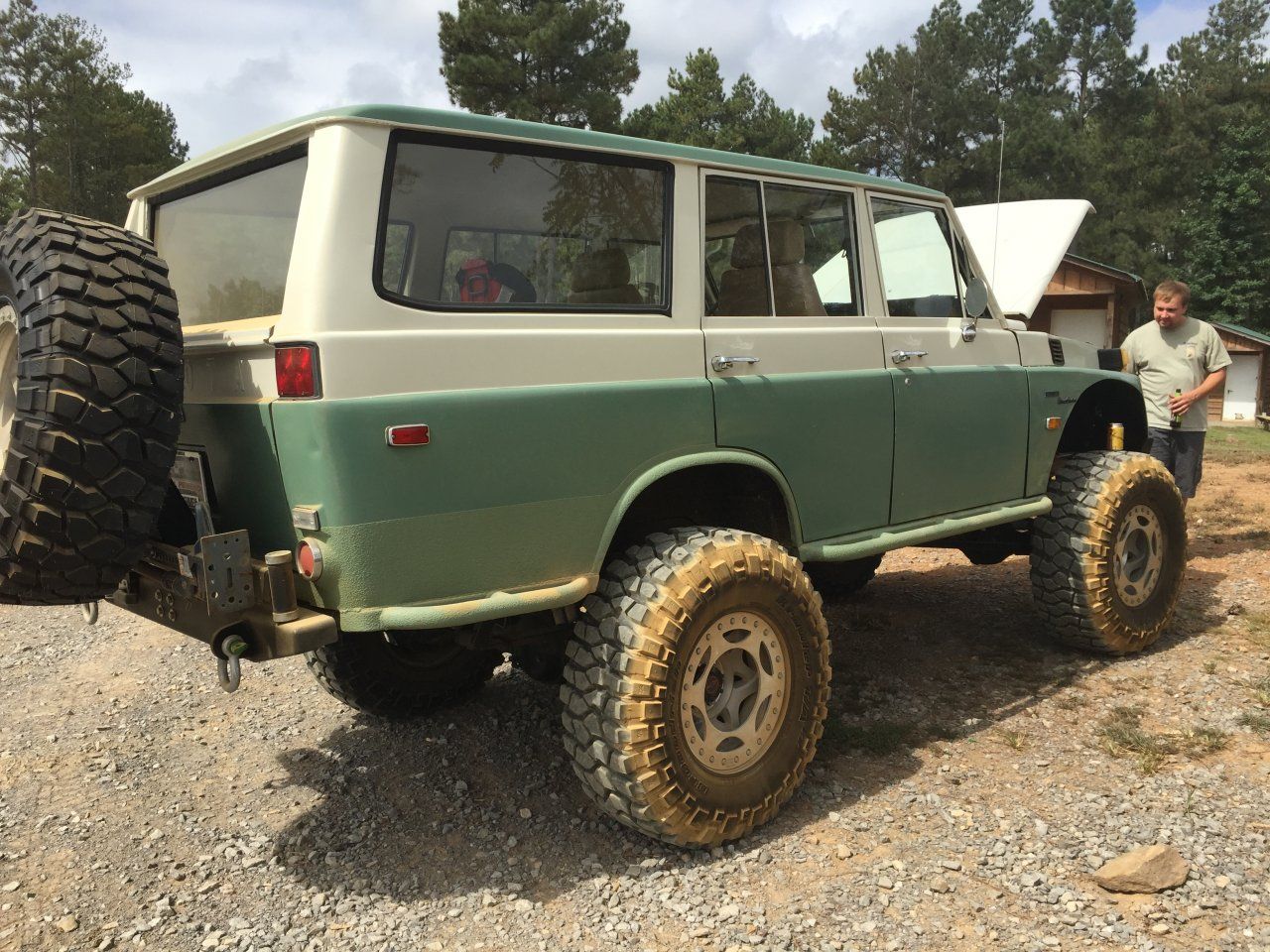

It's a straight truck with amazing work in it. One of a kind for sure.
Still worried about the cooling system. Steep hills on the highway were pushing the 230F range.
They have green coolant in now and I know that has to be flushed right away and replaced with red.
Put a 12 inch fan on the front this week, which is keeping temps in city driving down but the hill climbs are still creeping up beyond my comfort level.

What's with the dealer plate on the back? Did you buy it from a dealer?
@beno told me the Toyota red was a waste of money and wouldn't even sell it to me. Of course, I ignored him and used it anyway.
Is there a build thread on this somewhere?
Zack Penny is a local cruiser collector. We are not sure how many he owns, but he owns Bill Penny Toyota in Huntsville so he has it tagged through there for business reasons. Only dealer I know that has a showroom setup for Landcruisers (40;s, troopies, 45's etc...)
If it wasn't a newer toyota engine, I wouldn't care about the coolant type. But I think the 2UZ is specific on that stuff. Maybe Beno was referring to older F series engines??
I can't find a build thread, but I know Iron Pig and Slee did a lot of work on this truck and the PO sold this truck twice before.

In past seen electric fans not work well; if you can fit a clutched Toyota fan/ shroud try that and ditch electric fans.
Don't sweat the cooling. There is a way to make it cool I promise. That technology has come a long long way.

Nice work on the break down you pretty much hit everything right on. The trans cooler is a Fluidyne.
Now take off that Sky Jacker steering stabilizer and replace it and get some real door panels on it! lol.
