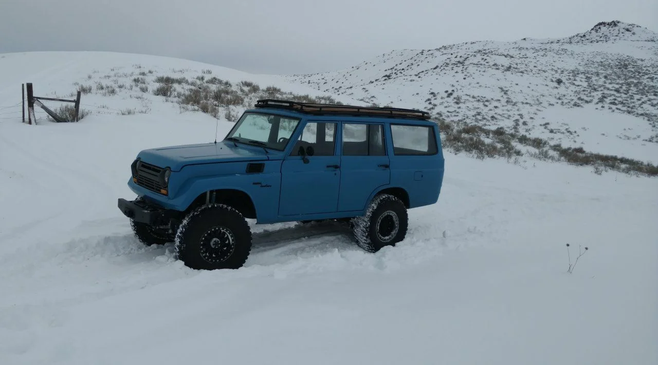

View attachment 1441238 View attachment 1441239 View attachment 1441240 Thanks Deo, I'll take you up on your offer. I look forward to meeting again. Oir pig is running great! I sooo excited. I'm think I'm going to install a shackle reversal to make a little more room for the 35's. Does anyone have any thoughts on this? Maybe a 5 speed??? But I don't want to rush it. Here are a few pics as it sits now.

Hard to tell from your pictures, what springs are you running?
I had to move my front forward one inch to make my 35” tires happy with the 3”/4” lift on my 55
I used the cruiser outfitters 2.5" 70 series springs... they ride really nicely with several leaves taken out of the rear.
I have the same kit, it worked really well with three rear leaves removed when I had the 33X12.5” tires.
When I add the 35X12.5” tires I needed to add the three leaves back in the rear and move the front axle forward an inch, at first we just redrilled the centering pin hole in the main leaf and the second leaf with the wrap one inch forward and move the rest of the flat leaves forward on the centering pin, this worked well and was a fast easy solution to moving the axle forward.
I had a new longer main leaf made when I re-arched the front springs to get rid of the stink bug with the center pin in the new location, but I believe the second spring is still the OME spring with both holes and no issue with durability.
