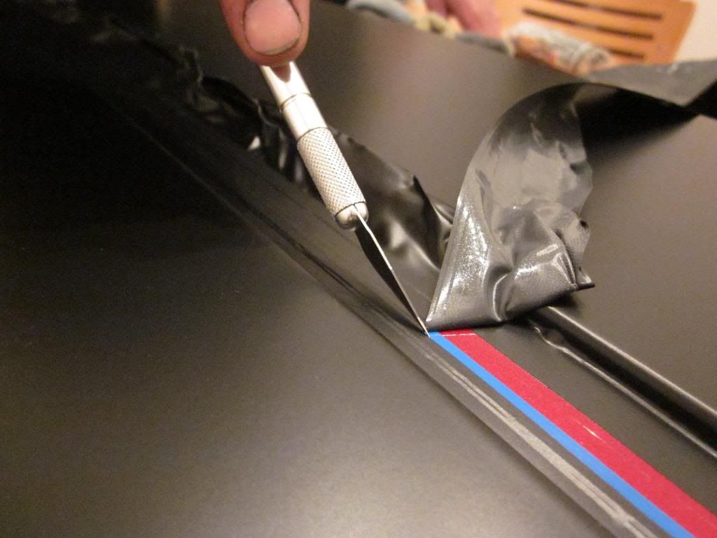

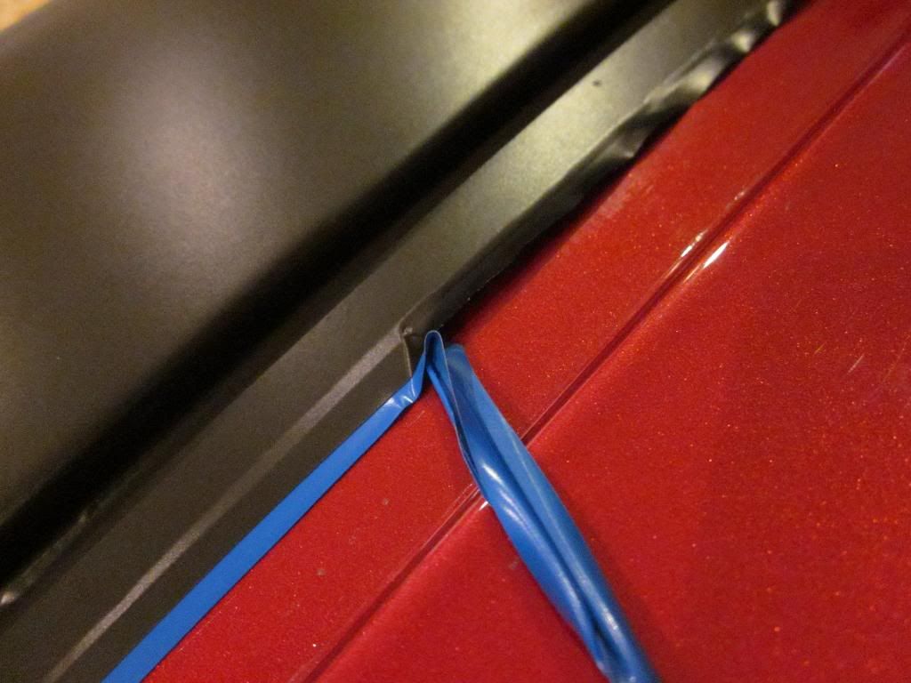

I found this cool vinyl tutorial awhile back. Check it out, the guy covered an entire C5 corvette in matte black vinyl. LOTS of work there. Scroll down 1/4 way to where he follows a countour line on a gutter. He uses fineline tape to put on the contour, lays the vinyl over, cuts on the tape, then pulls it out and sticks the vinyl. I think that approach would work really well on the 60's side contours that you followed. Put the tape along the edge, and cut.
