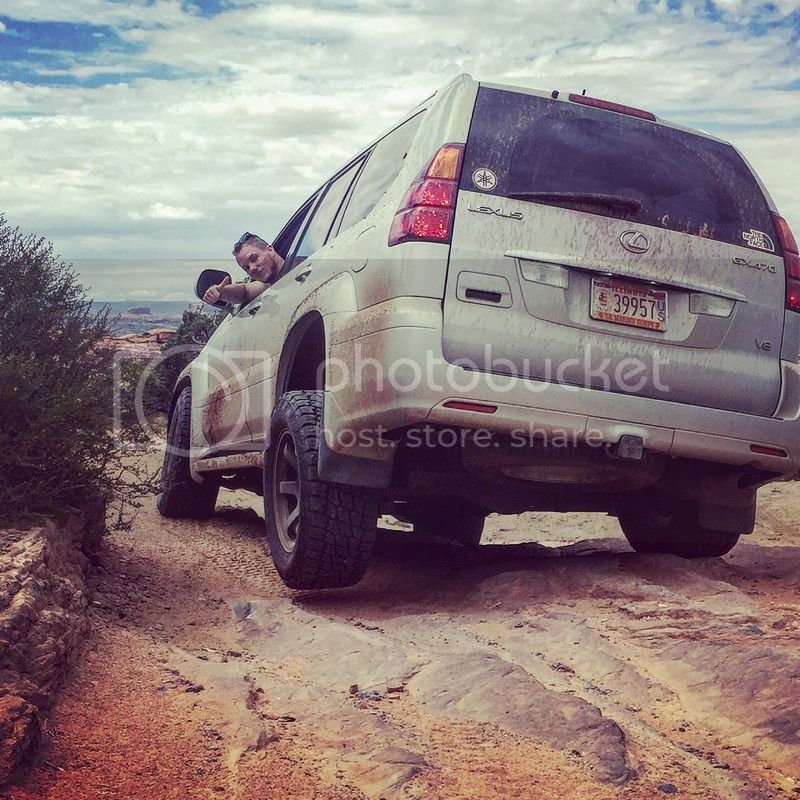

I've done some pretty crazy trails out in Moab, and never disconnected my links. You get quite a bit of flex even with them connected.
