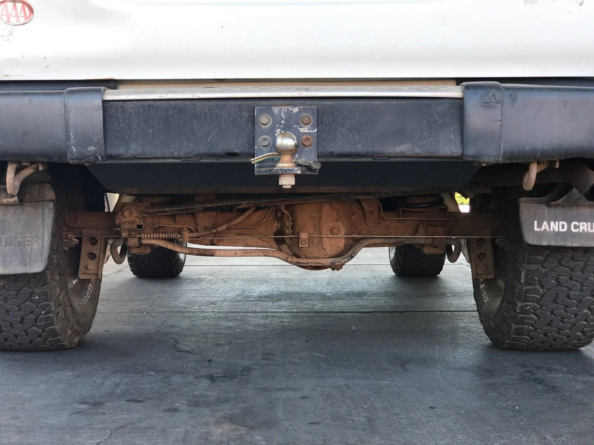

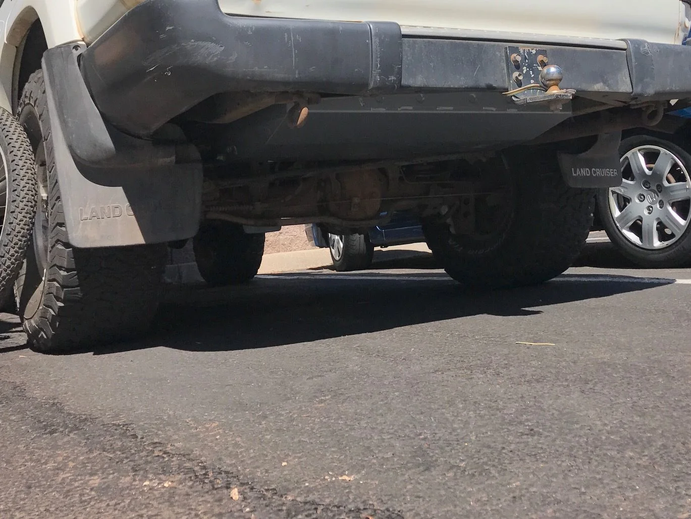

These pictures show an installed LRA 24 gallon aux tank on a 1992 80 series.
When shopping, I had a difficult time locating pictures of the position of installed 80 series LRA tanks (this is the smaller of two available) as may impact ground clearance and departure angle. I hope these pictures help others doing similar research.
The tank is located in the spare wheel bay. The spare must be removed and relocated. The tank rides nice and high, out of the way:

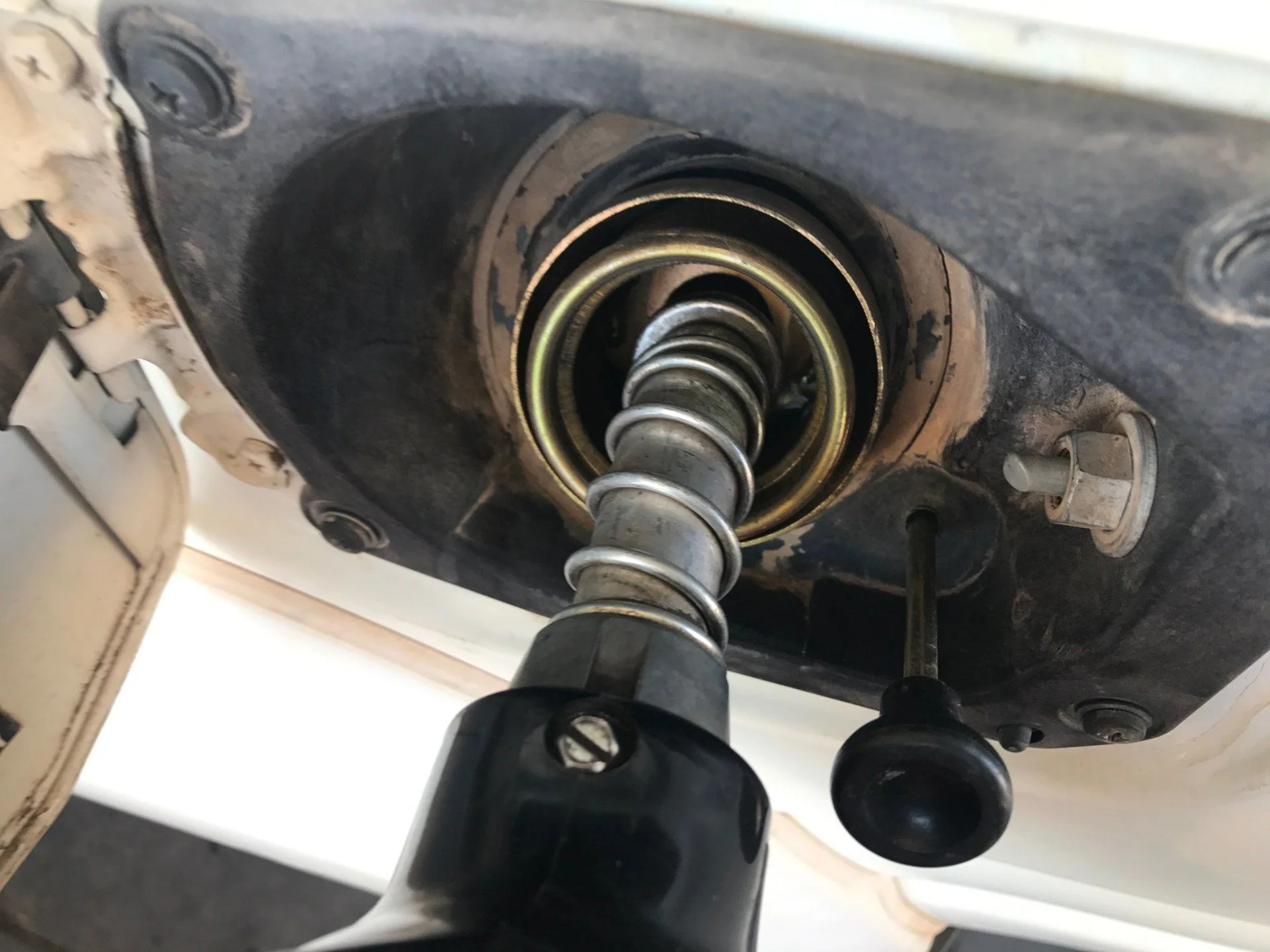

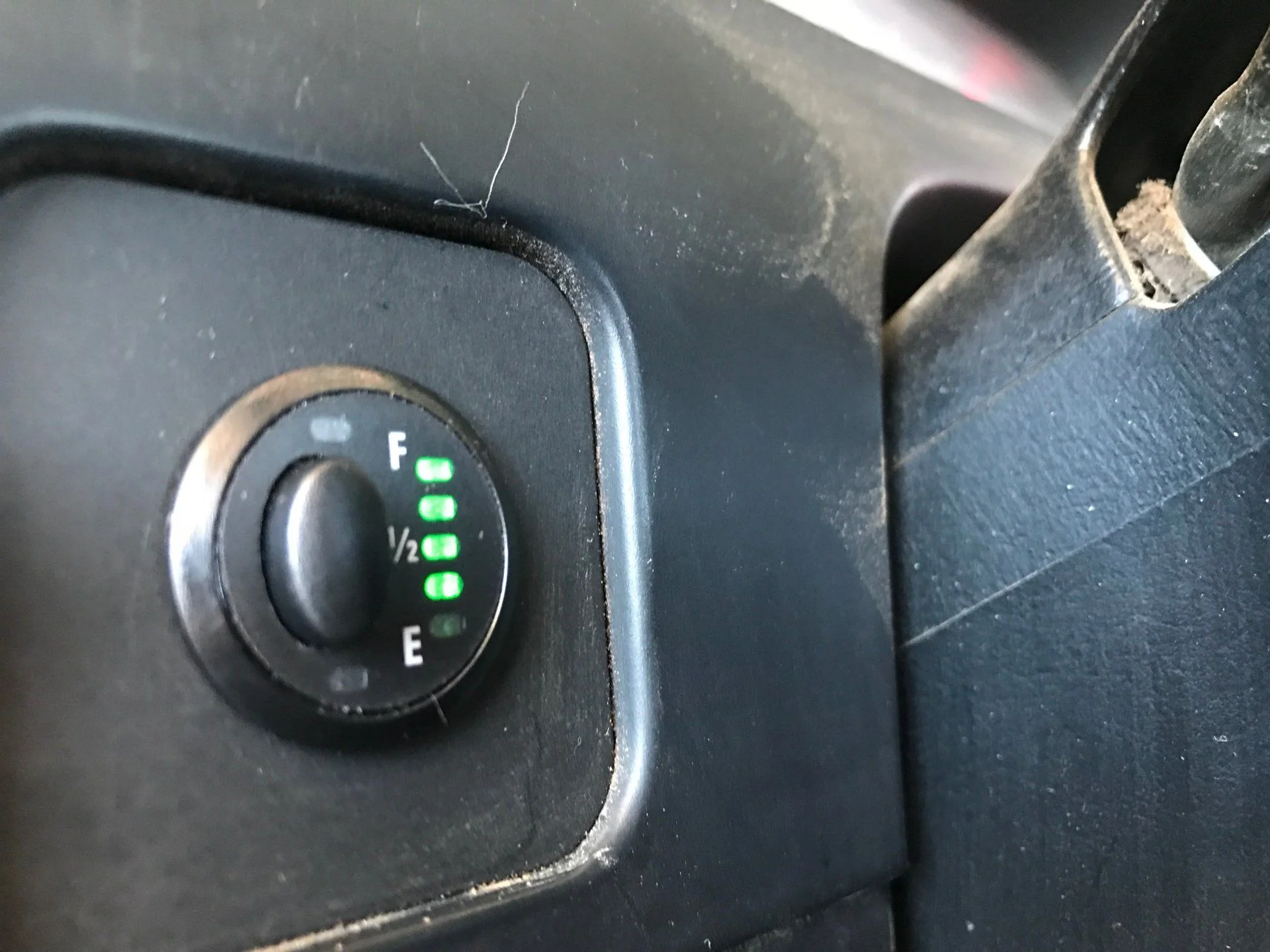

A pump delivers fuel from aux to the main tank. A dash switch turns the pump on and off and shows the aux tank fuel level.
The tanks are fueled from a common point. When fueling, a pull switch controls which tank fuel is sent to. The out position, shown below, sends fuel to the aux tank; depressing it sends to the main tank.
The tanks are fueled from a common point. When fueling, a pull switch controls which tank fuel is sent to. The out position, shown below, sends fuel to the aux tank; depressing it sends to the main tank. View attachment 1688194

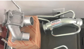

was it OEm dual filler? i just ordered this but already have an entire setup i peiced together so im curious.
I don't know whether or not it's OEM.
Yes, the Long Range Automotive kits for the 80 Series include a dual filler assembly that is OEM Toyota. Not a single part number but an assemblage of subsidiary p/n's from the manufacturer. The 80 Series aux tanks are the only LRA kits that use this component. The other aux kits use a twin-fill item that they manufacture.

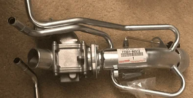

View attachment 1703938 View attachment 1703939
i bought all the pieces seperately as you know, and still couldnt make it all work. So Im handing it off to a more proficient mudder and installing your kit. is what it is.
