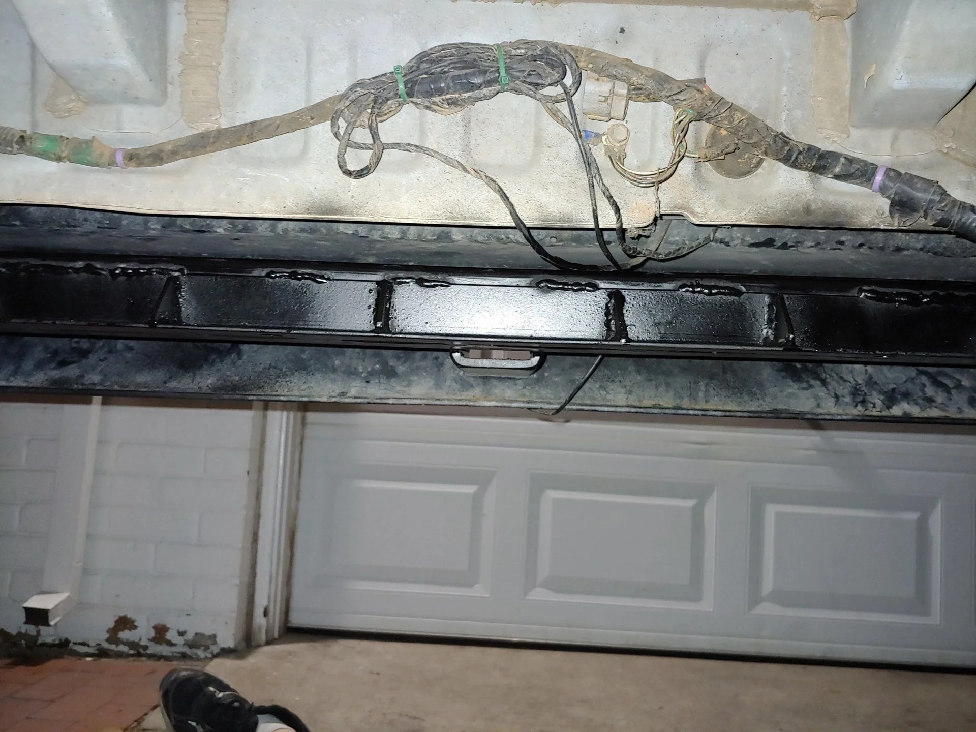

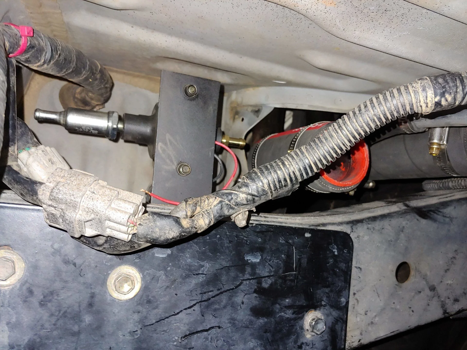

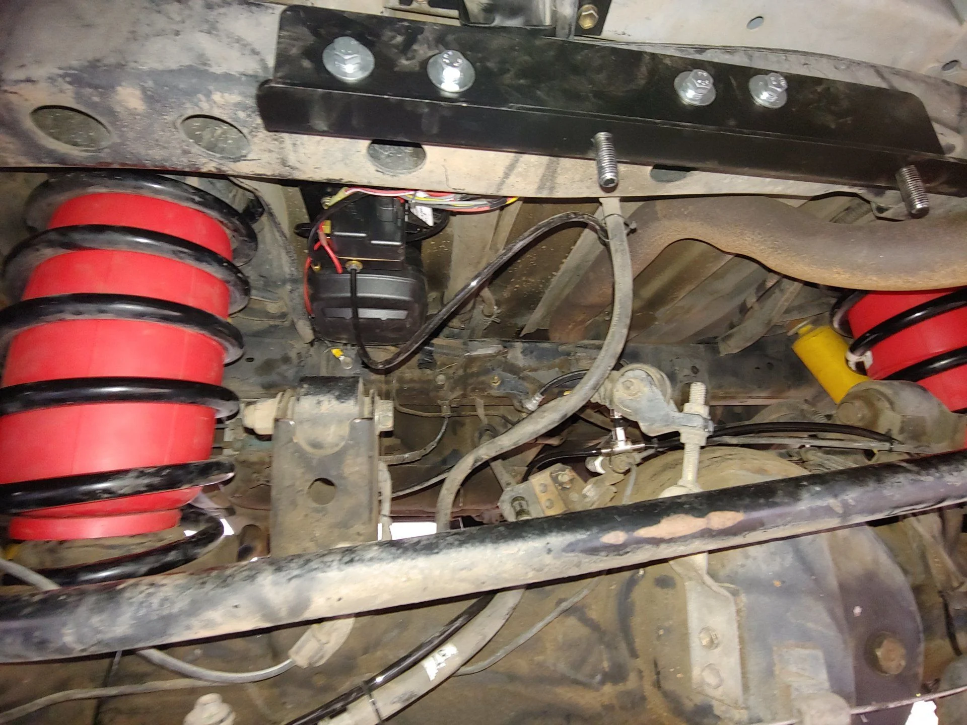

I just did the install myself and have a 4x4labs rear. I didn't bother using the included bracket and just welded a piece of angle iron and gusseted the crap out of it. It's welded to the rear 4x4 cross member.
Here's some pics. I've been lazy to do a write up but I eventually I will. But the install wasn't too bad. I did it in 2 days and did the install with Airlift airbags at the same time to combat the sag. I'm already running J's in the rear too.
