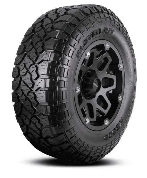

Quote from another thread and my reply were out of order. Just don’t hear much clearly positive on the Kendas.

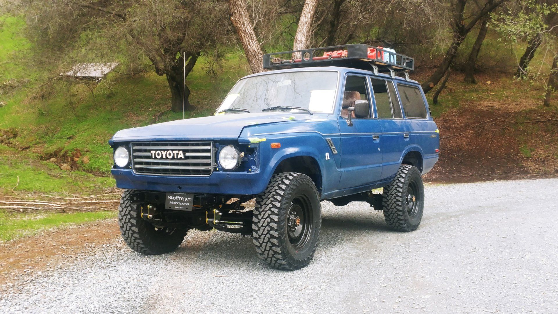

i'll post up later, have to get on another computer. The key on my pics with my truck ...I have 2inch body lift and 3+ suspension lift.
I can't find the series of pics at home but see the pic I posted in this thread. 17inch FJ cruiser wheels with 35/17/12.5 tires, requires spaces on rear to keep tire from scrubbing hard on inner fender, did not require spacers on front but ran them anyway just to keep things space similar front to back.
I was so glad to replace mine with Coopers!!

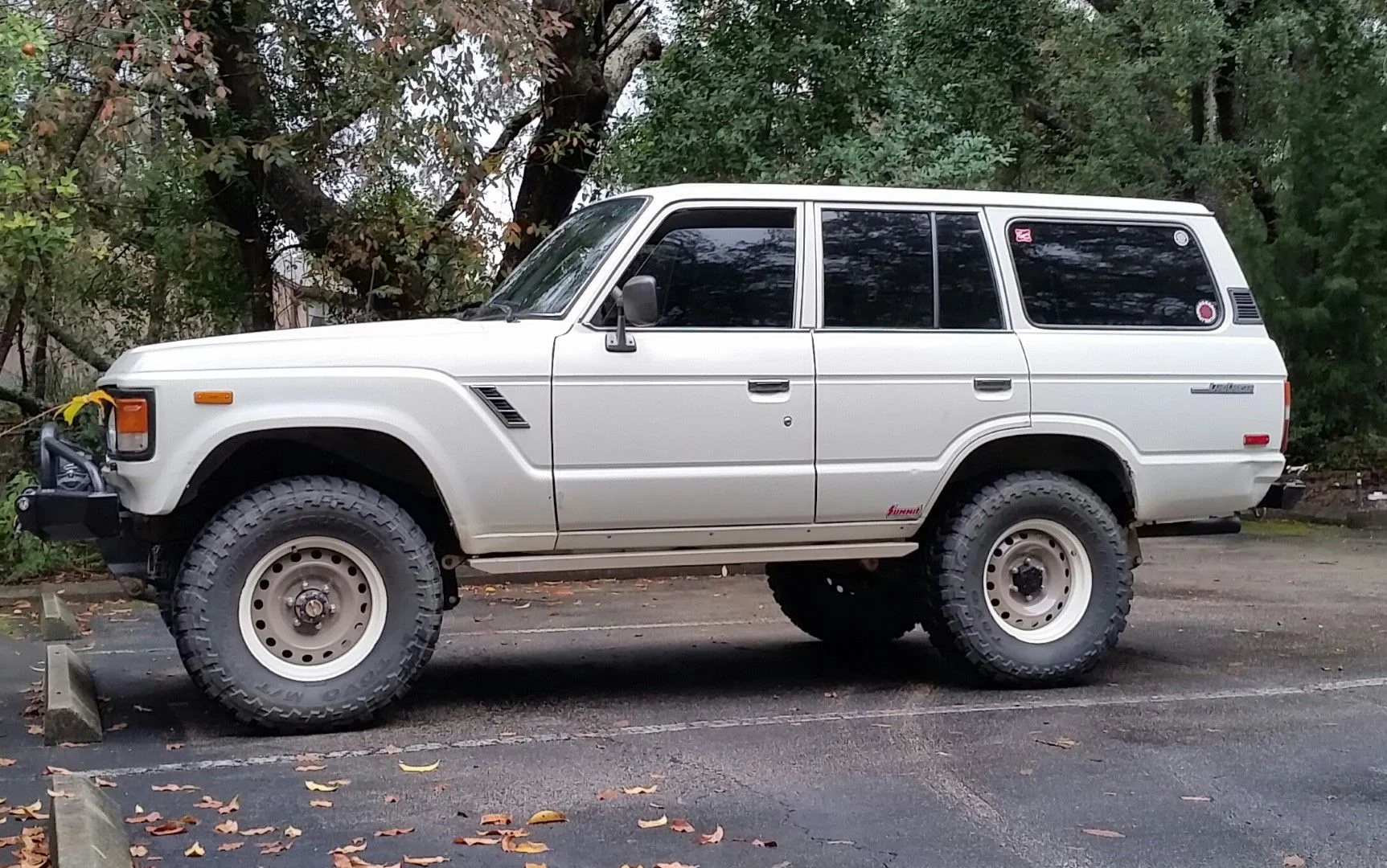

Late to this thread, but here's my 60 w/ FJ Cruiser steelies and 285/75R17 Toyo MT's...
(just a pic from behind my office)
I'm running 1.5" spacers, clears everything just fine.

Two tone on the steelies looks cool.

a narrow tire is a better choice as noted...for the 17inch FJ cruiser wheels, at the time I had 35 * 12.5 * 17 tires...so thats what I ran.
