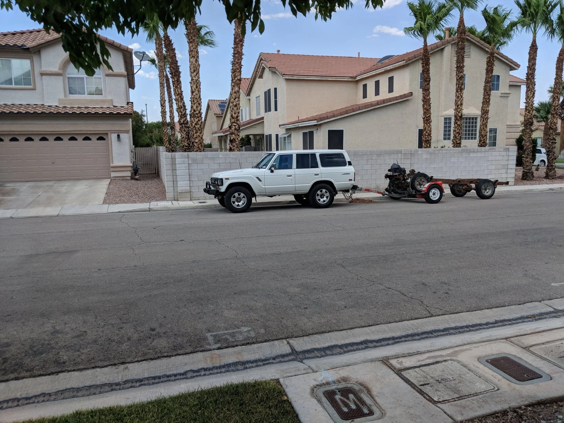

I do not have stock axles so I cannot help with the spacer set up but here is a pic of mine with nitto grappler 285/70/17
