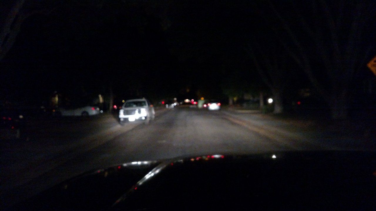

@McGrinnan here's the lights.
Stock low beam
Stock High beam
And High beam with front lightbar on
In person is much better experience, but I'm still beyond stoked for my $38 each price, was roughly $100 for materials and price of units installed. Thanks again @jcardona1 for the recommendation, stoked on performance!

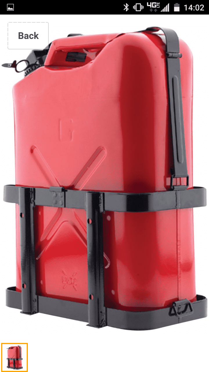

Amazon Sunday delivery! Pop can for size reference, rated at 2000lbs, 11 bucks plus sheeping.
