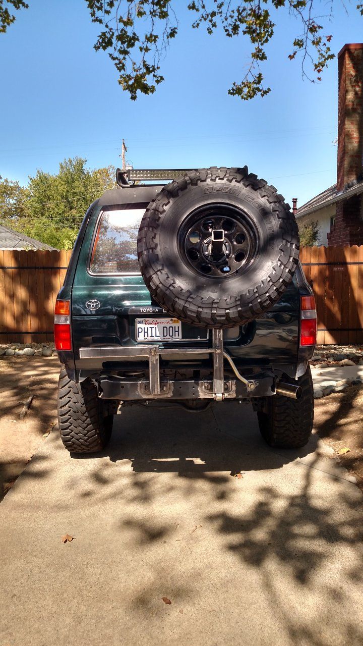

Please explain to me how your rear tire carrier works. I'm lost
It's not finished! The tire will have a hinge/clasp right where the vertical tube meets horizontal tube going into the receiver. I haven't had the help to finish it as much as I hoped, I haven't been in the cargo area in a couple months! The jerrycan side will be fixed in place, and removed at campsites individually. The spare is so tall for three things, clears the taillight, clears the license plate, and, when it hinges, the tire will clear the tailgate in the lowered position.
